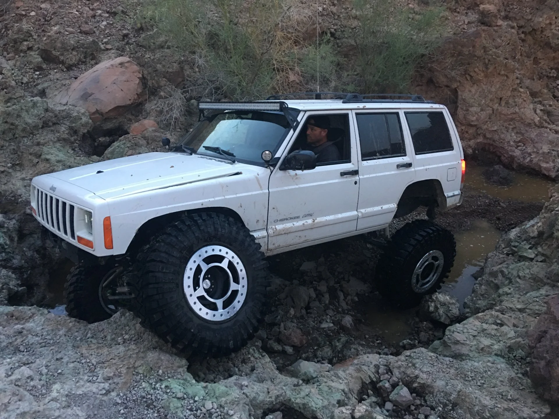

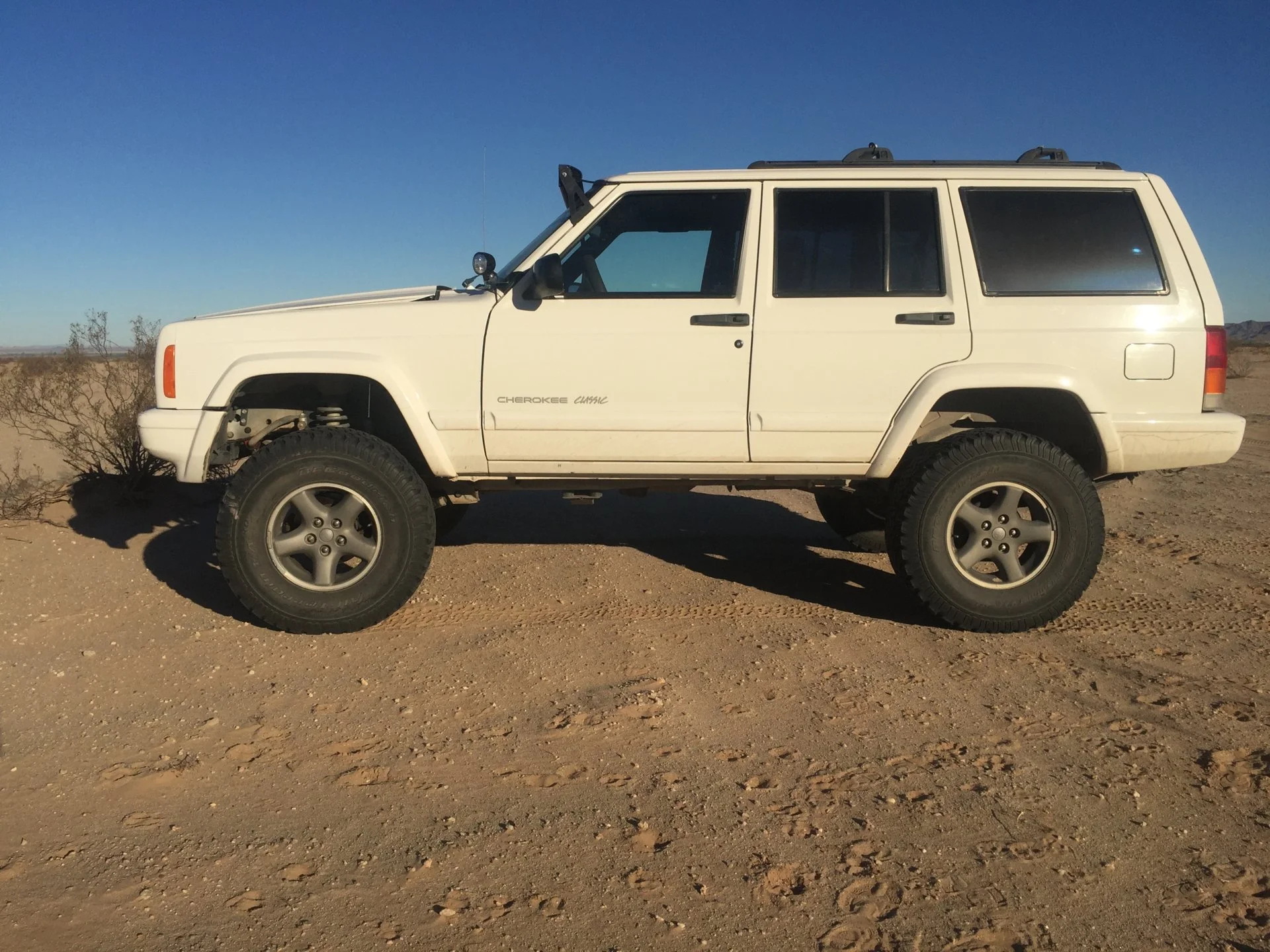

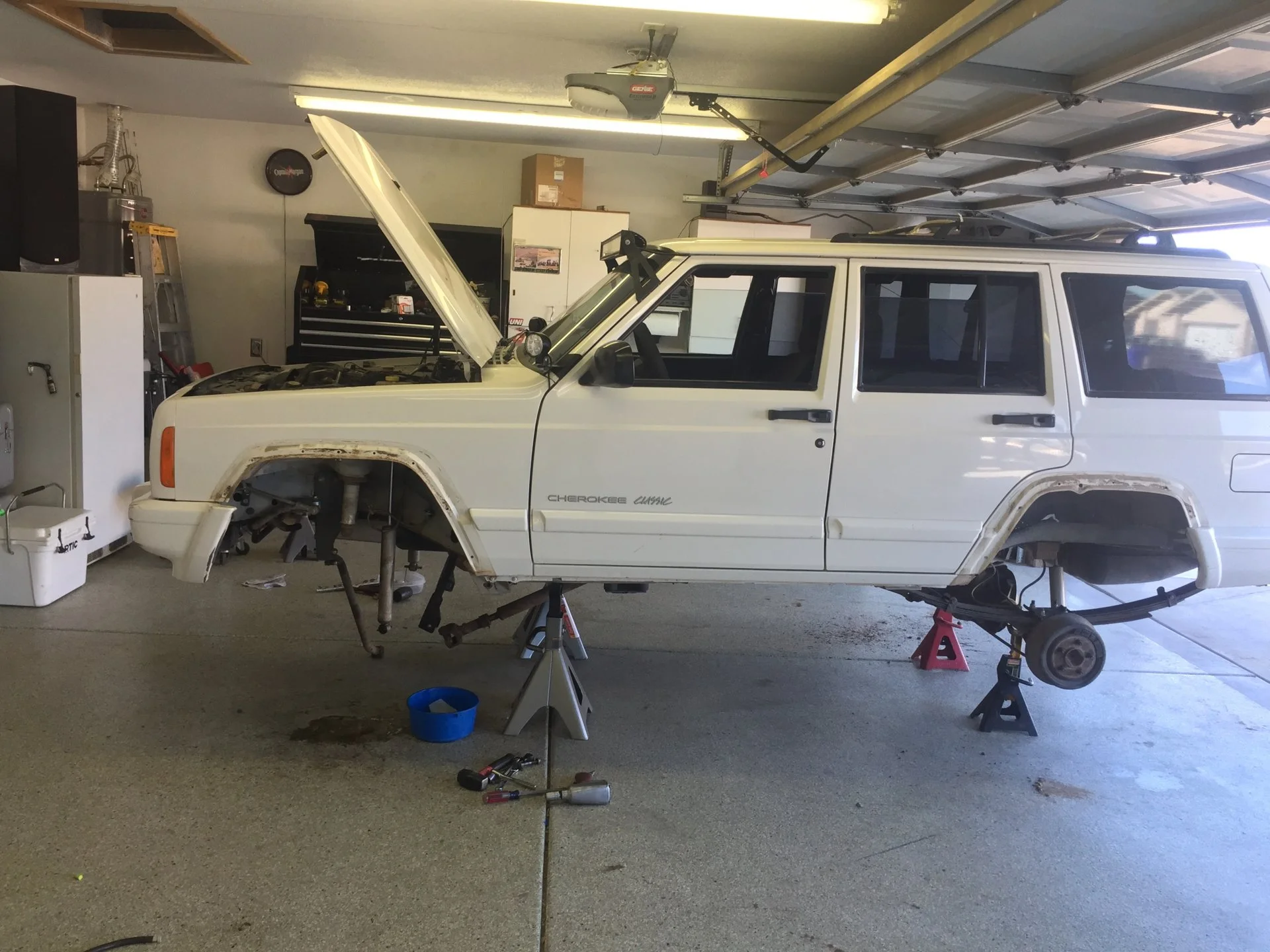

Been around off roading my whole life, this is my first jeep and didn't want to get too in debt building one so i chose the ever so hated XJ. Started off bone stock. now she's running The SYE kit, Adams drive shaft rear, local shop custom front, 2008 Rubicon axles front and rear, front has RCV's, 5;38 gears, E lockers, tubes and C's are gusseted and sleeved and has an ARB diff cover. PSC Hydro assist, home made steering and track bar with synergy cross brace, rear has chromoly shafts 5;38 gears E locker and housing is trussed from ARTEC ind. running 6'' rough country long arm kit with ACOS adjustable spacers. 17'' Spyder lock wheels wrapped with 37x12.50x17 Maxis Bias ply Trepedores. Ive done all the work jabbing and fitting everything on her and have to say she works pretty good. haven't been out a bunch yet but there hasn't been anything my buddy with JK's on 40's can do i couldn't. (not yet anyway) ....
