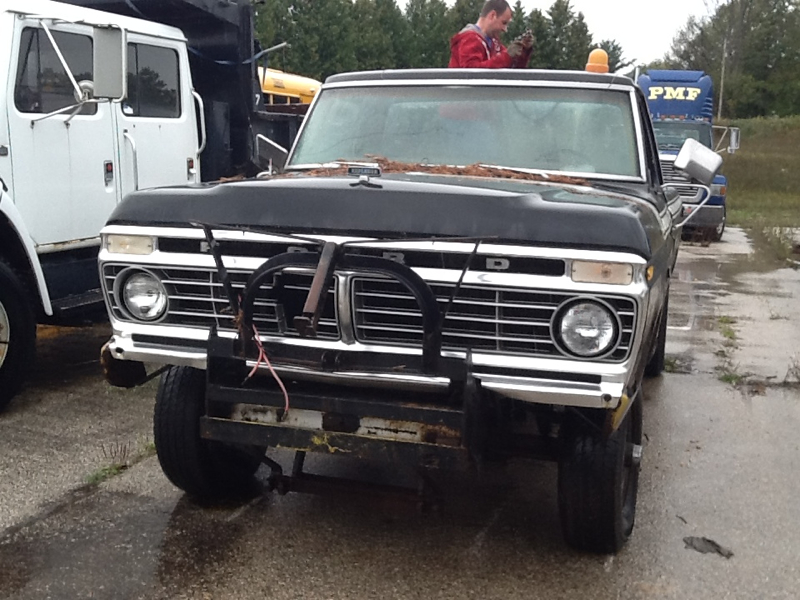

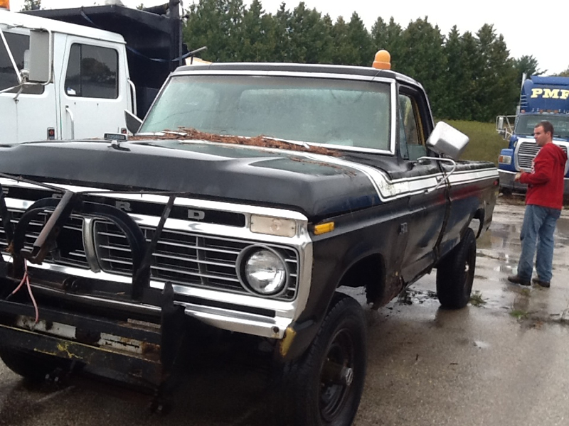

Hey i'm new to the world of wheeling, so i need some advice on a cheap buildup
Those axles are what make the F250 desirable...believe there were some years that had a D60 front as well.

Love that vintage :)
Looks like a past plow-truck to me...that is a hard life to live. Be SURE you check the driveshafts and front axle u-joints...easier to replace now than when they break :)
Determine what axles are in there yet?
Should be d44 , good looking old steel, Woody's right plowing puts stress on the whole truck, it will be a fine rig when your done...L
Figure a lot of work and some upgrades to the axles before you do too much wheeling on 36" tires or above. Also, a lot of that rust can be taken care of with a sawzall if you are not concerned about looks, and your local popo don't mind tires sticking out.

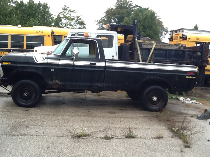

And im going to have to totally redo the exhaust, as you can see by the mufflers hanging down
rotten exhaust is common on a rig that sees limited distance each time it runs...pipe never warm up enough to clear the moisture.

It's not rotten, he just tried to do a duel exhaust, and completely botched it up
