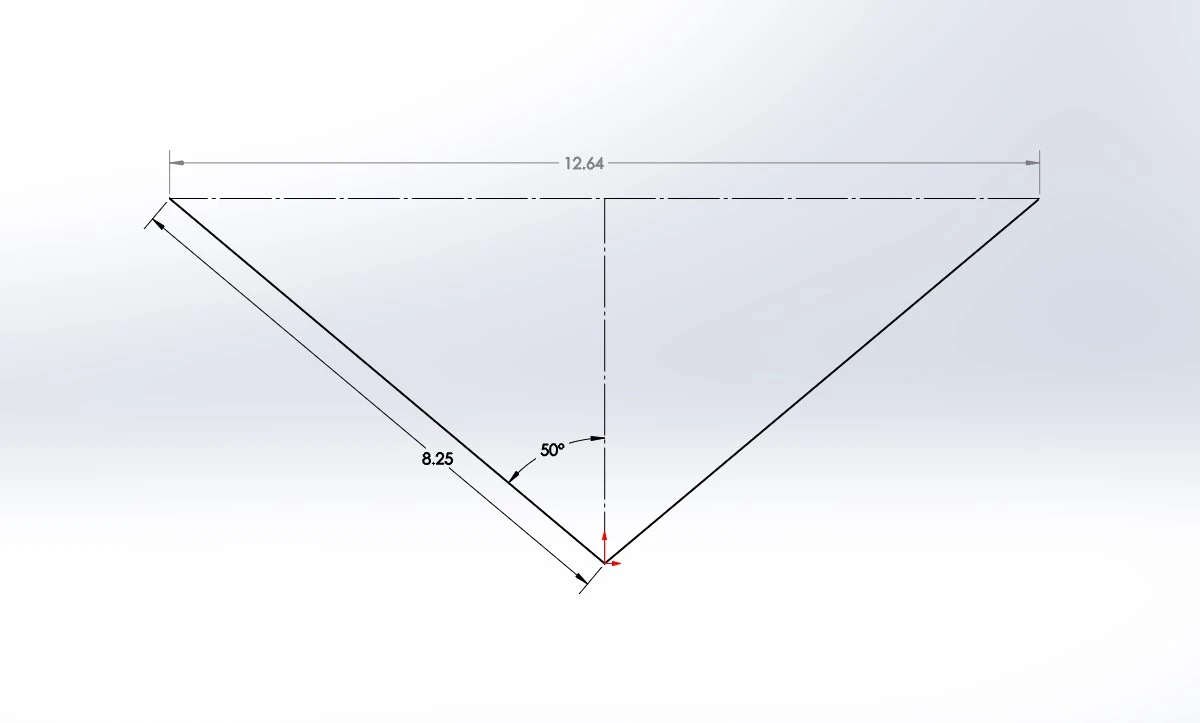

When I originally did all my research on which ram to use to achieve 50 degrees of steering I had seen I would need a 6.75 bj to tie rod hole to get 50 with a 10 inch ram. I ordered the BK steering knuckles for a my f450 stuff because they were supposed to be 7 and I figured that would get me close enough. The problem is they are actually closer to 8.25 from what I measured. Can someone smarter than me tell me what kinda ram travel I need to hit 50 deg with these or do I need something else
Does this diagram help? Only shows 0 ackerman but should get you ballpark idea. 8.25" arm on 10" cylinder looks like 37 degrees-ish. Not sure how correct that is.
Yeah, but its really just a simple sketch. Any CAD program should be able to do. You could even just plot it out on paper, its just easier with a computer.
I will say that its a very simplified sketch and in real life there are a lot more things going on, so that length may change slightly. I'd likely do some more research or try to measure things out before you commit.
