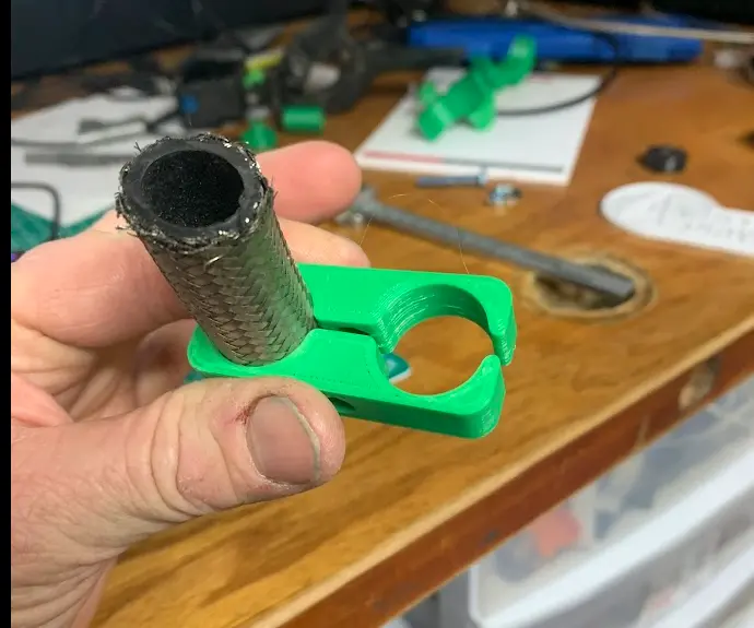

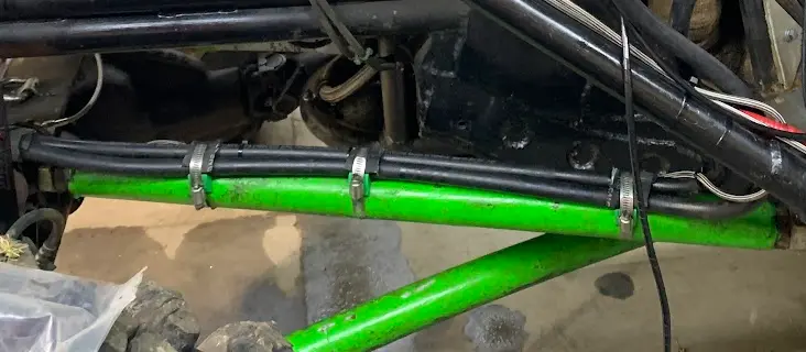

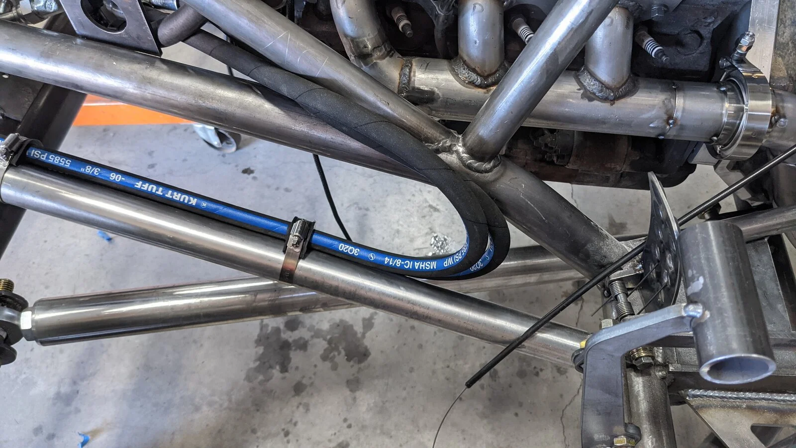

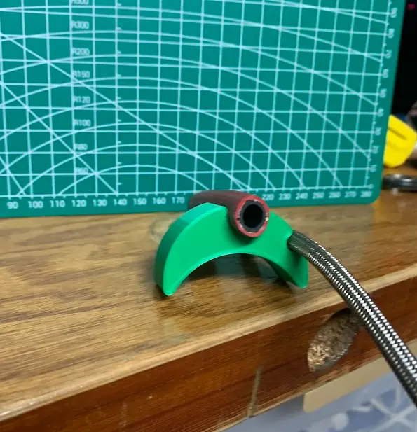

@woody who makes the hose clamps you have on your links?
I've bought those from Poly but also see Trail Gear with them as well. Note the largest size is 11/16" which fits typical 3/8 hose. I use 1/2" and doesn't fit those clamps.
I have also drilled an extra hole in those clamps for my rear to fit both brake lines and air locker line.

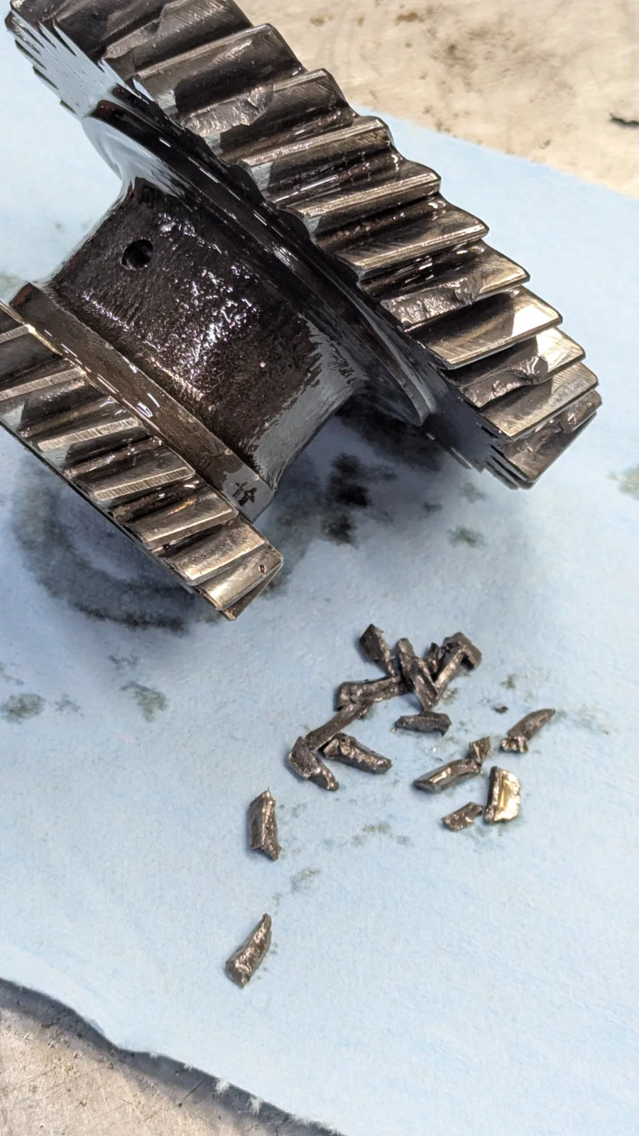

First, I ended 2024 with a junk D300 intermediate gear....my "guess" is one of the set screws for the Midnight case fell out and made a mess. Either way, that meant a new intermediate gear. The shift rods were also tweaked, I had a spare set that were supposed to fix the shifting. In short, they didn't, and it turned into a complete shitshow. I literally had to hold the levers into high or they'd pop out. Beyond dumb.

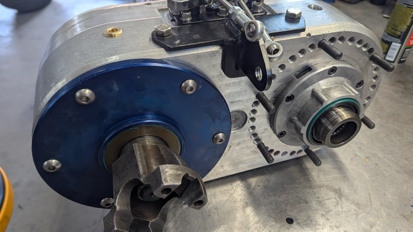

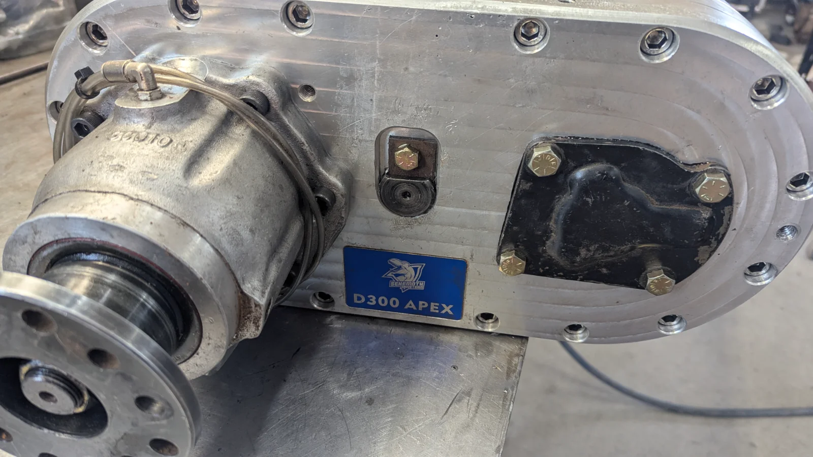

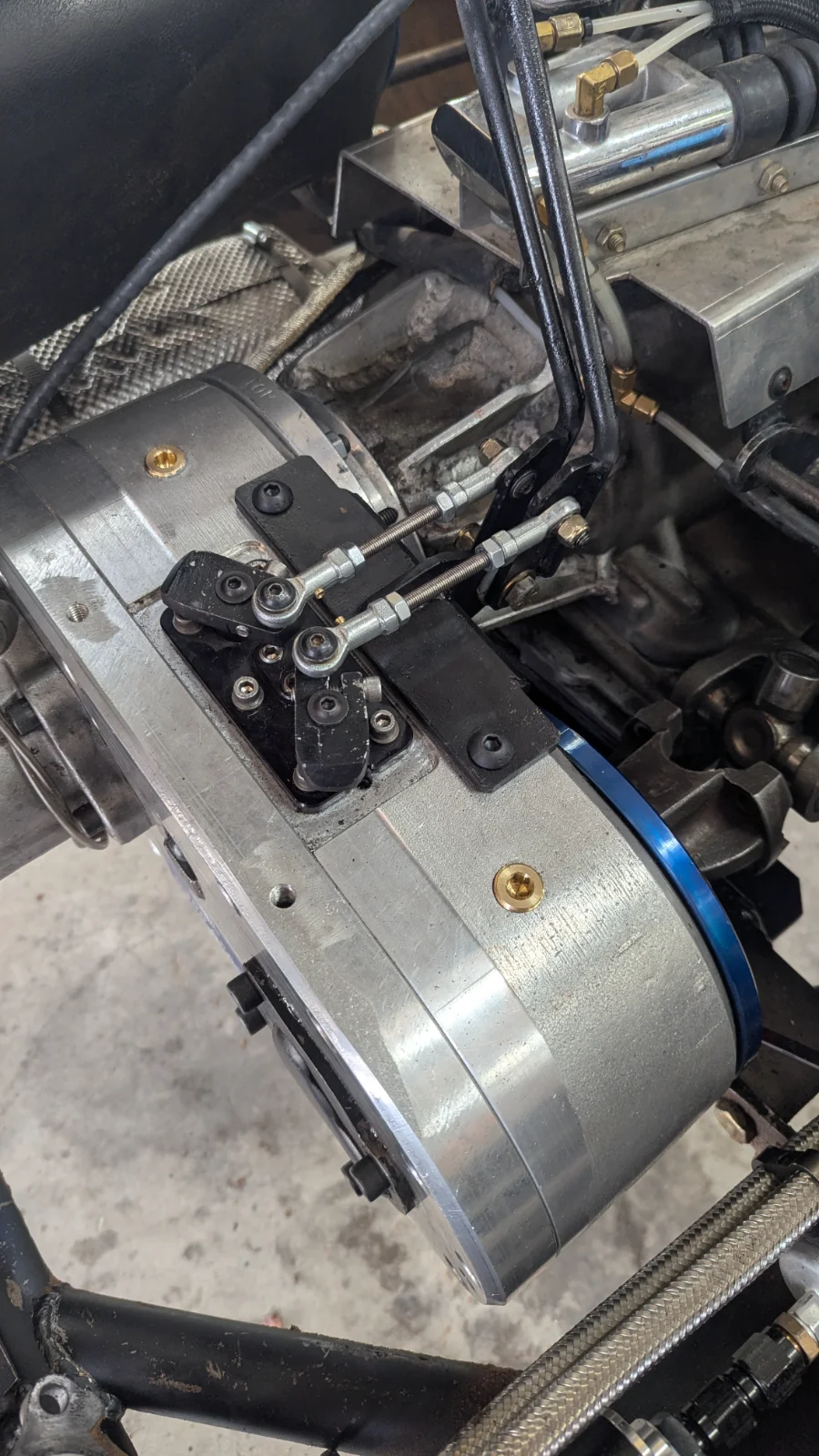

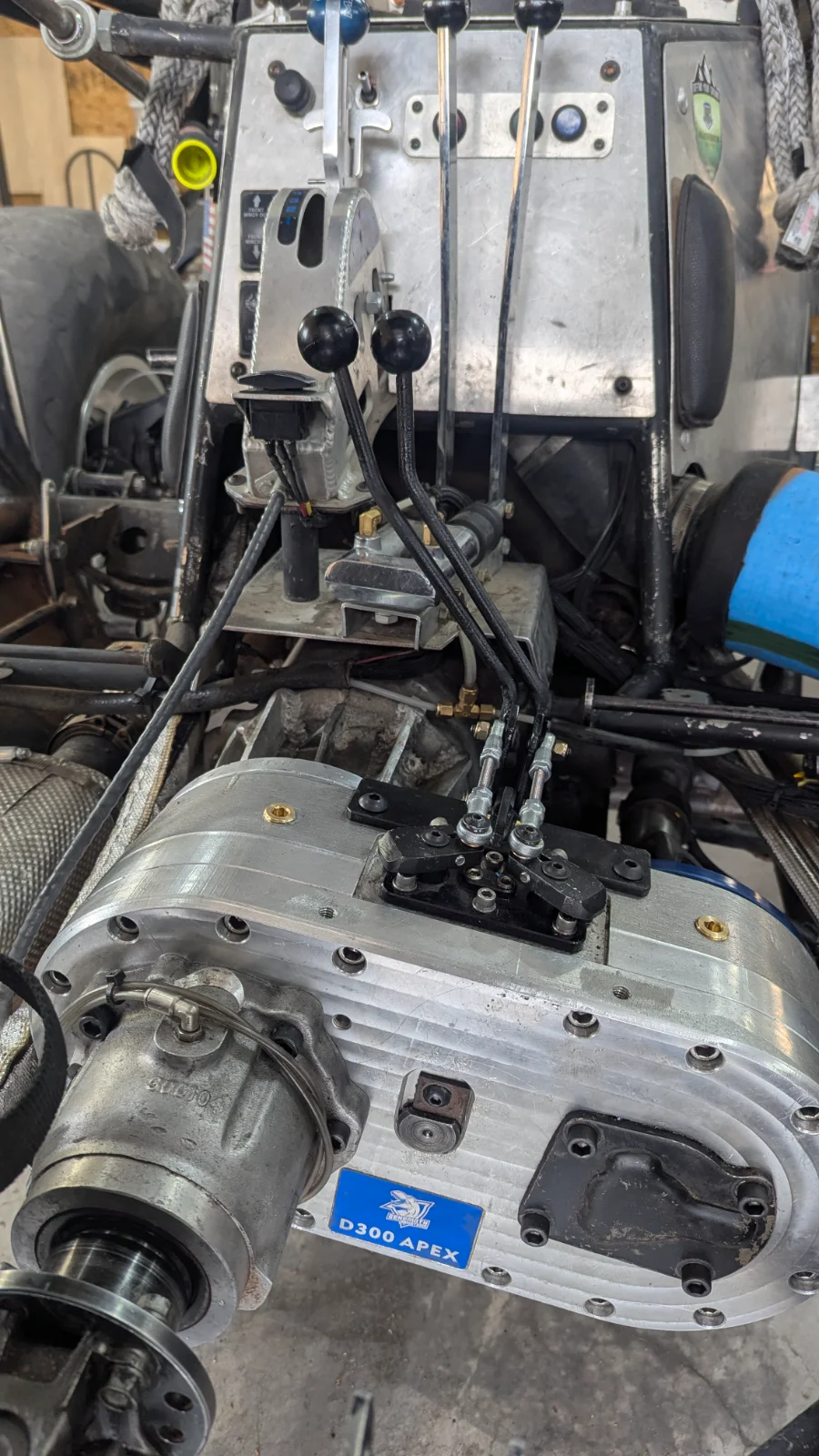

So, screw that mess....I've been chatting with Behemoth at various events and keeping up with their changes/improvements to their billet case...and then they came out with their cast aluminum Apex case AND their updated 32-spline front output shaft. I caved during their intro special, and installed that in mid-April.
I'm now a couple weeks in, and am thus far impressed. Shifting is FAR better. It DOES still bind, but that's unavoidable....but in situations where I expect it to shift smooth (and the MMW sometimes did...) the new APEX does. One continual headache with the MMW was loading on the trailer and then shifting from 4WD to front only....the MMW forever fought it. The APEX had done this simple shift flawlessly, every single time, high or low. On-the-fly neutral to low shifts are buttery smoothy. Zero issues of popping out, front or rear. My only annoyance now is that low is now just like a factory D300 (forward)....my MMW and prior D300 setups had low with the levers pulled back. I'm getting used to it, but still screwing up occasionally. I'll learn...
Oh, and it's quieter. Noticeably. My original D300 and the MMW both "chattered" endlessly at dune speeds (ok, 20-25) but it was super annoying. The APEX does too, but barely. I'm hopeful that it stays quiet, time will tell.

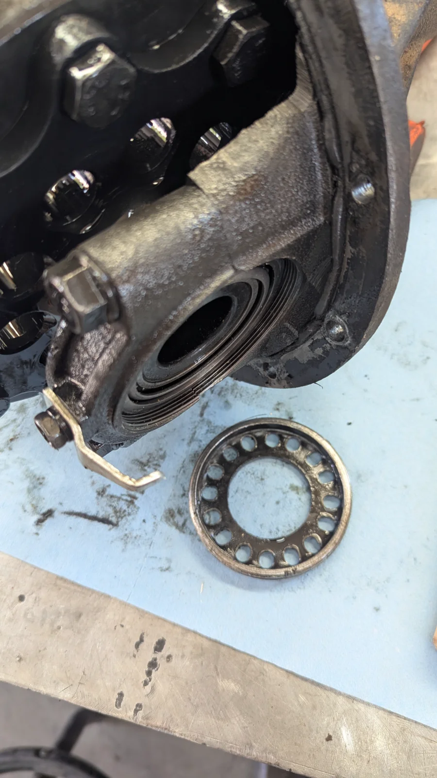

Next up was this weeks fun....finally put my tires on the Monsters Inc exit, and it kept binding....hard. I finally decided to push thru and see what happens....and BOOM. Lost some bits of ring teeth, and popped a side adjuster right out of the caps!! (first junked diff in 3-1/2 years of wheeling) Fortunately, I had a spare set of 4.88's and a 4cyl diff case on the bench, so I built my first ever 8" and installed it yesterday. Tested this morning, and nothing fell out, so we'll see. Backlash was set around 6, and pinion torque about 11. Now to order another spare set of gears so I'm ready for the next break (and decide if I'm gonna stick with 4.88's all around, 5.29's all around, or overdrive.

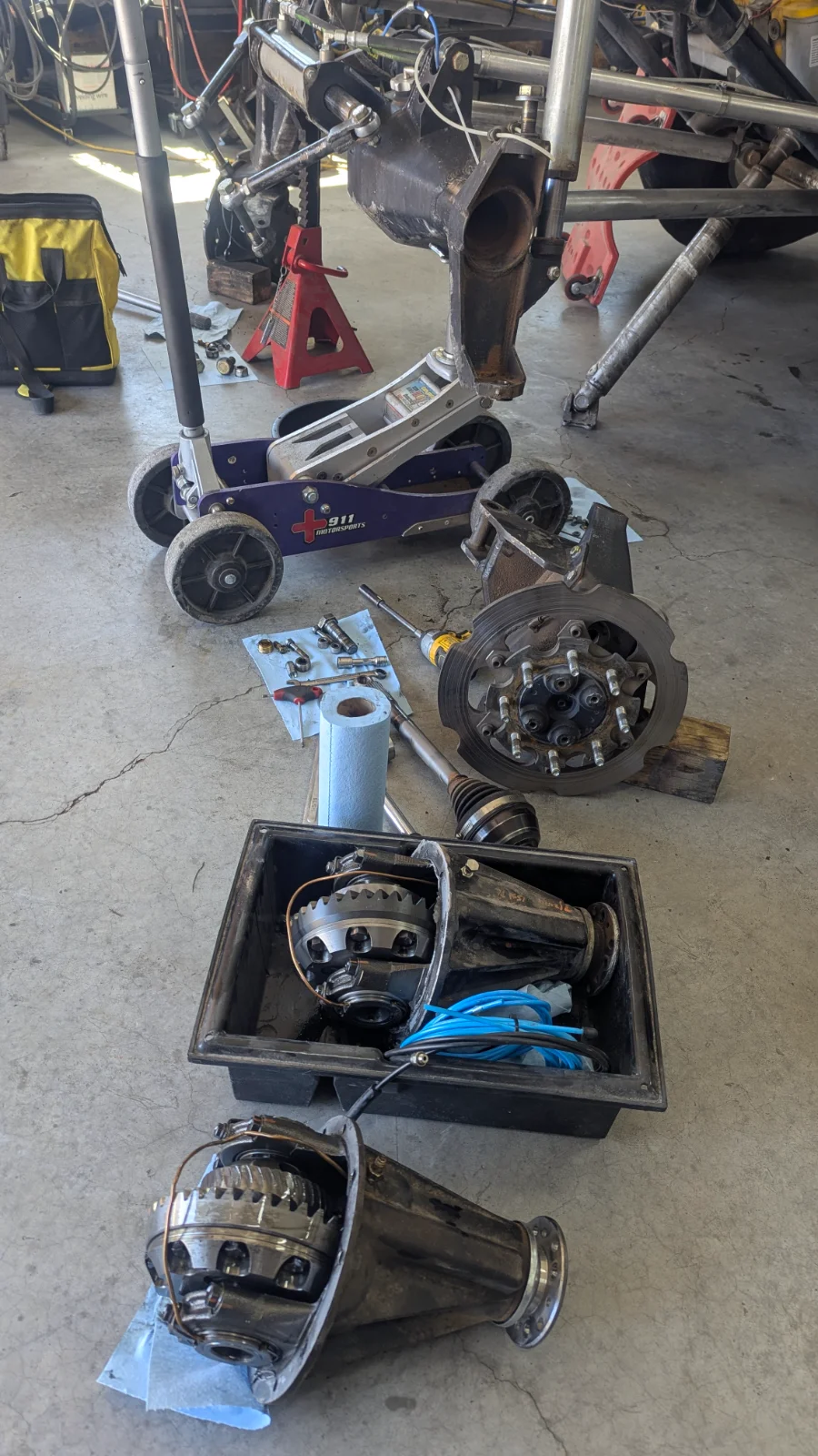

Ironman today in Hurricane/StG, so traffic around Sand Mountain is a disaster ...took me 90 minutes from fully assembled to this pic...next, clean up the housing, seal and soft-set the new 5.29 diff, assemble the balance, then torque and fill with lube tmrw (I like to let gasket maker sit overnight and set up before torquing/filling)

Well, that took less than a minute...literally loaded onto the trailer and had to R-N-D-N-R the shifter to unbind the t-case...on the trailer. It still shifts FAR better than the MMW did overall, but the added bind issues are a given.
As a friend put it yesterday, the only reason to do overdrive is to make your D300 shift like crap. He's mostly right. the benefits to OD diff gearing is definitely there, but unless you are regularly doing death climbs or competing, I wouldn't bother. I'm betting I end up swapping 5.29's into the front in another month or two. (I've been wanting to be overall deeper than the 75:1 I had with 4.88's all around)
OD sucks when grabbing reverse to save a roll, since the rear is now 8% slower, and the front will kick you off the climb that much quicker. OD sucks for side hills, since the slower rear wants to drift down. OD DOES help flatten the front links/chassis on steep climbs, but so does sucking down the front winch. You do need to spend more time shifting into 2WD to help things stay unbound between obstacles (personally, I run front only most of the time)

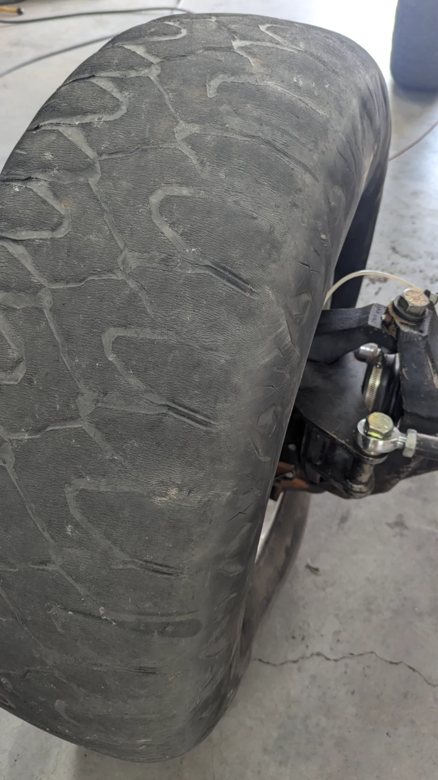

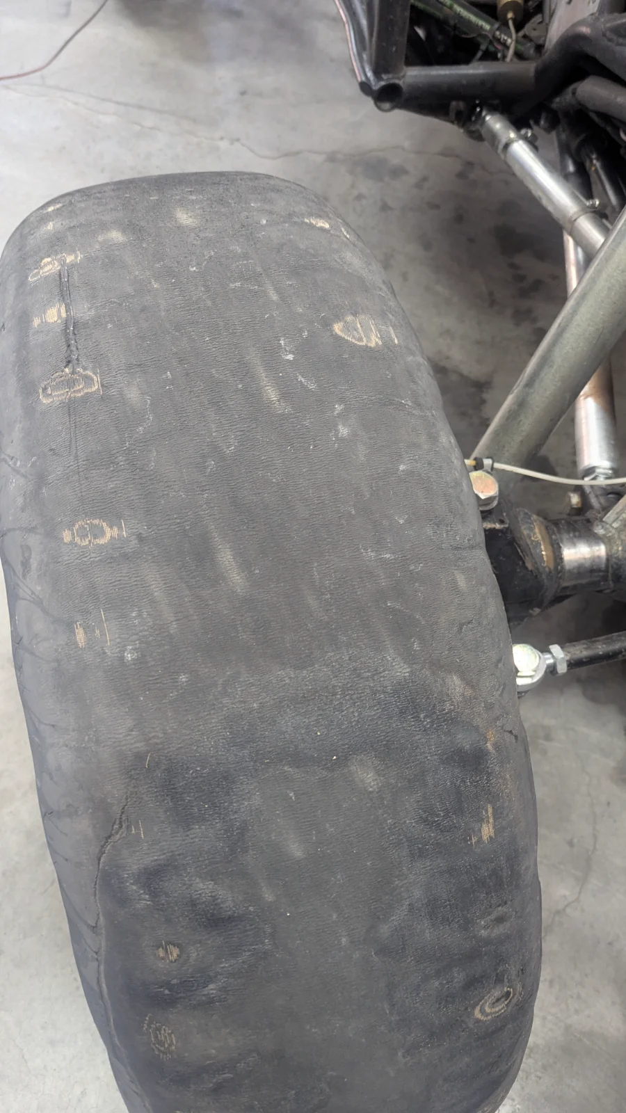

Tire destruction continues....this is the front passenger tire... two layers of cords showing, still not down to the steel belts. Ran portions of Arrowhead, Side Chick, Shotgun, Chain Reaction, MasterLink, Broken Chain, and Joint Effort today (2 hour solo tour) ...this is where we are at until returning from CO later in July.
Tires still work well, tho a few spots would appreciate some tread depth 😁
