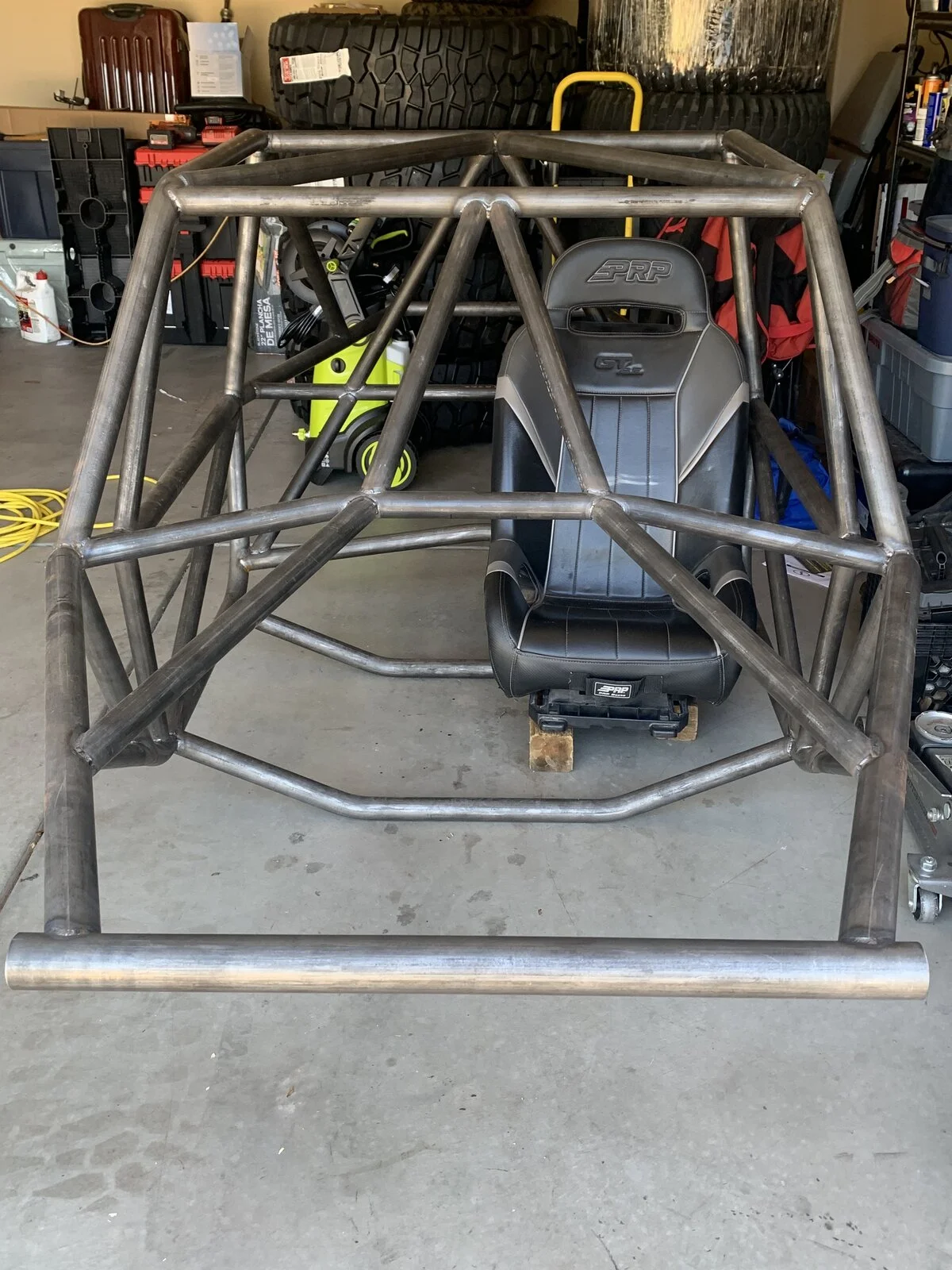

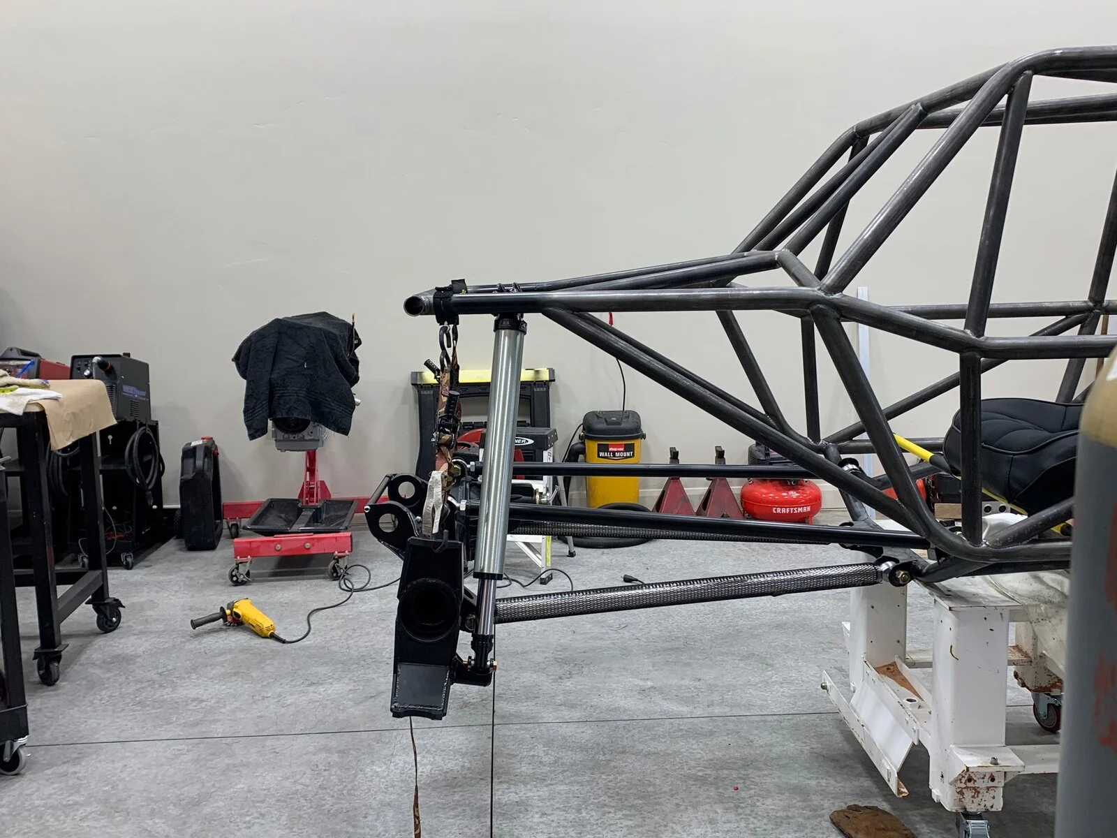

Here is the chassis anyways!
Definitely 2.5 airs...less pressure needed for ride height, less unloading concerns too.
And IMO, find a smaller/compact seat without a headrest...space is a premium.
Ya, Poulsen was convincing me of the 2.5’s as well, just worried about packaging, Kalif said they’re gonna be TIGHT in there.

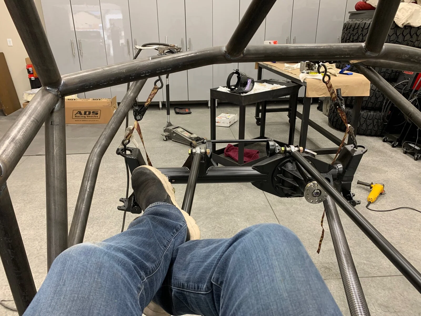

Definitely going to go with a more compact seat. Probably the Roadster. Just had this sitting around and had to sit in the car 😆👍

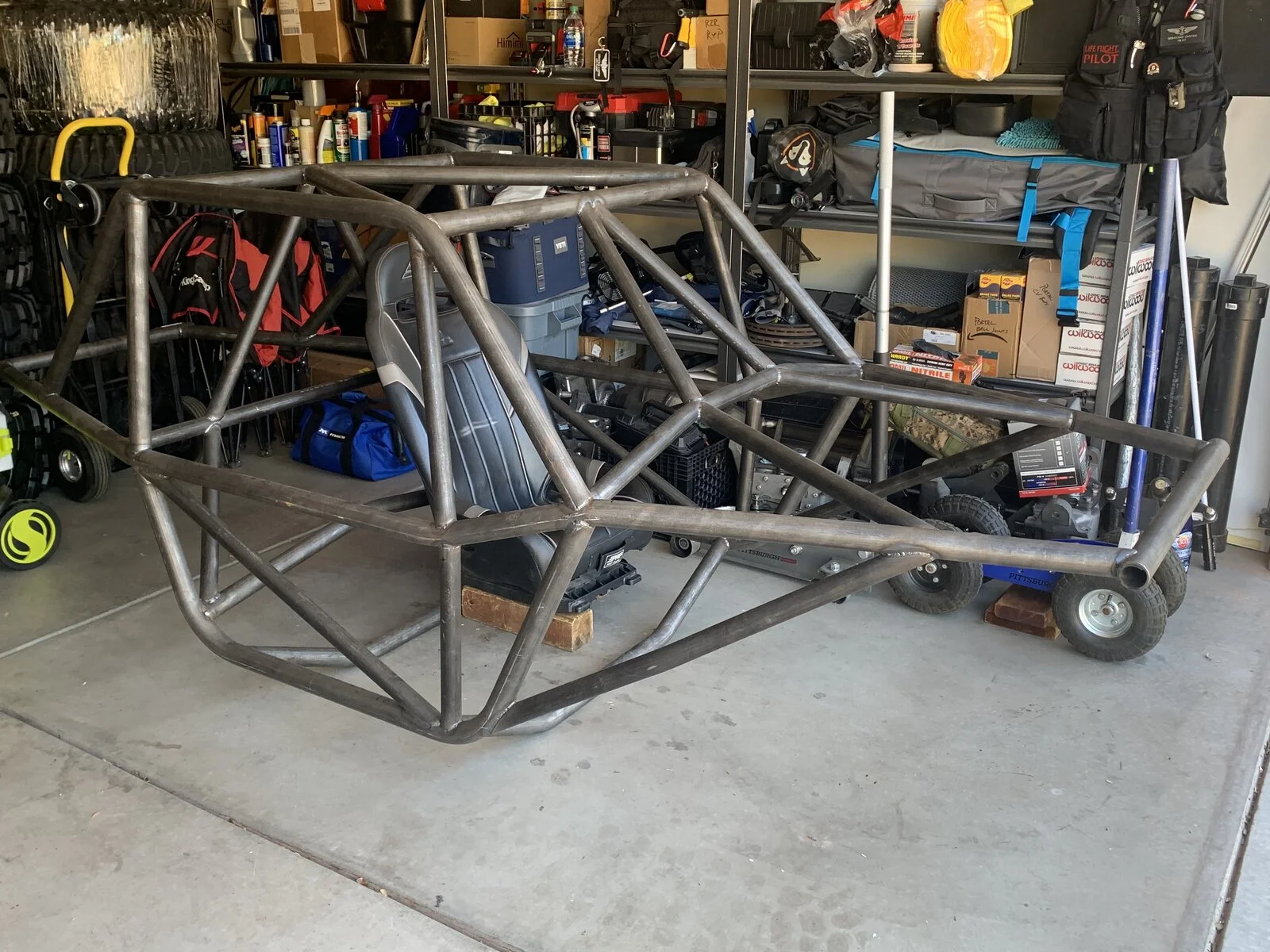

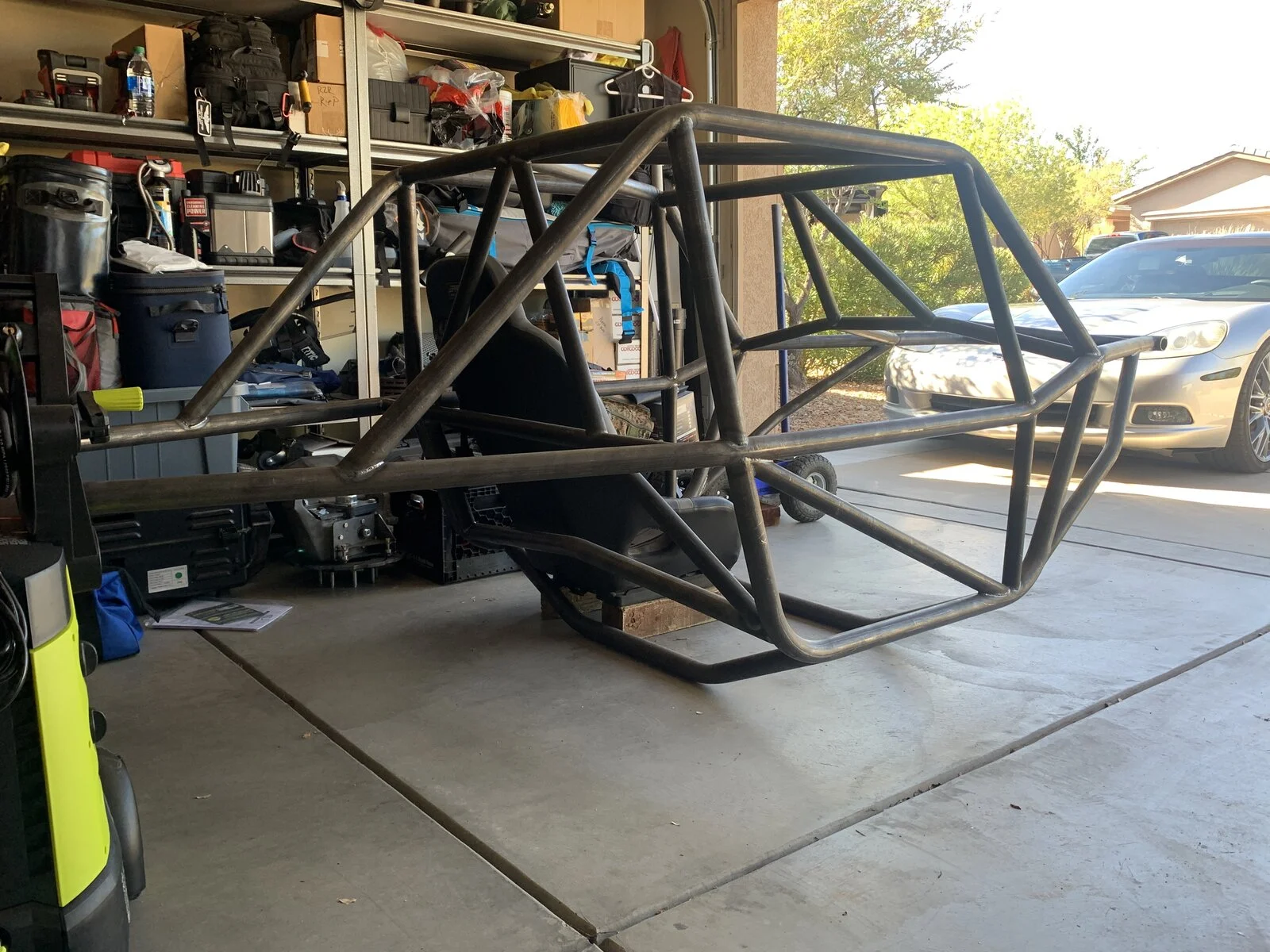

Is this chassis one of his XL version ? The window opening appear to be fairly large. I have a first gen XL and love it
Well the Gen2 is a little bigger chassis as it is (not by much) but I had the roof line lowered slightly so it actually matches up with a Gen1 total height (as I understand it anyways). I measured Brent Jolley's (used to be Jeff McKinlay's) and the floor ro the roof looks to be about the same but the window opening does look to be a little larger. I think that the door bar is lowered a little (reflected in the bend at the A pillar) so it gives a larger opening without making the car taller. I believe the Gen2 in normal configuration is a little taller (belly to roof).
From bottom of belly to top of roof, mine is 45" and the window opening is 20¼" from the top of the door tube to the bottom of the roof tube. What are your measurements?
From A to C (waistline) is 45”
Window opening is 21” tall
Top of roof at B is 66.5. Belly @19”
So 47.5” from top to bottom of chassis

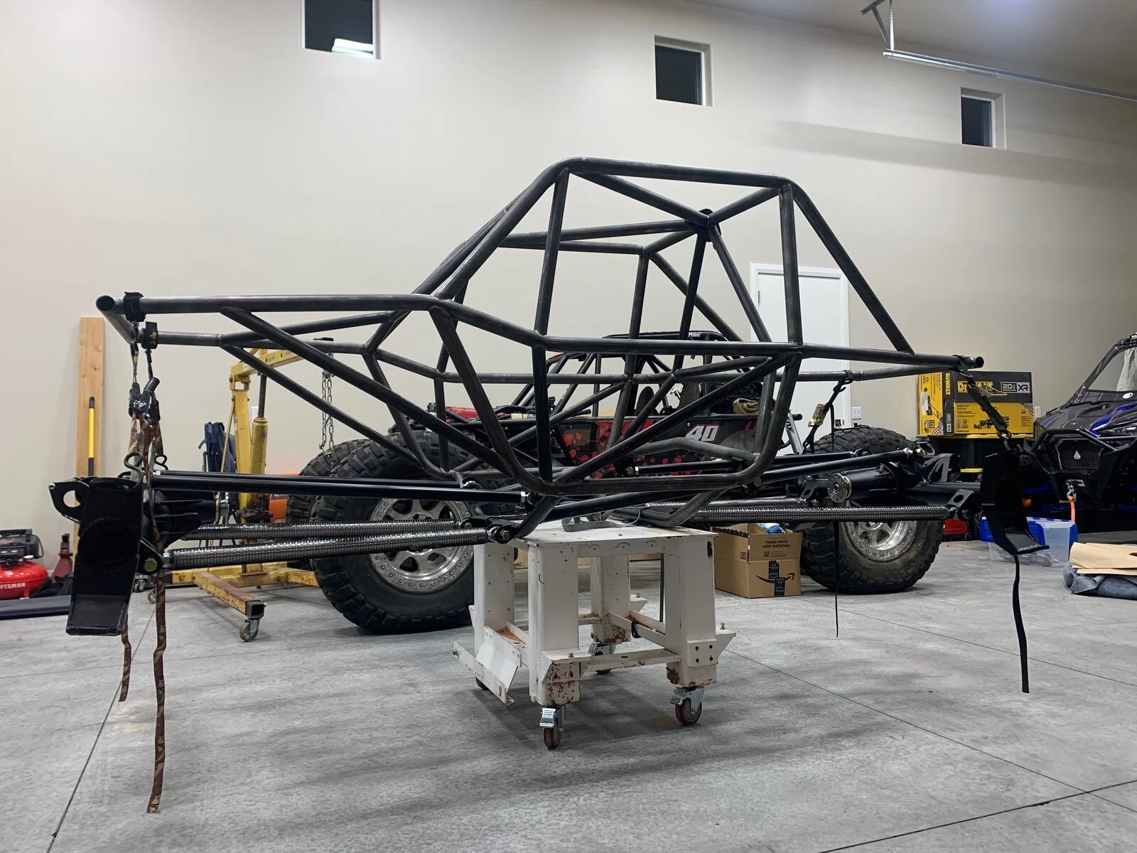

Well, small update...painful wait for everything, waiting on our house to be completed so I can actually get to work on this thing.
Just stuffing parts into our tiny rental house garage for the time being... *rolleyes

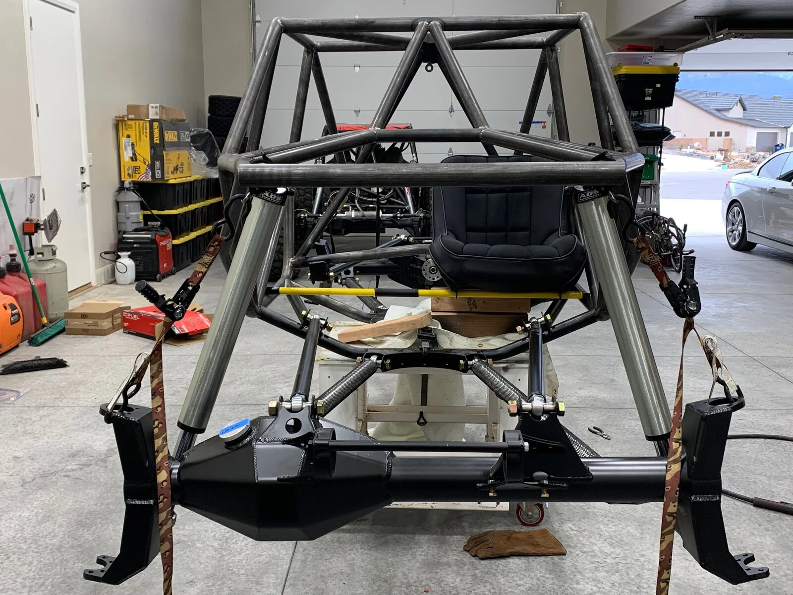

- Got my diffs, thanks to Ryan at Agility
- Went with ADS 2.5 air shocks, got those

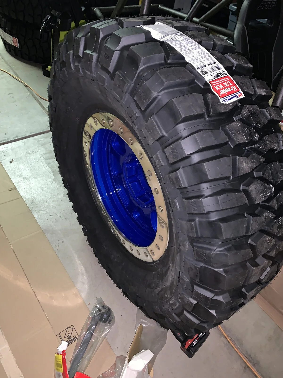

- Got my wheels and tires, powdercoated Illusion Blueberry, thanks to Will at FX in Hurricane for adding the color!
- Got my t-case
Huge thanks to Steve at SHO for the advice and help with getting this build started! I definitely have more people to thank for their words of wisdom and will do so once this thing looks like something to actually brag about LOL!
Update: We ended up delayed on our home so we didn’t even move in till the very end of December. Then, with moving and trying to make my garage a workable space, it’s finally getting going.
Went with the 3.9L LZ9 and 904 with D300. Was a tough decision but it came down to cost, simplicity, the width as well as the fact that everyone I know that runs this combo is happy with it, and the local support around it is huge (much thanks to thanks Steve Nantz, John Hembel, Devin Brandt and others).
No regrets.
Steve Humphrey's engine harness is on the way.

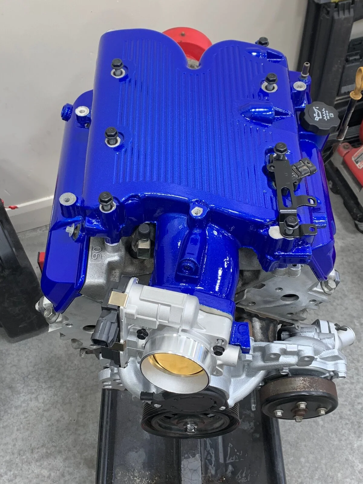

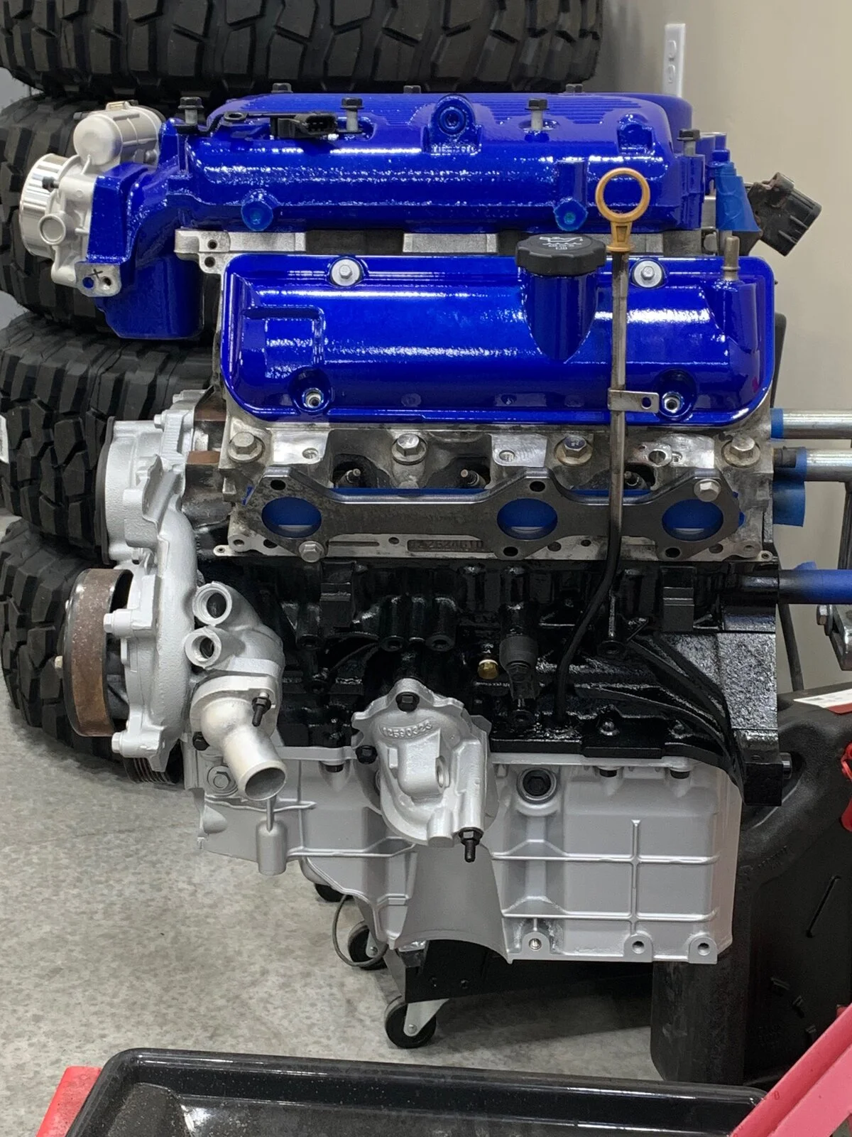

As of now, I’ve got the engine freshly sealed/gasketed and had to have FX Powdercoating lay down some more color on the engine which is almost ready to go in. The trans has a fresh rebuild with a CRT RMVB and billet servo, and the D300 is in pieces getting ready to be resealed with new nicknacks as well as the new AA input shaft and new 1310 u-bolt yokes instead of straps.
The housings are in (thanks for the brackets SHO!), front shocks mounted, and now mocking up seats (Corbeau low back heated).
Inner shafts just came in so I’m ready to assemble the portals with RCV’s and Branik inners.
Hoping to have a roller with drivetrain in it by this weekend.

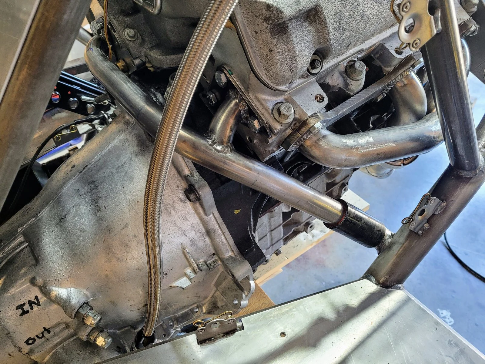

engine looks nice and clean. Whats your plan for upper radiator hose?
Making brackets that bolt up to the heads with a tube coming off from the holes in the heads (removing the freeze plugs), joining the two heads together with a tube and "Y-ing" off the driver side to the radiator.
Here is my rear head crossover from 1.25" tube. I must not have ever taken a finished picture but I added ports for my spal+ fan switch and water temp gauge. If I did again I would add a bleeder port too for burping air but I can crack my water temp fitting pretty easy for burping. I also had the inside coated with Cerekote heat barrier and outside done in a high heat Cerekote the same as my exhaust. Maybe give ya a few ideas to play with.
Nice! Yes, that is similar to what I’m thinking I’ll be doing. I like the idea of having it cerekoted, I hadn’t thought of that. Also a means to burp it, great ideas man, thanks!
