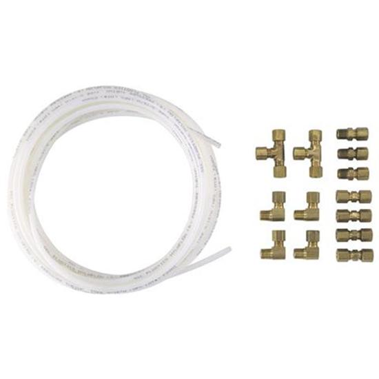

I just ordered up the Speedway kit today....hard to beat $29 for most of what you need. Added in a handful of extra 90's for the cutting brakes too.
Will take one of the straight pieces and cap the end....keeps it available in the tool bag to cap off a line if needed (will have splice fittings along too, but never know)

Going to tap calipers or run a conversion fitting? I assume you're going to run Jesse's brakes as well?
Fitting included in the kit will work perfectly. Added a few additional for the cutting brake setup.
