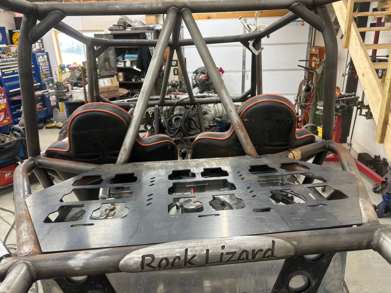

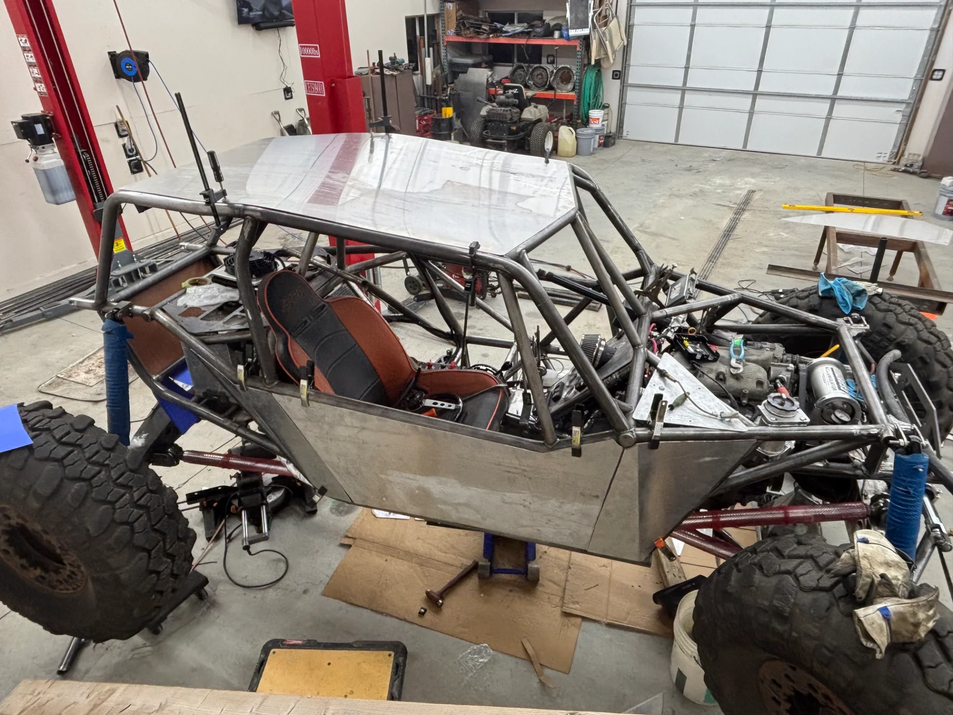

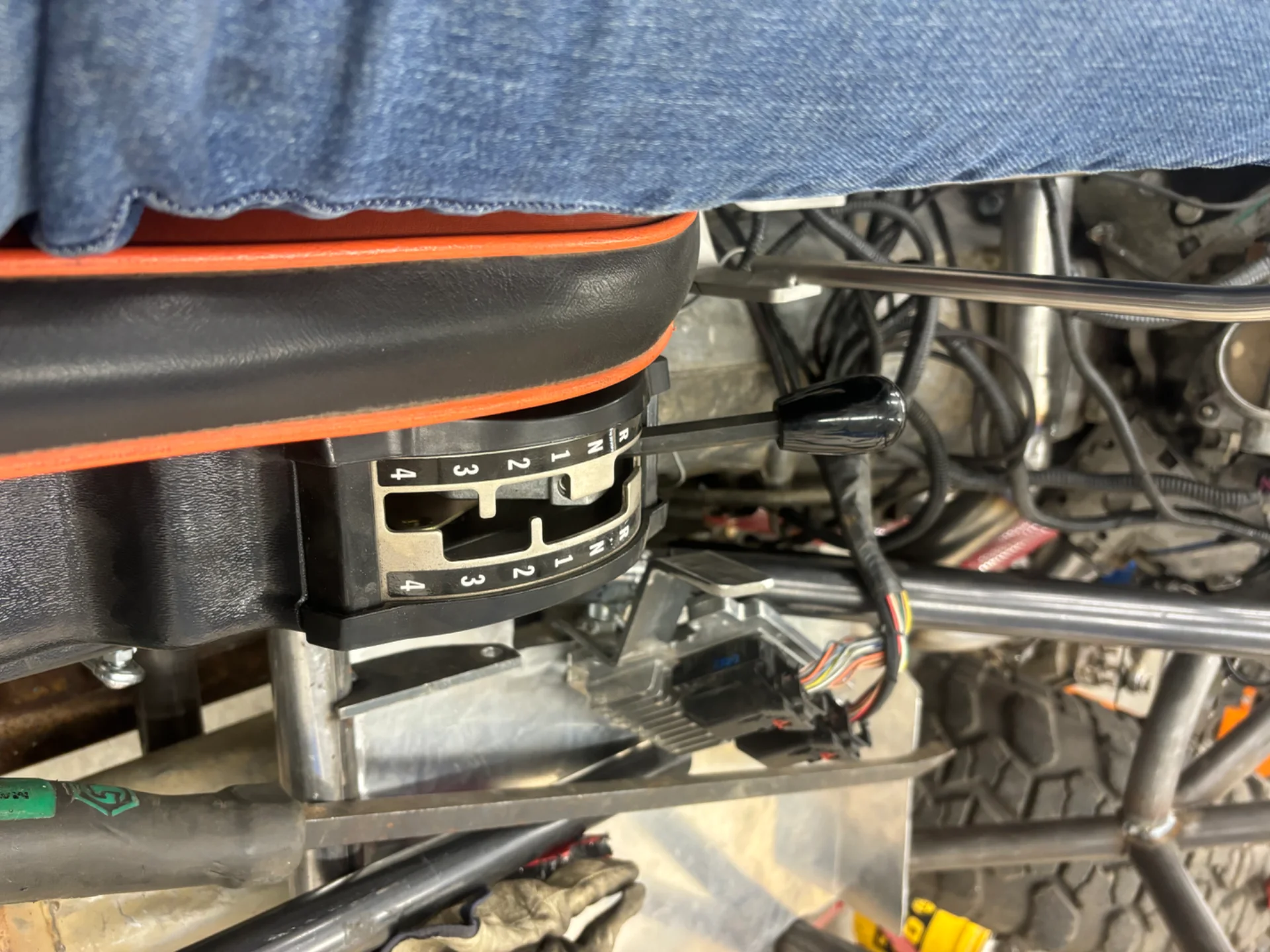

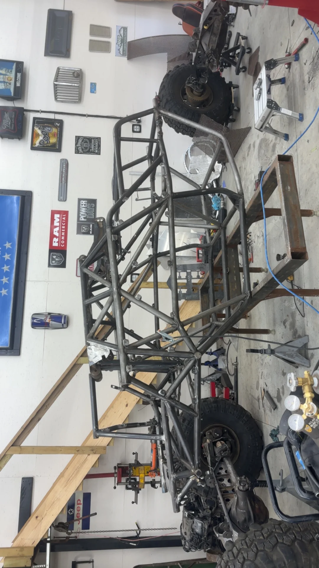

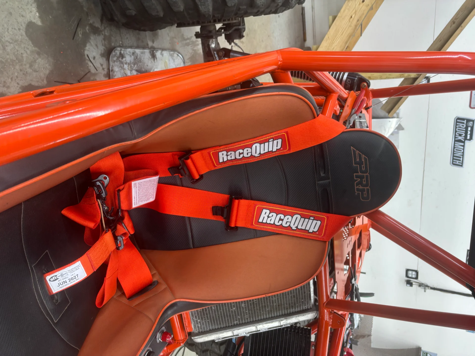

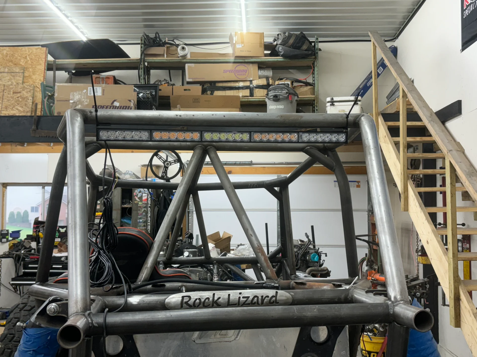

Did you consider notching the seat brackets for the front or rear mount points? Allows you to "clip" the seat in, then bolt/pin the other end for security.

I had that thought. I initially had it that way but didn’t have enough material on the top side of it to make me feel confident in it. I’m sure I could have reworked it but I didn’t. Probably just laziness on my part. I’m sure I’ll pay for it laterDid you consider notching the seat brackets for the front or rear mount points? Allows you to "clip" the seat in, then bolt/pin the other end for security.

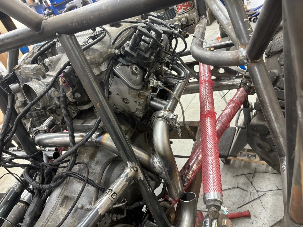

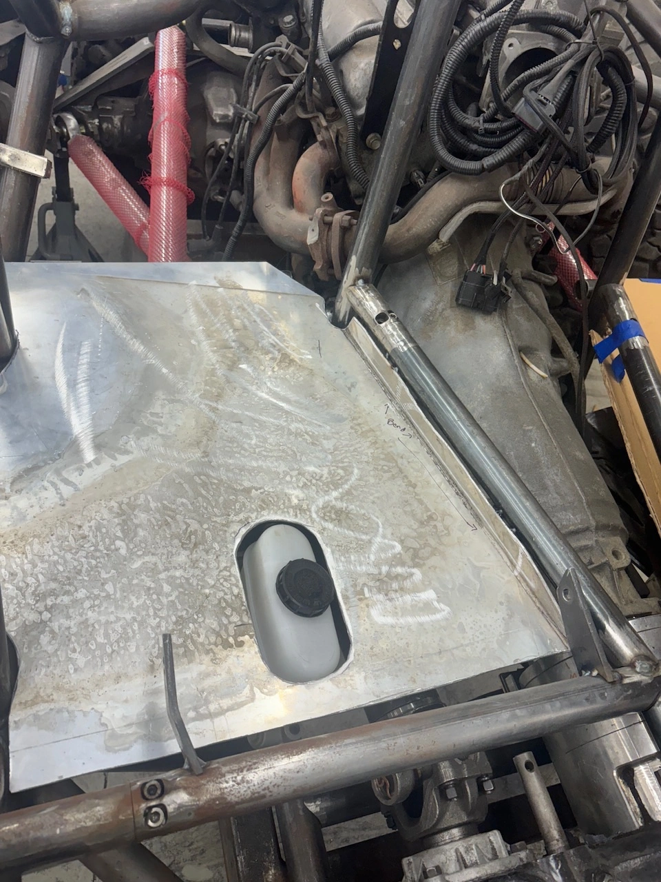

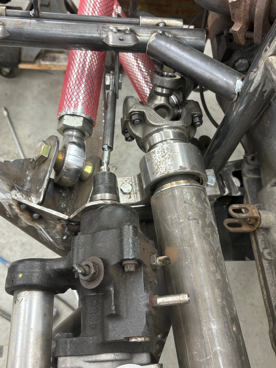

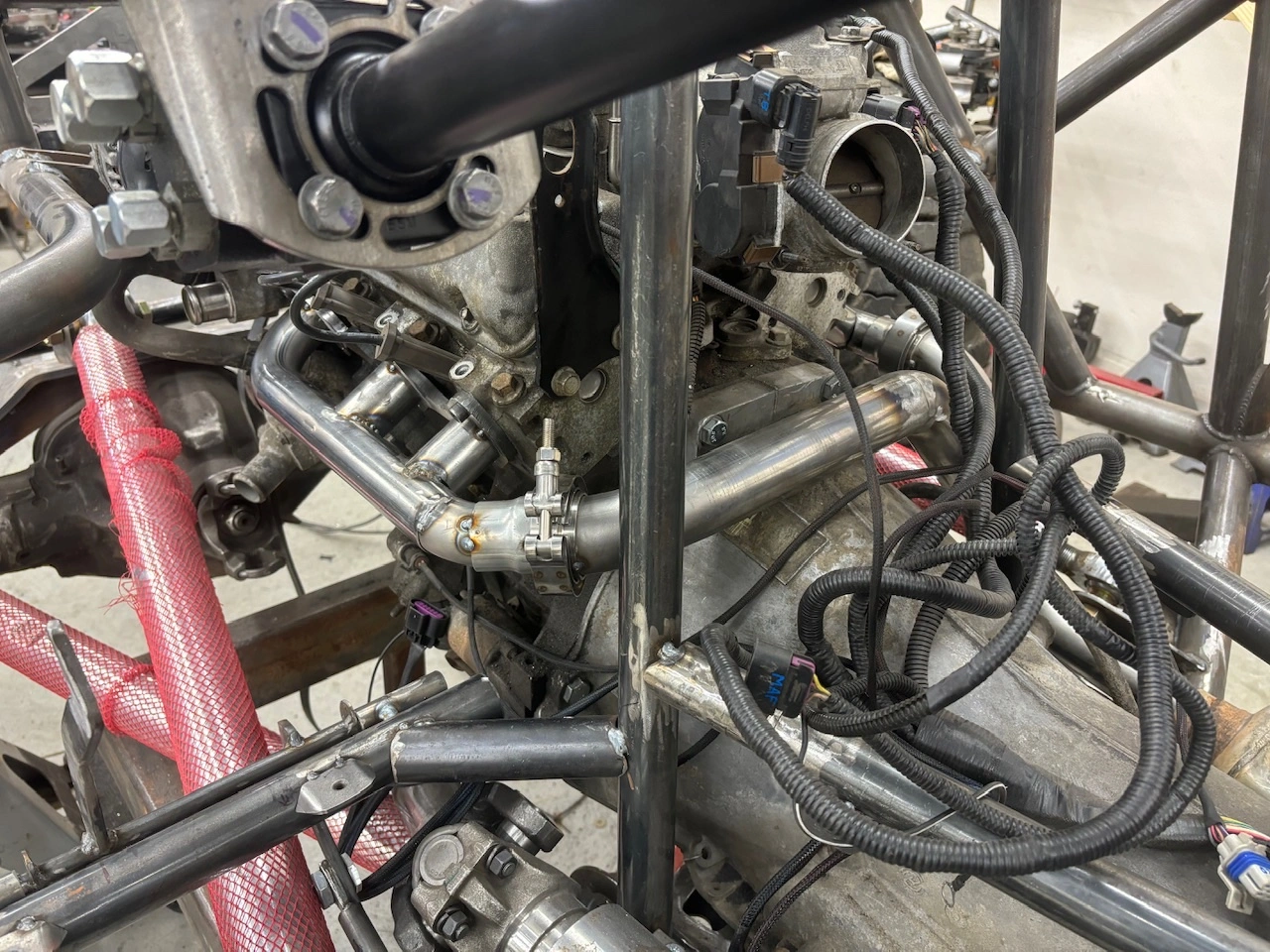

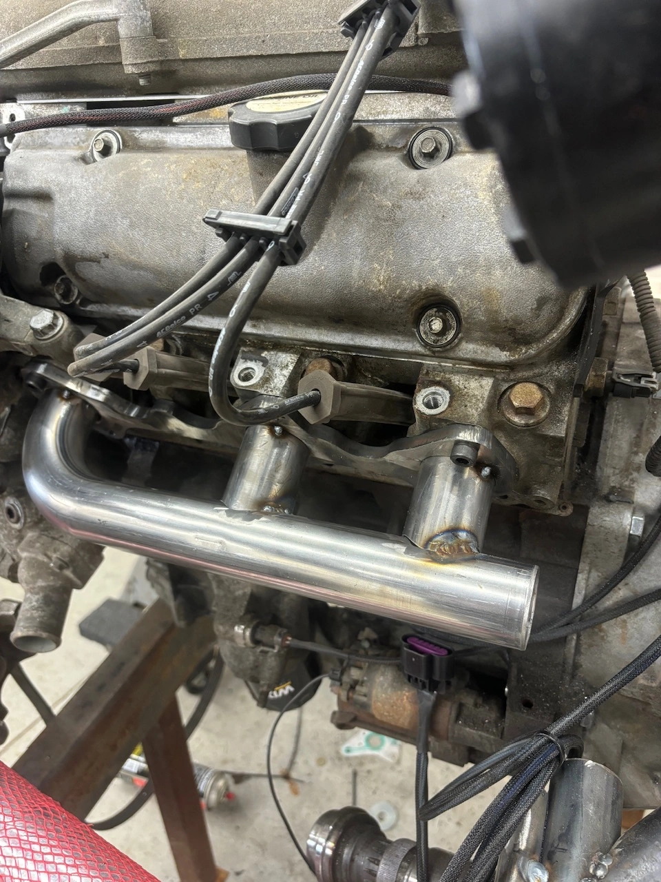

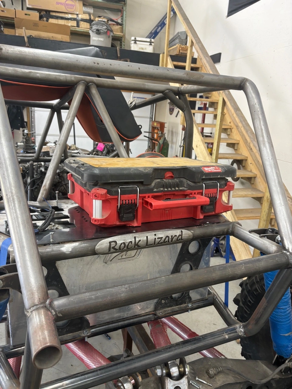

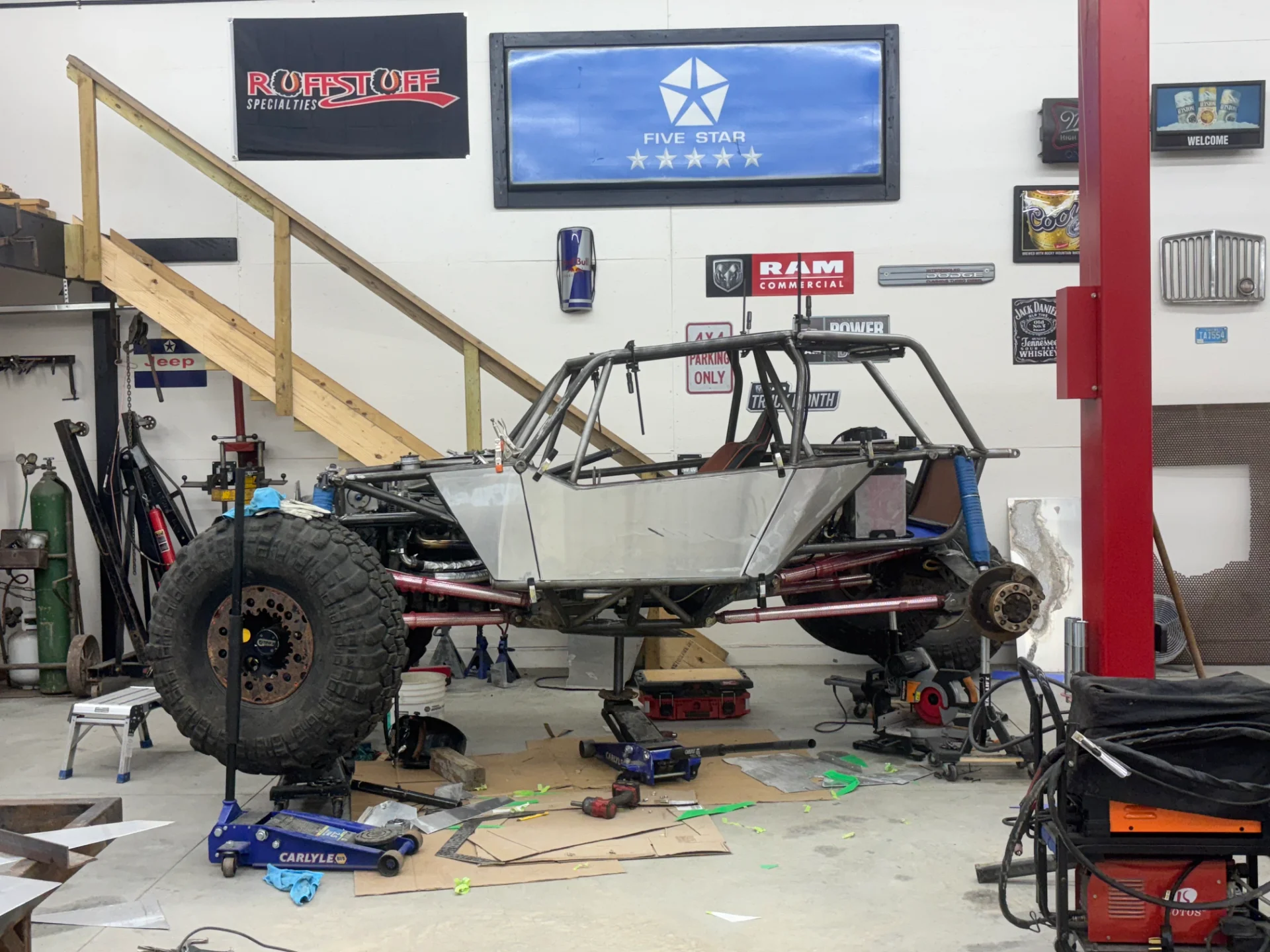

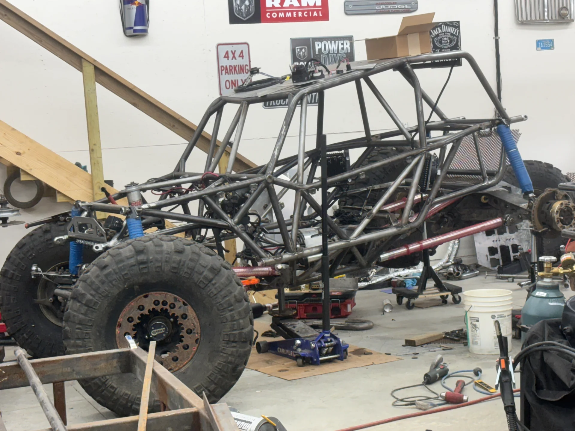

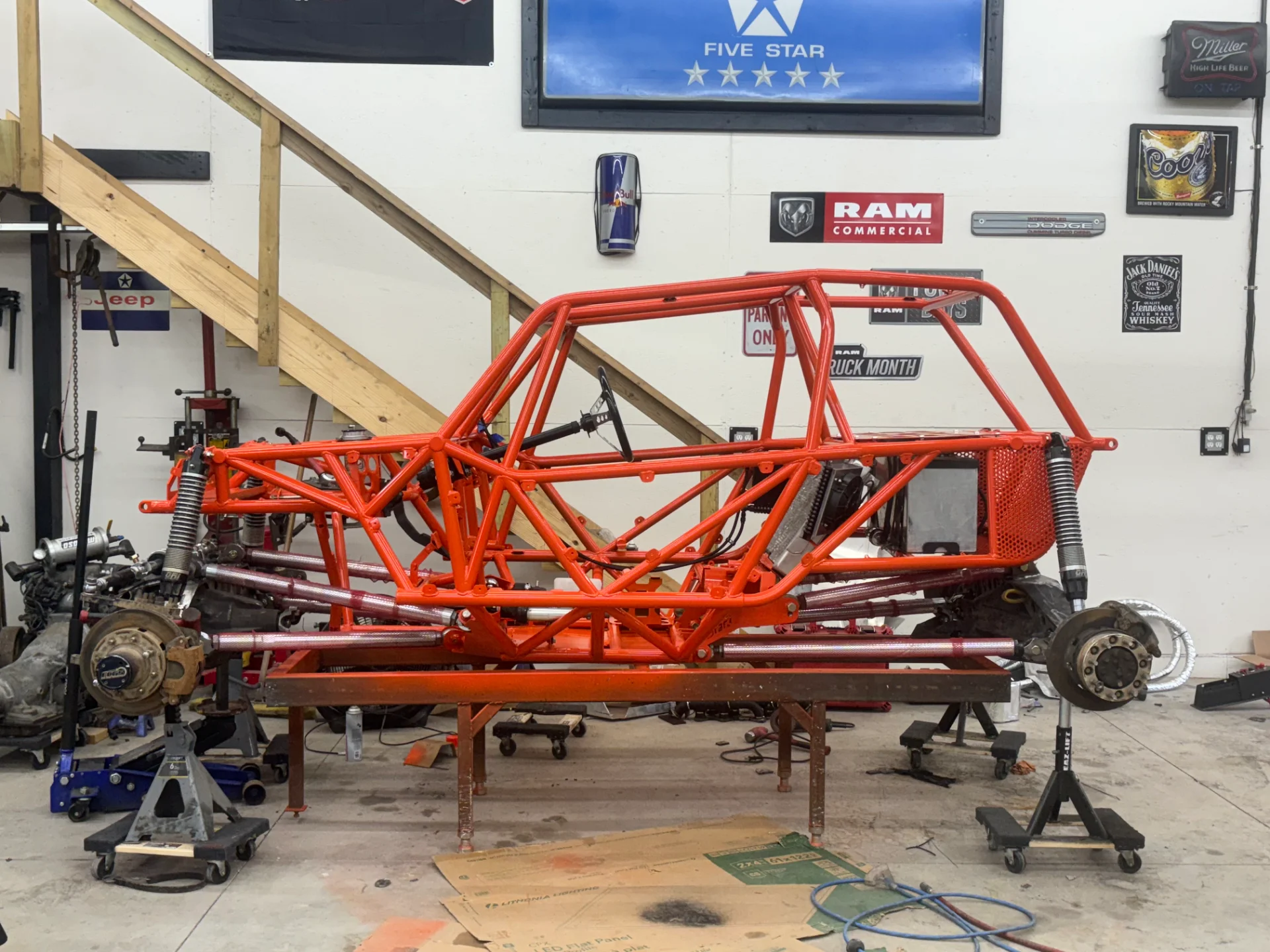

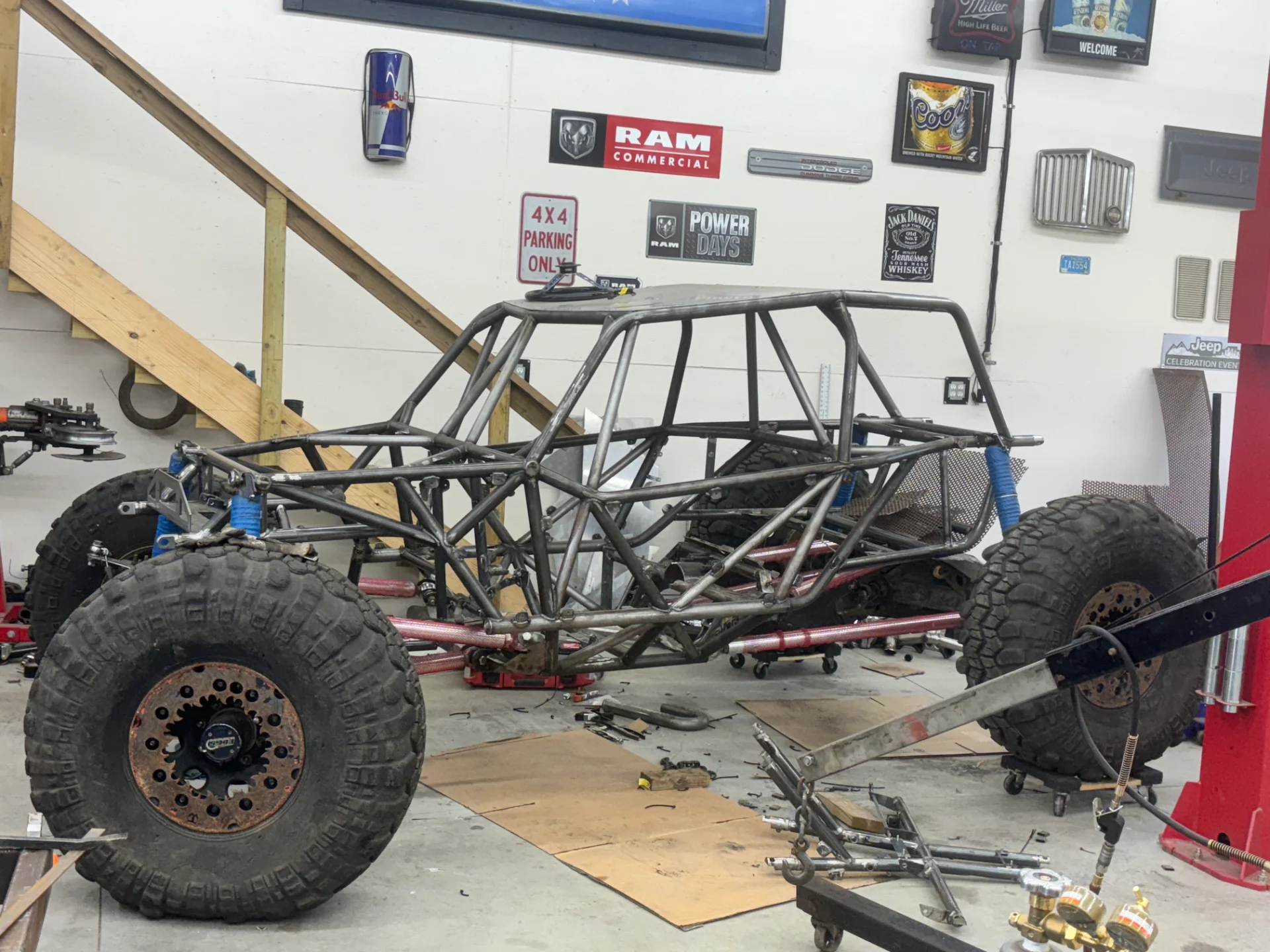

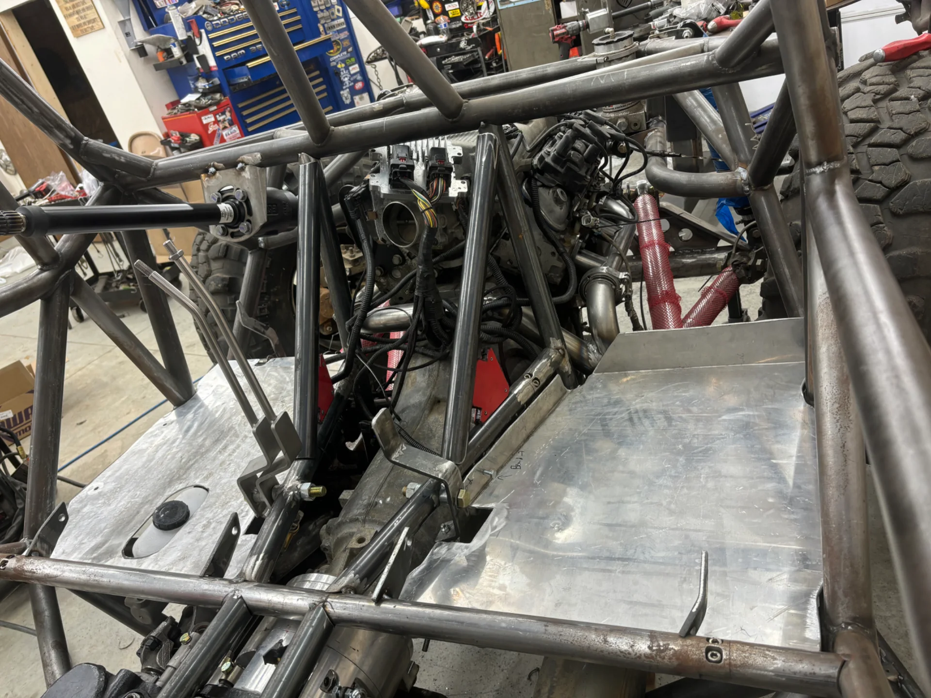

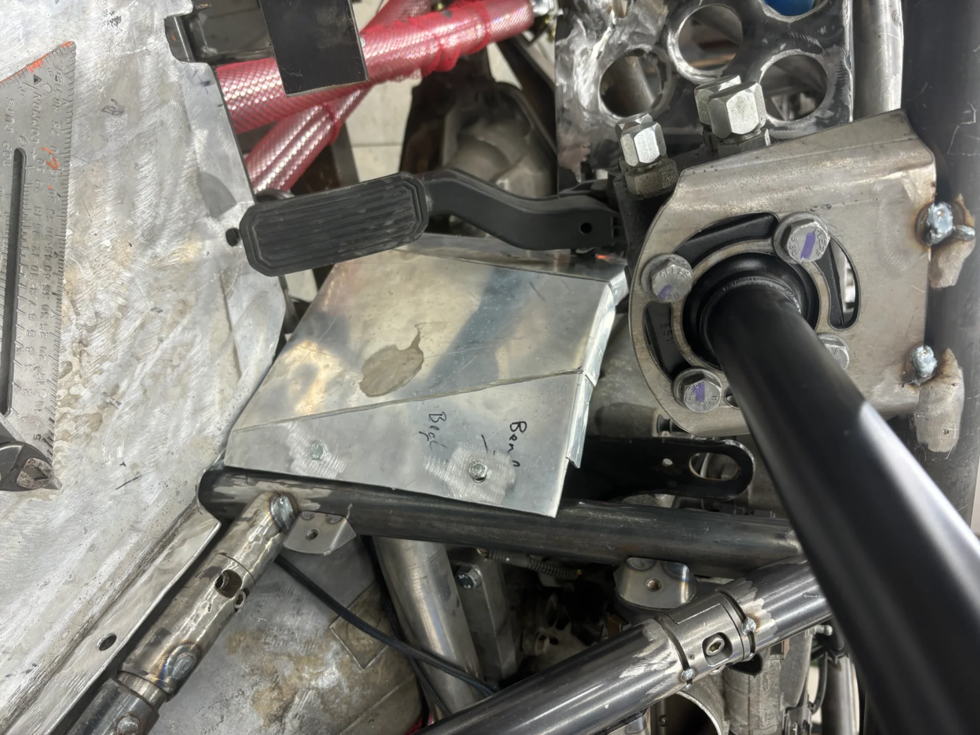

More headway. Brake pedal built, floor pans on both sides. Exhaust manifolds an a crossover pipe. Fuel cell in and pump changed so my pressure is correct. And last but not least a pack out / cooler mount.
They are handy as can be. I also modified my seat mount a little and use a 1/2 inch detent ball pin to hold the inside corner. Locks it in solid and makes it much easier to take out!Packouts for the win, I'd like to add that setup to mine...someday....

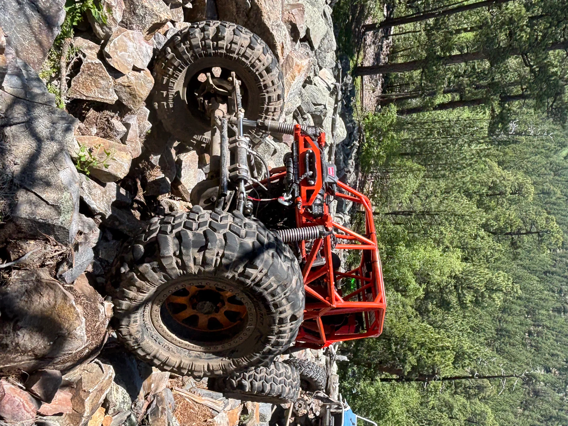

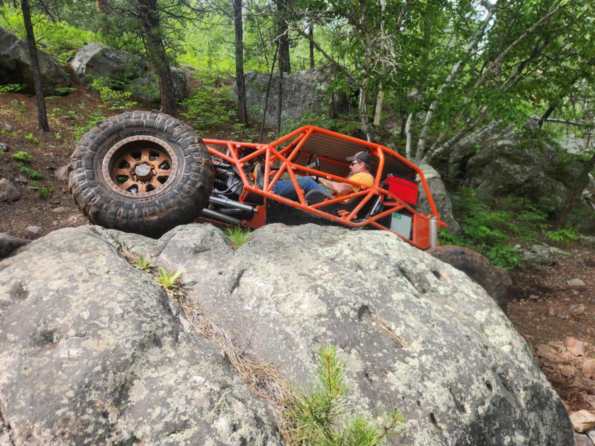

Glad the rig is working well!MidwestGotta love those E coast rocksGlad the rig is working well!

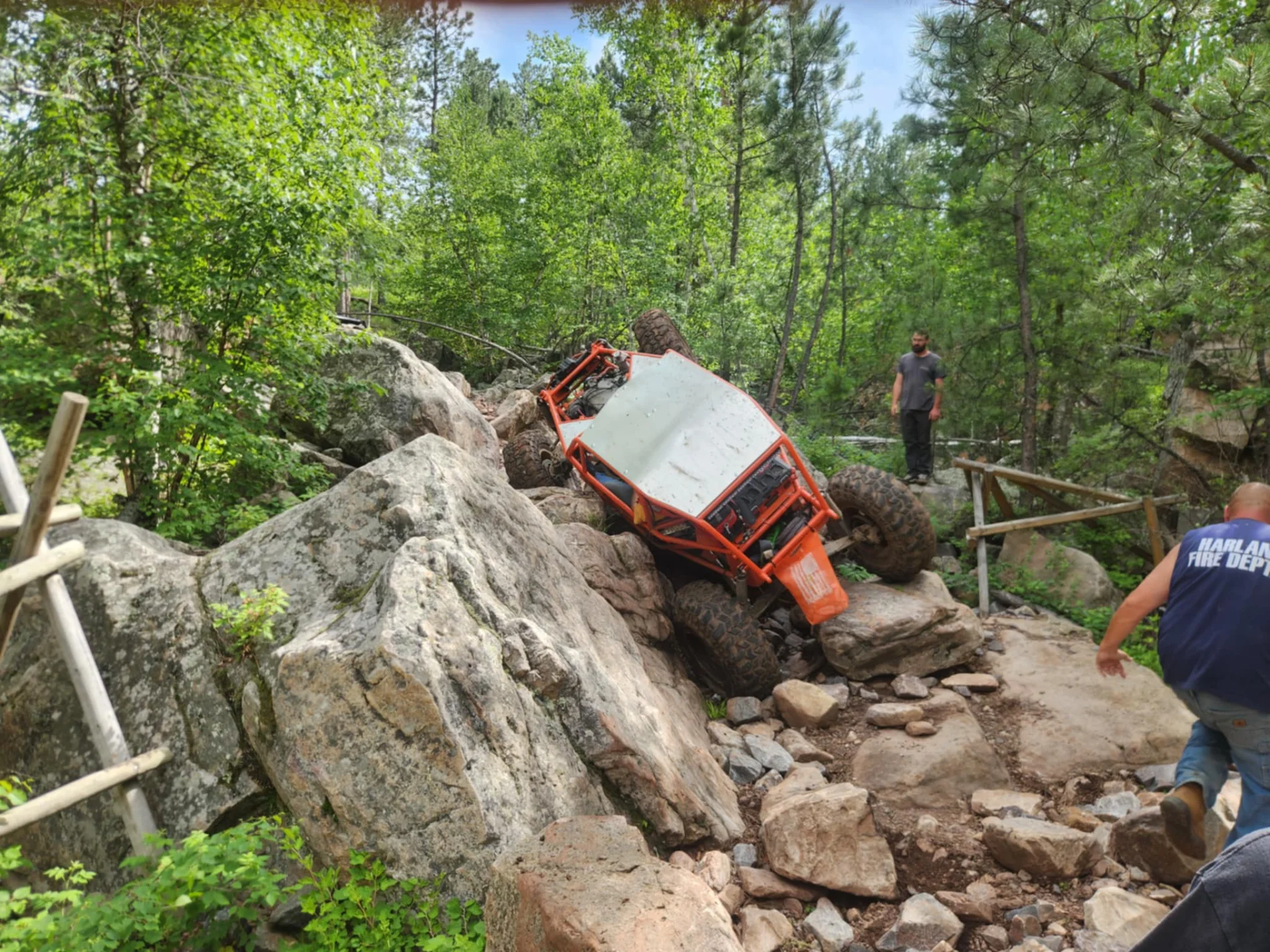

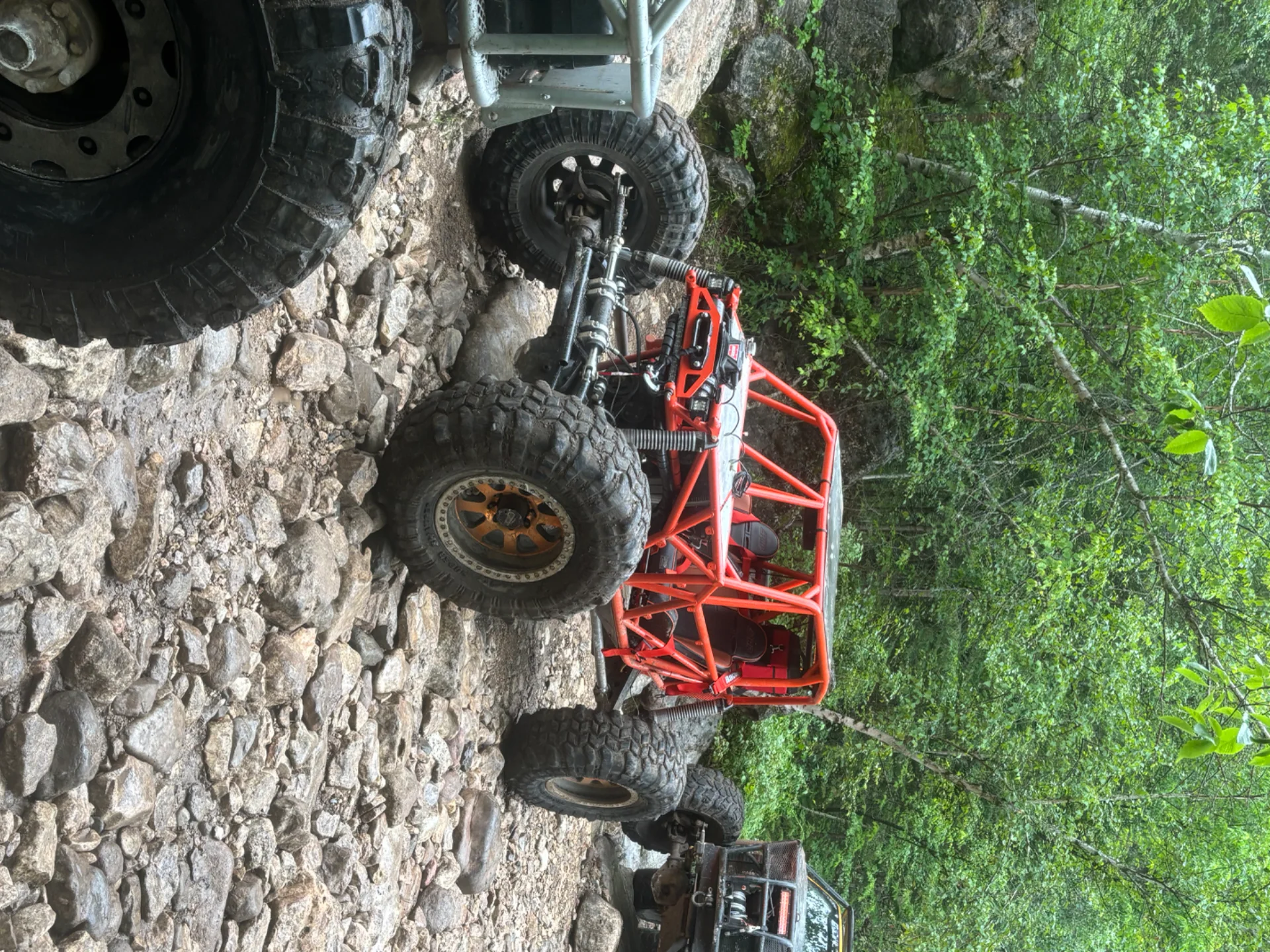

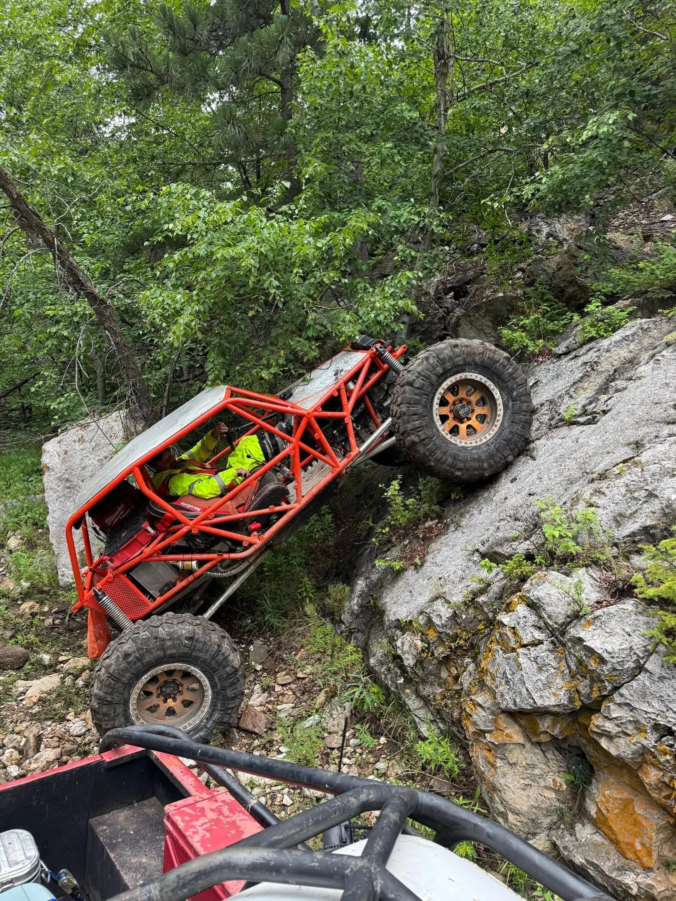

Yes. First time on Captain. It’s legit! We ran about a quarter of it and my buddies fuel cell ruptured at the seam. Will definitely be back.Looks good. Looks like Captain and Fruity?
