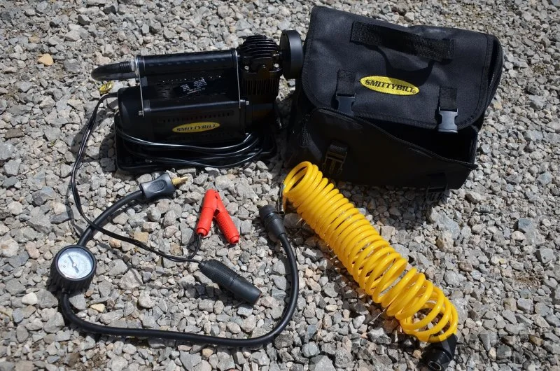

The Smittybilt 2870 is a nicely designed kit...the compressor has an insulating handle (which is cool enough to hold even with the cast fins are 250 degrees)...the base is double-isolated for vibration...the coiled yellow hose can be bypassed for short connections...the air gauge is at the chuck end (where you are monitoring the tire pressure) and includes a pressure release on the back....considering the MV50 compressor I also have, this was definitely an improved design.

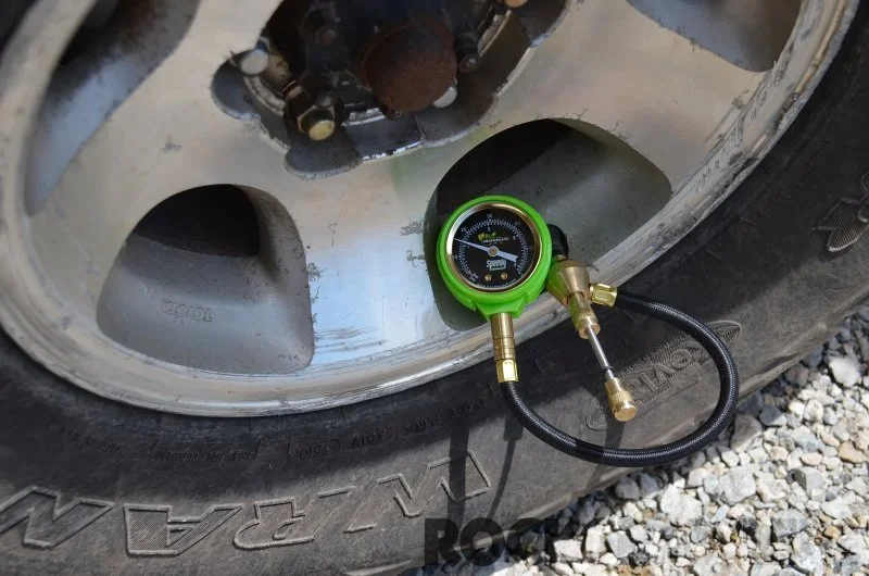

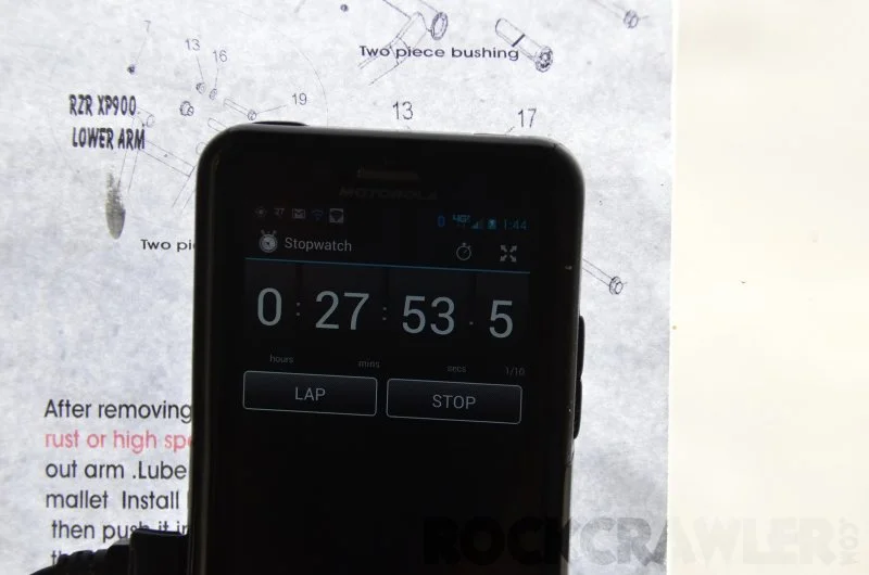

A few things come to mind when dealing with small 0il-less air compressors...speed of inflation, duty cycle and compressor heat. So, all of those were put to the test. Testing was on a set of 315-75-16 Goodyear MTR's...inflation range was 15psi to 45psi on all 4 tires....pausing only to change the chuck from one tire to the next.
First, air down to 15psi...

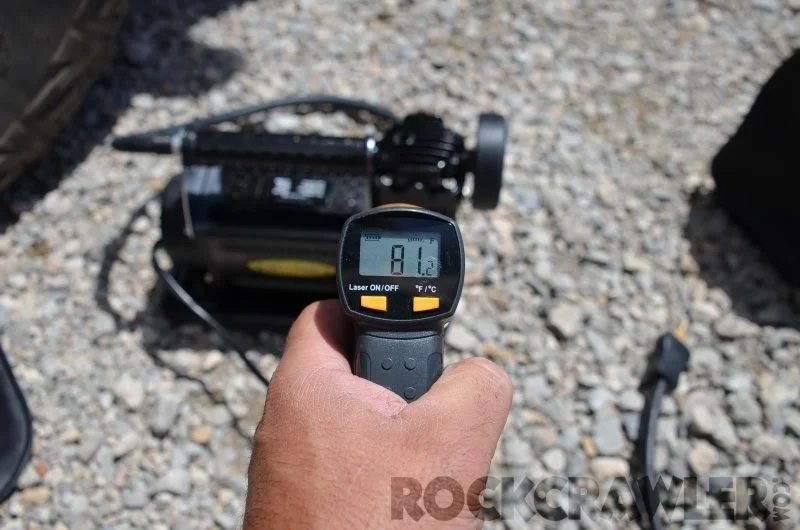

Next, I took a reference temp on the cast compressor fins....81 degrees to start

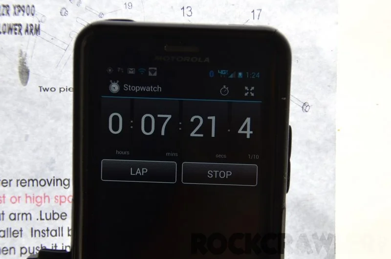

Set the stopwatch, and air the first tire from 15-45 - time elapsed, about 7 minutes.

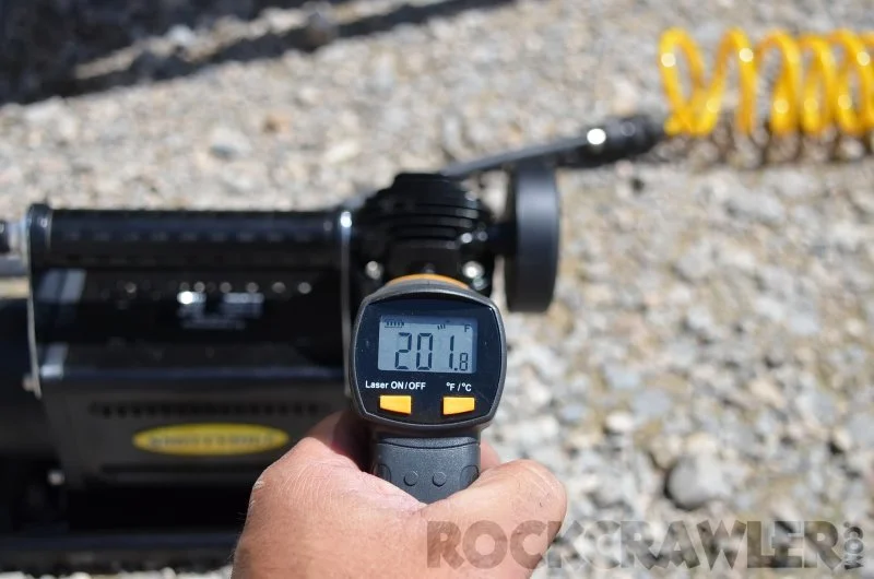

And then, record the temperature of the cast fins on the compressor....200 degrees, not bad.
Continue with all four tires....well, almost...

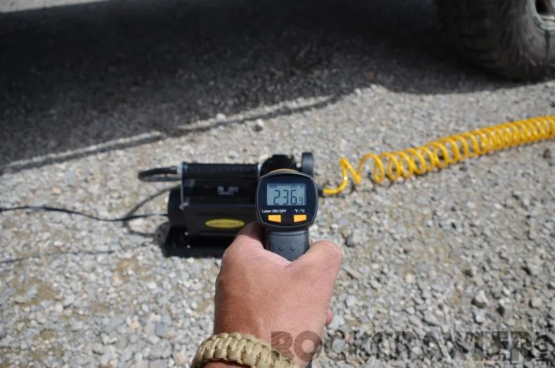

With the compressor in the sun and about 27ish minutes into the process, there was 40psi on the 4th tire...and the compressor shut off. Completely.
So, out comes the manual...hmmm...hey, look...there's an Overheat Protection Circuit...I guess 240-250 degrees is the cutoff point for this. I allowed the compressor to cool down to a gun-confirmed 100 degrees (about 15 minutes) and it fired back up to complete that final tire. Just for good measure, I aired down one tire again and aired it back... no issues.
