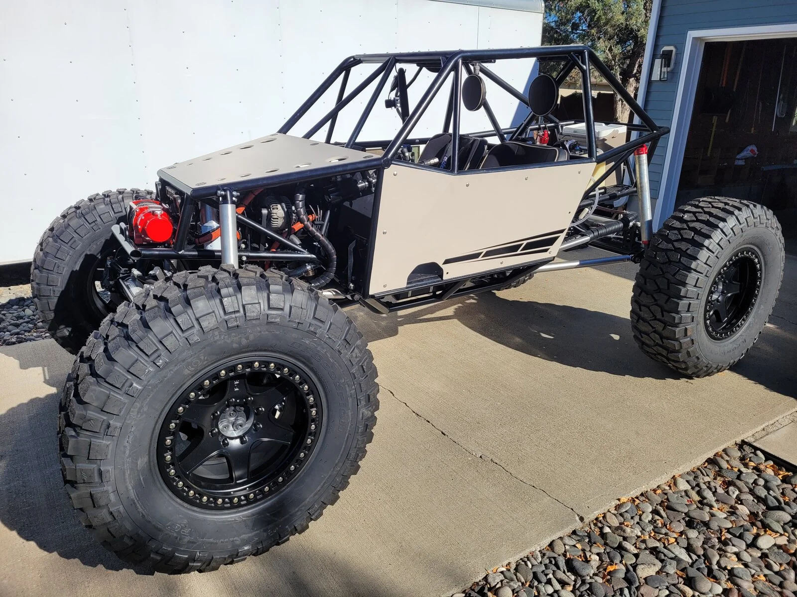

Well, panels will never look the same but this is the only picture I took early in the day.

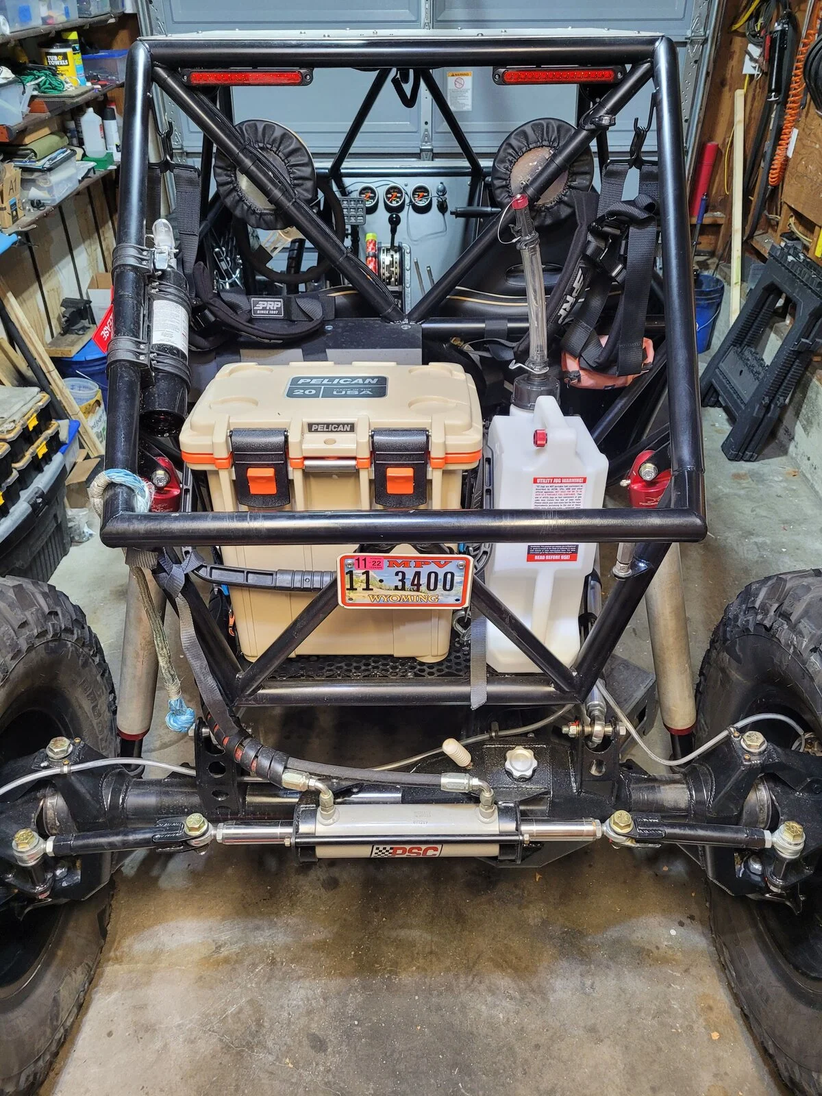

Also drove down to the local truck scale here and weighed the buggy. It came in at 3400 total and 1540 on the rear (equals 1860 front and a 55/45% bias). The truck scales weigh in increments of 20 pounds so a good chance of +/-20ish lbs. Ironically the weight is the same number issued on my license plate.
Found a cooler that fits in my truck area nicely and is a good size for all day wheeling. Its the 20qt Pelican. Also found a 3 gallon Risk Racing fuel can I fit next to the cooler when needed for long snow wheeling days that tend to use more fuel considering the 8 gallon fuel tank on the buggy.

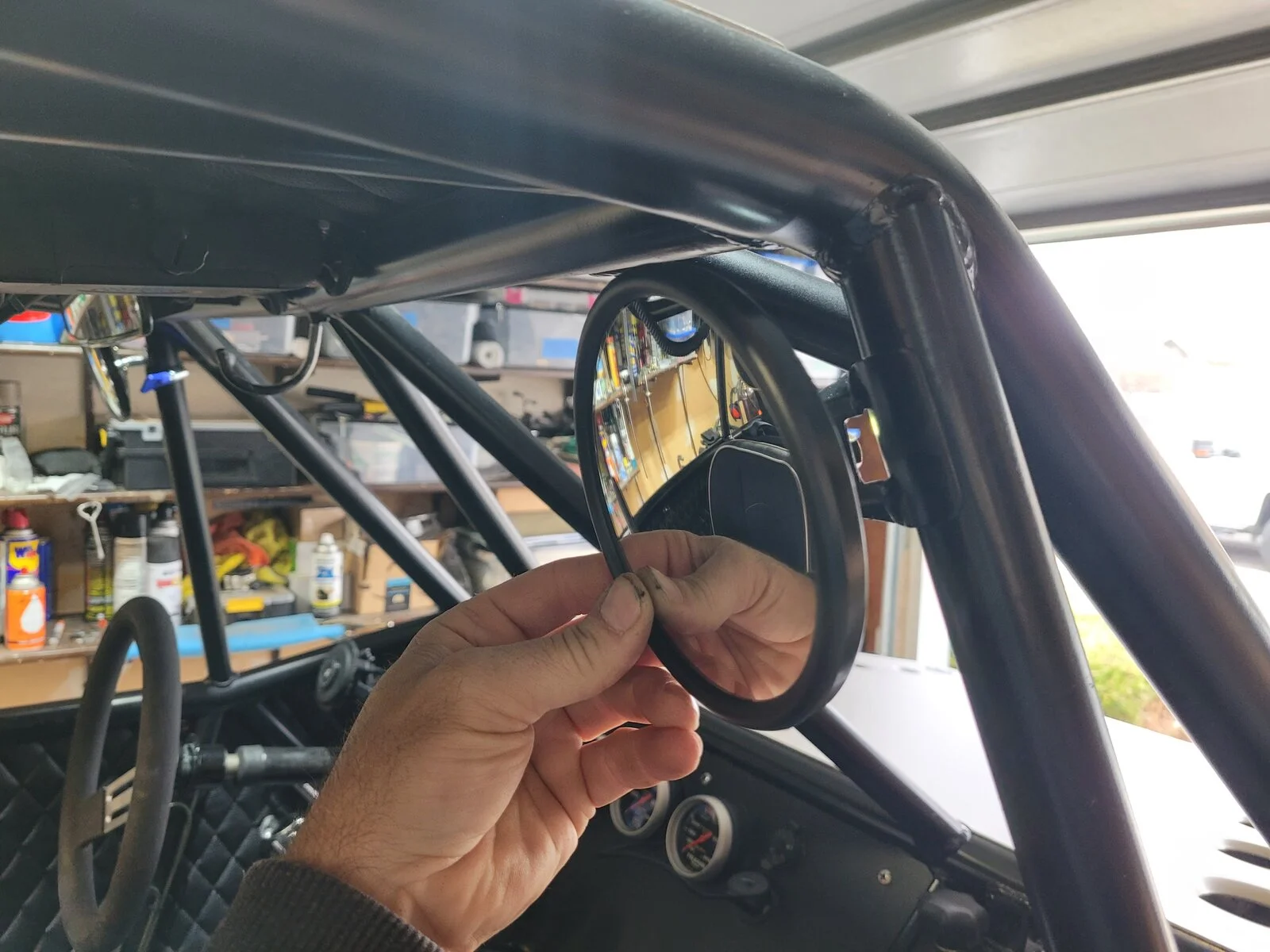

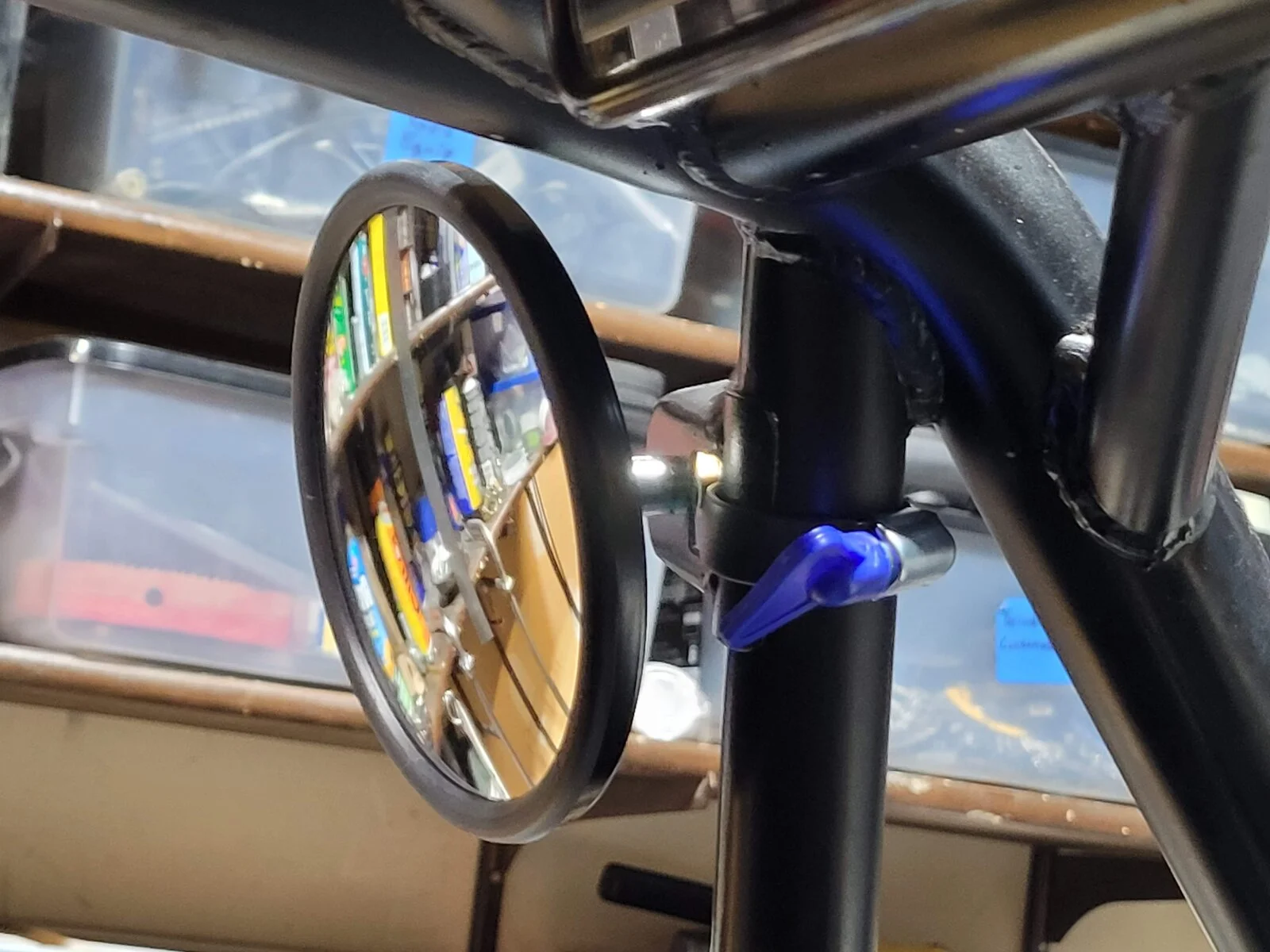

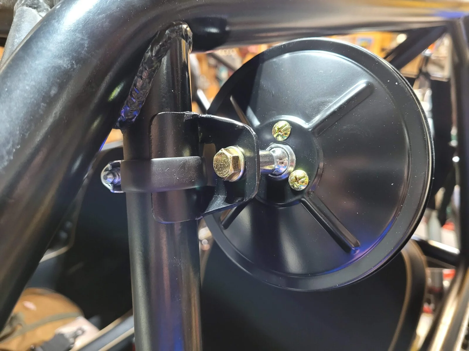

Last thing is the simple side convenx mirror mounts I just finished. Did the same on my old buggy and worked good. Basically just a trick tab with a groove ground out and a piece of tubing with the ID to fit the chassis tube split in half and a wing nut hose clamp and heat shrink. Nice thing is they can be reinstalled with the mirror inside more if needed and easy to loosen and swing in when driving against a wall.
Bummer you've only got one wheeling day in! Love that mirror setup, but considering I've literally repainted my A pillars after every trip, I'm not sure it's a good idea here :)

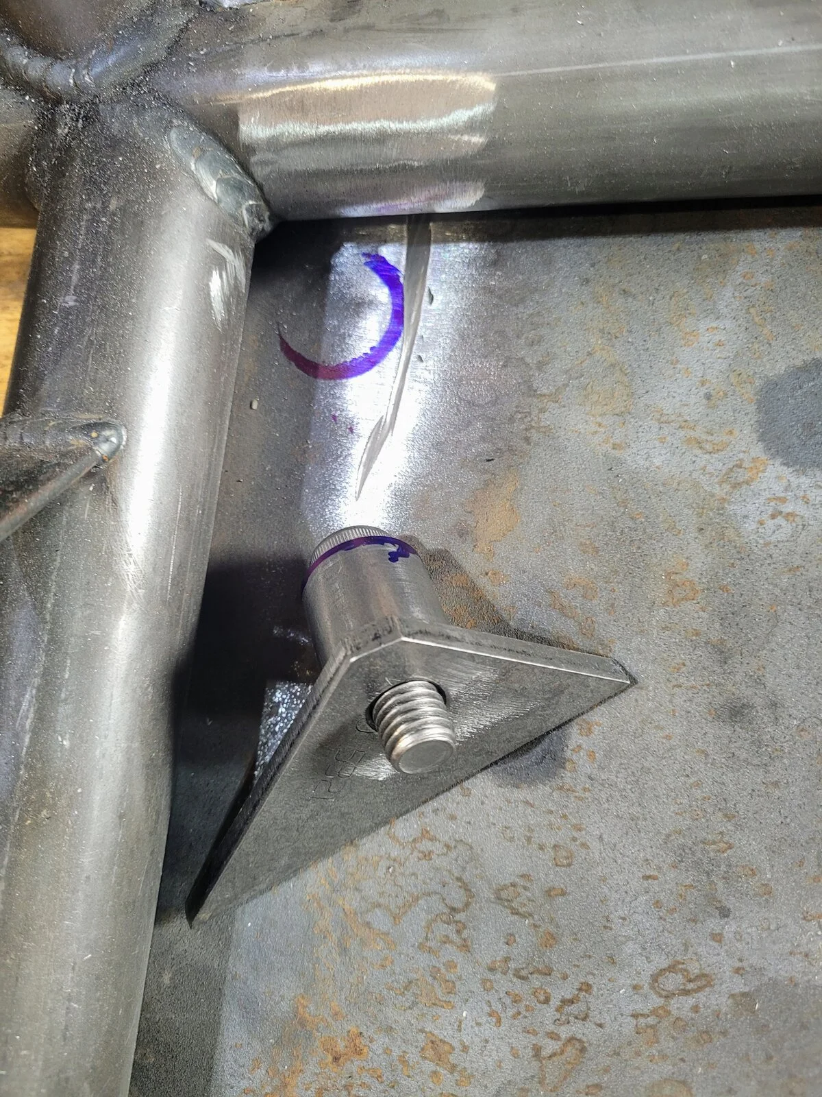

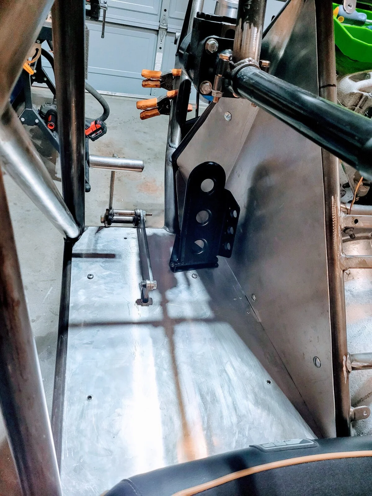

Thought would share how I attached my skid plate here in case it can help others. My old buggy has button head bolts and clip nuts on chassis tabs mounting the skids and overall they worked fine. I bought a bulk amount of bolts since typically replaced a handful anytime I dropped the skid. Often the Allen hole was jacked up but could typically pound a torks bit into it or worse case weld a nut to head to remove. This rig I used recessed socket head bungs so nothing hanging down. Used my Primeweld Cut60 plasma cutter and straight edges to cut the 3/16 AR400. Hand cut the holes for the bungs, welded the bungs, then a carbide burr to finish the hand cut hole to the ID of the bung. Not shown in picture but I did add mounts to the belly skid behind the front control arm mounts after the pictures. My thought is the skid is now reinforcing the the control arm mounts at those locations. The rest of the mounts aren't symmetrical because of the offset drivetrain and clearance to components. I also used a thin chipboard shim between skid bung and mounting tab before welding tabs on with used that will make sure the bolts pull the skid tight to belly tubes.
Nice! I never thought about "preloading" those bolts with material during fabrication...good idea :)

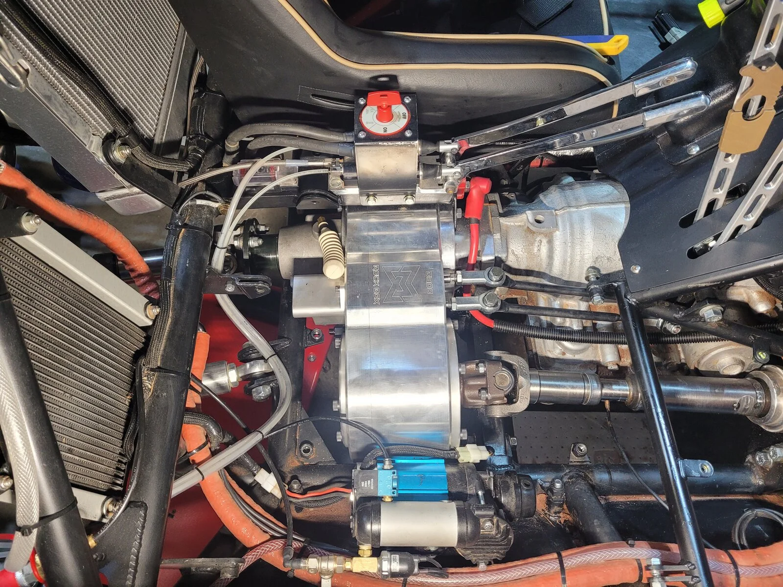

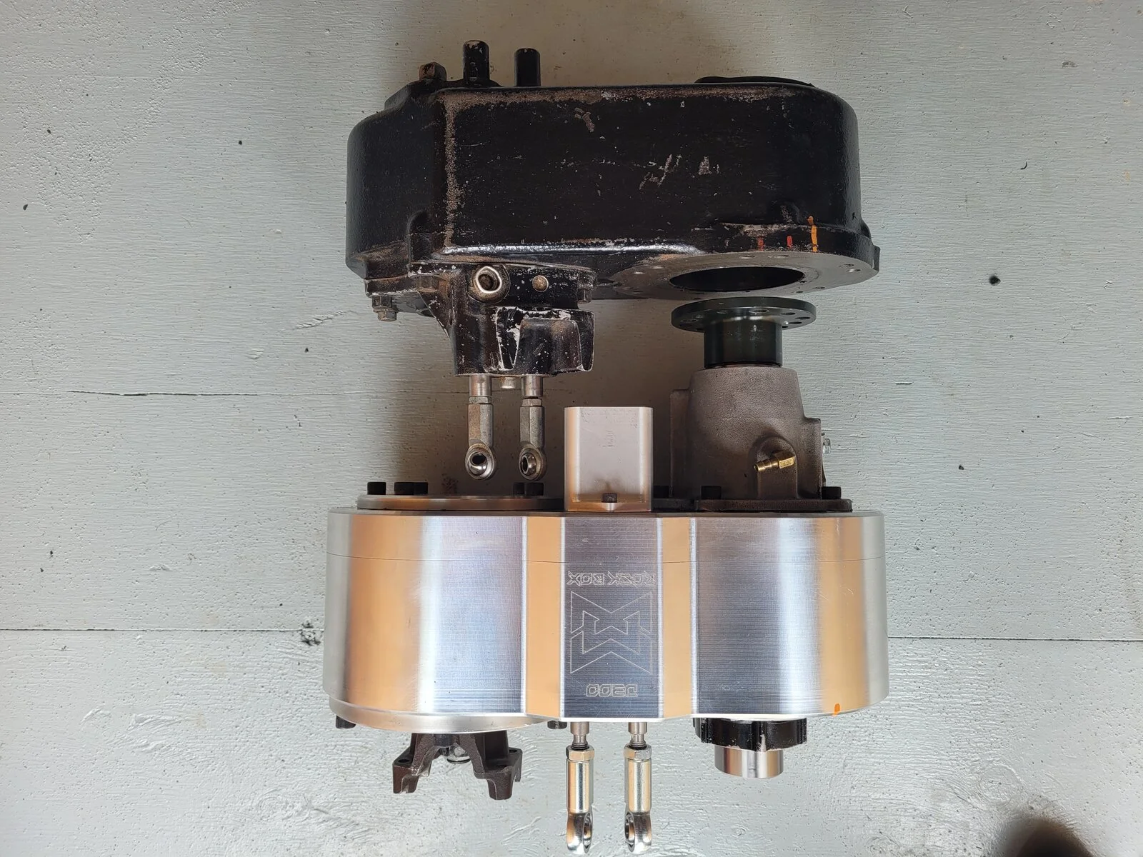

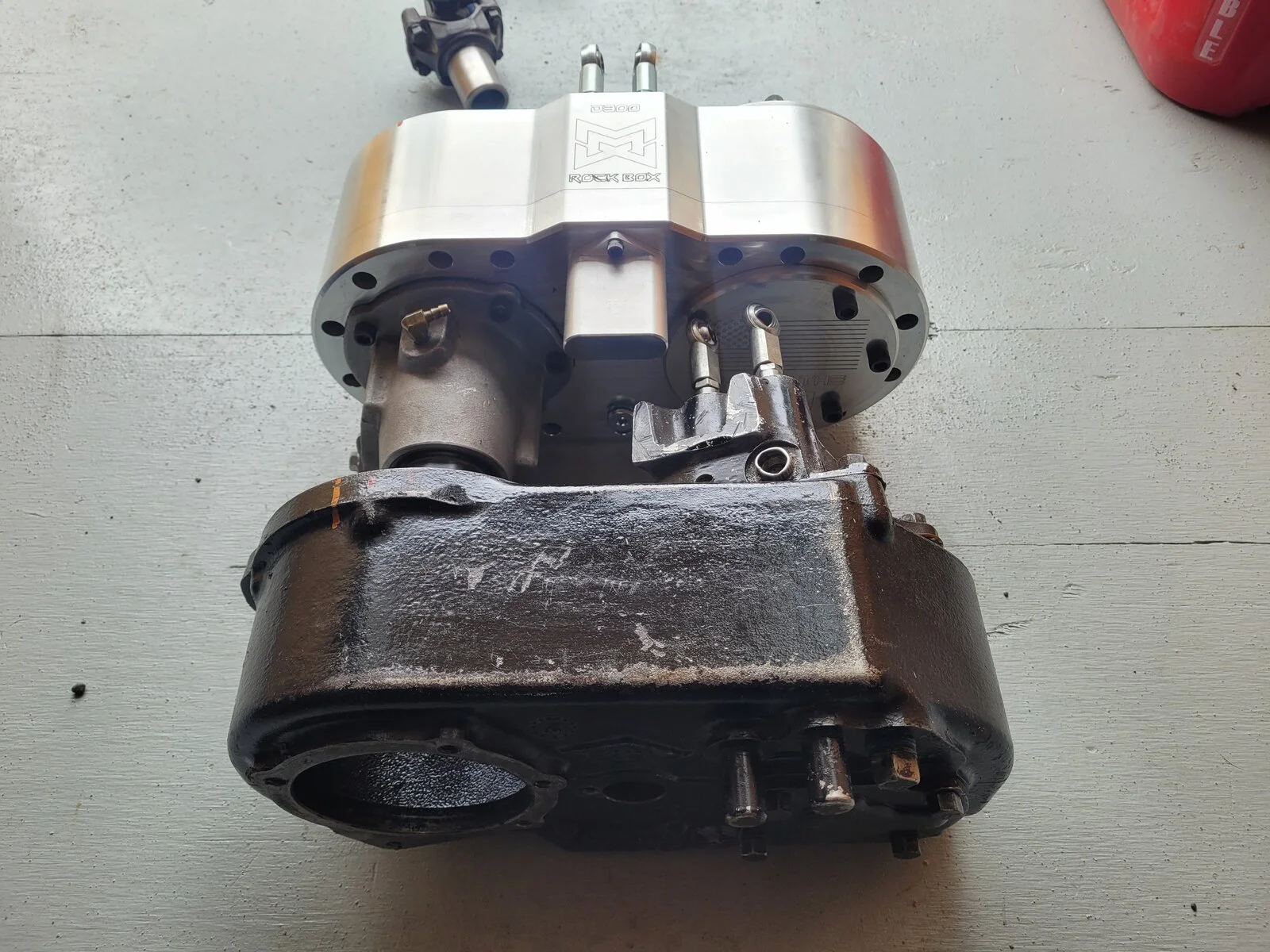

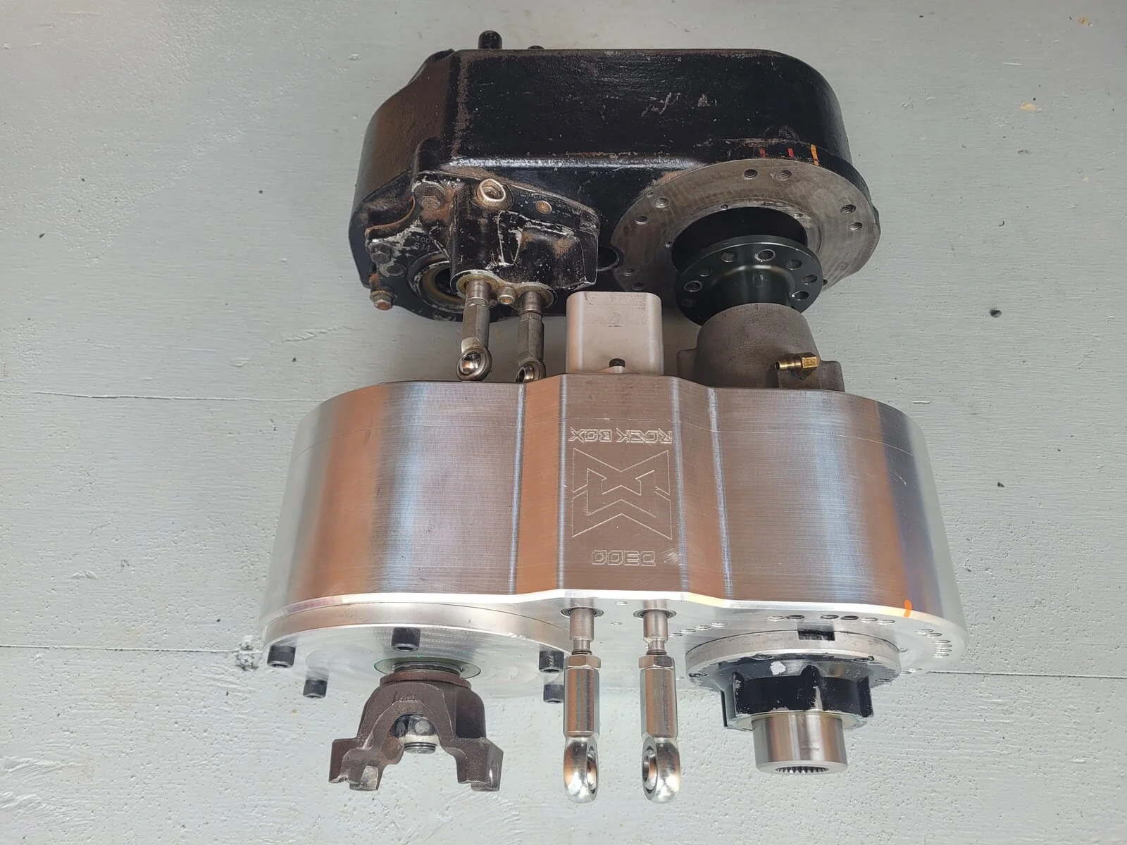

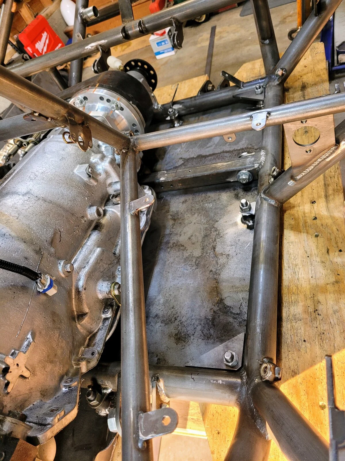

Picked up a Midnight Metalworks Rock Box replacement case for the dana 300. Decided not to rush to install before Sand Hollow in case I ran into any issues. Swapping it now and about ready to go test drive. The case is slightly larger than the stock Dana 300 so had to clock front output up about 3/8" higher than before to keep about 1/4" air gap to the skid plate. Had to rework my transfer case shifter linkages and my center console because my mounting bolts ended up in a different set of holes. I messed with the detent springs and got them shifting pretty smooth but it still sluggish because of the new bushings in the case, the more I mess with it the better it is feeling. Will have to modify passenger seat from more than I had before because of the shifter location on the MMW case is right where the seat frame lives. On the stock 300 I just had to put a box in the seat frame previously. Hopefully next weekend do some driving tests.
Attached are a few more comparison pictures of the two cases to show size and orientations.
I'm somewhat surprised by the size differences. The additional beef is awesome but the tight fitment of some of these chassis with stock dana 300s is gonna make it a bit rough I think.

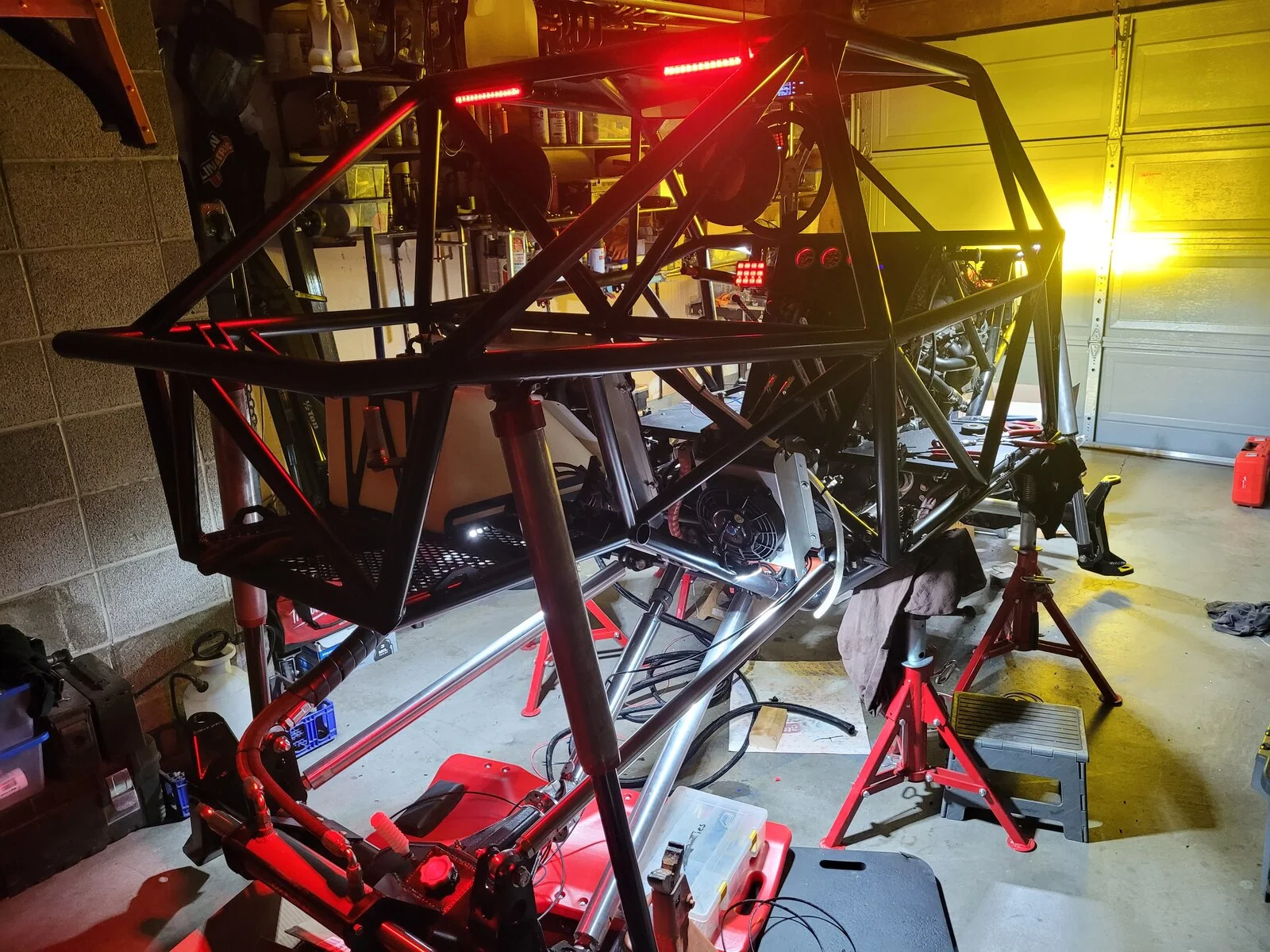

Few updates. As of now it's all done minus getting engine calibration sorted out. Had a bunch of time consuming setbacks in the last month or 2. Axle shafts were wrong length and had to be modified, had to fix chassis welds because of coolant leaks, and the ecu tune problems. Here are a few update pictures.
All lights wired in.
Belly configuration trying to keep and heat from sedative stuff.
First time outside and near complete.

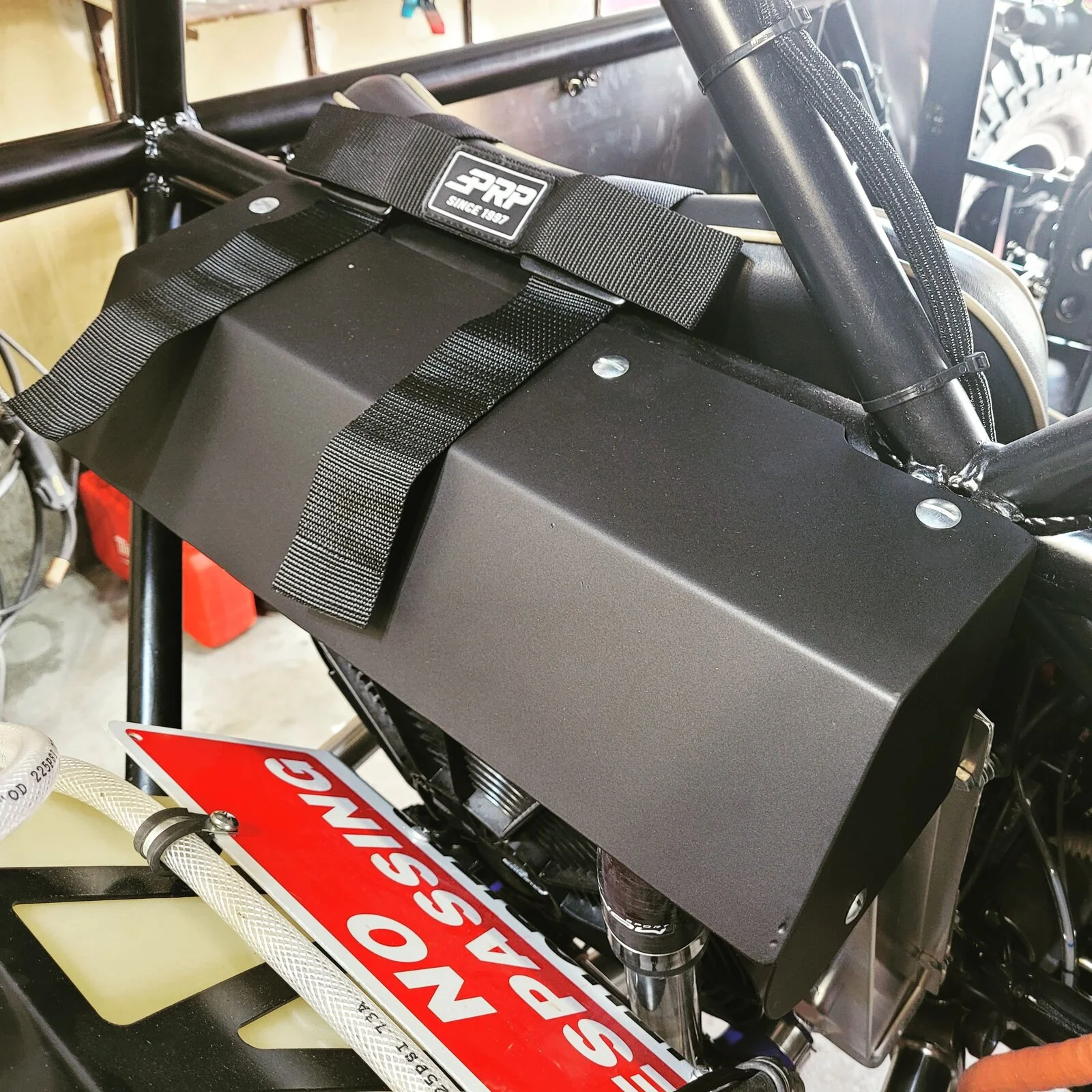

Radiator heat shield to block fan noise and protect from cap or upper hose failure.

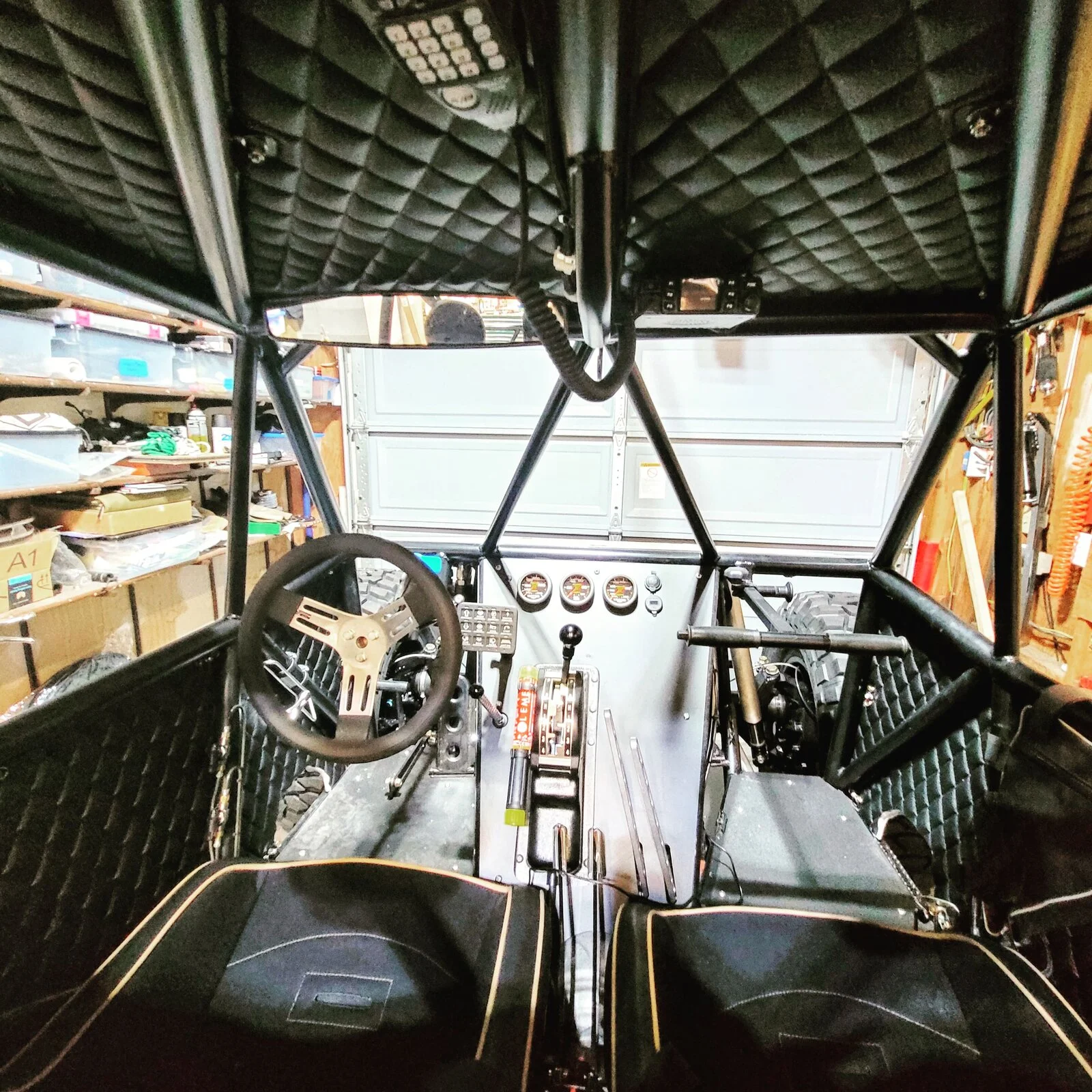

Finished interior. Seen a few guys do the fabric and made sense to me to keep rattles and harmonic noise down and has to help with radiant heat pluse looks finished.
I like that rad cover. Did you fab this? Great idea. I put my radiator behind the driver seat and I share the same worry
I did make that cover with some .060 or so aluminum. A little insurance in case of a cap or hose failure behind my head. Also think it acts as a heat and noise shield.

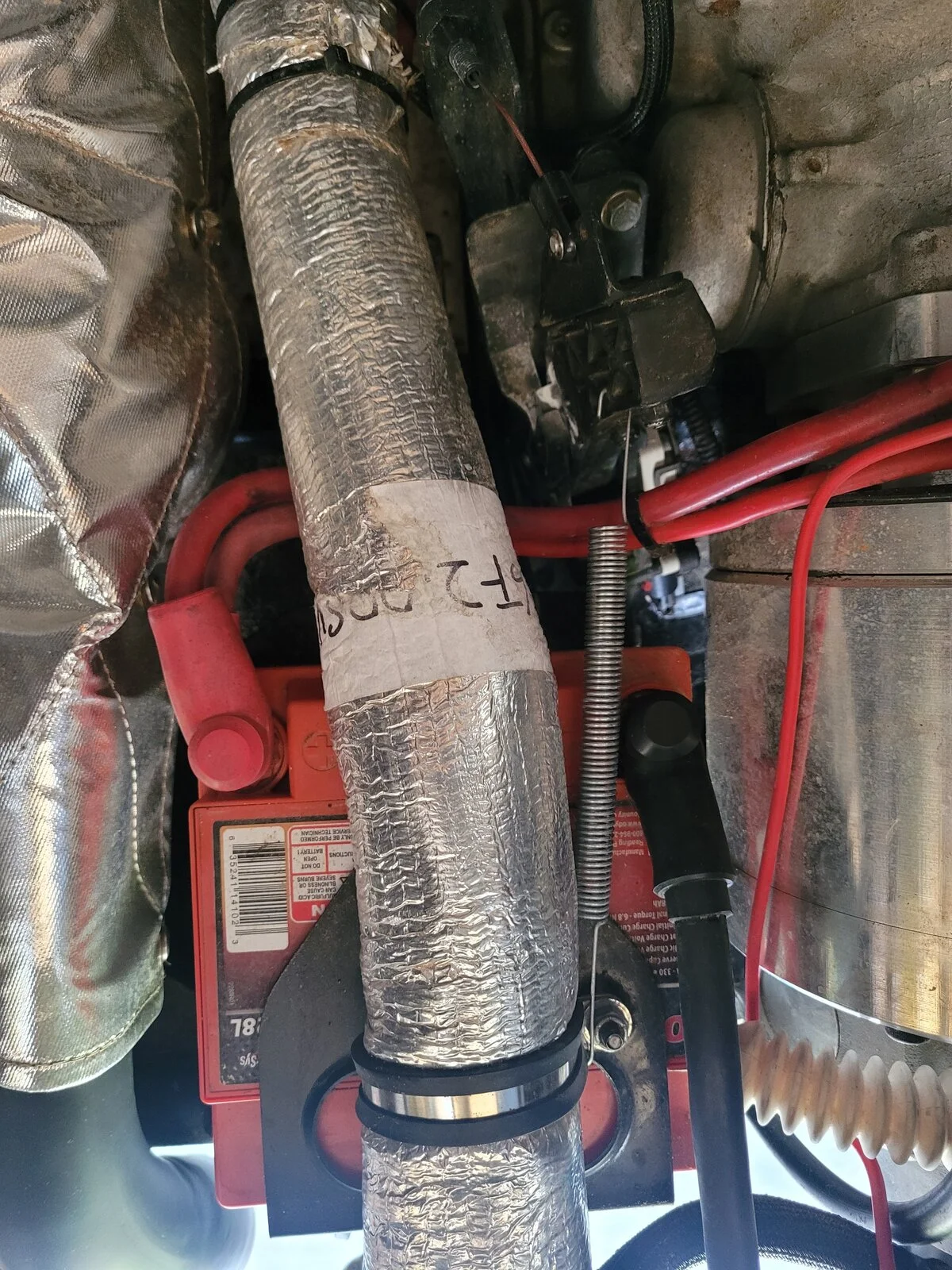

Have added a spring on my throttle pedal, with the added ratio of the drive by cable over wire the throttle was super touchy and would sometimes get sticky since the electric pedal spring had so much leverage against it. Adding this spring gives me a ton more pedal control. In sand hollow it didn't take much buggy movement and would make me blimp the throttle, sometimes when you least wanted it.

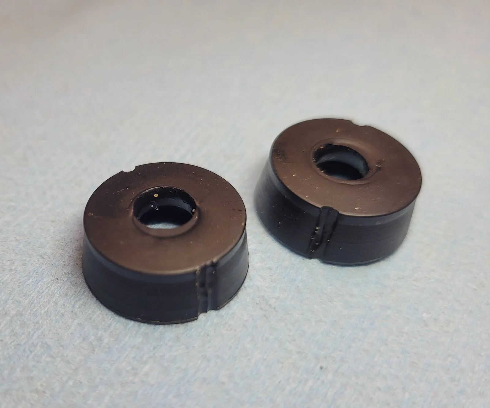

Also rebuilt the master cylinder and cutting brakes. On my initial test drive I was testing the cutters and had both pulled hard when all of a sudden they both got loose together and never worked right again. I could hear fluid back feeding the master when I tried to engage them so initially thought something in the master maybe. It's seals looked good so went ahead and pulled the cutter and sure enough both seals had damage. Replaced them and reeled the brakes and ready to try them out again.

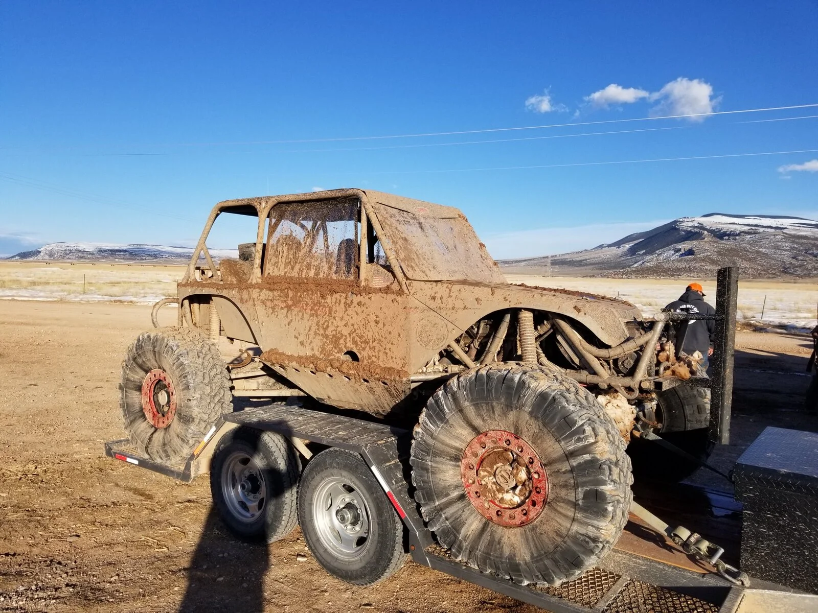

Also made see thru panels out of 3/16" thick polycarbonate. Was able to nest 4 panels out of a 4x8 sheet from home depot. Definitely a nice feature to see thru the panels. Did some vinyl wrap to give a little color and style.
see thu, how does that hold up to washing off the mud and such, we have mud all the time in iowa,
It can scratch fairly easy if you try to wipe mud off. I have used polycarbonate for windshields for snow wheeling my last buggy and would always try to wash the mud off with water only. I also apply rainx for plastic on it to help keep stuff from sticking. I consider panels as consumable anyways and seems like a set only last a couple years and gives you a reason to make new set and change up the color scheme.
i think i will stay away from clear, this is a typical weekend where we wheel in the midwest, even on dry weekends its still muddy in the shade. damit i would love the clear though.
Yeah they will get scratches in short order for sure. As side panels they will still function though, as windshield scratches suck. This day here destroyed that lexan windshield but would have still be done for panels.

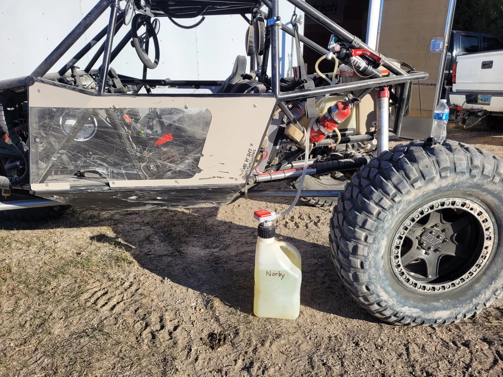

Little things, picked up a Terapump XL to fit in my 5 gallon fuel jug. So much easier that balancing on rear axle filling the gas tank with the Fuelworx can. Be sure to get the XL version that has the jug cap adapter and longer suction and fill hose.
Wow, I could use that for sure. I see the specs at 2.4 gpm. Is that a legit gmp?
I have only used twice now and only top offs but doesn't take long to add a few gallons. Has an auto off feature that has worked so far so usually packing cooler and keeping an eye on it.
