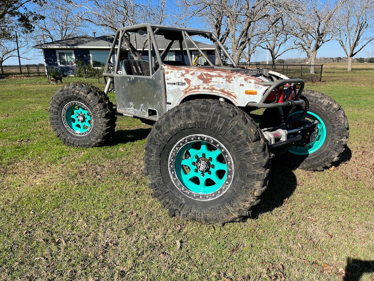

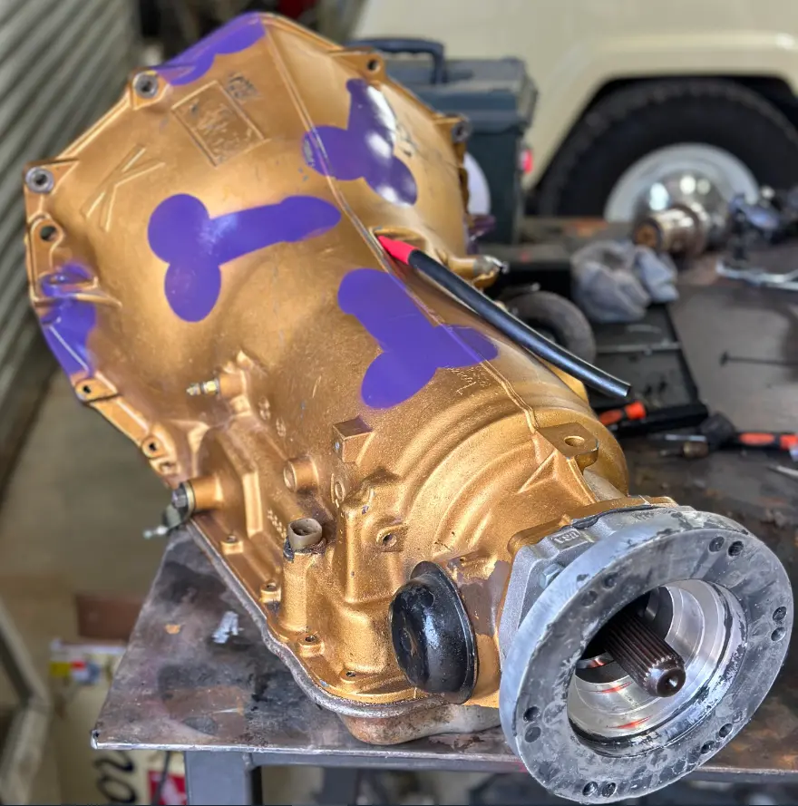

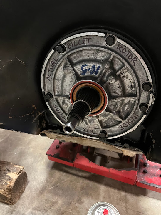

Picked up my trans from my new rebuilder. It actually has a billet pump in there this time.

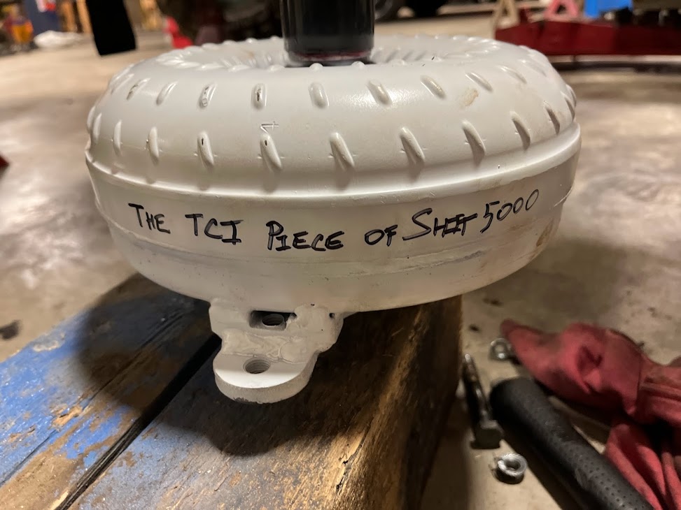

yesterday i picked up the rebuilt TCI piece of shit converter from a local rebuilder. Its now true on both ends, so hopefully no more problems.
Last night i got the trans and t-case stabbed back in. I will let the RTV dry today and add fluid tonight to see if everything works. Its 95% put back together with the exception of a couple of wires, the interior panels, and the skid plates. If everything goes to plan, she will be ready for RMR this weekend in Oklahoma.
If only you had a see thru bellhousing :) Classic.
Good luck, hope everything works perfectly (and STAYS working). RMR is on my list, haven't yet made it there.

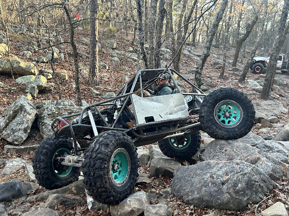

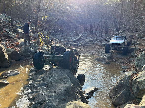

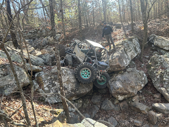

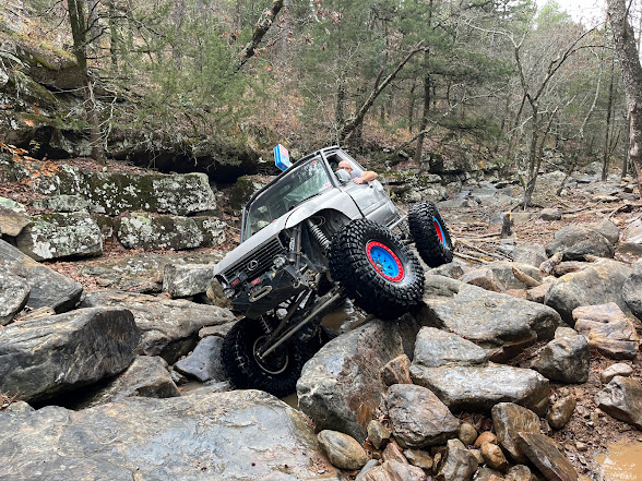

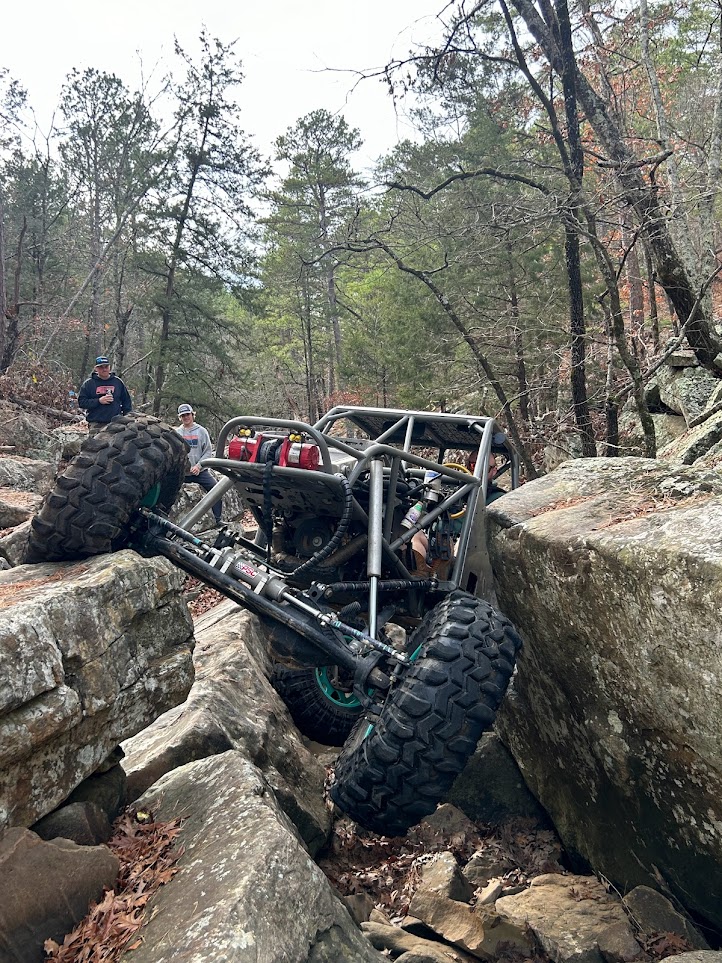

RMR trip report. Transmission pump has help up so far. No issues there. I bumped up the pressure in the shocks and for once, the didnt bottom out or settle. They are now sitting around the 4" uptravel mark which i feel is perfect. No breakage from anyone in the group which seldom happens. Weather was just about perfect. Good times were had. We hit Asylum for the first time and ran Tackett Creek a few different ways over the weekend. Next trip up is a New Years run on some Texas granite at Wolf Caves.
Even the pizza got delivered.

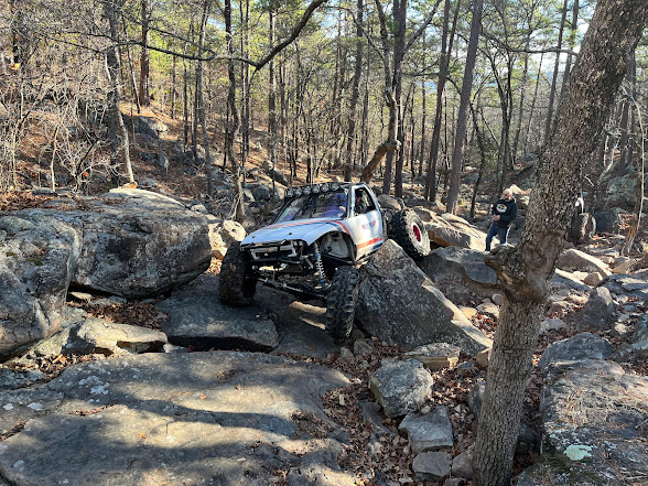

Thomas's S10 putting in some work

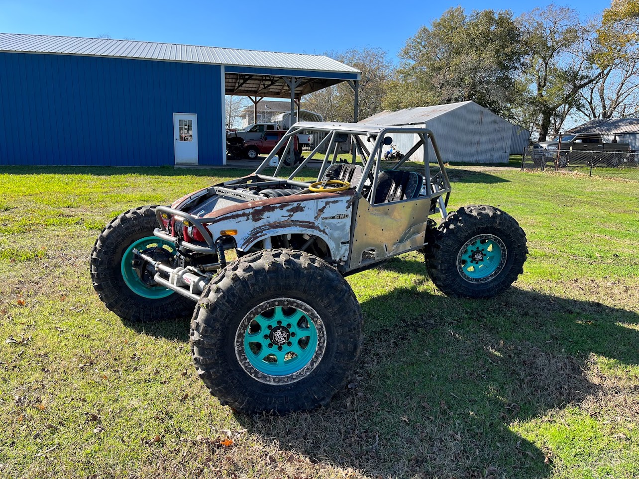

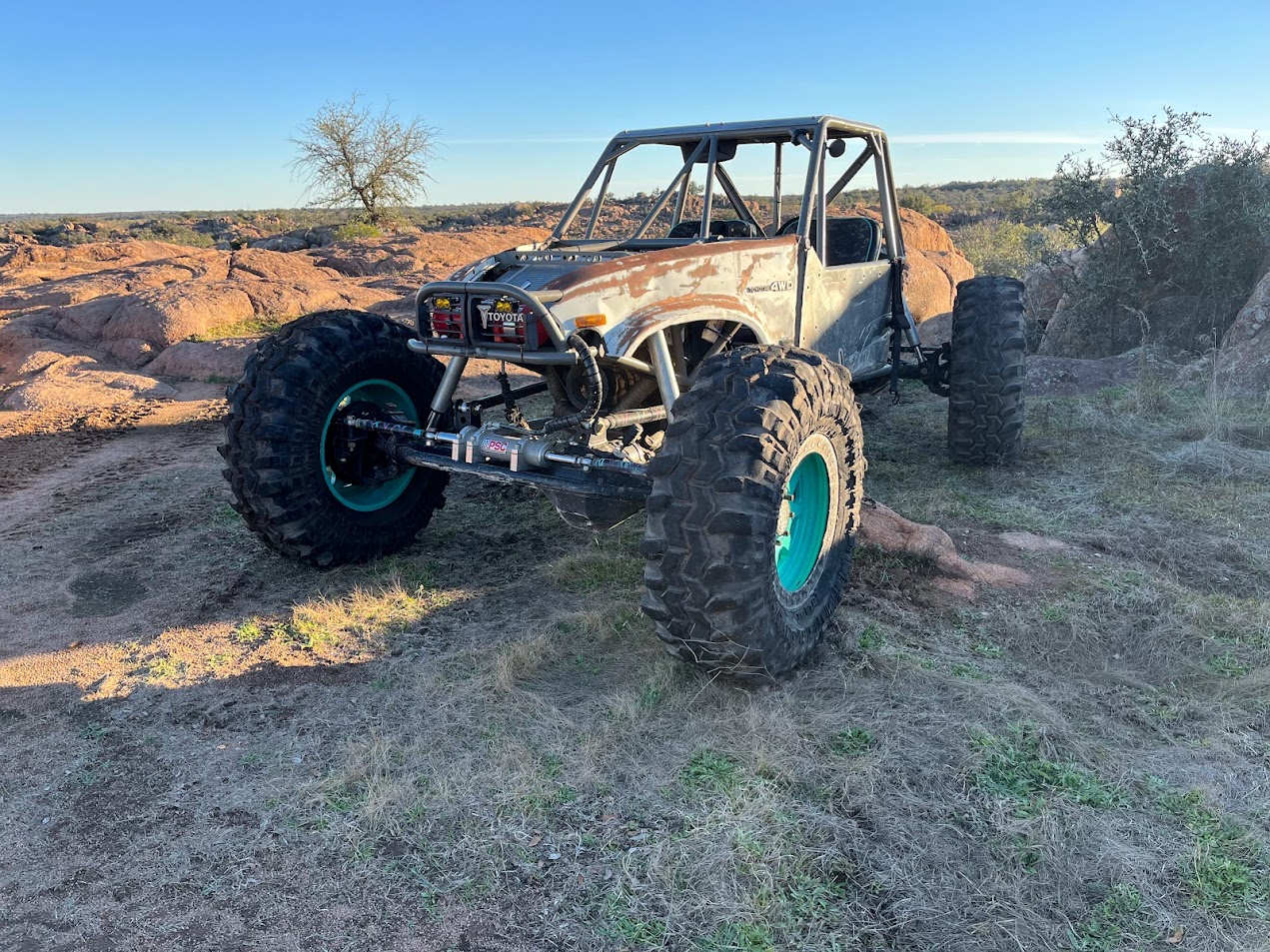

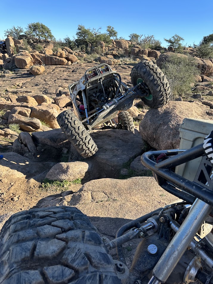

I would like to report that i have successfully wheeled two full weekend without my transmission pump exploding. Hopefully my days of blowing transmissions are a thing of the past. We spent the long holiday weekend wheeling some granite at Wolf Caves in Mason. Good times were had. We only broke one 8" R&P, one 9" R&P, and one RCV in a portal buggy. Otherwise it was a clean weekend.

As for Mission Impossible, only myself and a bud tried it. After a few minutes i made it up. He didnt. Its a tough one.
Heck ya that's a tough cookie to crack sucks to hear about the engine but good to hear you got it back together hope to see ya out wheeling sometime again and ill come introduce myself.
