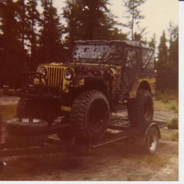

I was this crazy kid back in the day circa 1981. CJ5 with 38" Gumbo mudders................. on a D25 / D44 combo. LOL
I'll post a pic tonight.

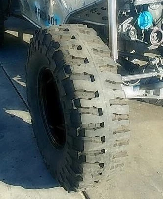

Have you seen the pre-production version? Cut your own....after a comp season, they sat the top 3 guys down and had them finalize to the current design. Pretty awesome.

I had not heard that. The tread looks the same as the 39.

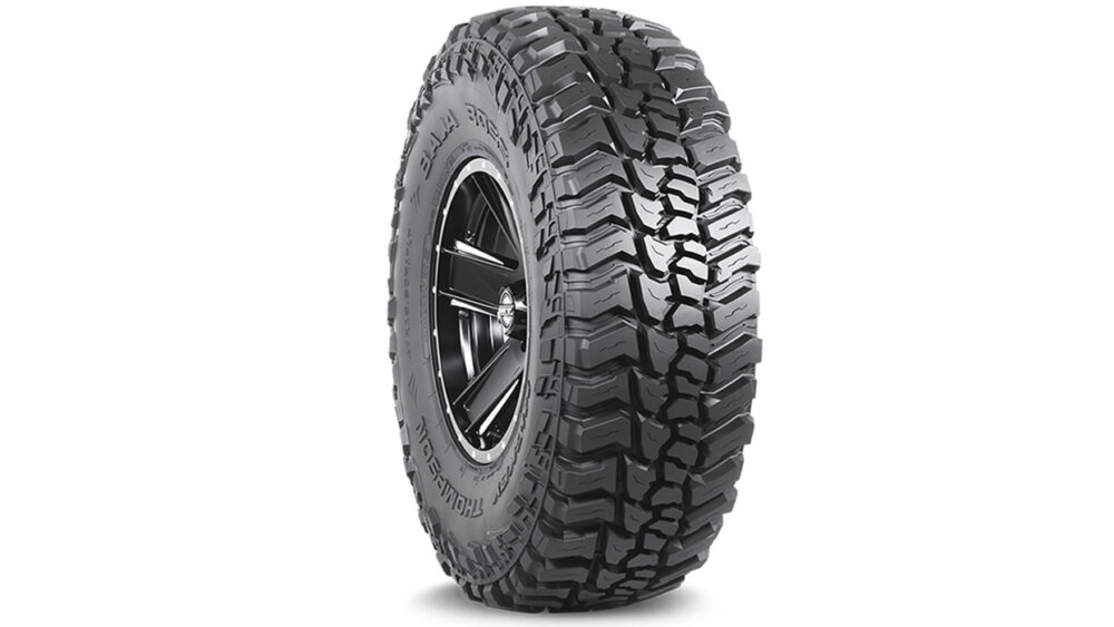

Micky Thompson debut'd their 44's at SEMA. I've wheeled with a couple people at SH running the Baja Boss tires and I'm personally not impressed. But the driver can play a part too.
