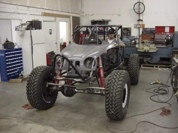

The next rig was just a Dodge D-50, not much of anything. Just enough to get out and enjoy the outdoors, small body lift and 33's. After that I tried my hand at my very own buggy. By this time (2001) fabricators were throwing everything they could at the idea of evolving rock crawling "Tech" if there ever was such a thing at the time. I am not entirely sure who made the first full tube buggy but they were being built and scrapped for newer tech every month or so. It was crazy. I decided to throw my ideas at the buggy build craze. A two seat, front engine (They were pretty much all that way at the time), tube buggy with a light weight Oldsmoblie 215 Cubic Inch aluminum block V8, with a VERY narrow rear end so it tracked better through cones. The problem was it didn't climb very well because of the narrow rear end. The chassis was modelled after a Shannon Campbell chassis, since at the time, he was my favorite driver. Since we finished it in 2002, it has been bastardized and rebuilt about 200 times. So much so, that it is completely unrecognizable and I have no idea where it is now. Heck by the time I was done with it, I had 3 builders who had helped me finish it (Monkey Fab-not sure where he is these days, S&N Fab-Jason has been in and out of the sport for some time, and HallStyle Racing-John Hall now races in 4400). Shortly after I was done I saw Tiny, the nelson built buggy driven by Jon Bundrant and the entire buggy building crazy went back into a tailspin for even more redneck renditions.

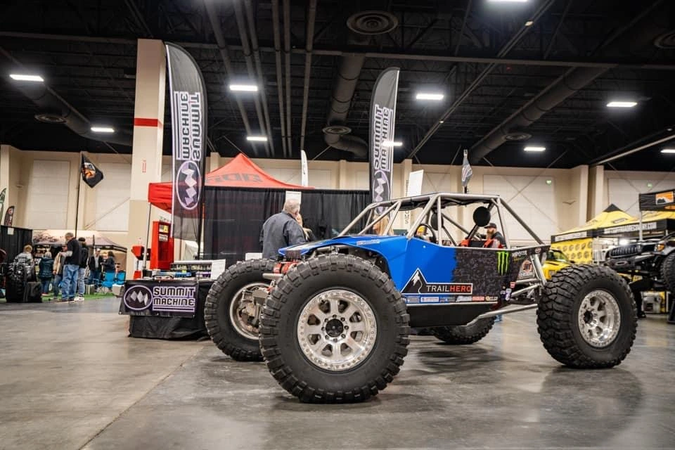

I saw you just popped $180 k on a new buggy. Cool.
bummer

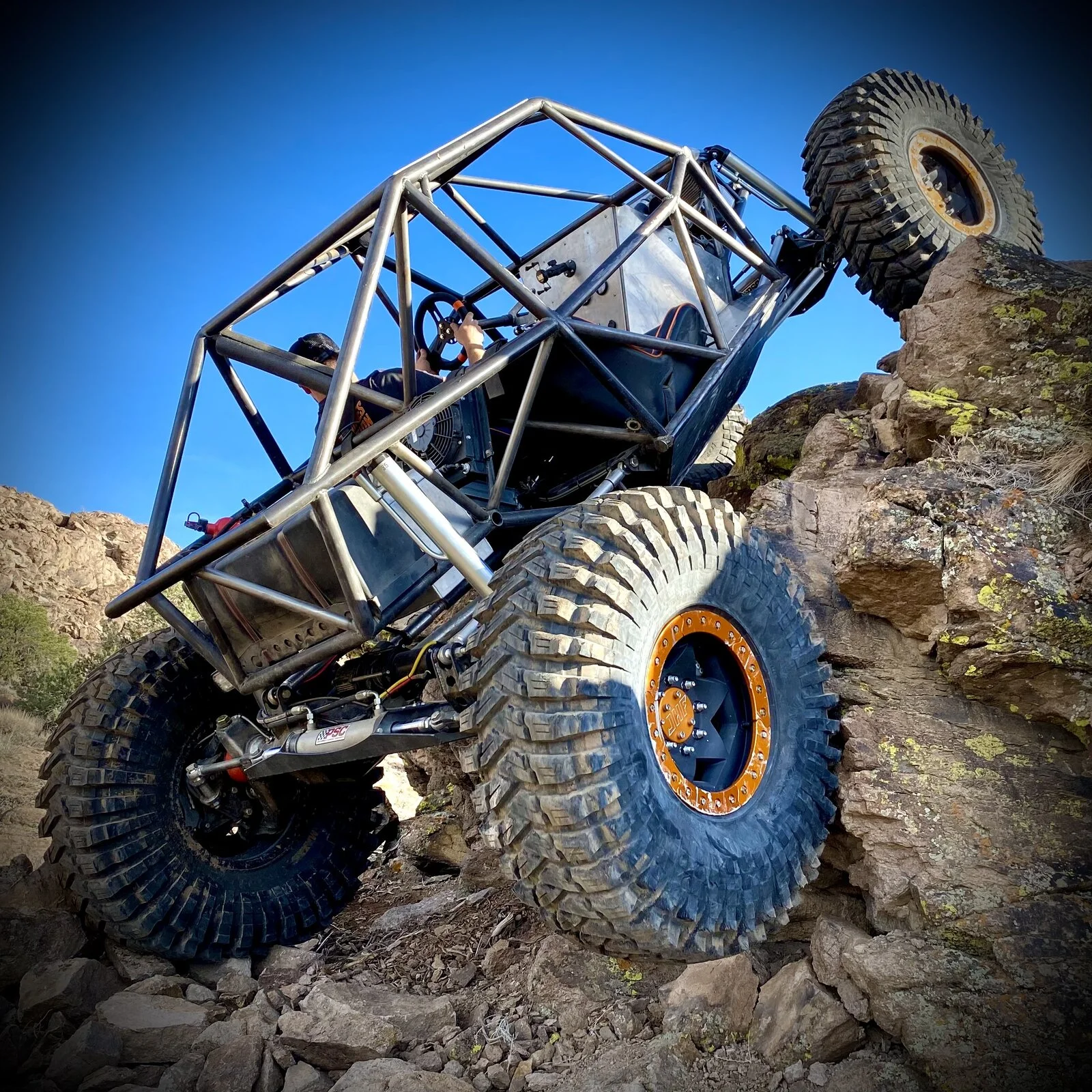

Who's ram mount is that? I've seen something similar on 3 different JHF Trail cars now....Battleborn's, this one and one on Jesse's FB page. It looks clean and appears to do a good job of protecting the cylinder and shafts. Looks like it might be Jesse's normal "cup" design with plate over the front from one picture (you can sort of make out it out in the attached photo), but I'm not sure. Just noticed the attached pic shows a car with a passenger drop front and driver drop rear axle.
