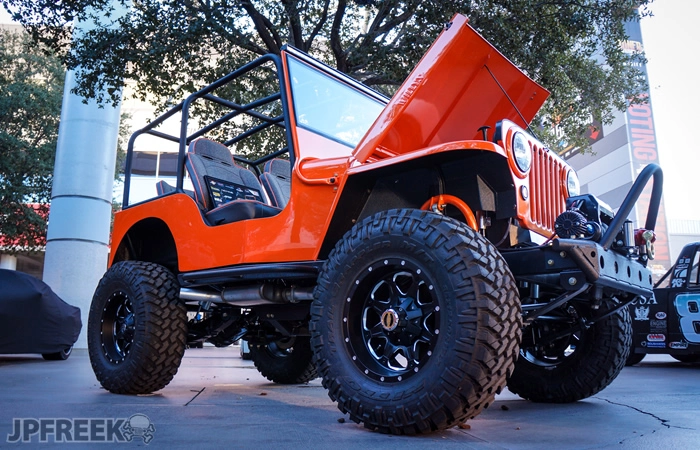

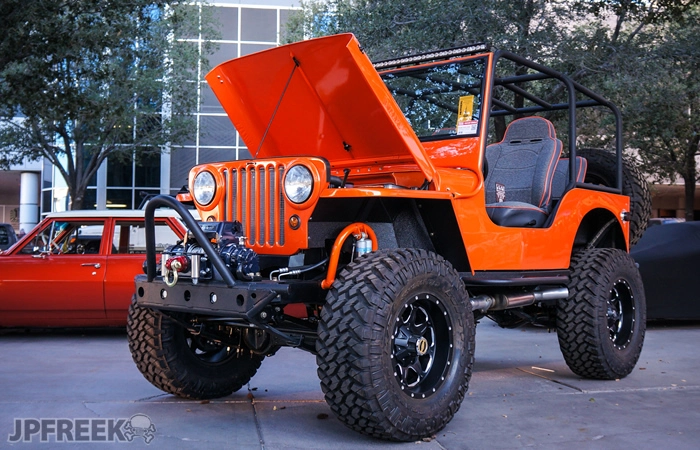

The custom 1948 Willys CJ-2A was created for SEMA 2013 by Rock Solid Offroad (RSO) in San Jacinto, CA. What began as a concept drawing by Josh Miles at DT Design Agency quickly became a full-fledged custom build that turned out better than anyone could have imagined. The frame was hand-built from 2″ x 4″ square tubing. RSO wanted to give more room for the driver and passenger so they stretched the frame 12″, made the body 6″ wider, and modified the window frame to make it 4″ taller. A custom cage was fabricated as well as custom glass that was cut and installed by Felipe’s Auto Glass.​

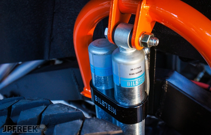

The front axle was moved forward 4″ and the rear axle was pushed 2″ back to give the Willys a more comfortable ride and aggressive stance. Toyota truck axles were used and fitted with both disc brakes and ARB Air Lockers. The front shackles were reversed and a 4″ BDS Wrangler kit was used. Rock Solid Offroad decided to run Bilstein 5160′s with remote reservoirs.​

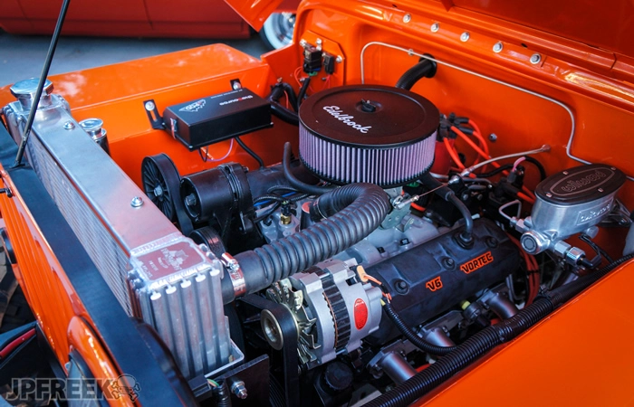

Under the hood is a 4.3 liter fuel injected Chevy Vortec. They paired that with a 5-speed manual transmission and transfer case from a ’94 Toyota 4Runner using adapters from Advanced Adapters. They also used a Centerforce clutch and conversion headers sourced from Advanced Adapters. Some fender modification was done to accommodate the headers. Magnaflow mufflers and a Flex-A-Lite radiator and fan combo were installed to give her a nice rumble and keep her running cool. Putting it all together was done with a Centech K40 body harness and a PDP-1B fuse panel. The fuse panel and ECM are hidden in a compartment in the glove box. The engine’s ECM, wiring harness, custom chip and fuel pump were all sourced from Howell Engine Development.​

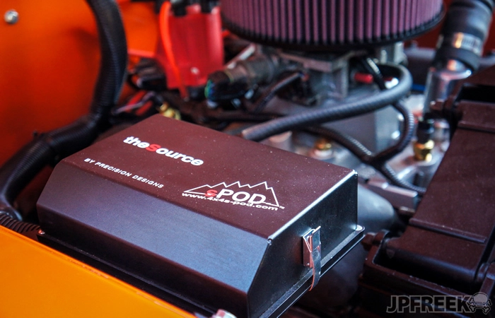

All the accessories on the Willys are by a power distribution box from 4×4 S-pod. The team at Rock Solid Offroad said the S-pod was a huge timer and kept their engine compartment organized and clean of wires running everywhere. They also said a Phantom Products “touch and go” start system was added to the Willys for added security and piece of mind.​

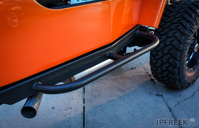

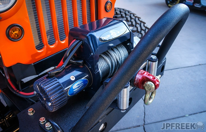

New bumpers and sliders were also custom fabricated for the Willys. The sliders were fit to the original body lines and a tube step was added. The frame, bumpers, cage, and sliders were all coated with bed liner to match the interior. The front bumper features a Superwinch 9.5 Talon winch fitted with a Factor55 Prolink. Vision-X 2″ round solos were added to the front and rear bumpers as well as a low profile light bar to the top of the roll cage.​
