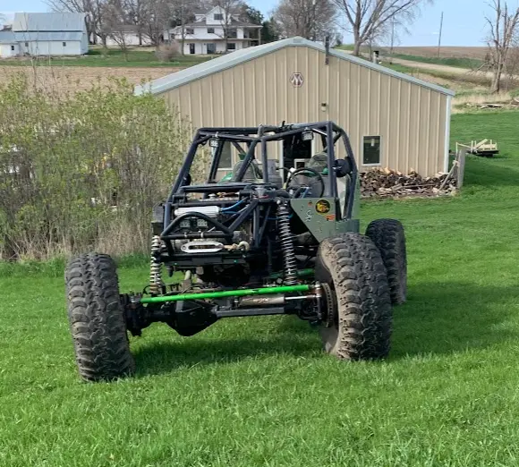

Wider than 84"? To acheive that you are looking at super deep wheels, or custom axles. My dads buggy is '05+ dana 60 with 4.5" BS and its 85". In the east it's as wide as I want....

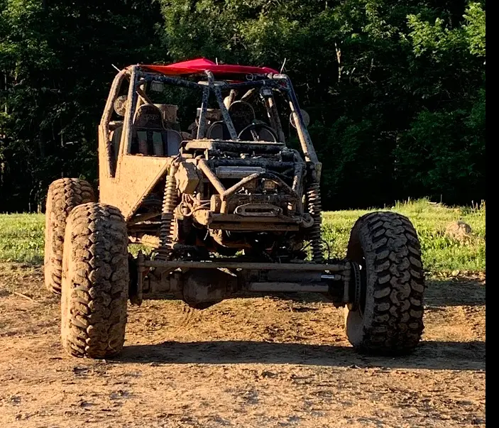

Mine was 83" on 40's with 17x9's and 85" on 42's with 20x10's and 5"BS.
Build around 42's, you'll regret it if you don't. Having run both on my JHF, I wouldn't ever go back to 40's again.

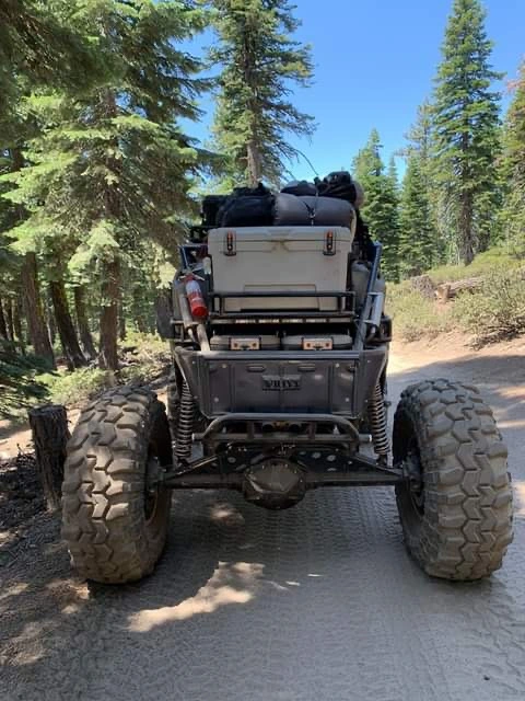

I think this is 89" wide. 14 bolt, 4" bs and 43 TSL stickies
But I gotta measure for sure.
I agree with Woody, once you run a 42/43 you won't want to run 39/40.
