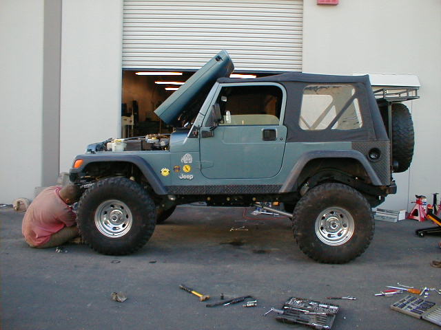

You will now need to adjust the rear trackbar to center the rear axle under the Jeep. You may want to drive the Jeep back and forth a few times to have the suspension settle a bit. Then, observe the rear of the Jeep and if it is off center from the axle. If so, remove the axle end of the track bar and thread the heim in or out as needed.
Once the axle is centered, tighten the jam nut on the heim joint and tighten the track bar mounting bolts. Centering the axle is a pain, but using a bottle jack against the wall pushing against the Jeep rocker panel will move the Jeep body over pretty well in relation to the axle.
Click to enlarge.  The rear end is complete.
Double check all mounting bolts on the rear suspension for tightness. Sit back and take a look at your stink bug TJ! I drove mine around like this for two weeks with no ill-effects. After a hundred miles or so, check all hardware again for loosening. Also, check the length of your driveshaft. Rubicon Express said it won’t need to be lengthened, but mine looks like it could use another inch or two. I’ll check with Tom Wood and find out if it needs to be extended.
