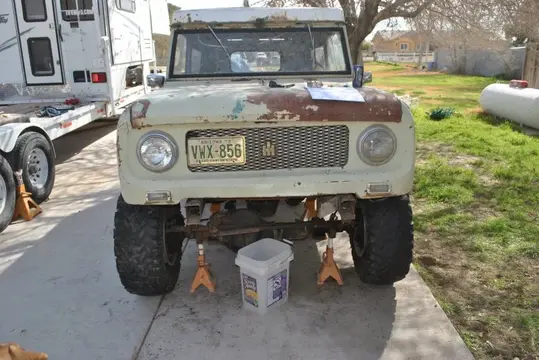

Axles showed up last weekend. They are out of a 95 HZJ75 pickup. Disk brake front, drum rear with integrated parking brakes. 4.10/4.11 gears, and a limited slip in the rear.
Widths appear to be 56" front and 55" rear. About perfect to increase the track width slightly without needing to hog out the fenders.
Now to hit the junkyard for some 57" chevy leaf springs and some Land cruiser 80 series front control arms.

Got the front axle positioned under the truck, and a set of 33's for scale (Probably going to run 33x10.50 or some 32" tall tires for 16" rims).
80 Series Radius arms with 10" travel coilovers. Be about 4" of uptravel and 6" droop. At this height there is just a bit of angularity to the draglink, and the control arms are basically flat. Should handle nicely on the street.

btw, the stock motor had the oil sump in the front of the block. There is no way I could have mounted the cruiser axle under it at this height with that oil pan. The pumpkin is resting against the oil pan right now, with 4" of lift.

The above pic also shows the back asswards engine oil pan. The sump is in the front instead of the rear. no freaking way I could keep this motor and swap axles...
