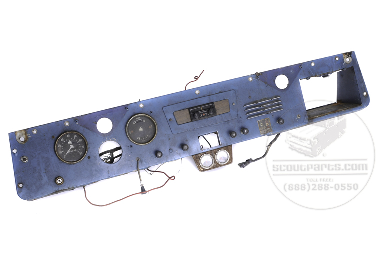

Here is what the dash looks like (pic pulled from the internets)
The main problem is that the opening in the scout dash is about 4.437" and the gauges are 4.15" bezel OD.

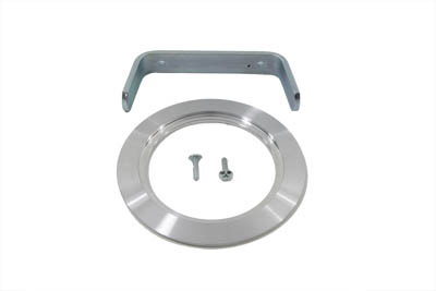

I have two choices, grab a couple 5" aluminum disks and make "halos" that can center the gauges (like this)
Or weld up the dash and drill new holes.
The "adapters" will likely look like adapters. But the dash is perfect and I hesitate to modify it. It is just a flat piece of steel, so it's at least easier to make look clean..
Thoughts?
Adapters....should be able to match the edge of the gauges to help it blend
