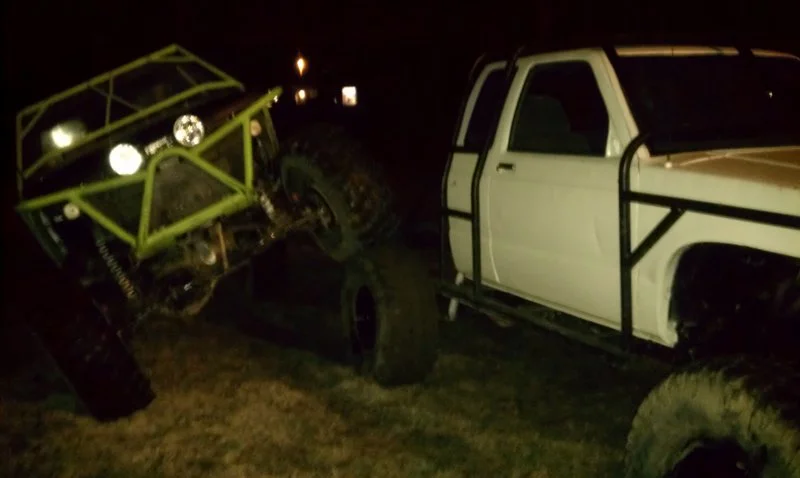

hey guys i know ive had alot of questions but now im looking to upgrade from leaf springs to a 4 link design i was just wandering i should go with coil springs or the Fox 2.0 Pro Series 16" Travel Emulsion Shock- .875 Shaft i have saw the coils in action but ive never ran with anybody with the fox shocks any input is appreciated. the white one
is the truck its going on

What year is that rig? What Motor? I'm sure we could put together a budget build for it
