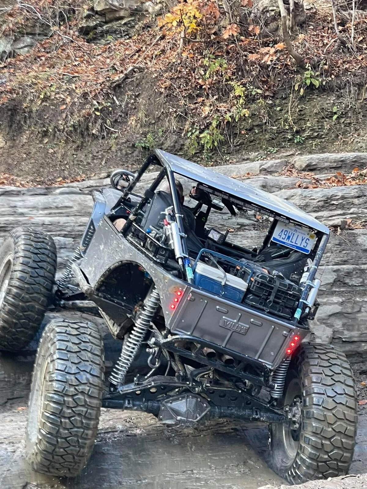

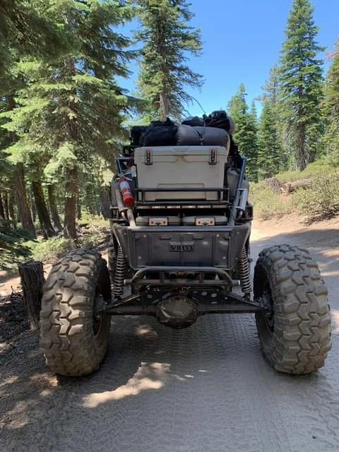

This is not really a build thread but more of a continued work in progress. I did not build this rig but rather bought it turn key. Whatever that means. :) I think it's really important to state that there are very few people in this world who are experts at everything. Some are fabricators, others are engine builders, others are suspension experts and others are electrical gurus. Finding a person who is a one-stop-shop is pretty hard. With that said, I want to add that I have nothing but high regards to the seller/ builder of this rig. I think he is an exceptional fabricator and built a very nice rig. With that, it still has/had some shortcomings which I am in the process of fixing/modifying/improving. Although I ended up changing some things I was not expecting, I would buy it again in a heart beat.
I will also say that I think the seller did not run it nearly as hard as I intend to run. So, it's good to say that I bought a rig that didn't have the shit run out of it. The down side is that I bought a rig that didn't have the shit run out of it - meaning that it was not pushed hard enough to find some of the weak links.
The drivetrain is pretty traditional. A healthy LQ9 6.0, TH350 trans, 203/205 triple stick, Chevy LP 60 front and 14b rear. As bought it had Grizzly lockers f/r and Yukon axle shafts/lockouts up front.
A little back story, I have been wheeling for 46 years (yeah I'm an old codger) and rode the wave of off-road evolution. For the last 20 years I have had a stout, stretched, linked, LS, 1 ton YJ that had all the good parts and was about as capable as a full bodied rig would be. (old build thread here WhiteRhino's Latest Mods ) For the past few years I have wanted a tube buggy to move to the next level but never pulled the trigger due to cost and loss of winter wheeling comfort and I am getting close to retirement. Last fall 2020 we were going to Trail Hero, YJ was prepped and ready and about a month before the trip I pointed out to my wife a nice buggy that was on line and she said "go buy it". Then we headed down the same discussion road of "lots of money" "close to retirement" "open and cold in the winter" blah blah blah and she finally threw down the ultimatum of "either go take the money out of the bank and buy what you want or never bring it up again". LOL Well, she drew a line in the sand.
So I reached out to Rich Klein to discuss what I should buy. After giving me his thoughts, I started shopping and sending him links. He would say "that chassis is junk" or "suspension looks wrong" and so on. Then a buddy from Minnesota sent me some pics and info on this one. After back and forth discussions with my MN buddy and Rich, Rich said it looked like a good buy. I reach out to the seller the next morning, talk to him by 9am, make the deal and wired him the money that afternoon. Well now I'm committed. I leave on Friday after work with a couple pals and drive through the night to get to Duluth. We meet at 7:30 in a Lowe's parking lot, load it up in my trailer and head back to Michigan.

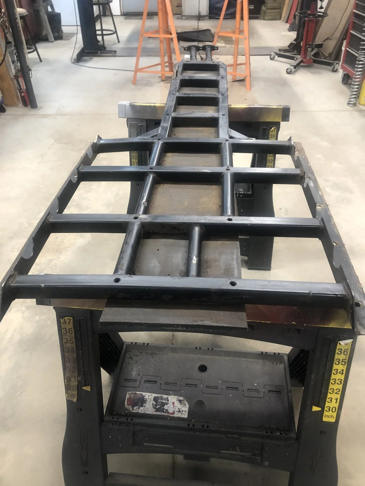

This rig is a pretty good looker. It's a one off, full tube chassis mocked up to look like an old flat fender. It's titled as a 49 Willys with lights and turn signals. It has made it into Crawl Magazine 3 times that I know of. First as a feature vehicle around 2017 (sadly I don't have a copy of it), once in 2020 on the Rubicon and once on the back page in a Yukon ad.

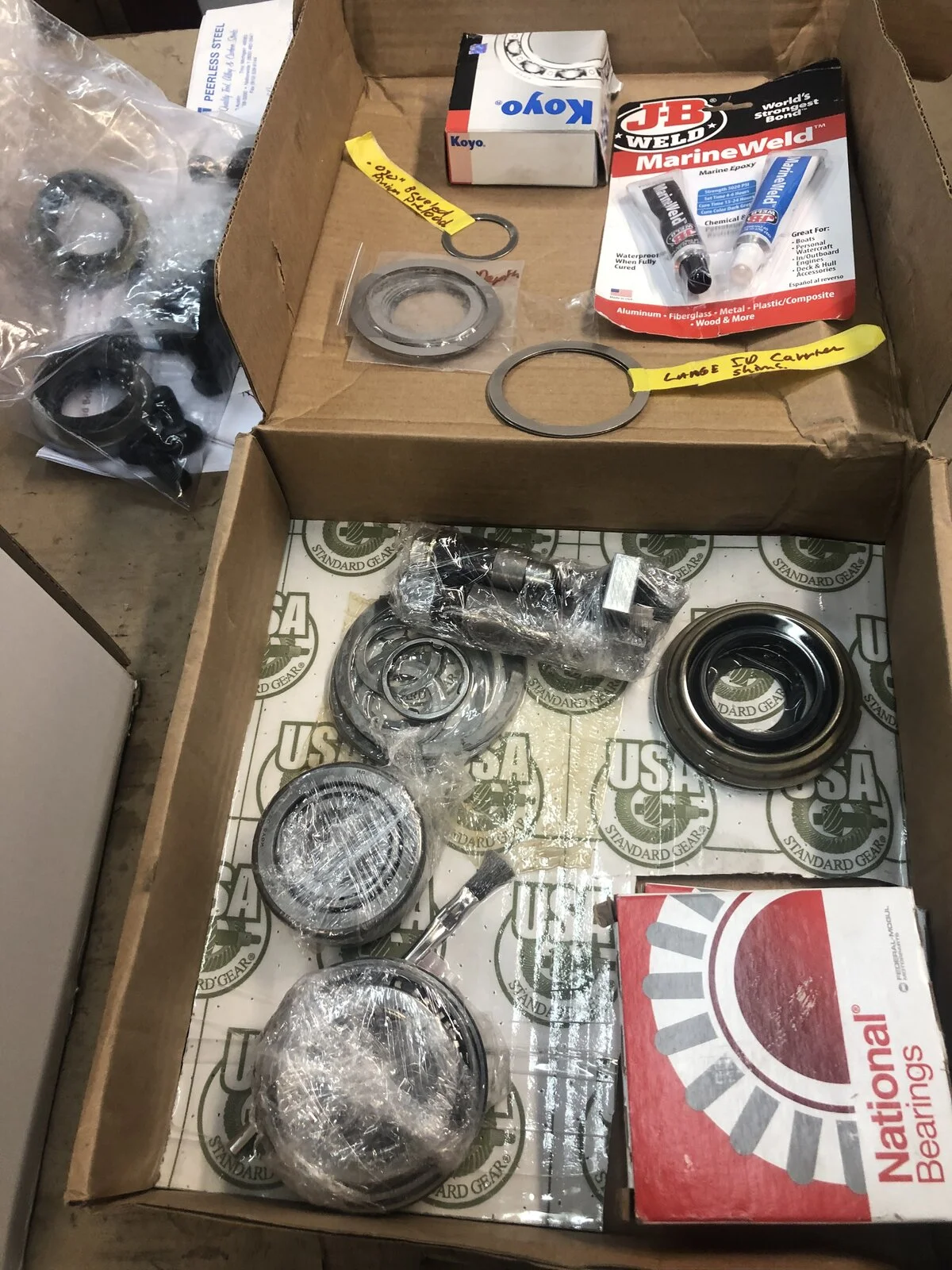

So I get home from Utah and order up a new transmission from Tranny Tom. (for those that don't know Tom, he builds the trans's for Casey Gilbert's 4800 car and several other U4 competitors so he's pretty savvy in the off-road transmission needs) In the meantime I head out to the local park to fool around and start playing around in the rocks. I can't say what I really did other than to say I got out of control on the rocks and got throttle happy. End result was a broken link bolt and a broken front ring gear.
One of the things I have learned helping the race guys is to run a longer bolt and cut the threads so that you get a full shank through the heim joint. This didn't have that and resulted in a fatigued bolt.
So I replaced all of my link bolts and switched from a 3 piece heim to TMR solid center rod ends.

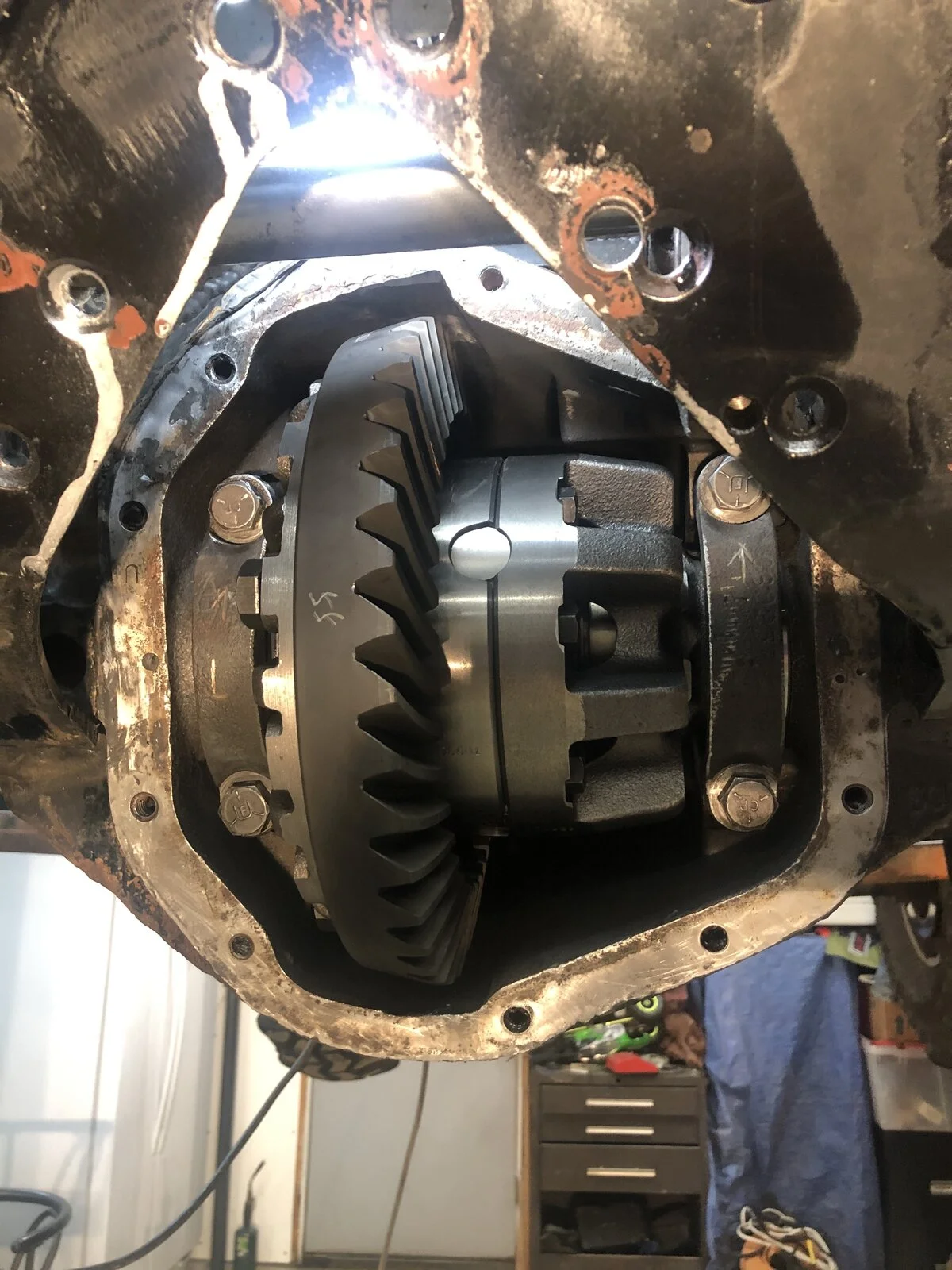

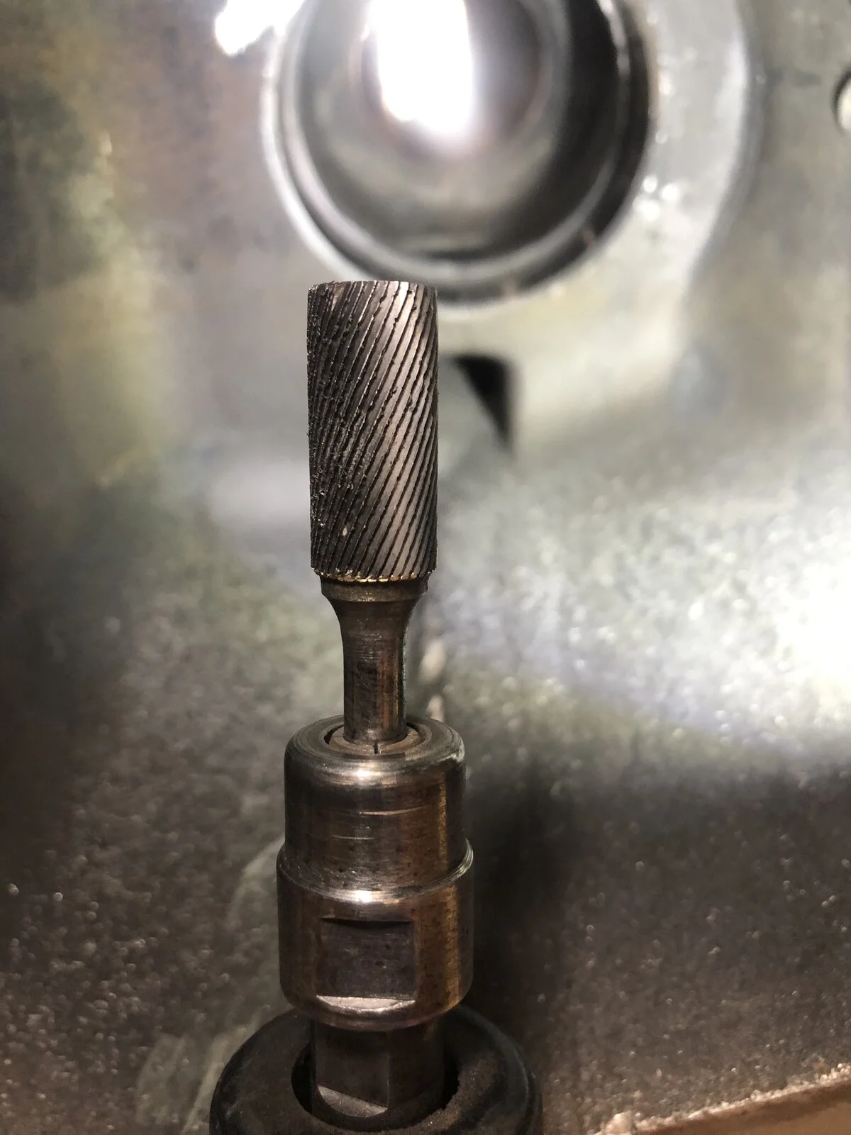

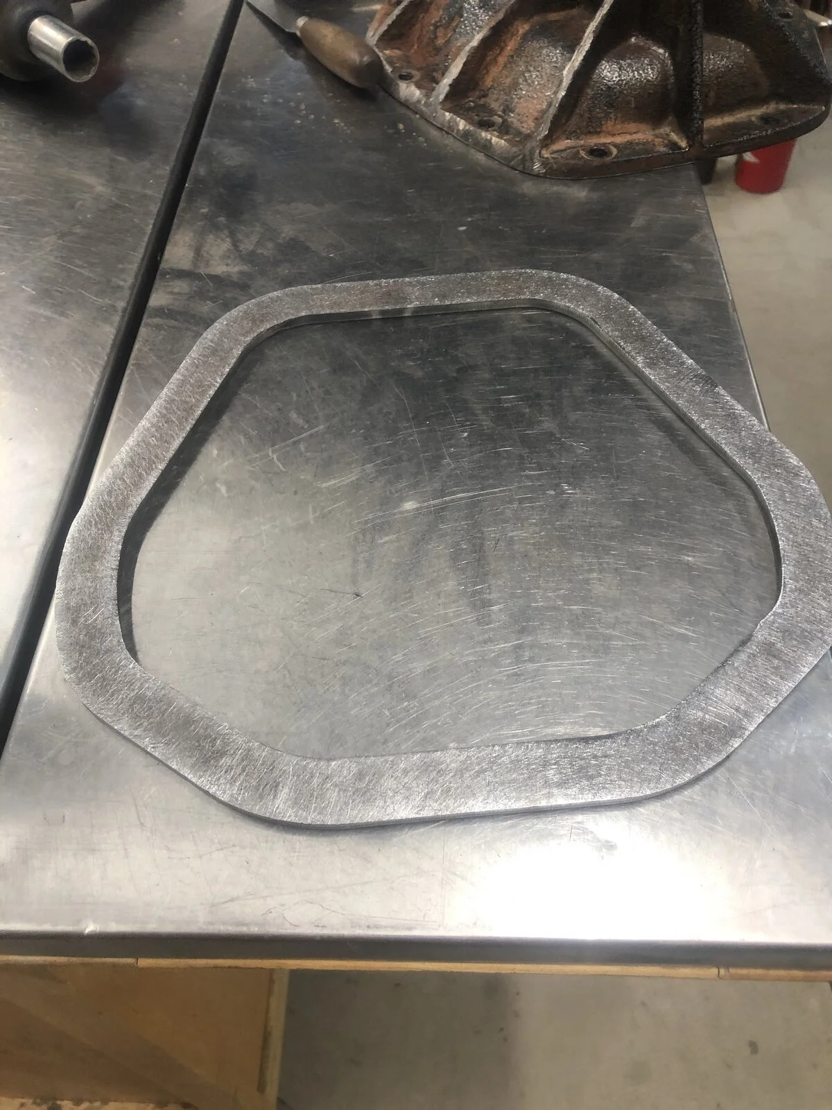

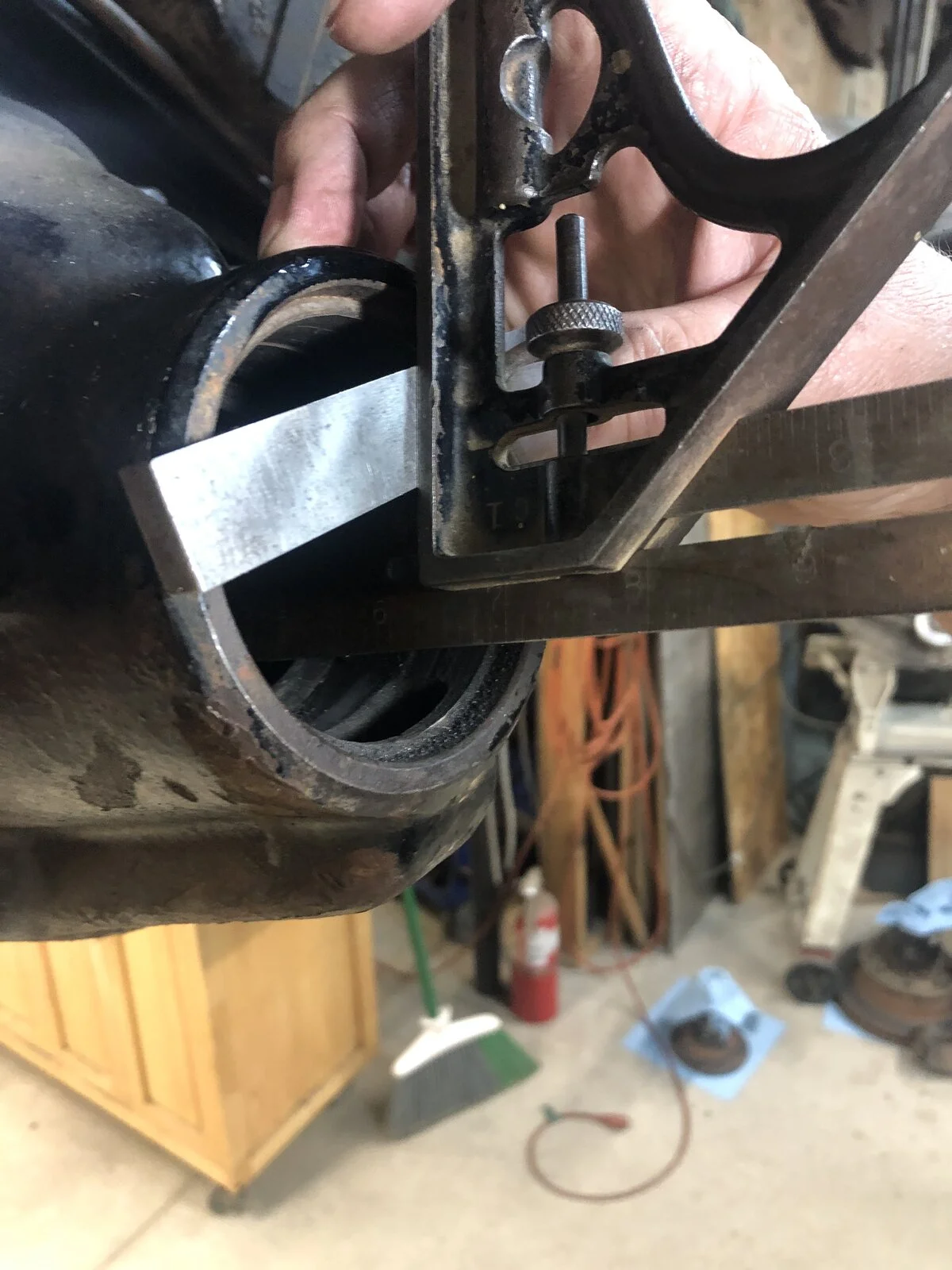

RE the broken ring gear, this is one item that I am disappointed with on this rig. My YJ had a Ford HP D60 and the Chevy LP is known to be weaker. Long story short, after research it seemed that the best course of action was giving a shot at the Jantz Jana76 conversion. In a nut shell, it's a Dana 70 gearset and carrier modded into a Dana 60 housing. Dana publishes a 33% increase in strength. After a talk with Carl, I ordered up a complete set including a new Detroit front carrier and Load Bolt. I have to say, Carl's system and directions are top notch. Installation was exactly as he predicted.
The housing requires some grinding.
Carl gives great instruction on where to locate the load bolt.
I preheated and then shot peened the shit out of the weld.
Due to the larger ring gear I had to make a spacer for the dif cover.

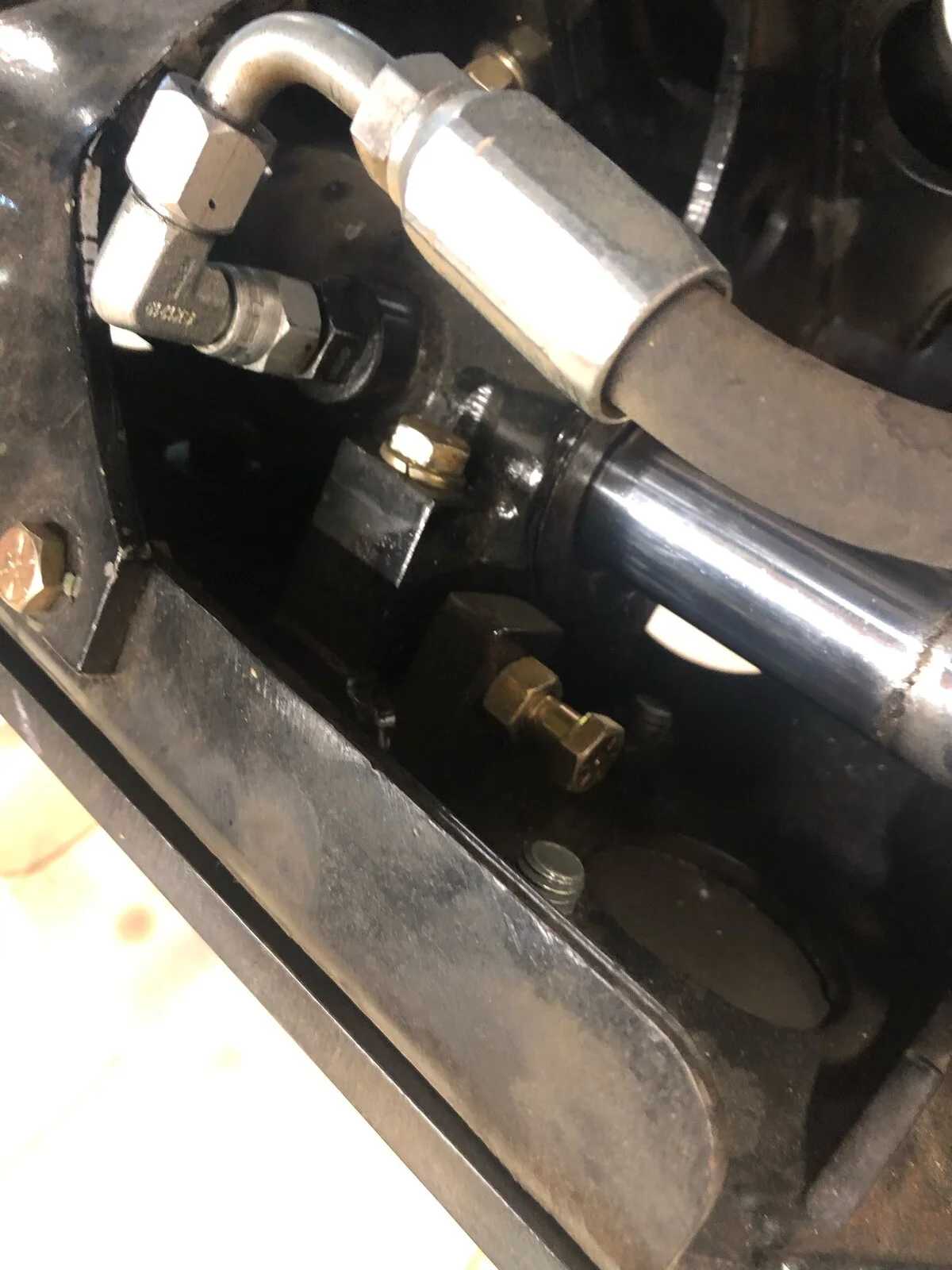

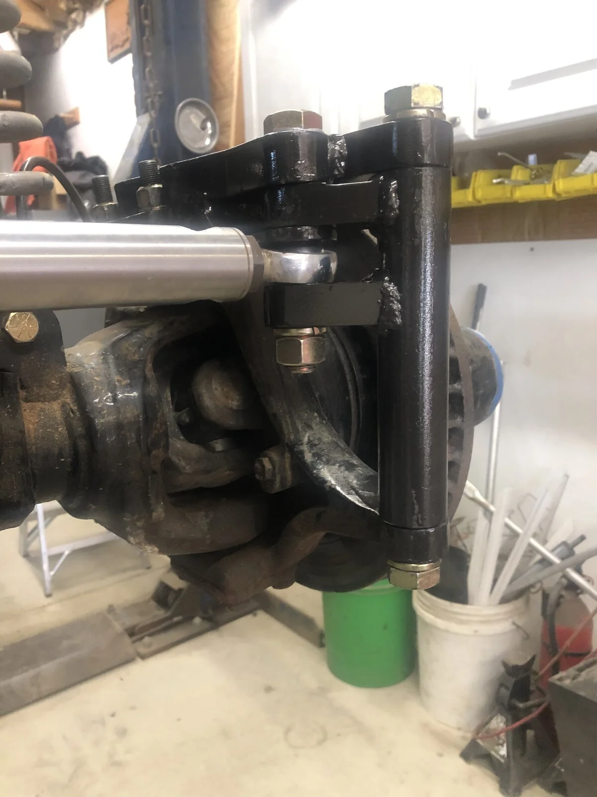

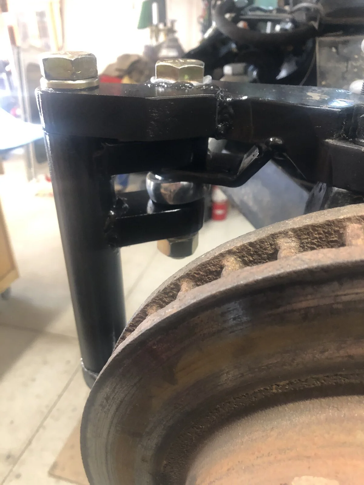

Backing up to my sheared hydro ram issue, when I got home I discovered that the Artec ram mount was bent which had stressed the bolts. I was able to get 3 out of the 4 broken bolts out and I could reuse the tapped holes. the other had to be clearance drilled and a thru bolt used. So how to fix? I took several approaches. First, I added a jam block on either side of the ram with a jam bolt and nut. This gives preload left-right so in case the ram bolts loosen up, the jam bolts keep it from shifting. Really hard to see in the pics.
Next, I added a support brace from the ram mount to the upper truss to keep it from bending. Note that Artec has an opening in this area of the ram mount to allow for the front dif to come in and out.
And finally I added a piece of 3/8 1045 across the entire front of the ram mount. This is something I learned on my YJ, that many front ram mounts are not really that strong when it comes to impact with a rock. I've seen more than one bend. So, a plate across the entire front with several bolts makes it darn sturdy.

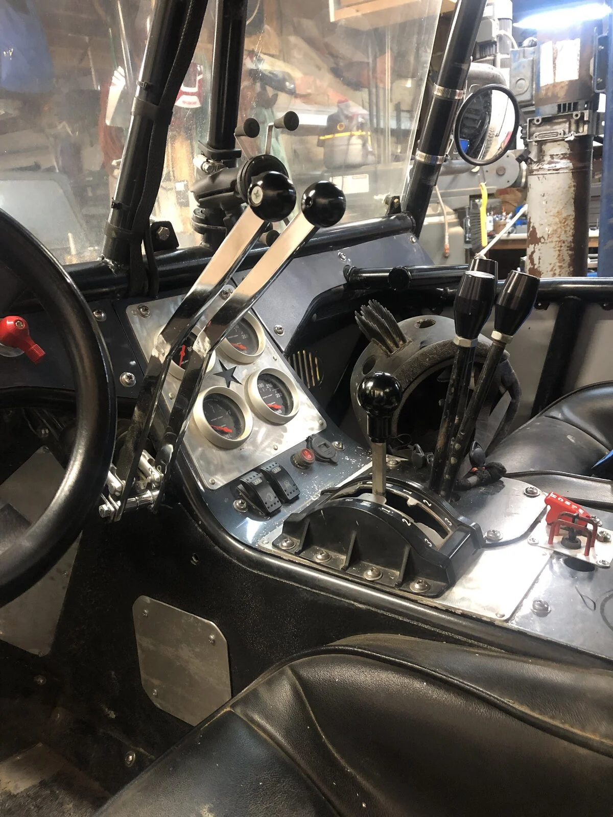

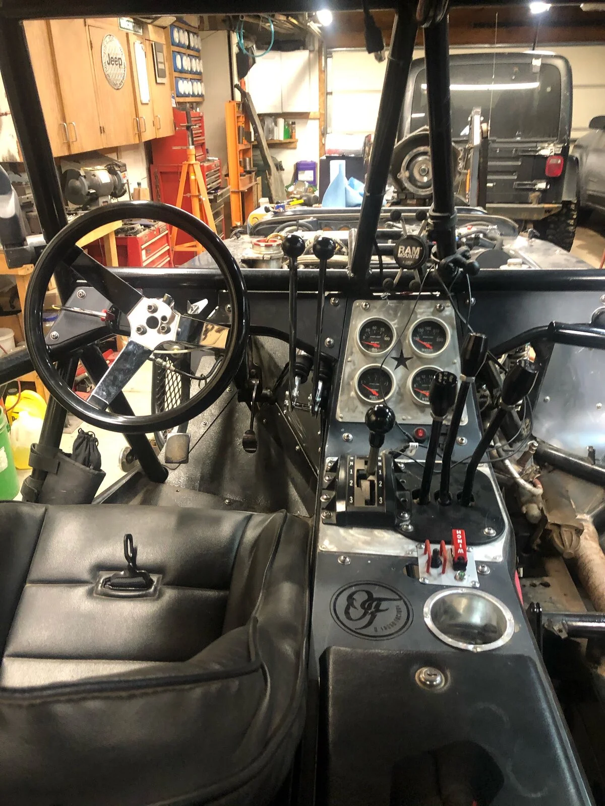

Back to the wiring/relay access issue, the switch panel has a nice relay/fuse panel. (can't recall brand name) Anyway, the way that it was mounted, it was about impossible to access. Plus, the radiator fan relay was buried inside the console tunnel which was a PITA to access.
Remove outer skin.
Remove passenger seat/harness
Remove inner skin.
Ugggg........
So, with the trans cooler relocated it left a nice area to relocate all of the relays. I moved the switch relay panel and also bought a solid state relay bar from Summit Racing. Now, simply remove the cowl and all electrics are accessible.

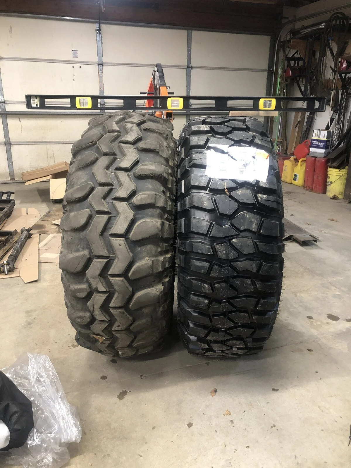

And of course we needed some new treads. I'll keep the SX's for snow, sand and road driving and use the 42 Reds for rock crawling.

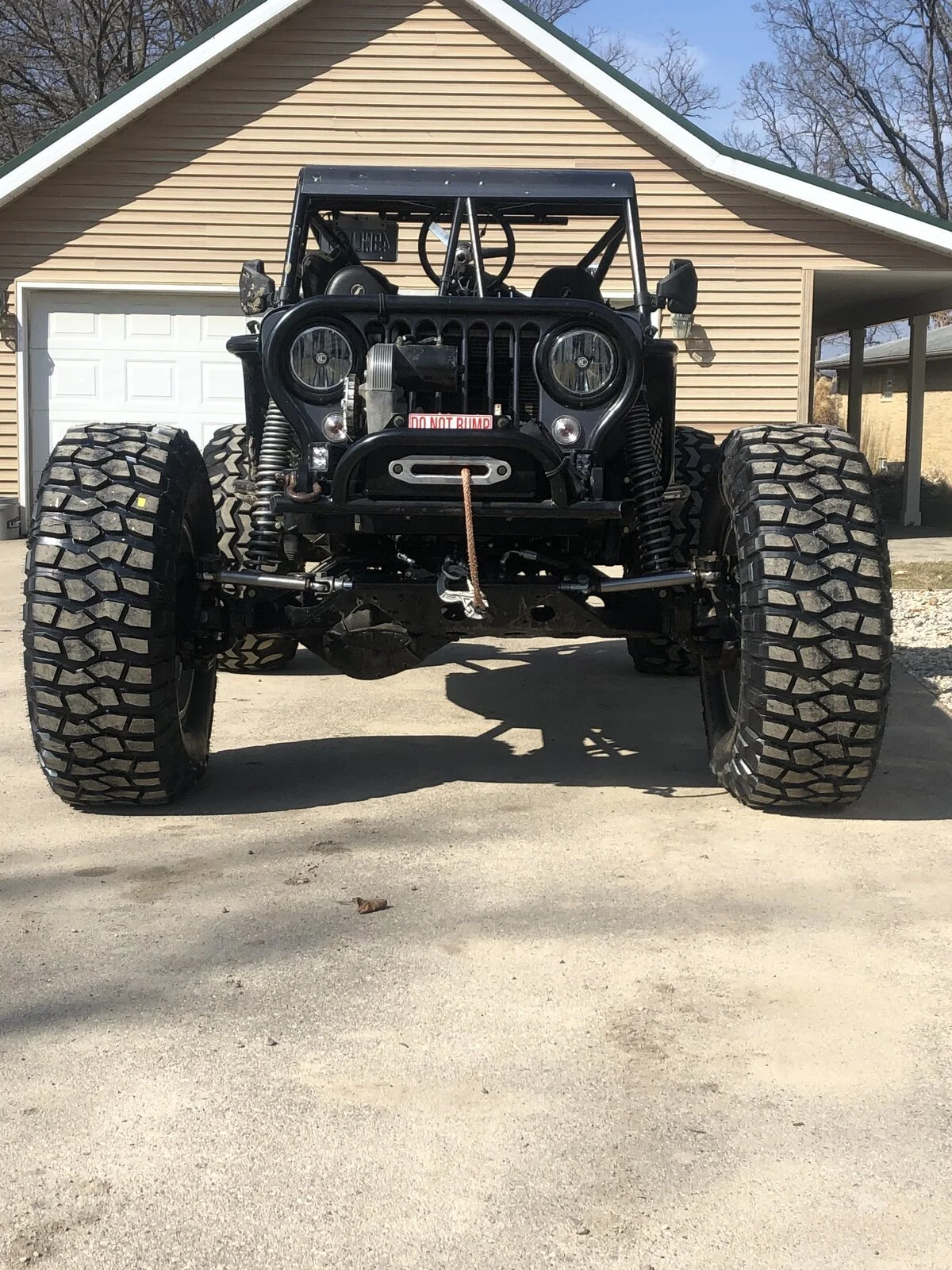

So the end result frontal view.

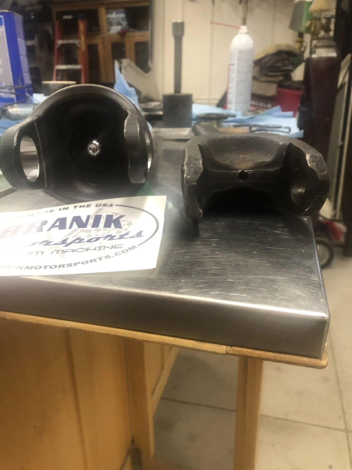

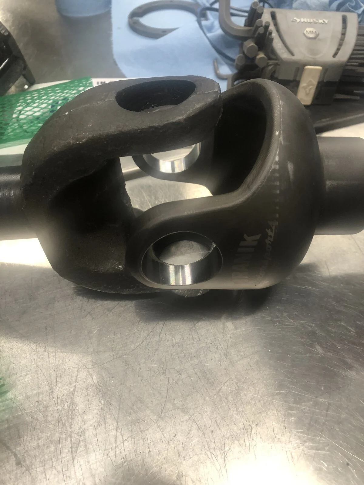

And later on our last day driver error bound up a tire and snapped an inner front axle shaft. No point in buying 4140 when you can buy Branik 300M. :) I'll upgrade the others as needed.

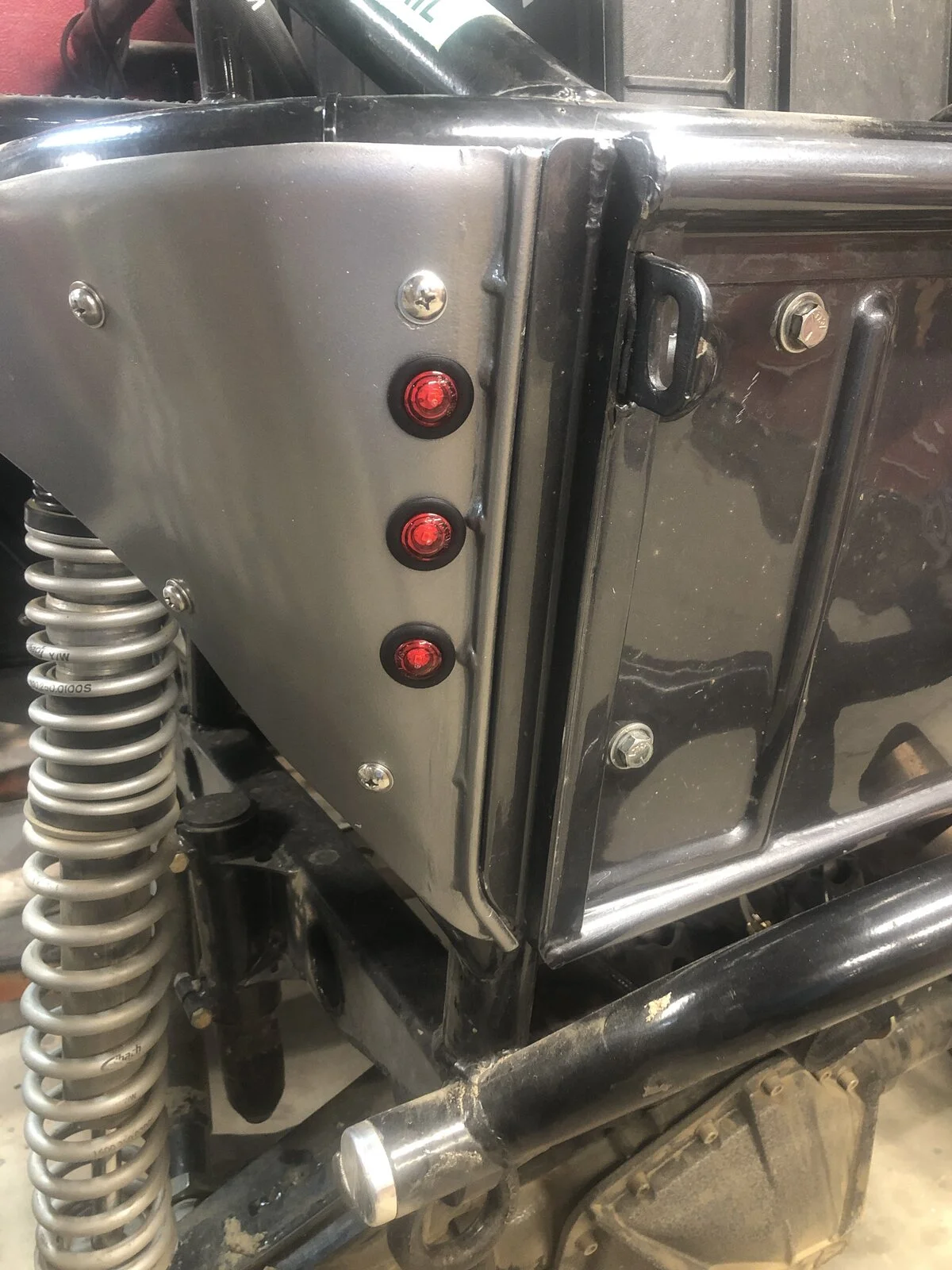

The race light bar has brake lights but they flash yellow along with the red. I really don't want to have flashing lights when street driving so I added a set of LED brake lights.

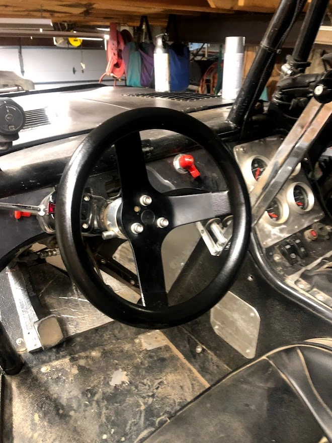

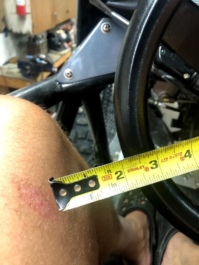

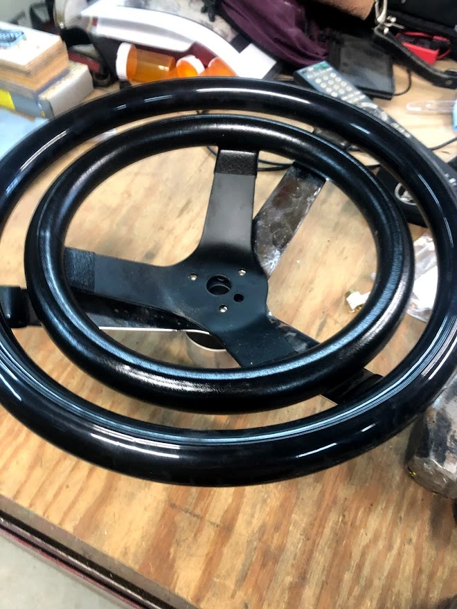

However, I had one oopsy. Dropping off a steep ledge I got jostled and since my leg is close to the steering wheel I got a rug burn.
So I ditched the 11" wheel and went to a 9" wheel. Now I'm driving a go-kart. LOL

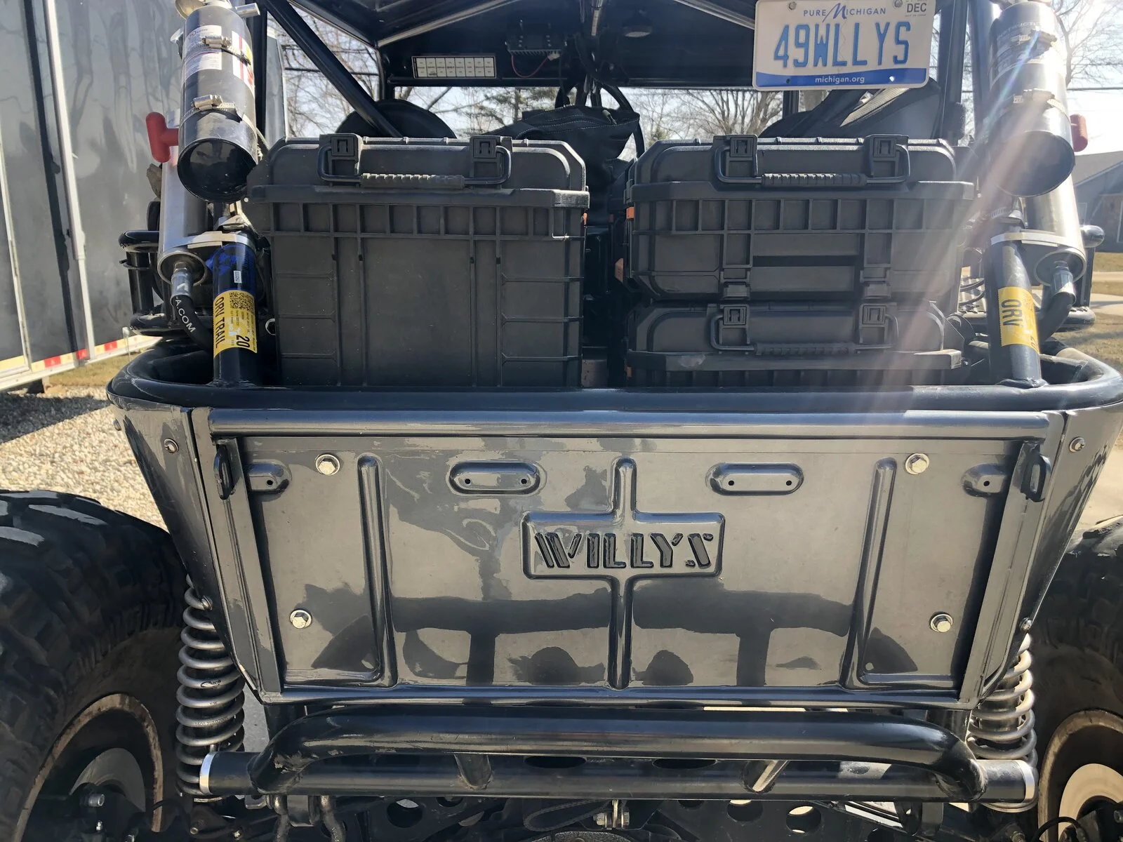

The grill and tailgate are OEM Willys. I really like how he cut the tailgate down and the overall look of the rear. This is as-bought. Note the totes, rack and light bar.
The light bar was attached to the rack, so to get to the totes in the lower storage area, the rack had to be removed and the light bar unplugged. I don't expect to pack it for big trips so I moved the light bar to the back of the roof (which you can't see in this pic) and switched to Rigid stackable tool boxes. This is a great pic of the narrowed tailgate.
The thin box on the above pic houses my Ready Welder. For not so big trips where the welder doesn't come along, I pared my tools down to 2 boxes - which is still too much. My tools weigh 97 pounds. But, I now have all my recovery gear in a tote in front of the cooler, and a bigger cooler. Next step is to get all the tools in only one of the big boxes. Fire extinguishers also got moved to the bottom side of the cage. No point in smashing them in the event of a flop. Light bar is visible under the roof.

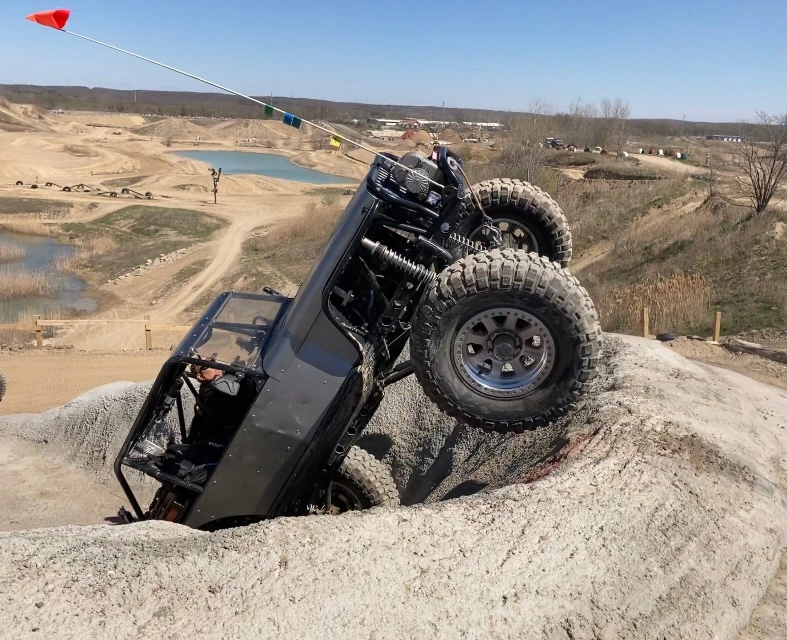

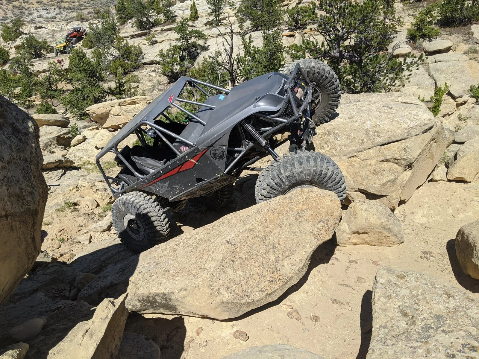

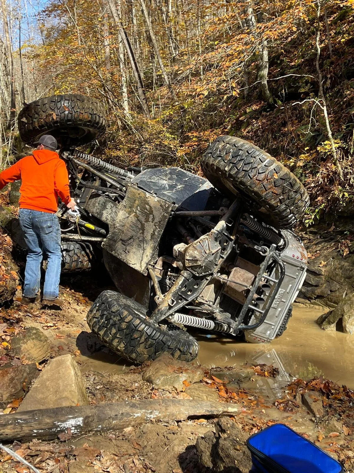

Flop? That shit don't happen. LOL Glad I moved the fire extinguisher. Nice view of the UHMW skid plate. Speaking of the UHMW, it is not holding up on the leading edge at the frame rails. It's actually worn back about 4" on each side. I just ordered some AR400 and plan to do a combo of UHMW in the middle and AR400 on the sides. The UHMW has been held with flat head screws and big washers and you can see that they are losing the battle with the rocks. This will change also.

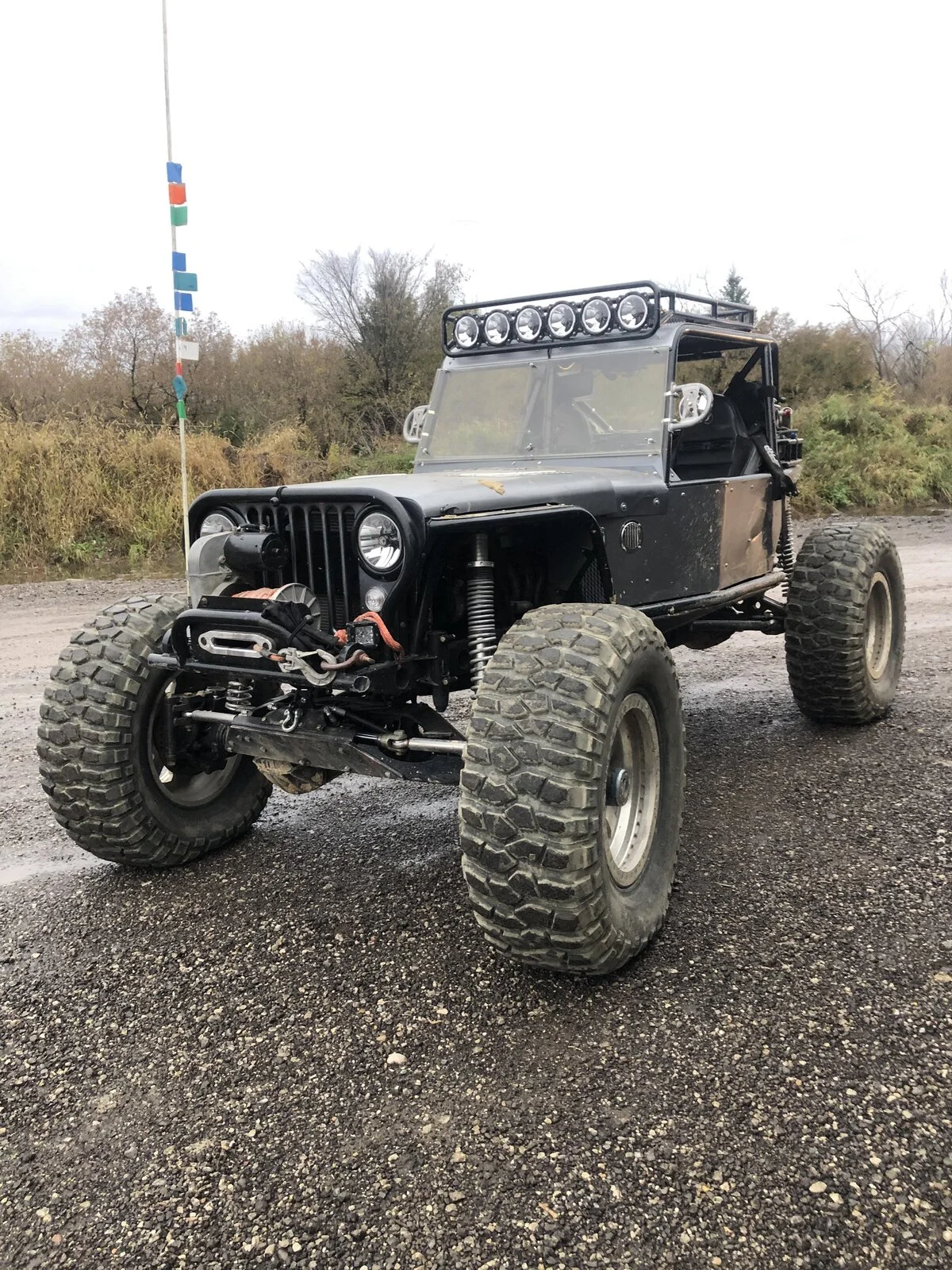

I'm still struggling with color. The buggy came with a non-spray bomb dark grey. Nice until it needs a touch up. Plus, I like a lighter color. I'm a believer that for a rig that will get scratches, a spray bomb color is the only way to go. So, I opted (for the moment) for Rustoleum Hammered Pewter. However, I would still like to get a pop of color but can't figure out what to do.
Color as bought.
Pewter. Likes, dislikes? Thinking maybe a red strip of some type. I like the green that I had on my YJ wrap but it may look gaudy on this rig. I'm hoping to make it "classy" vs "flashy". Still pondering..........

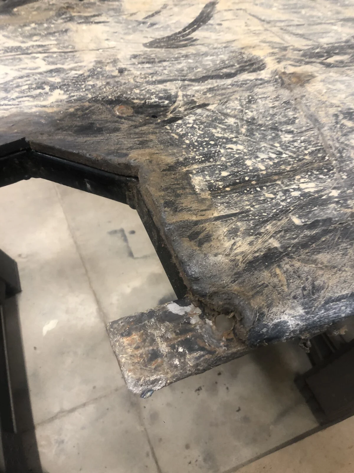

Thanks. I plan to add tabs welded on the inside of the current skid framework with weldnuts. Then 3/8 Grade 8 hex bolts up from the bottom. They get skuffed but unless I allow them to wear away I can pound a socket on them to get them loose - then just swap out the bolts. TSC bolts in bulk make it pretty easy. The buggy goes up on the hoist after almost every run so it's not a big deal to swap them.
I ordered 1/4" AR400. Kinda wishing I had done 3/16" but oh well.
