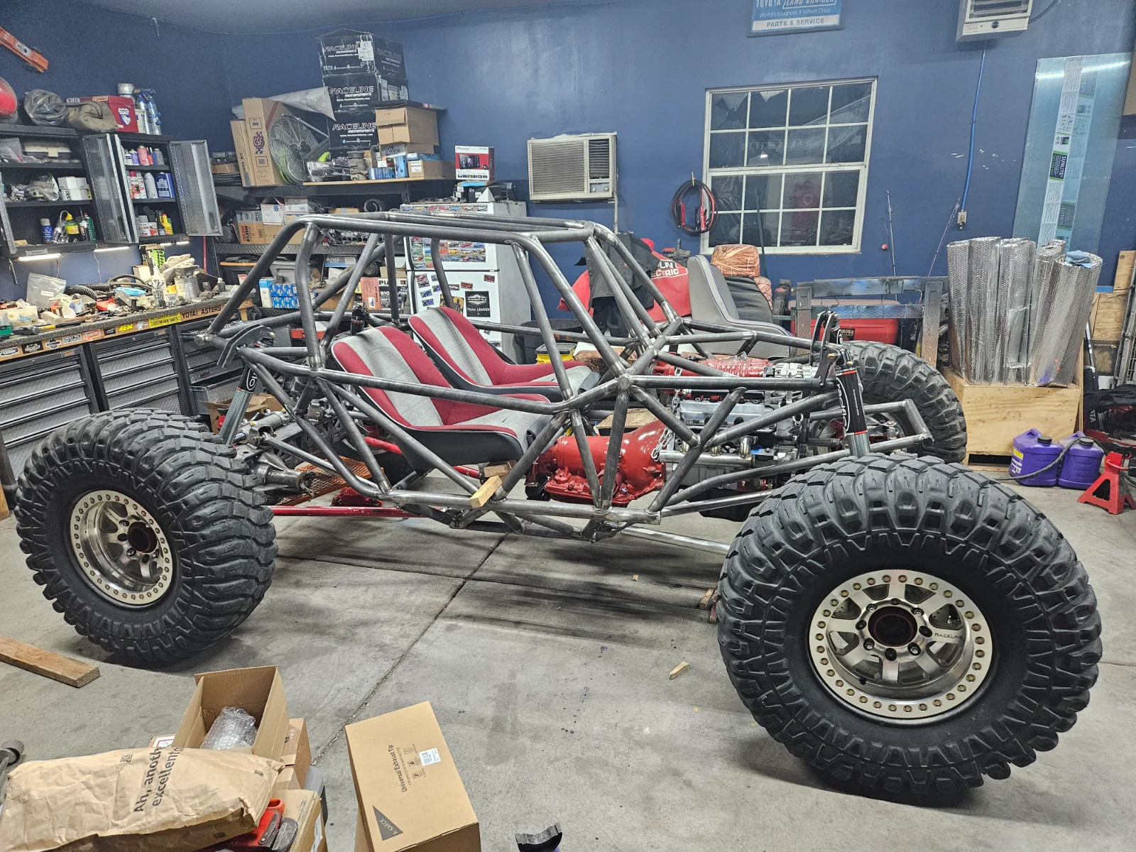

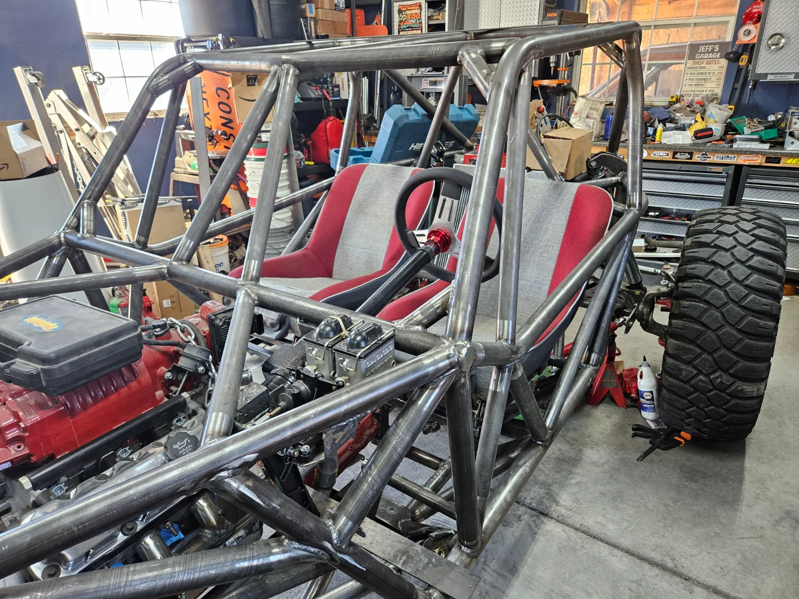

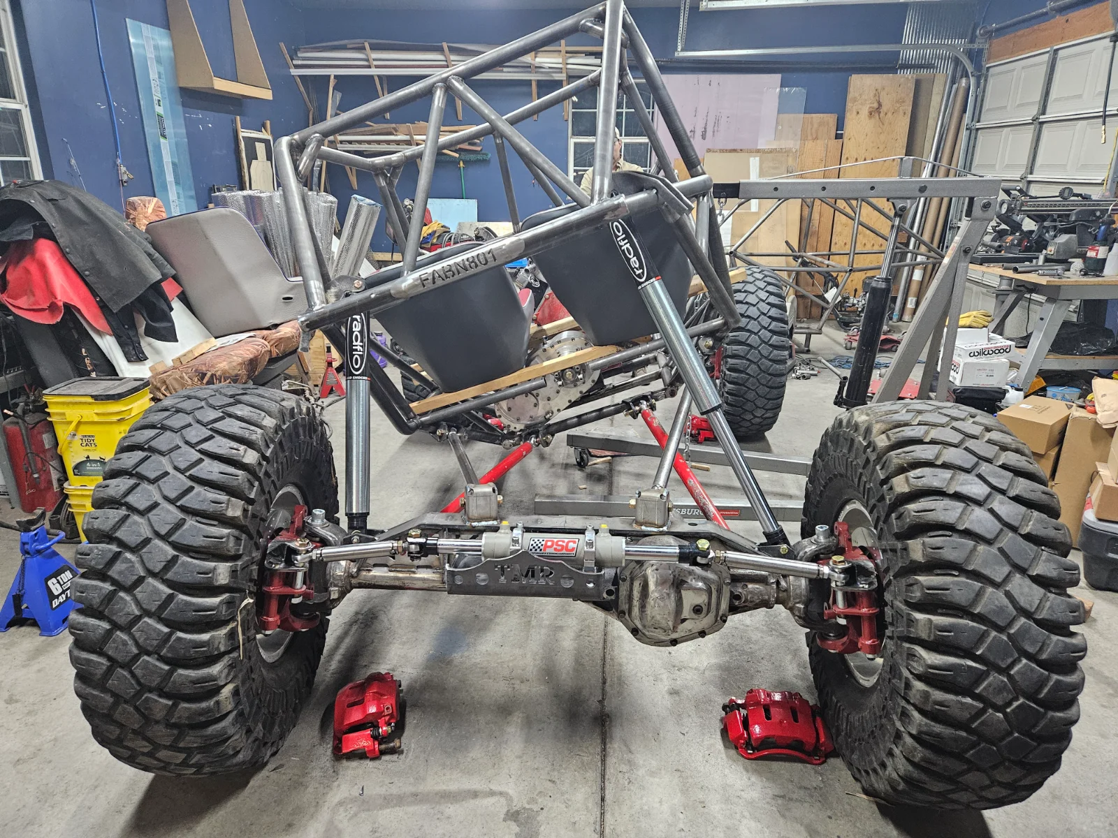

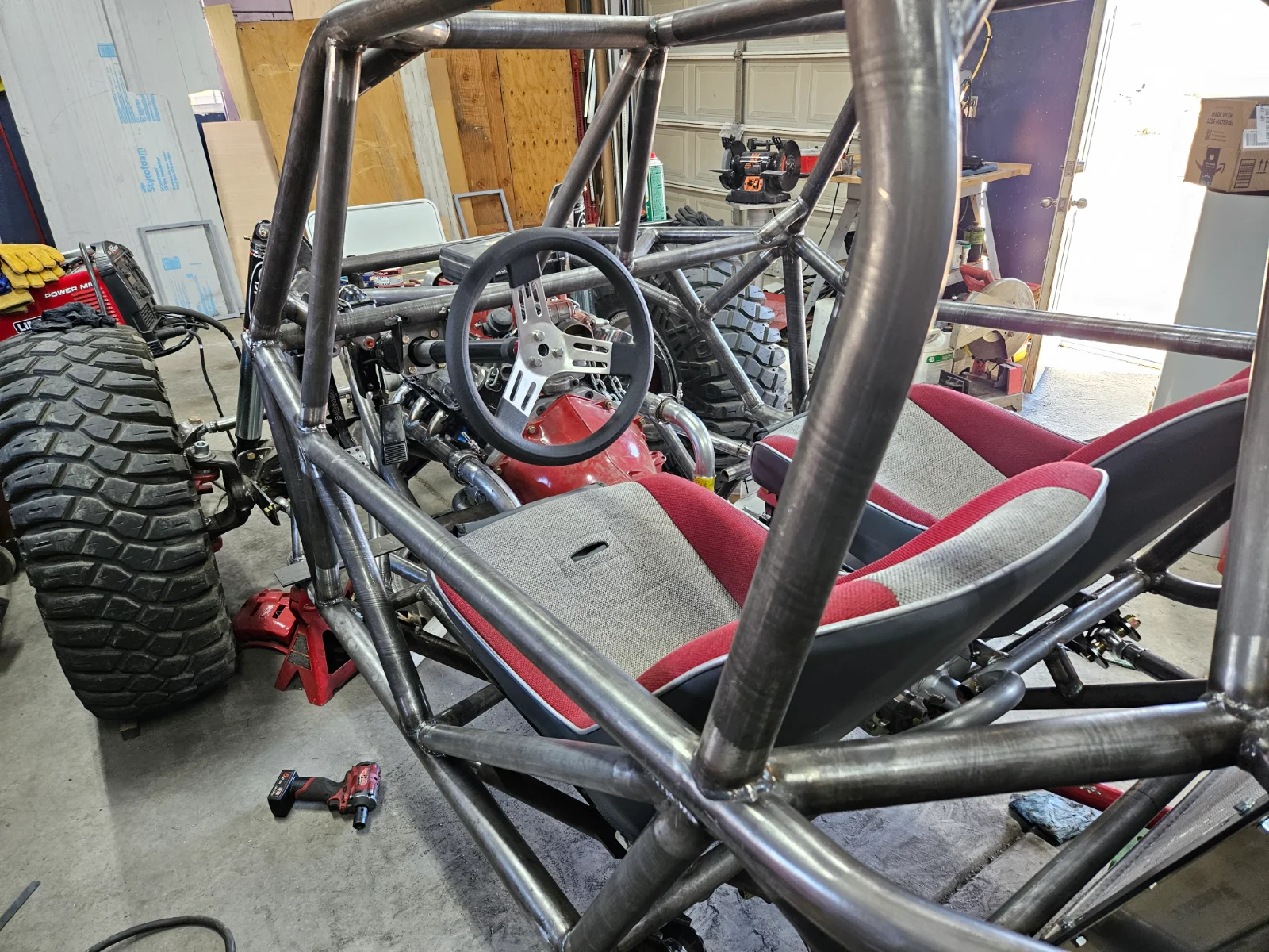

Build Gonna start a new build

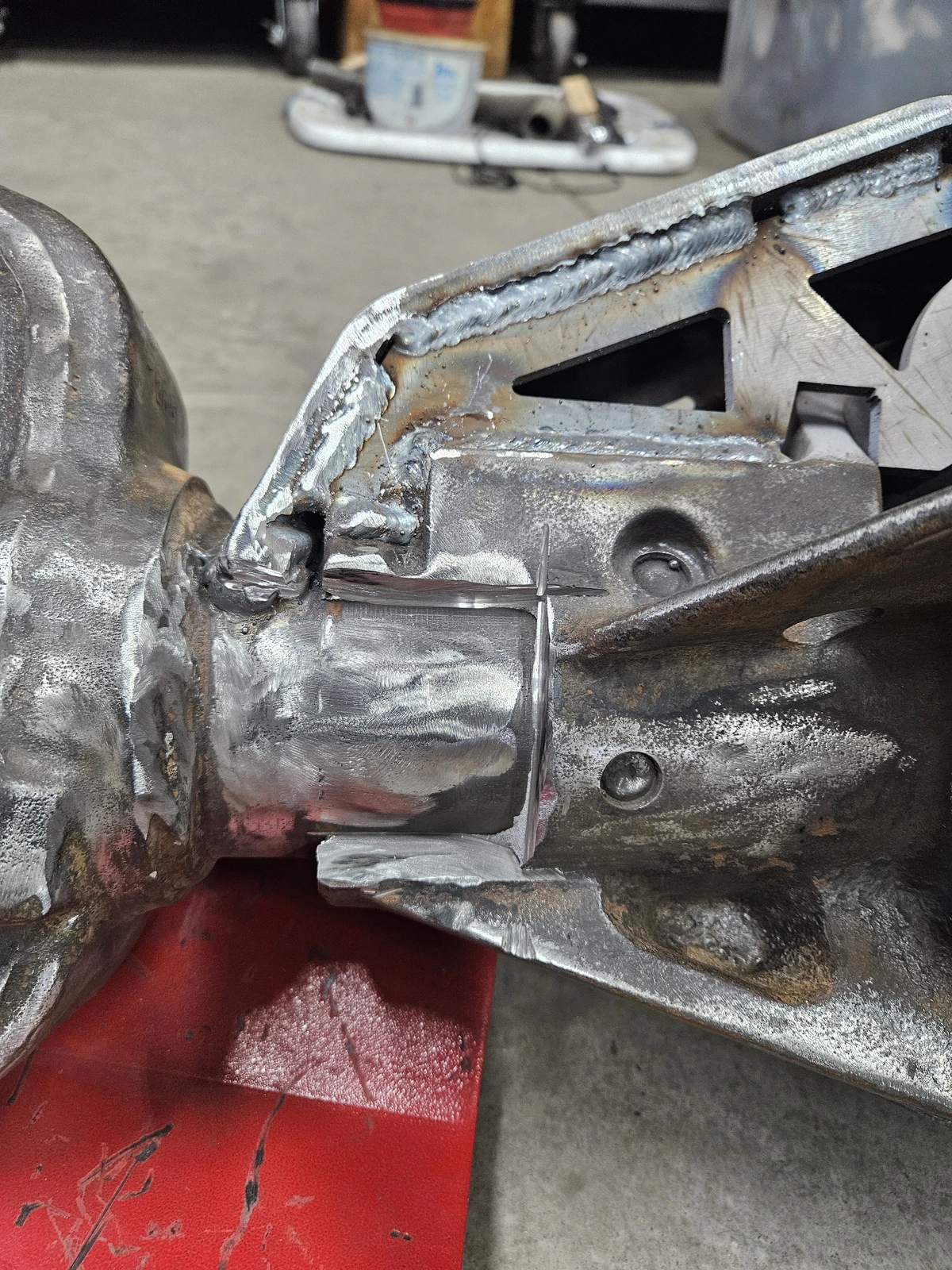

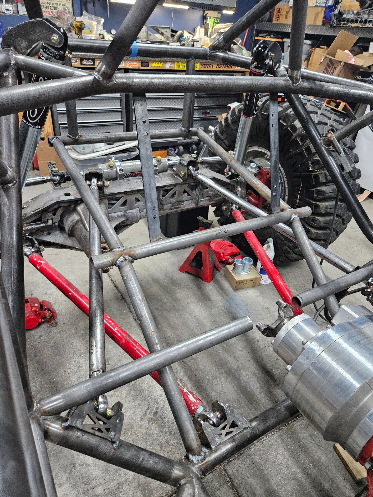

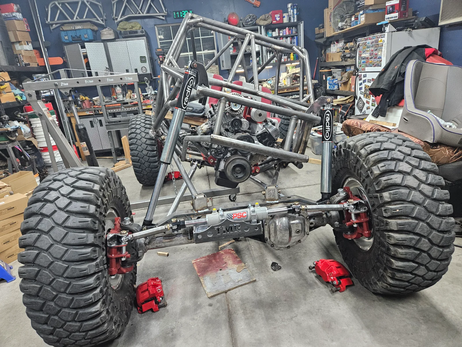

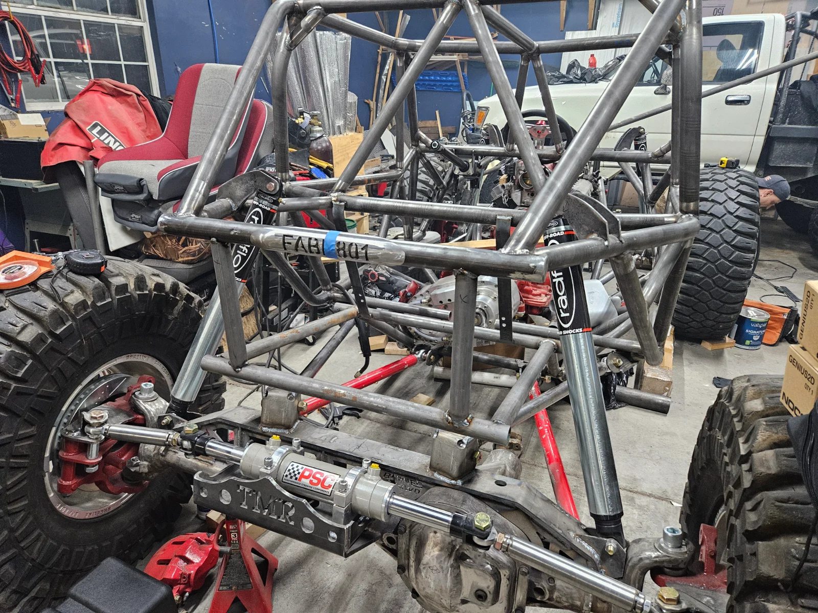

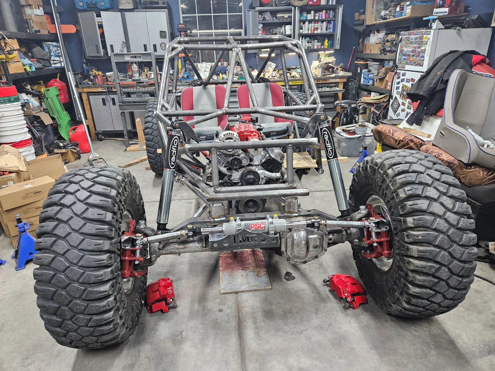

Ran into a couple of issues getting the links and shocks mounted.

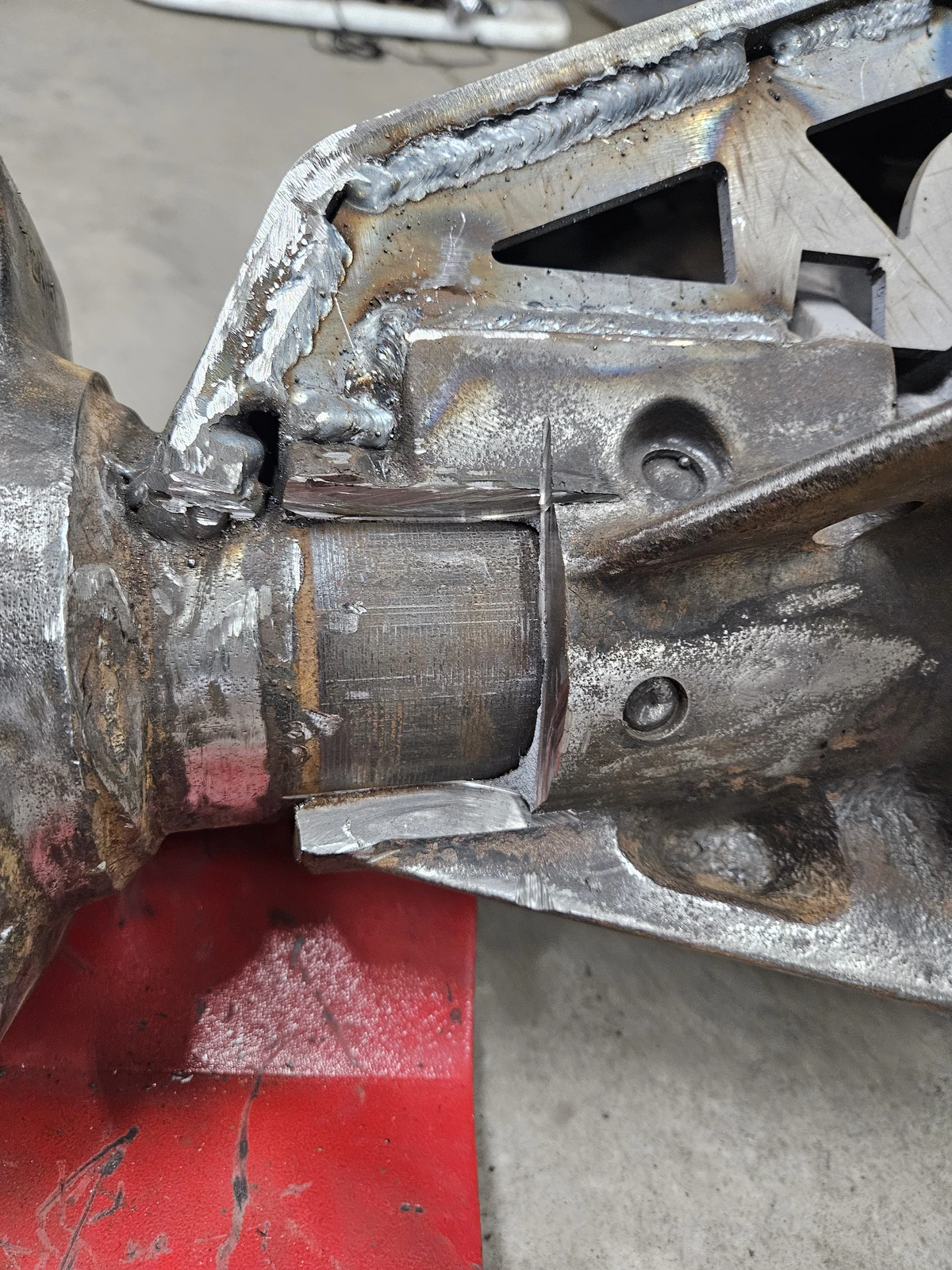

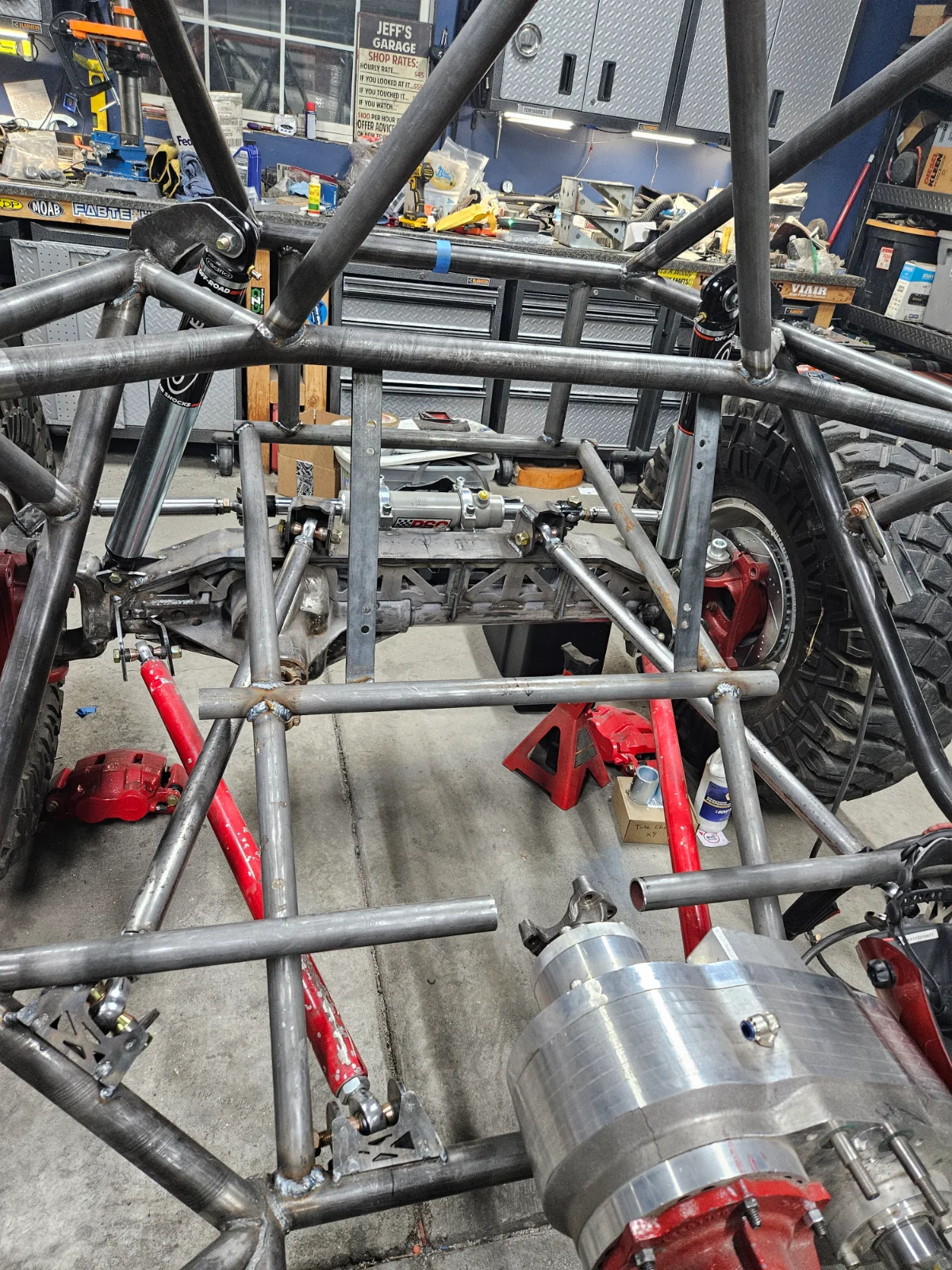

First the links. On the short side of the axle housing there was really no place to attach the lower link bracket except to the cast steel on the differential section. 😬
So out came the cutoff wheel.

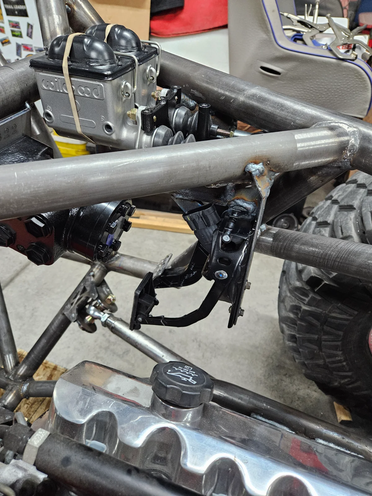

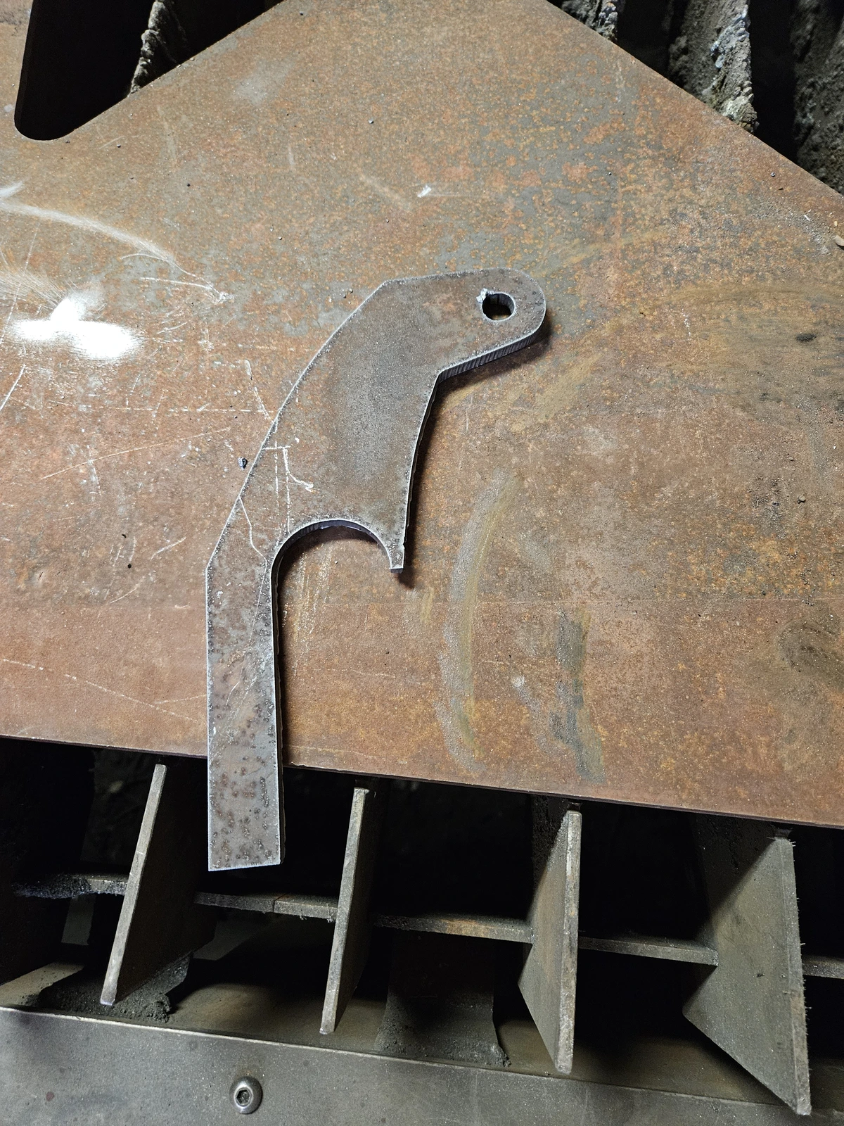

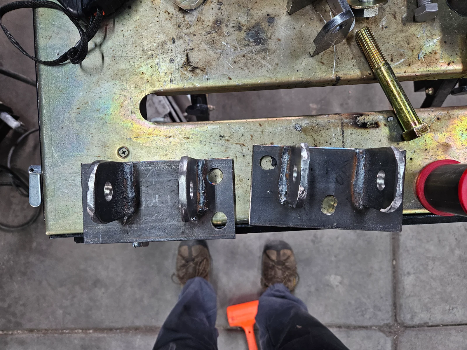

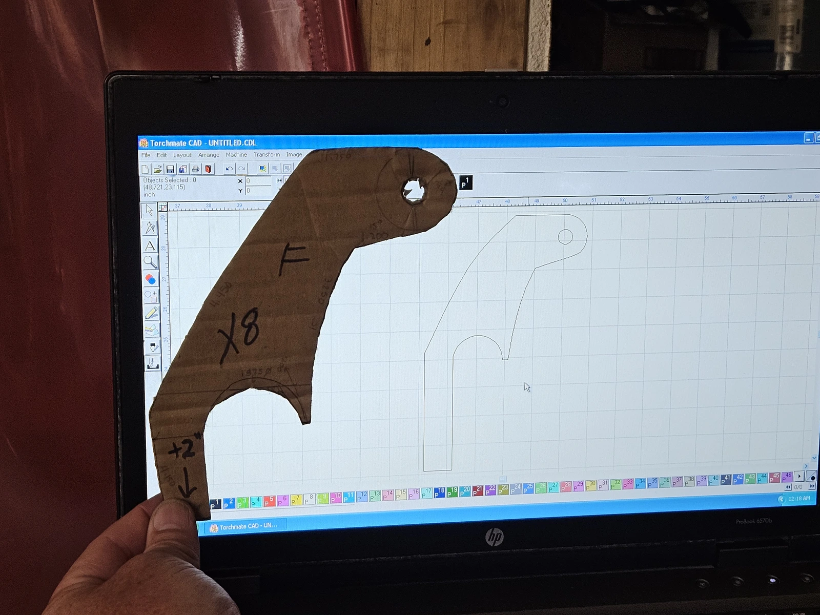

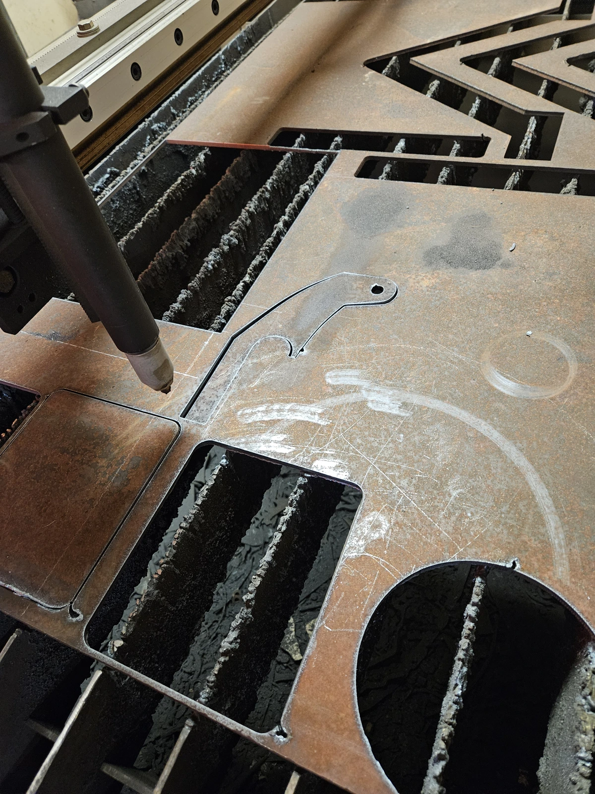

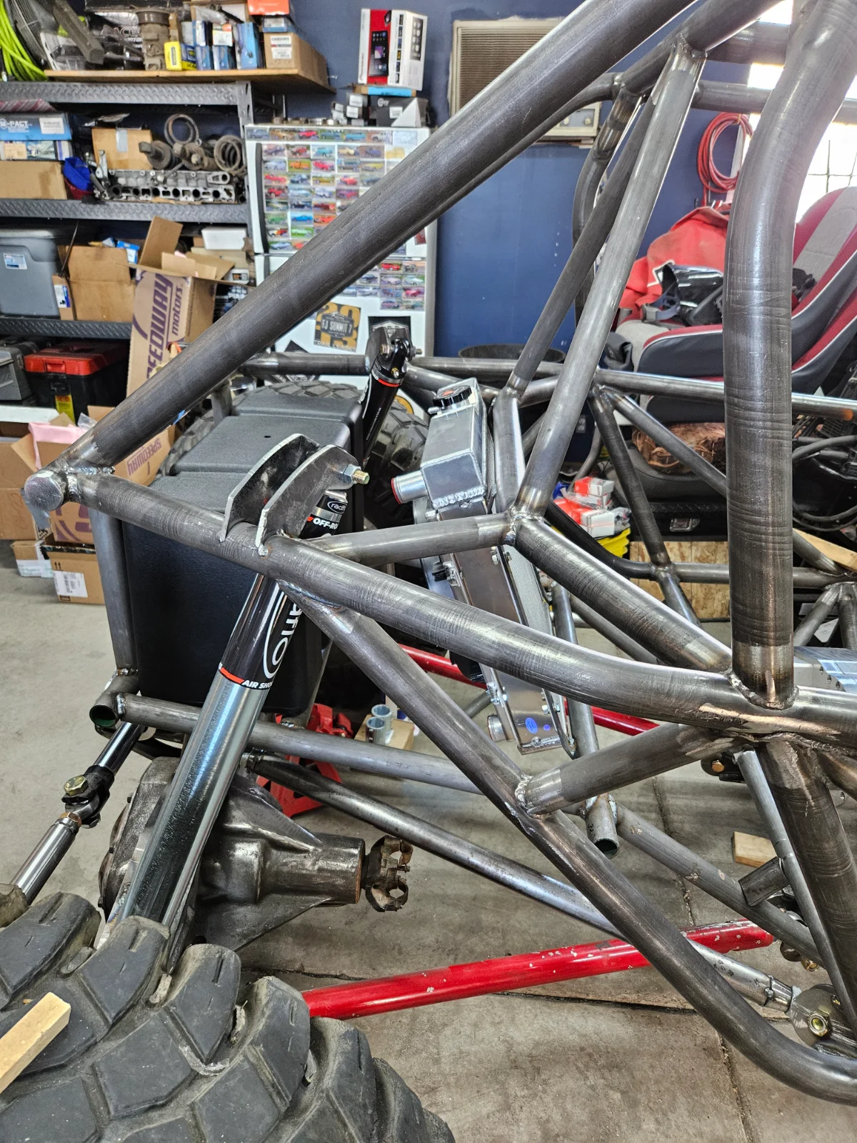

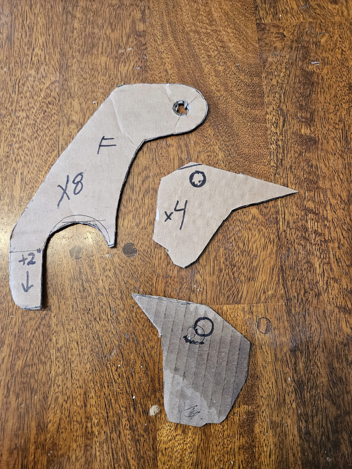

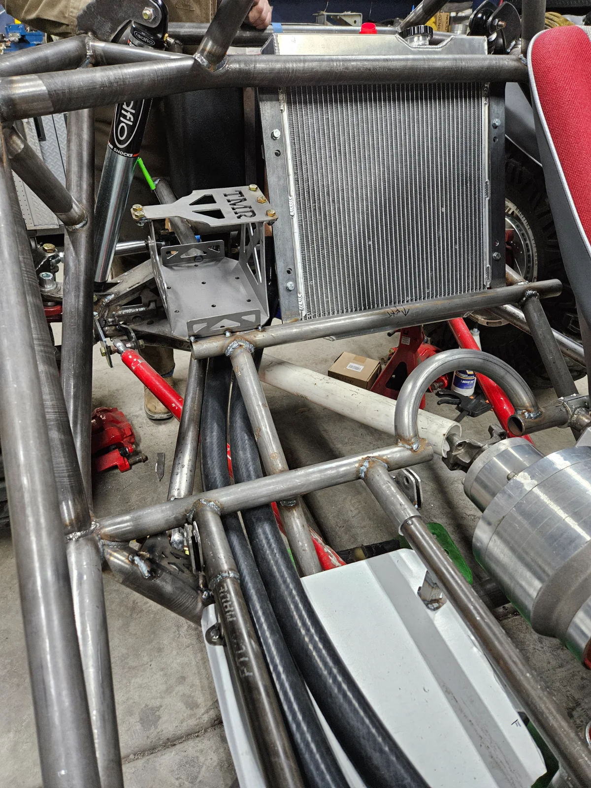

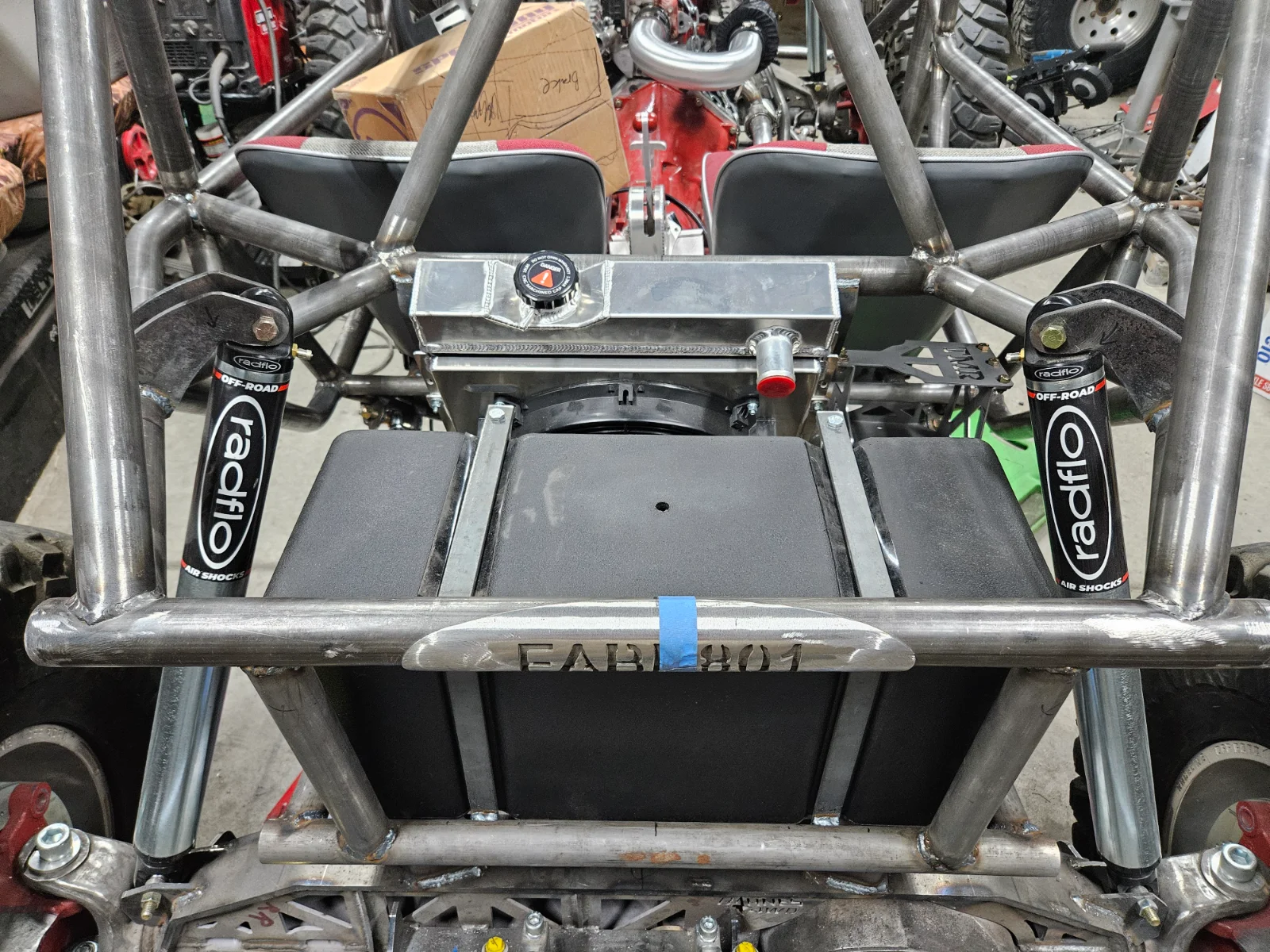

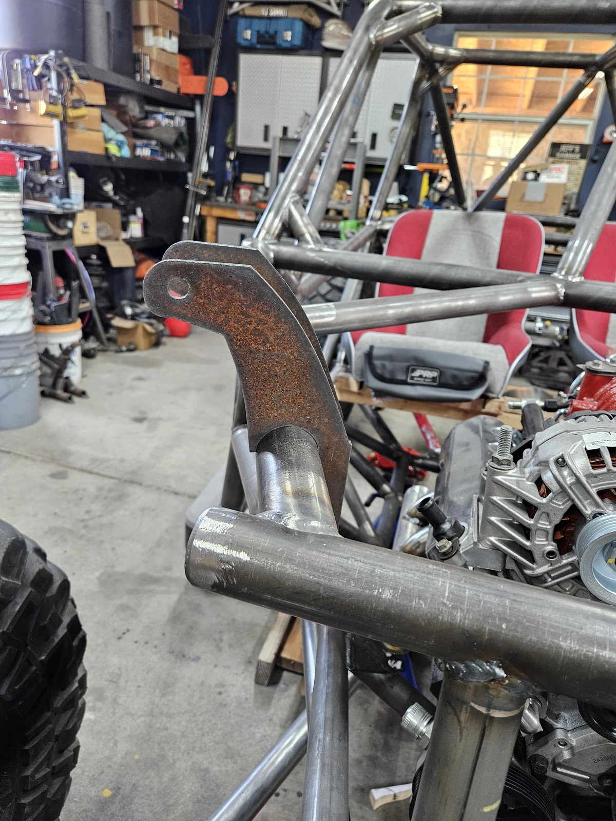

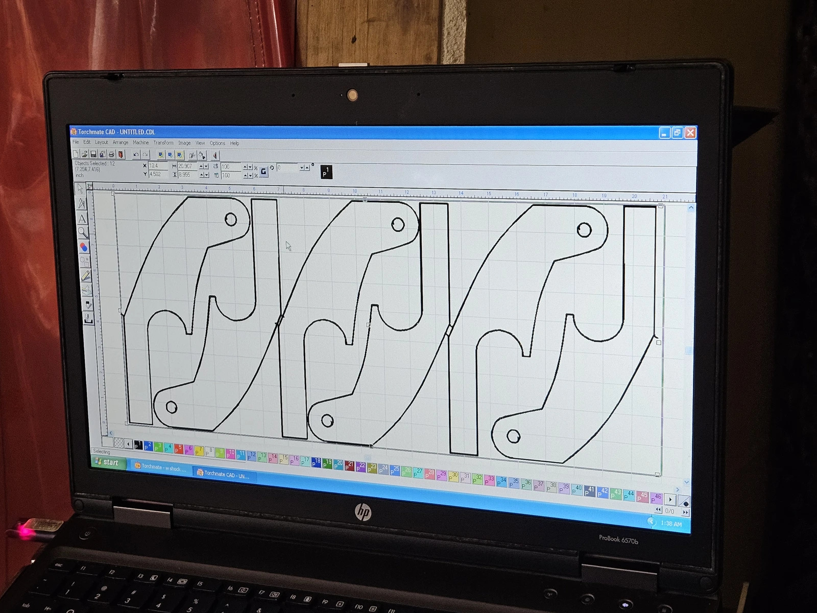

Next was the shocks. Again with these axles, mounting was an issue. There was also the issue of the shock mounts on the chassis. After some thinking and measuring it was off to my buddies CNC table with some CAD (cardboard aided design) templates.
Here's what we came up with.

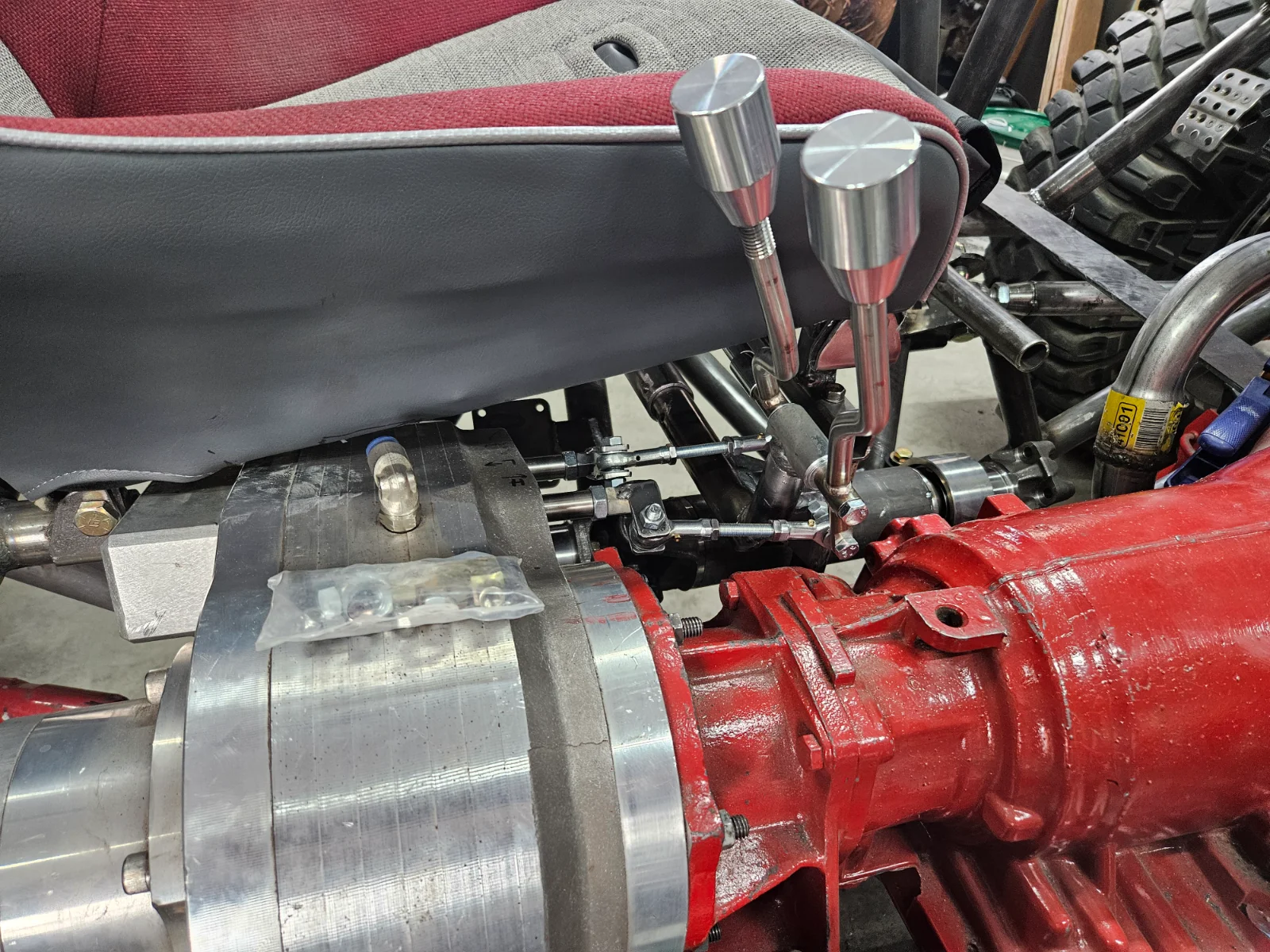

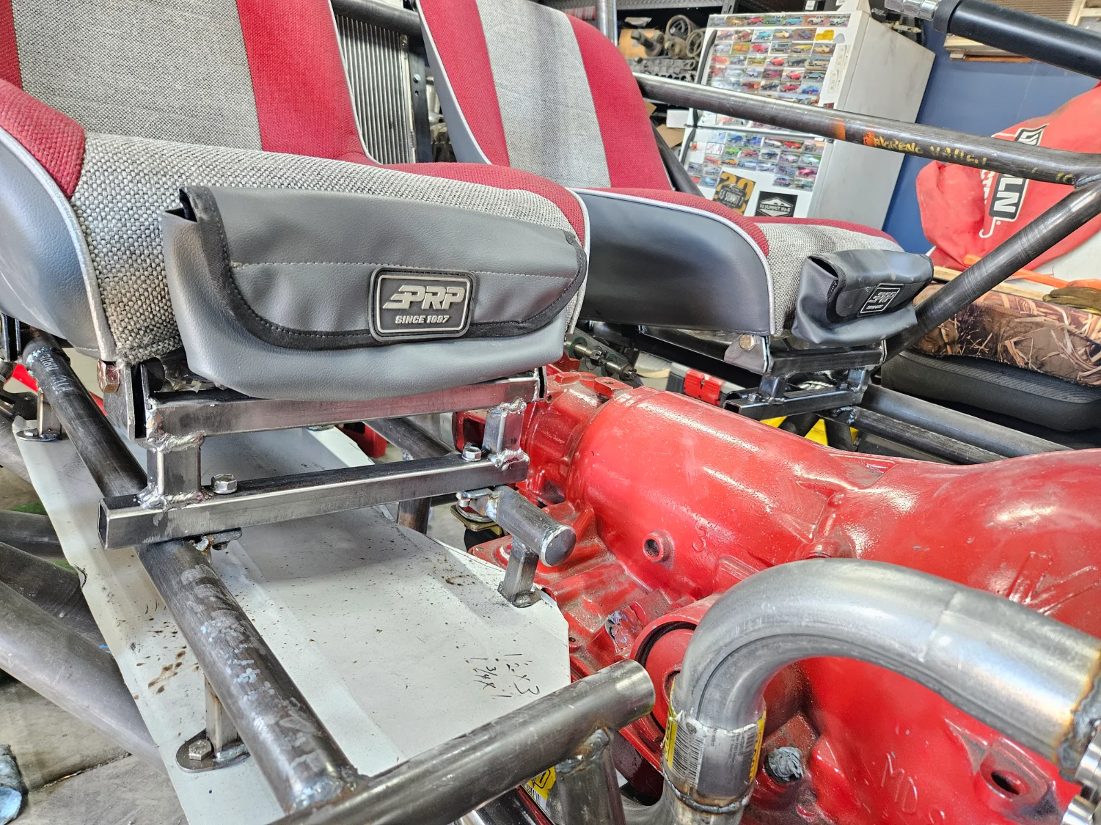

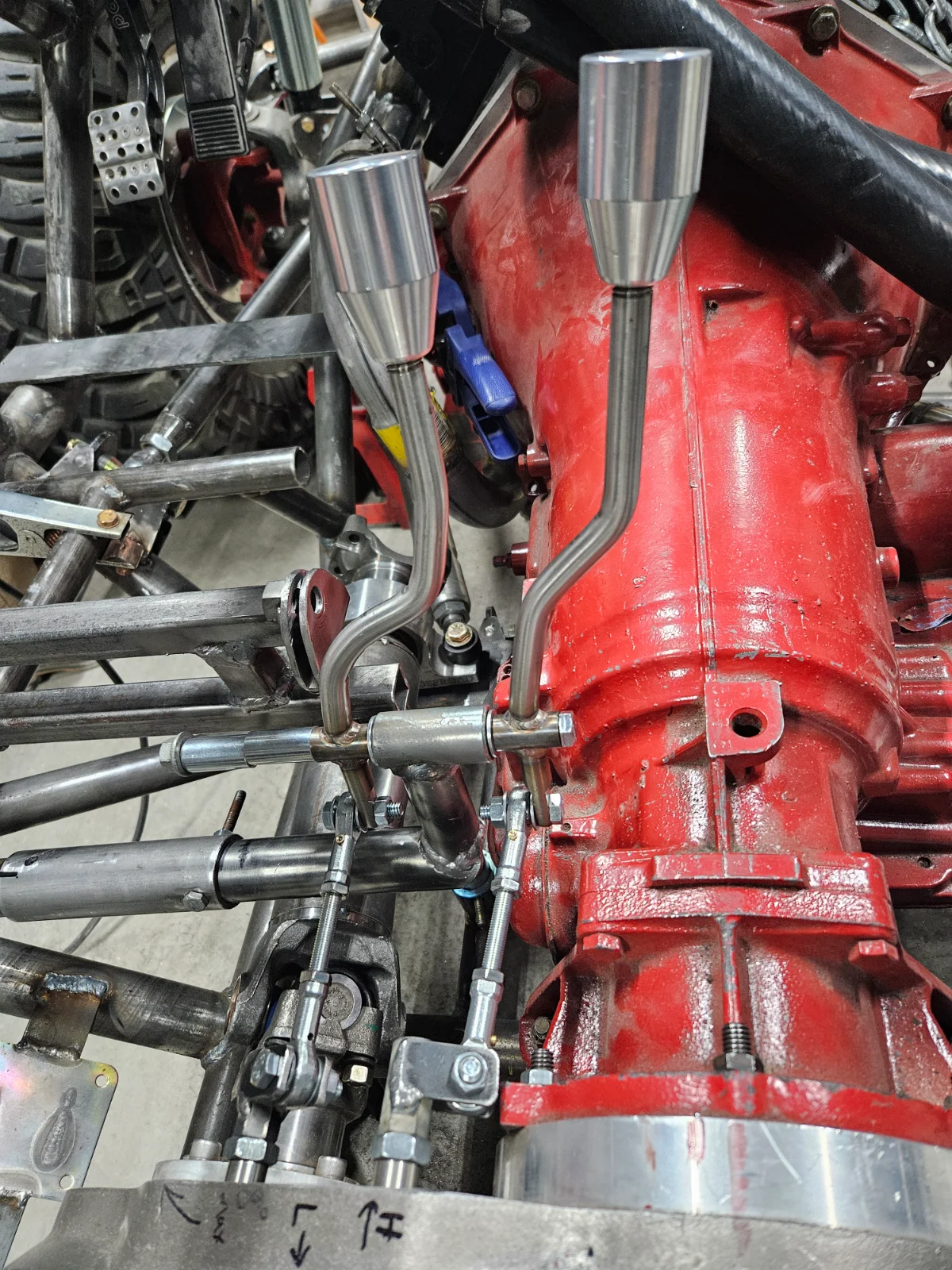

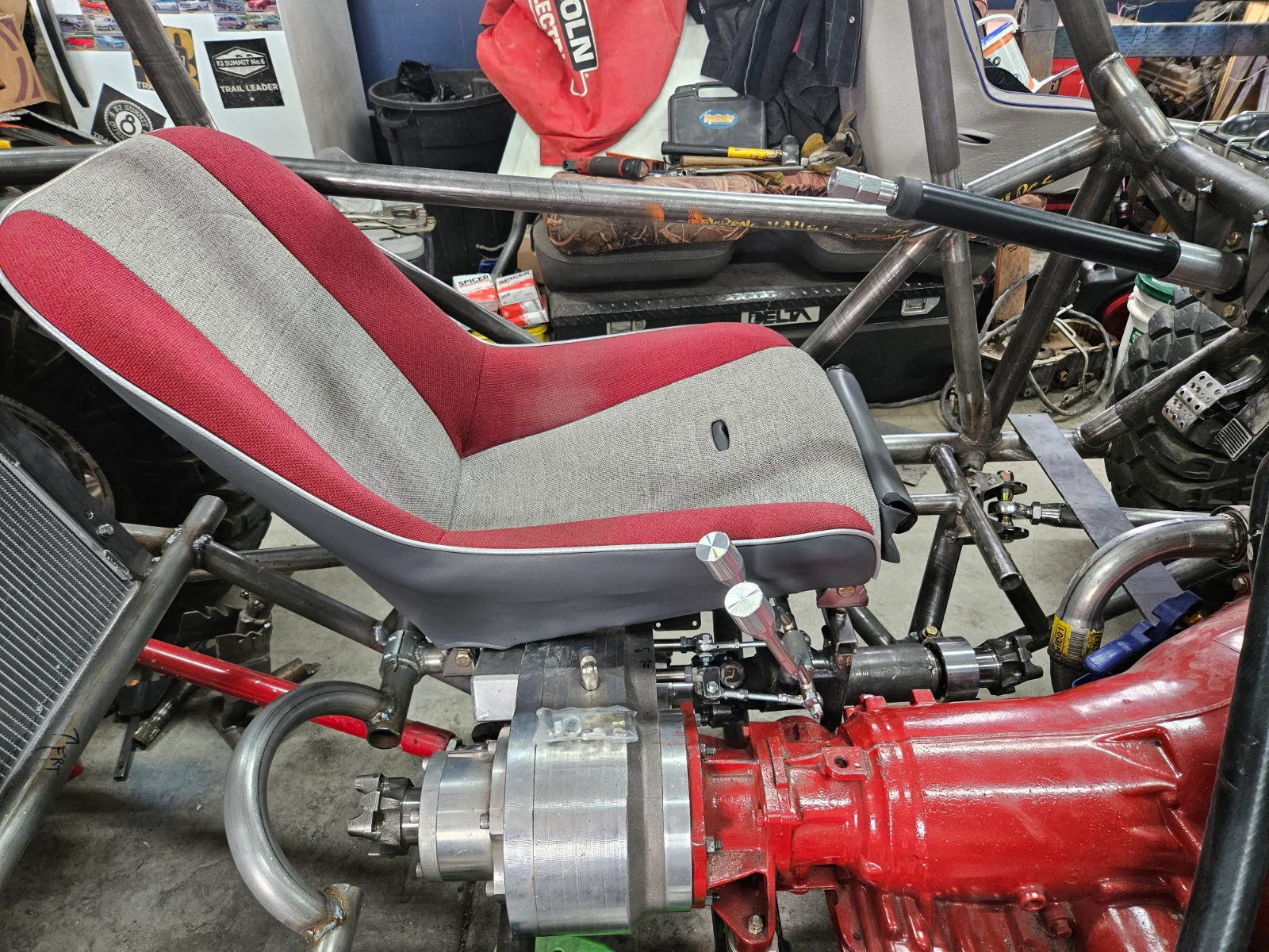

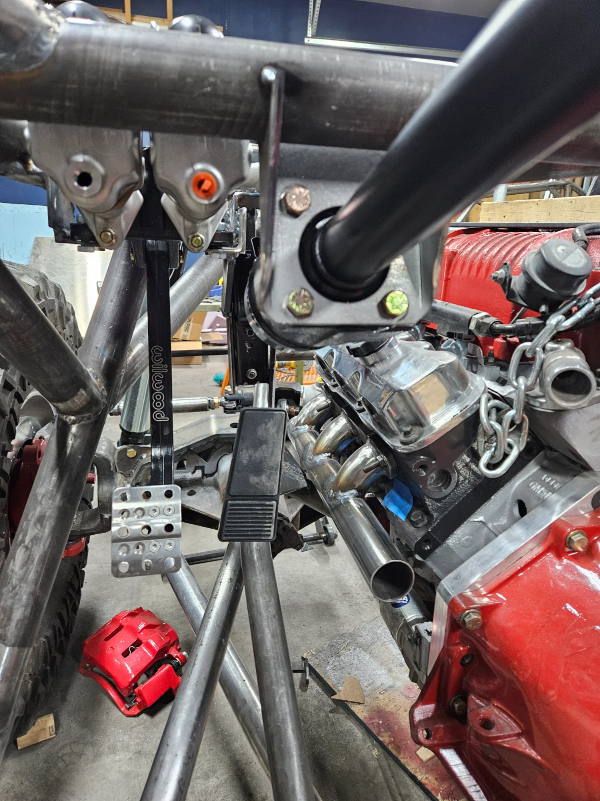

Major accomplishment (in my mind anyway) last night (well early this morning actually.) Figured out how to get the t-case shifters out from under my seat. Progress!

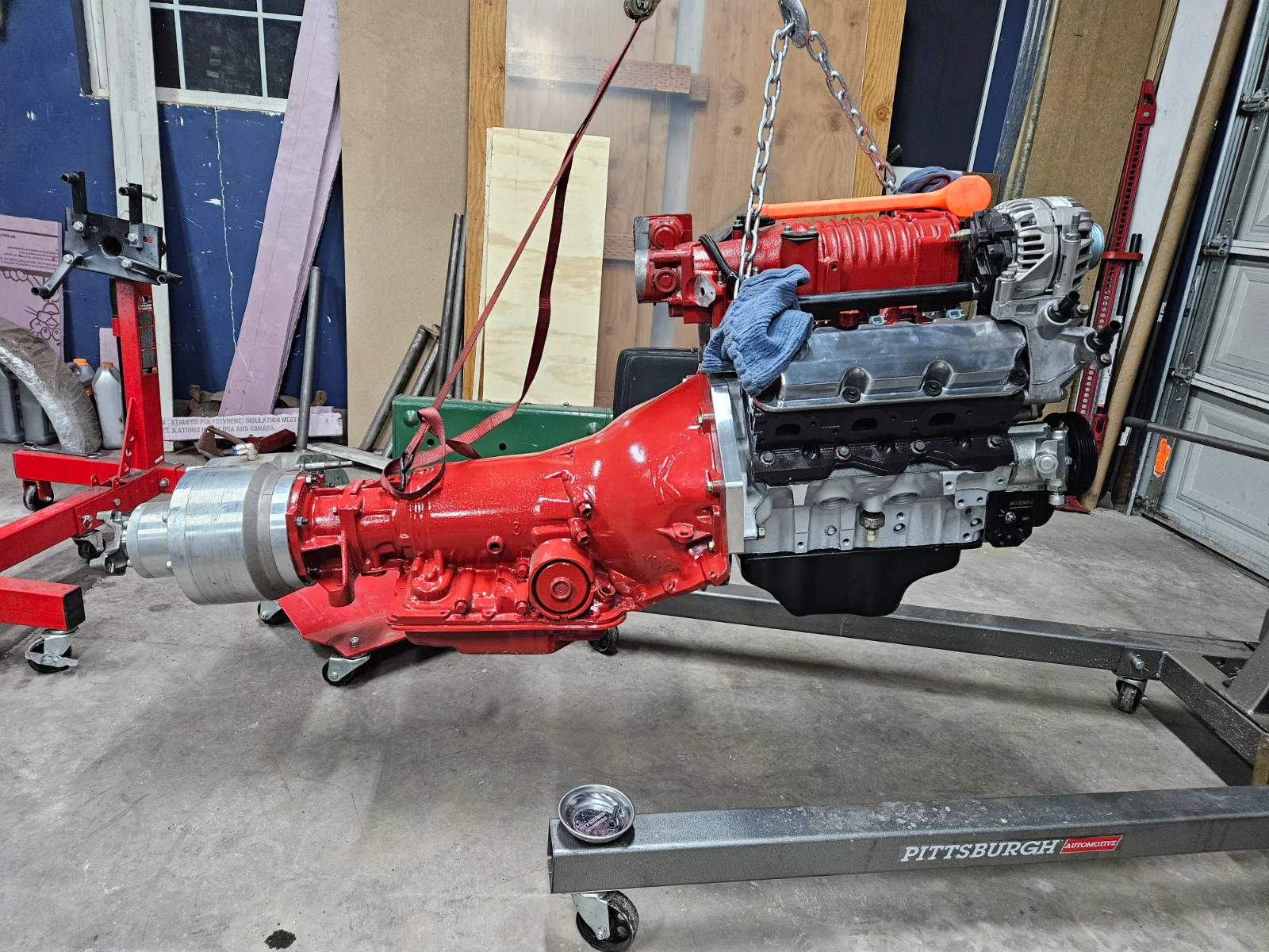

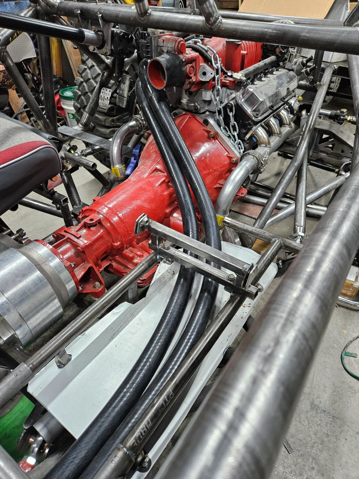

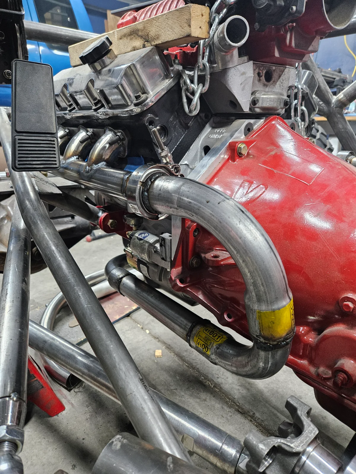

Ok. New to automatic transmissions. Had this 700r4 built with a reverse manual valve body. Is this normal? Should there be that much play?

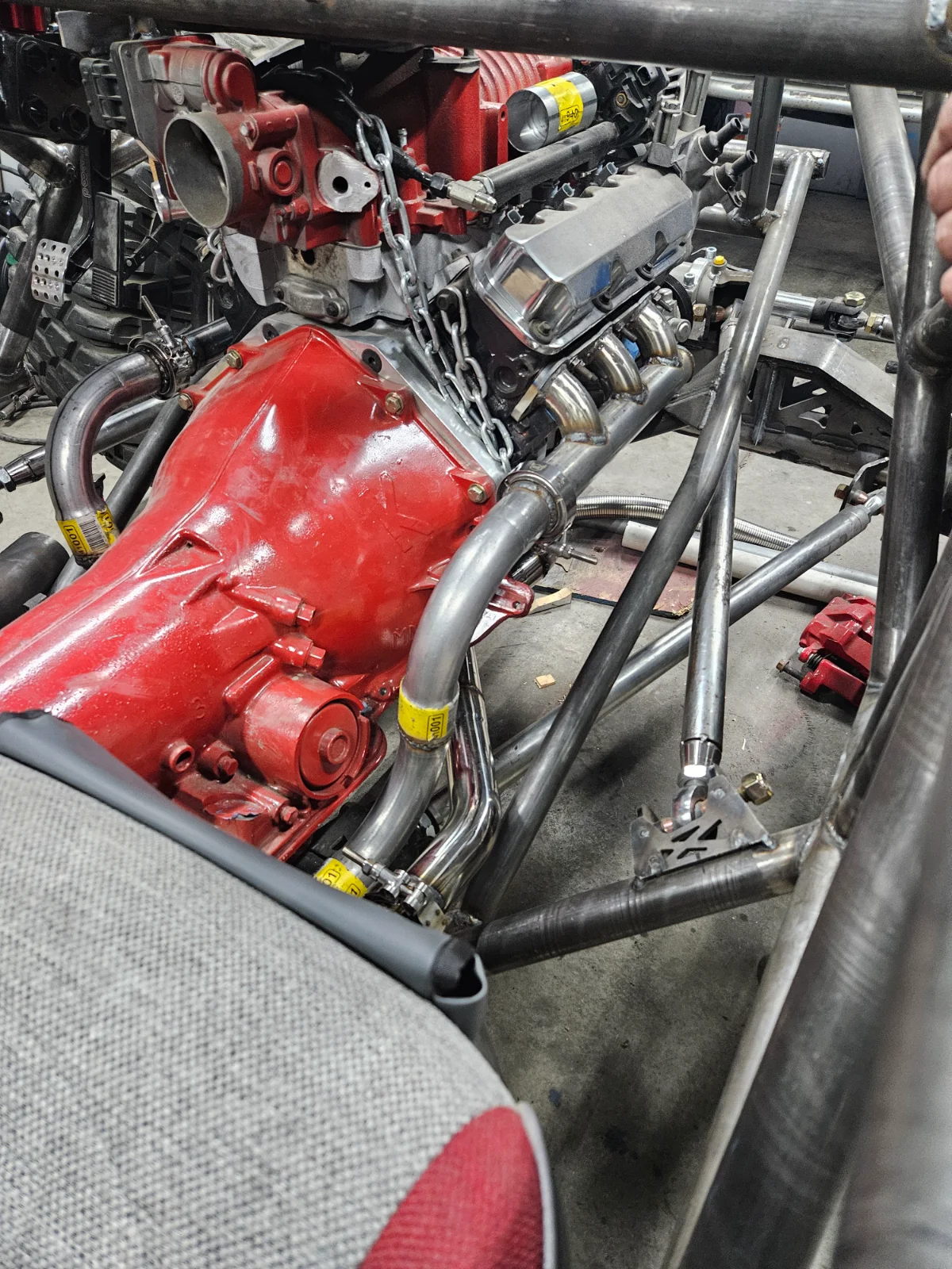

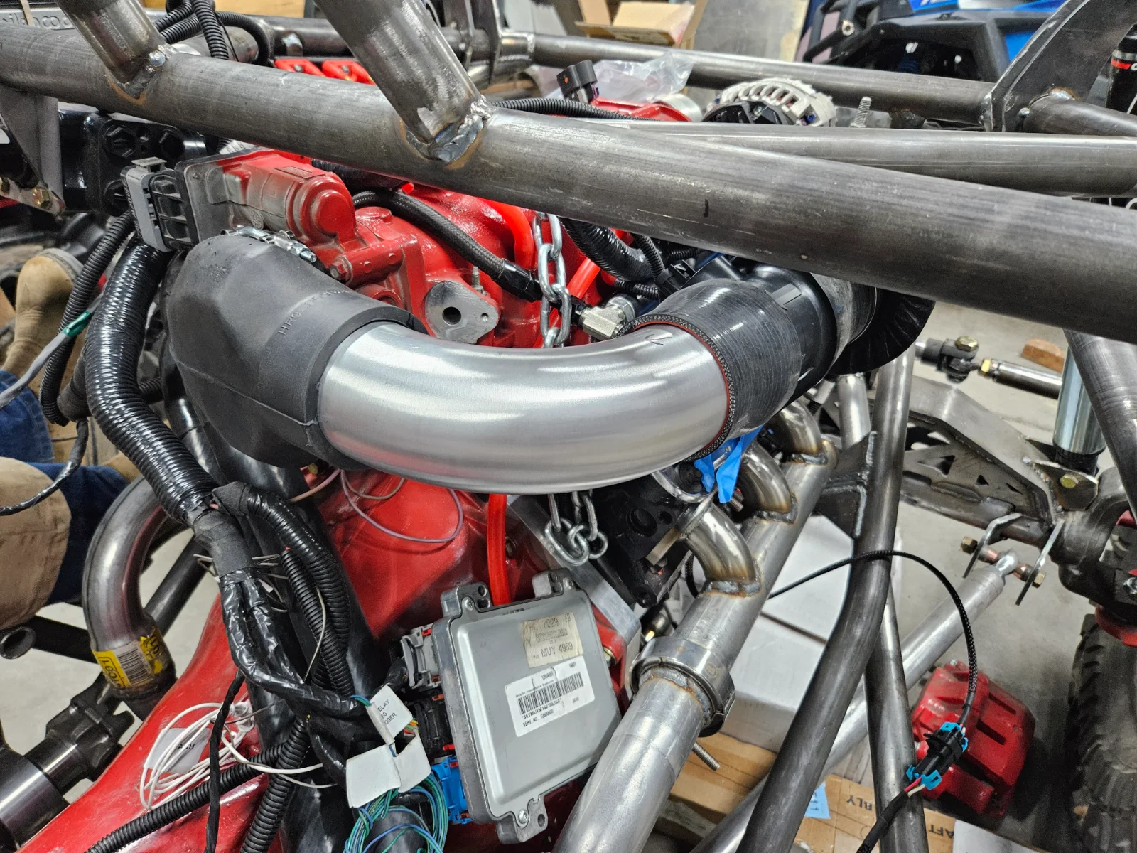

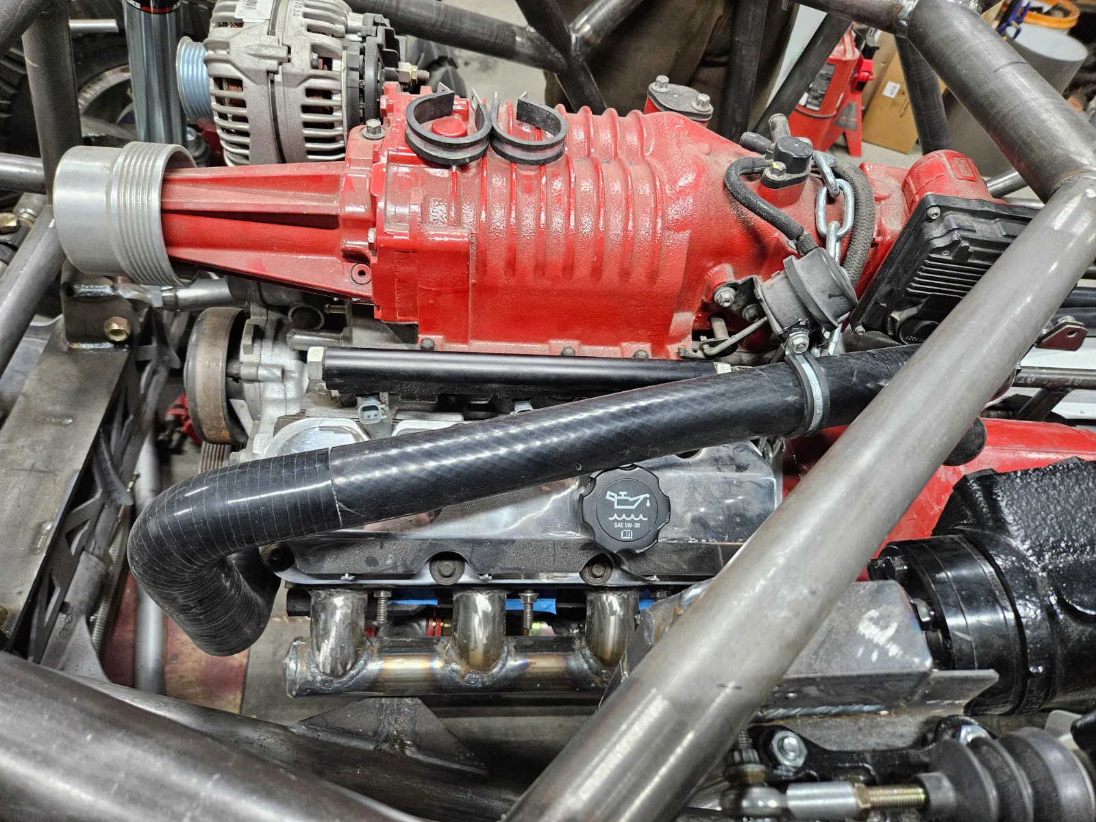

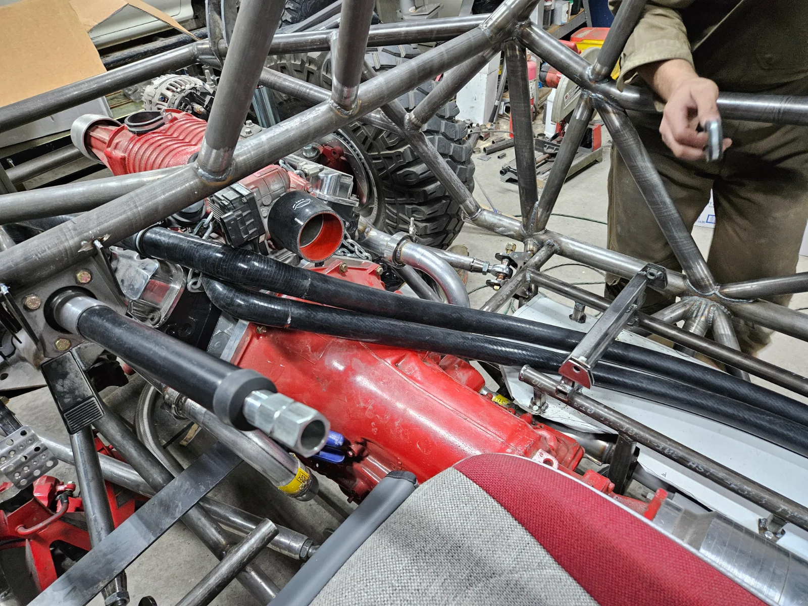

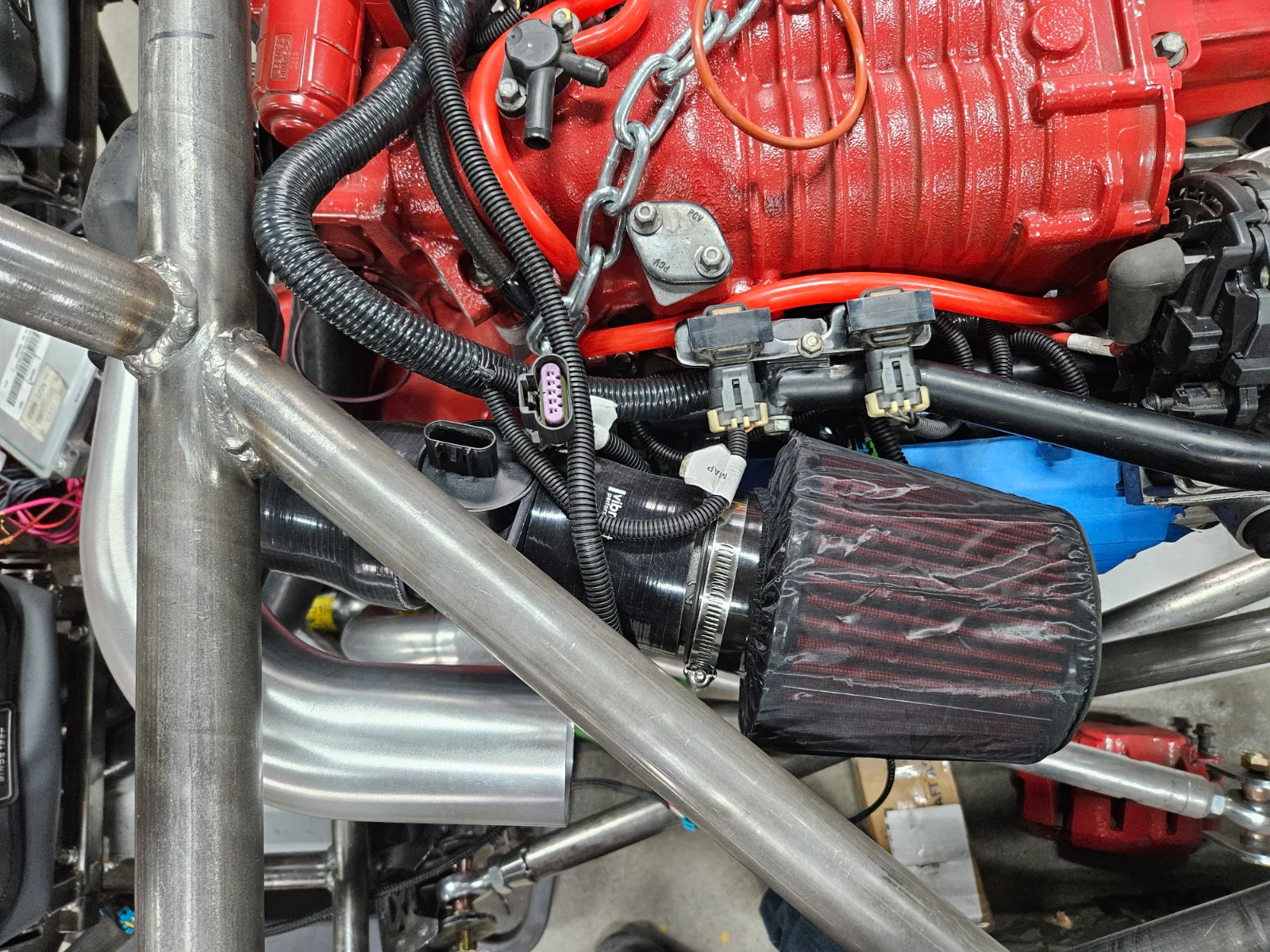

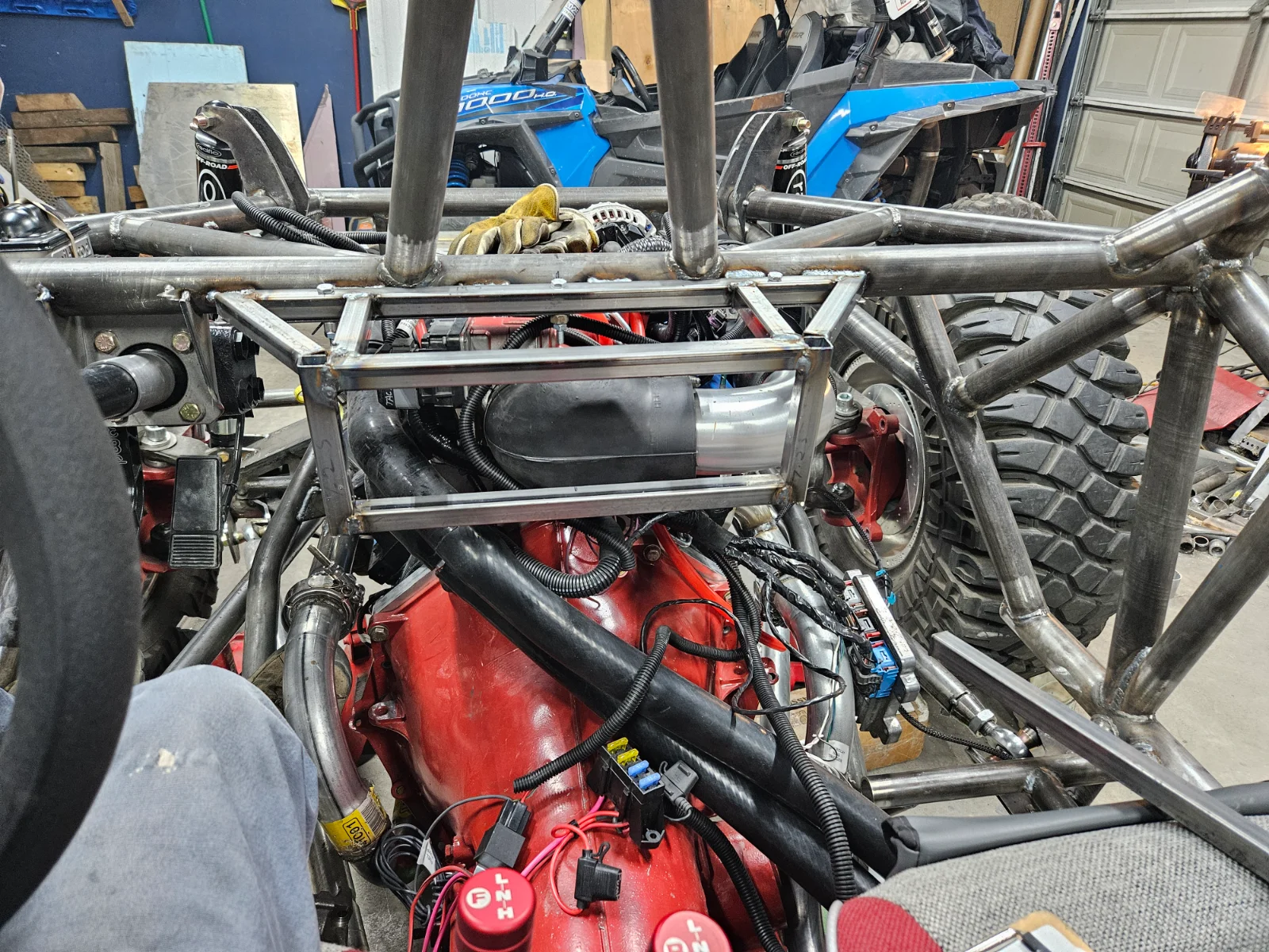

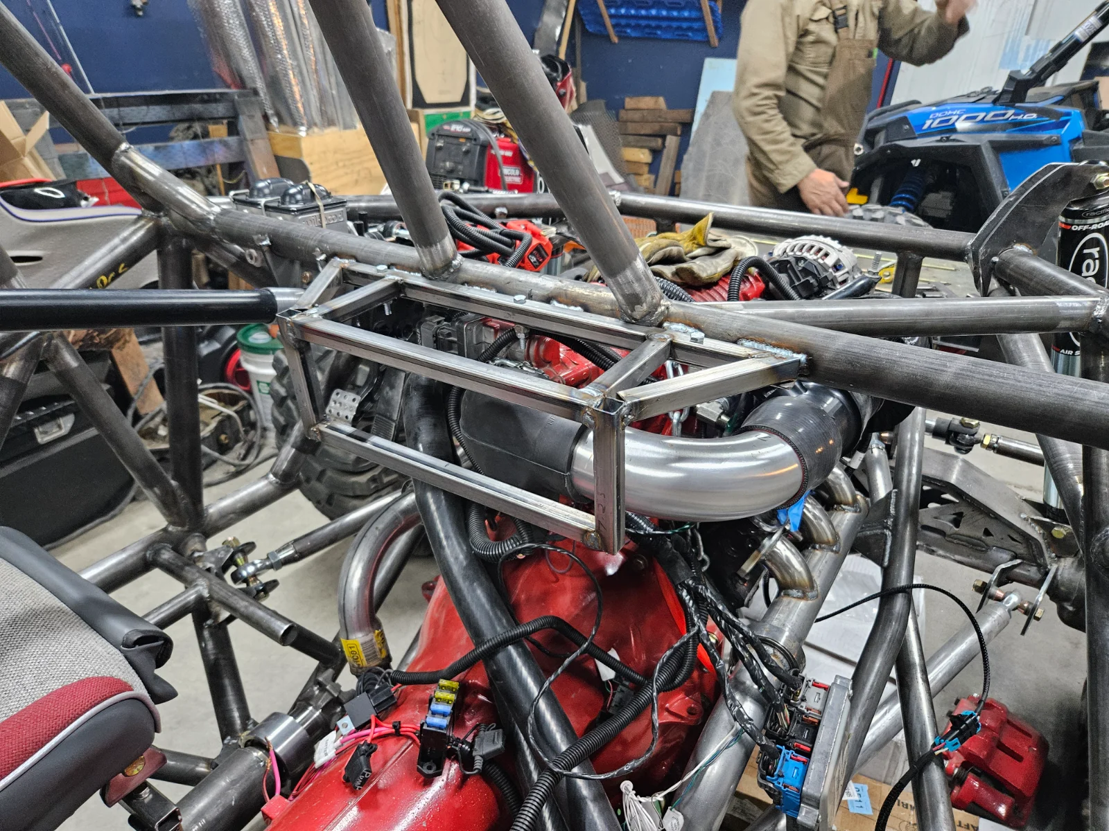

Air filter in place. Starting on the dash. Engine wiring harness has been hooked up. Every plug has a place and no empty spots on the engine. What a relief!
Speaking of wiring...
