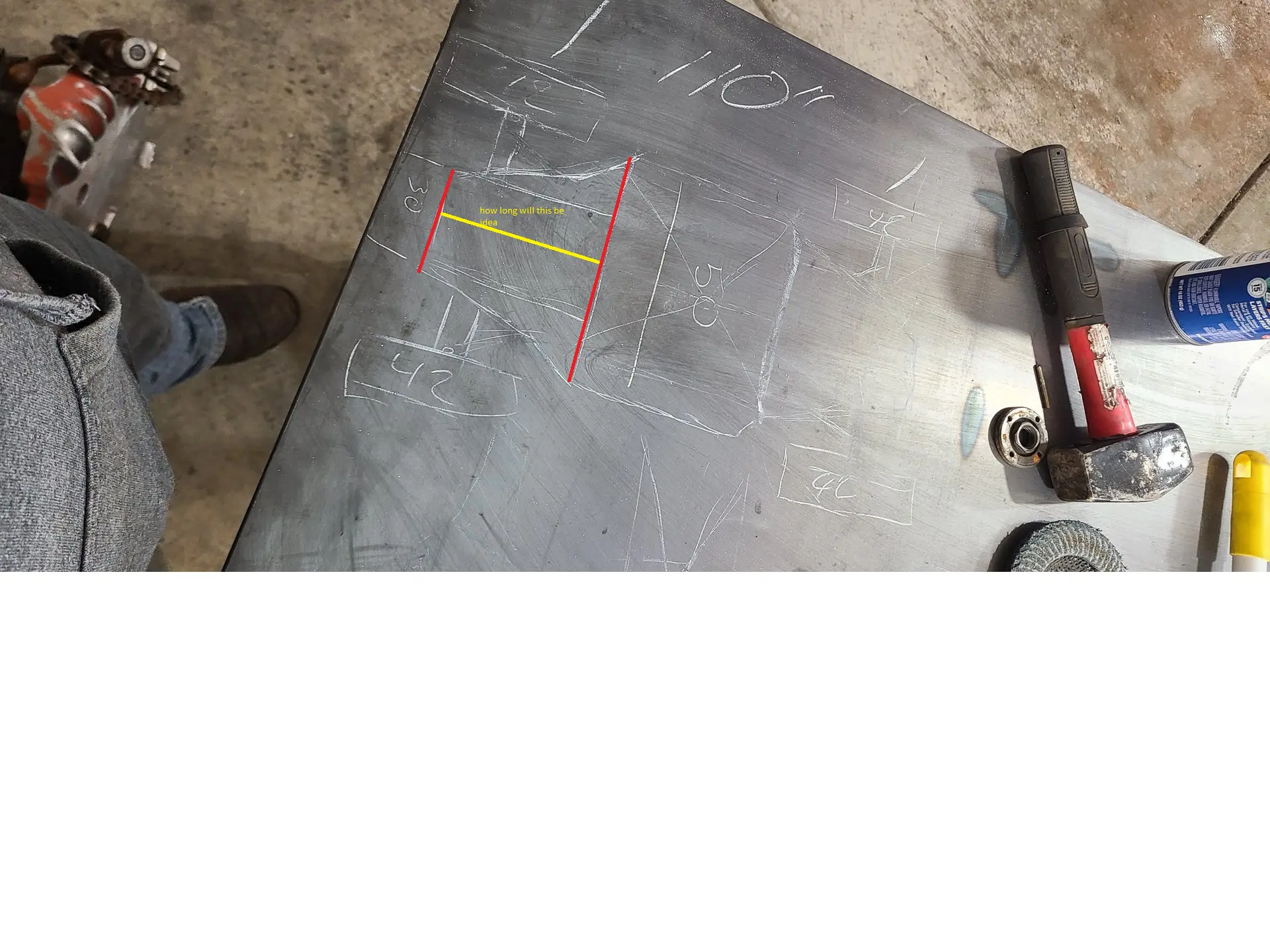

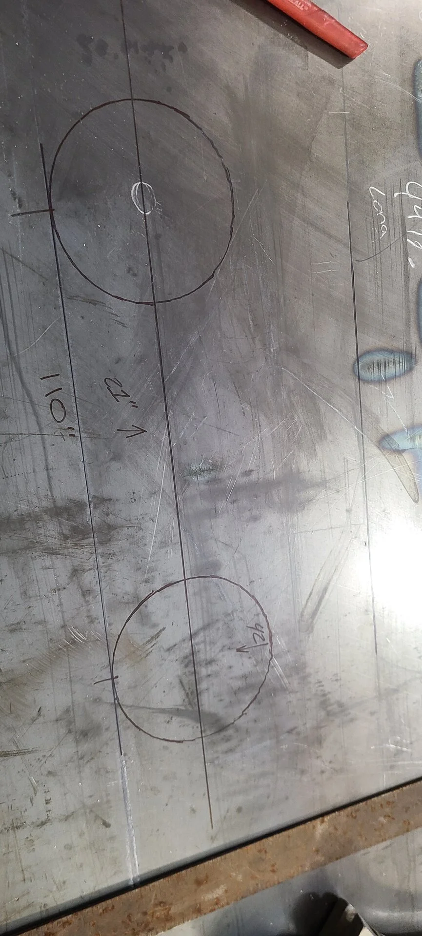

I've been all over the place with buggy and jeeps. Been back and forth a million times just like everyone else. Anyway, the last car I built for myself was a jhf car. The goatbuilt kit. It was pretty not bad. It got sold before it was finished and I've been debating for a bit to either buy or build one. Now for Christmas, the wife was going to get me a Kalif Redden chassis. Lead time won't work if I wanna hit moab and sand hollow this spring. Maybe even a few werock events. This is just a basic doodle on my fab table of how I'd like it to come out. 60 front, steering 14b rear using super duty outers. 42" treps or reds. V6, auto and atlas. Wide enough to get 2 adults in and have a little shoulder room. We will see what happens here as I'm going to build it to comp with mainly but ride trails too.

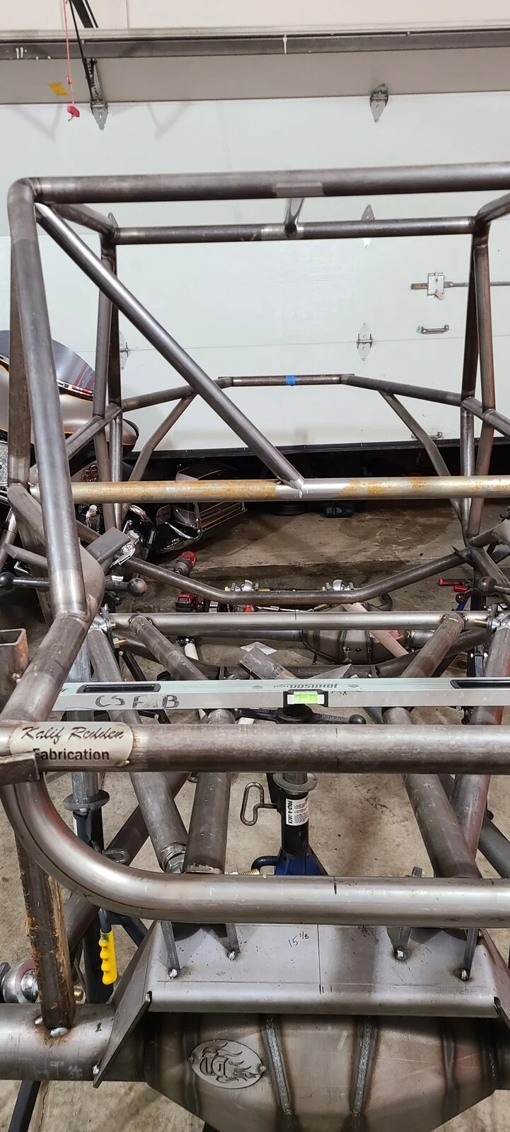

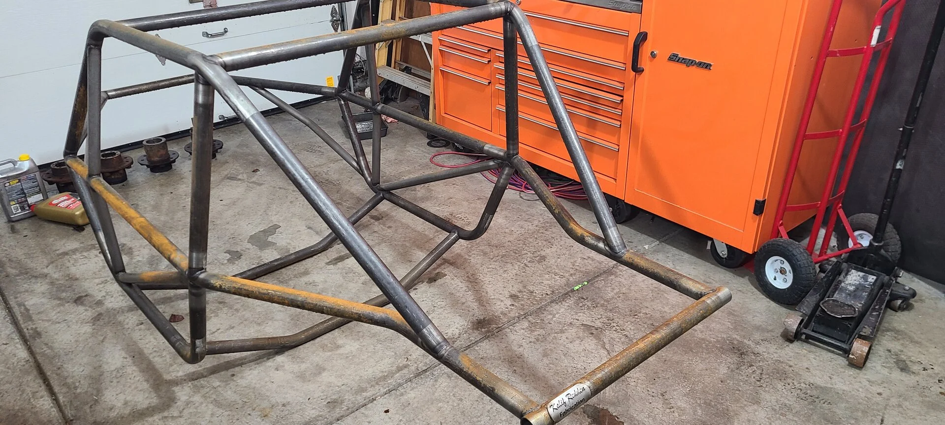

Well, I ended up with exactly what I wanted. After some calls, a chassis came up for sale and I got it bought. After a trip thru Oklahoma, I had to get the rust off but it wasn't too bad!

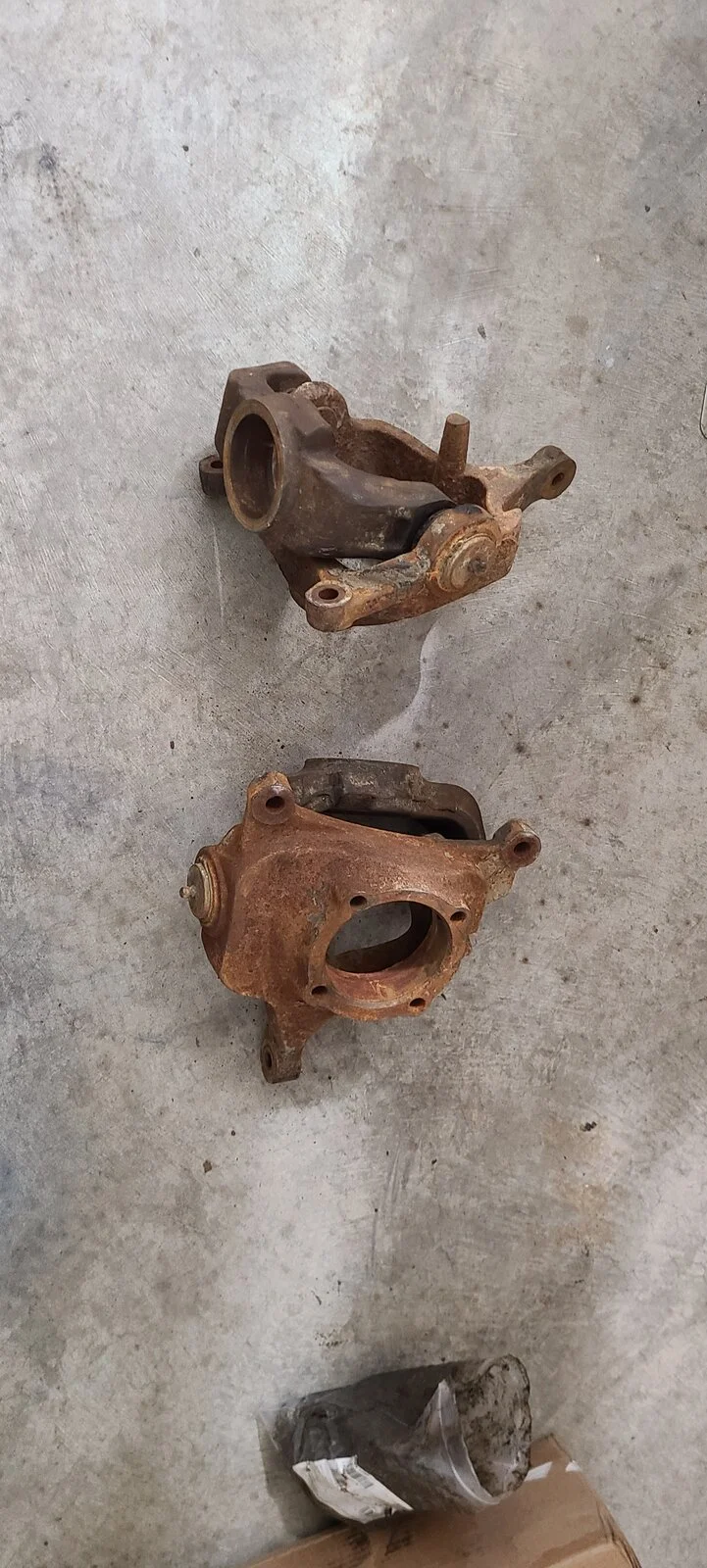

Ditching the 1 ton ton idea. Even though I have a ton of parts for them.... Trail gear and jegs was having what seemed to me a good deal on 9" housing. So both those. Another set if SD knuckles and C's are on their way. Prps, joints and the new Profenders are at the house waiting for me now.

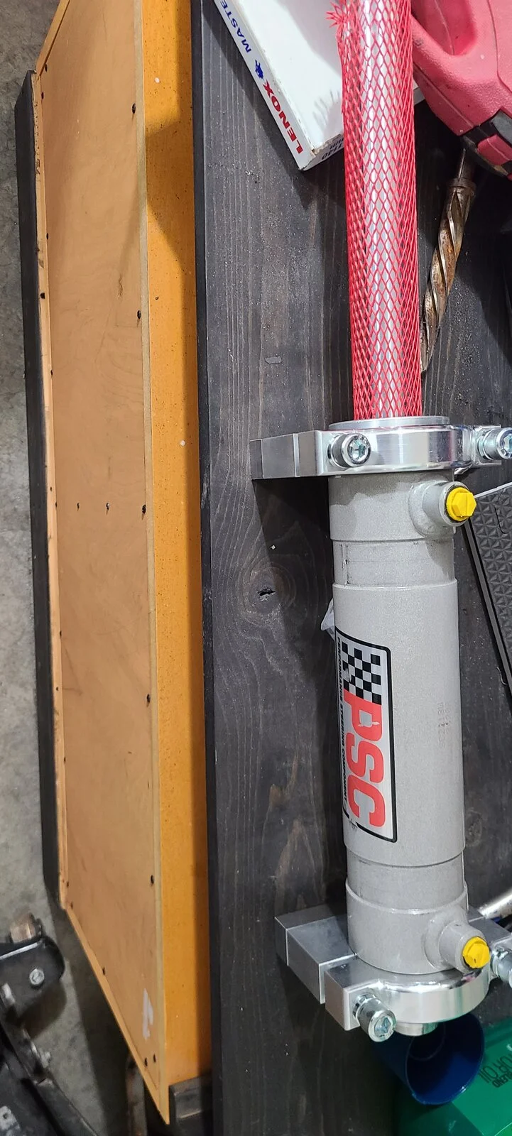

So here's the rundown. 6.00 gear with a th350. May switch to a 700r4 first gear though and get a slightly higher gear. 5.0 atlas. Still trying to decide on the motor. 3.9 or 3.5. I talked to Jake last week at Marked. They are a couple months out yet. So is Advance. So no harm there. I'm still a month out from going home myself. Got a slick fuel cell and mount from Richard Hulse a couple weeks back. Scott Trimarco has a badass steering pump and rear steer kit that will be at the house when I get home. If you haven't looked into one of his pumps, definitely worth it. This will be my second one.

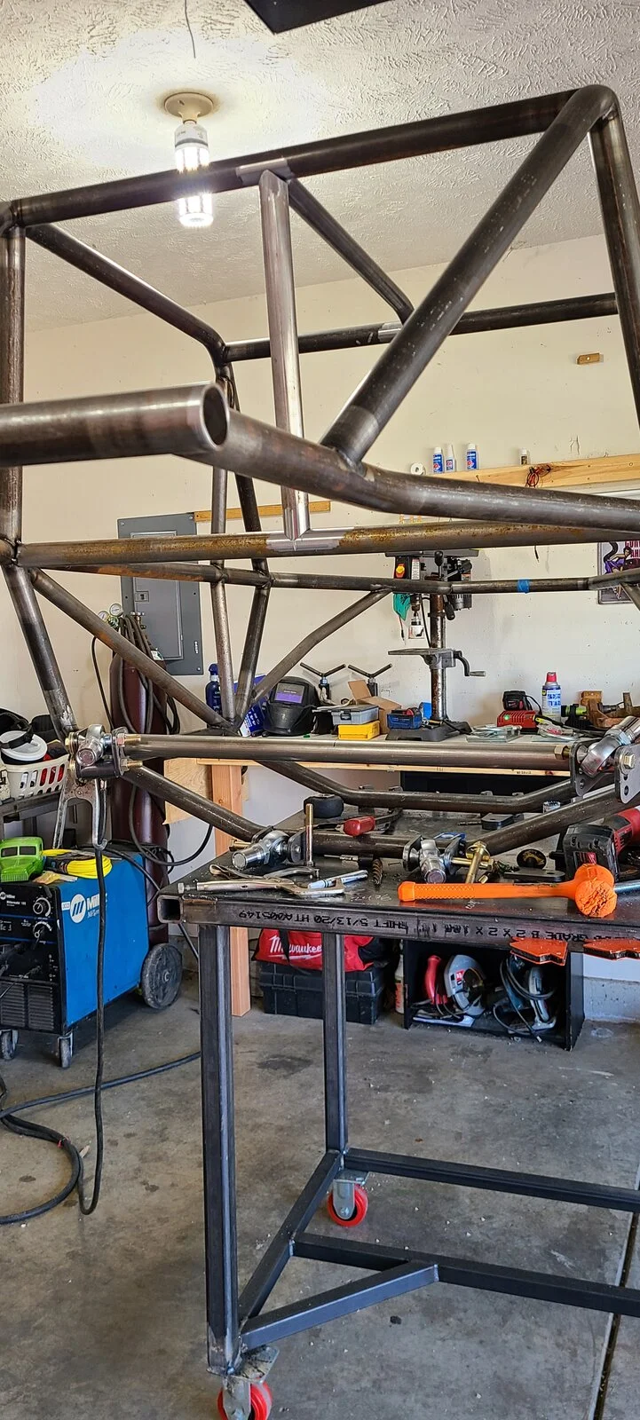

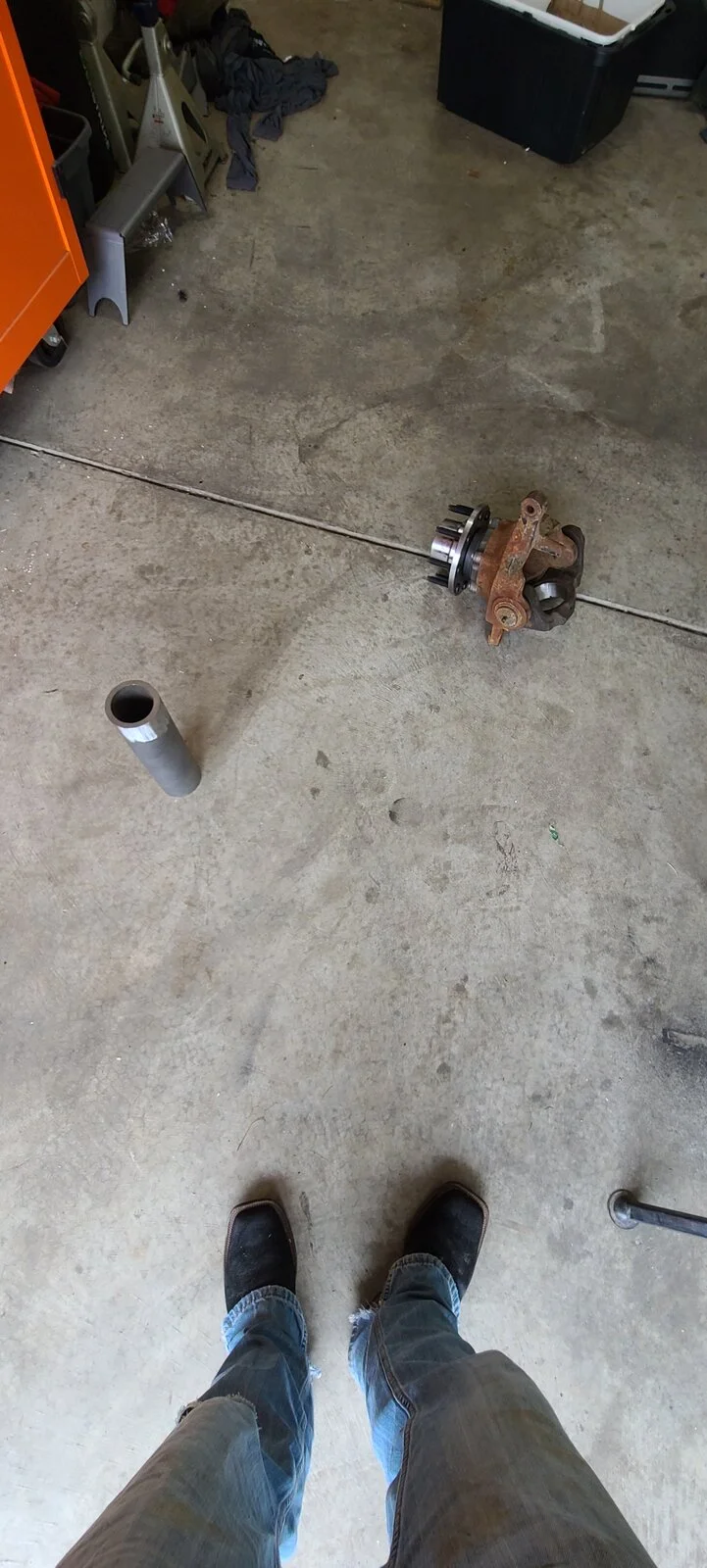

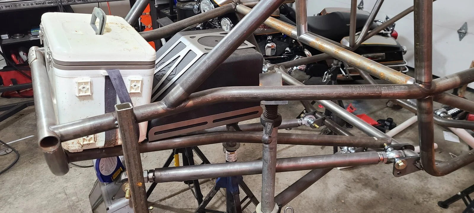

Still plugging away. Been working on a few other cars here lately and haven't had the time to mess with mine. See that damn rust!? Over that crap already. Link material will be here this week as well. As soon as my knuckles and C's get here, I'll get the axles cut and have it a roller. Without tires.....
Still tryna plug away. Been something everyday around here lately. Wife's transmission died, moving to a new shop, and its been crappy weather, haven't done much but I was up pretty early this morning doing what I could and not wake everyone else up. Gonna grab my tig here in just a bit and get busy on the back side.
