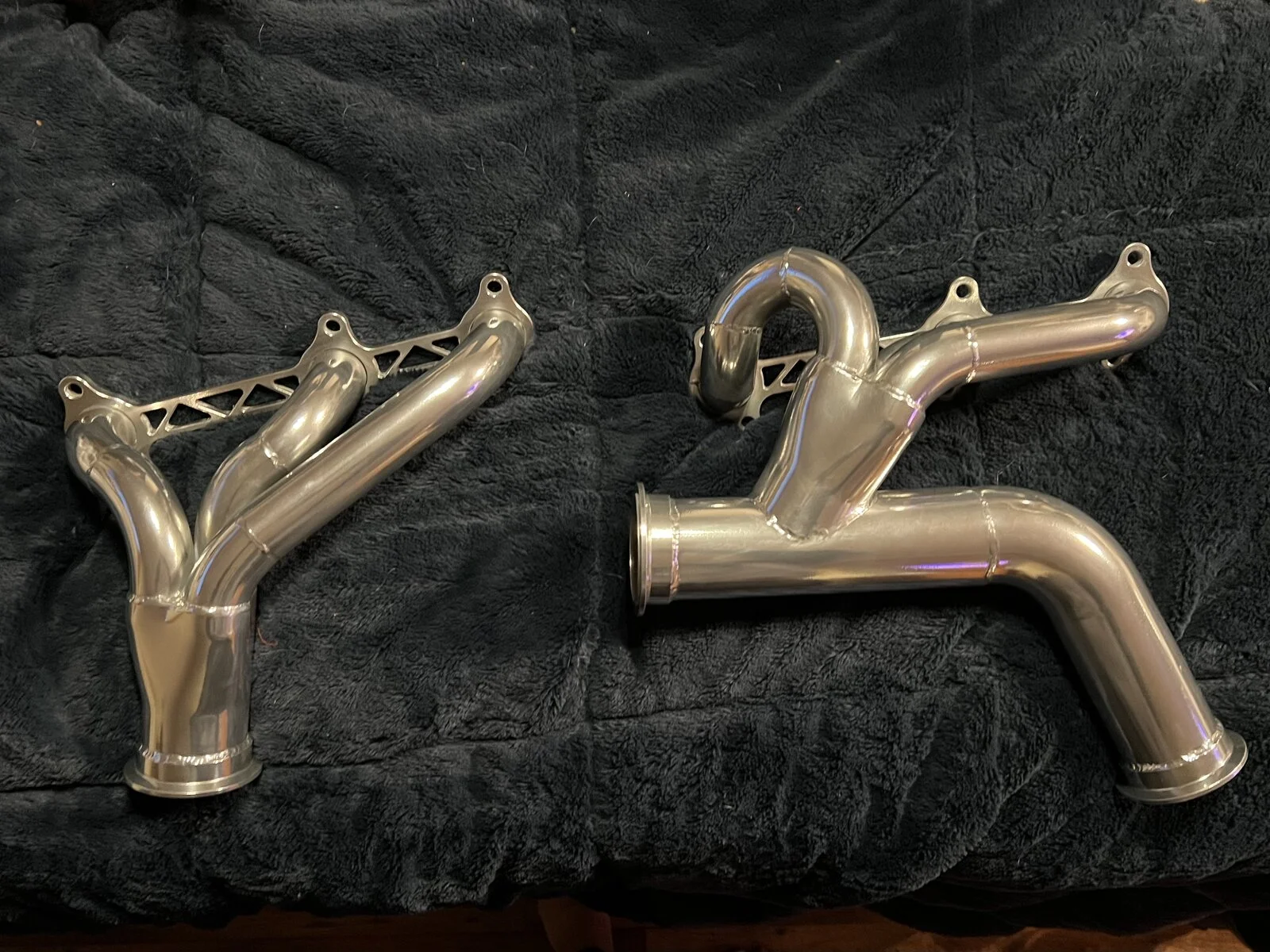

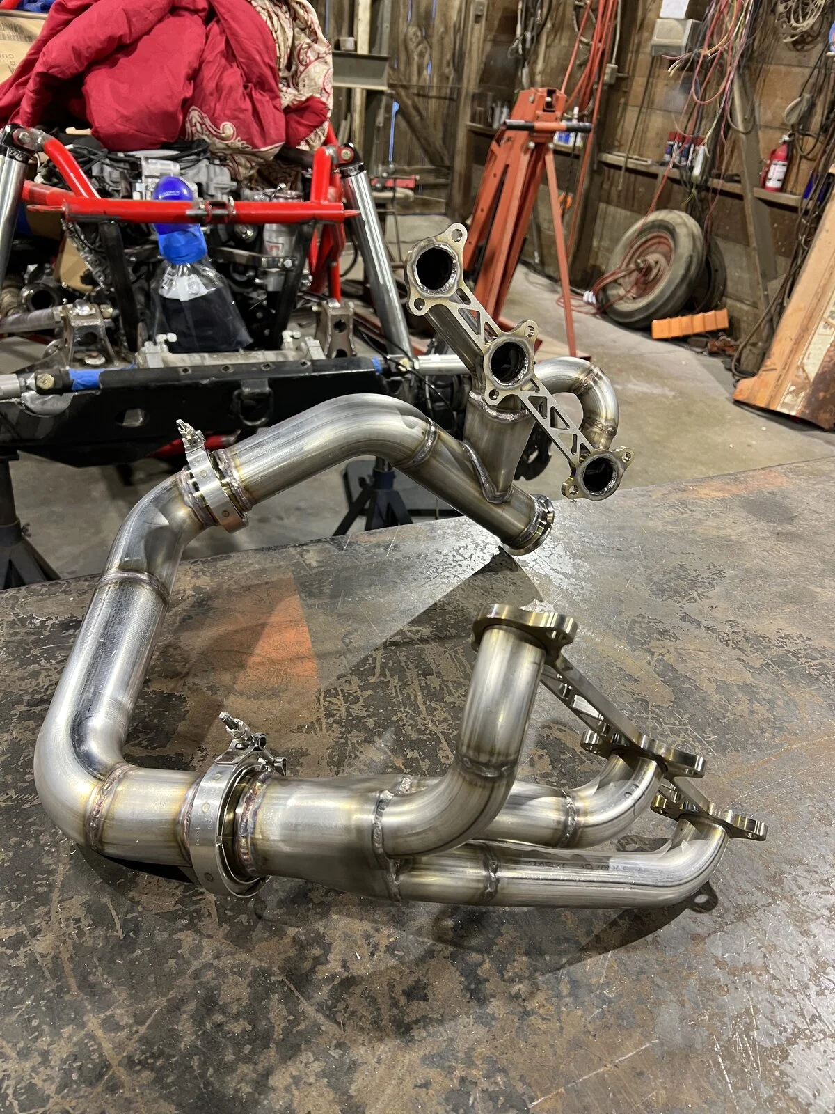

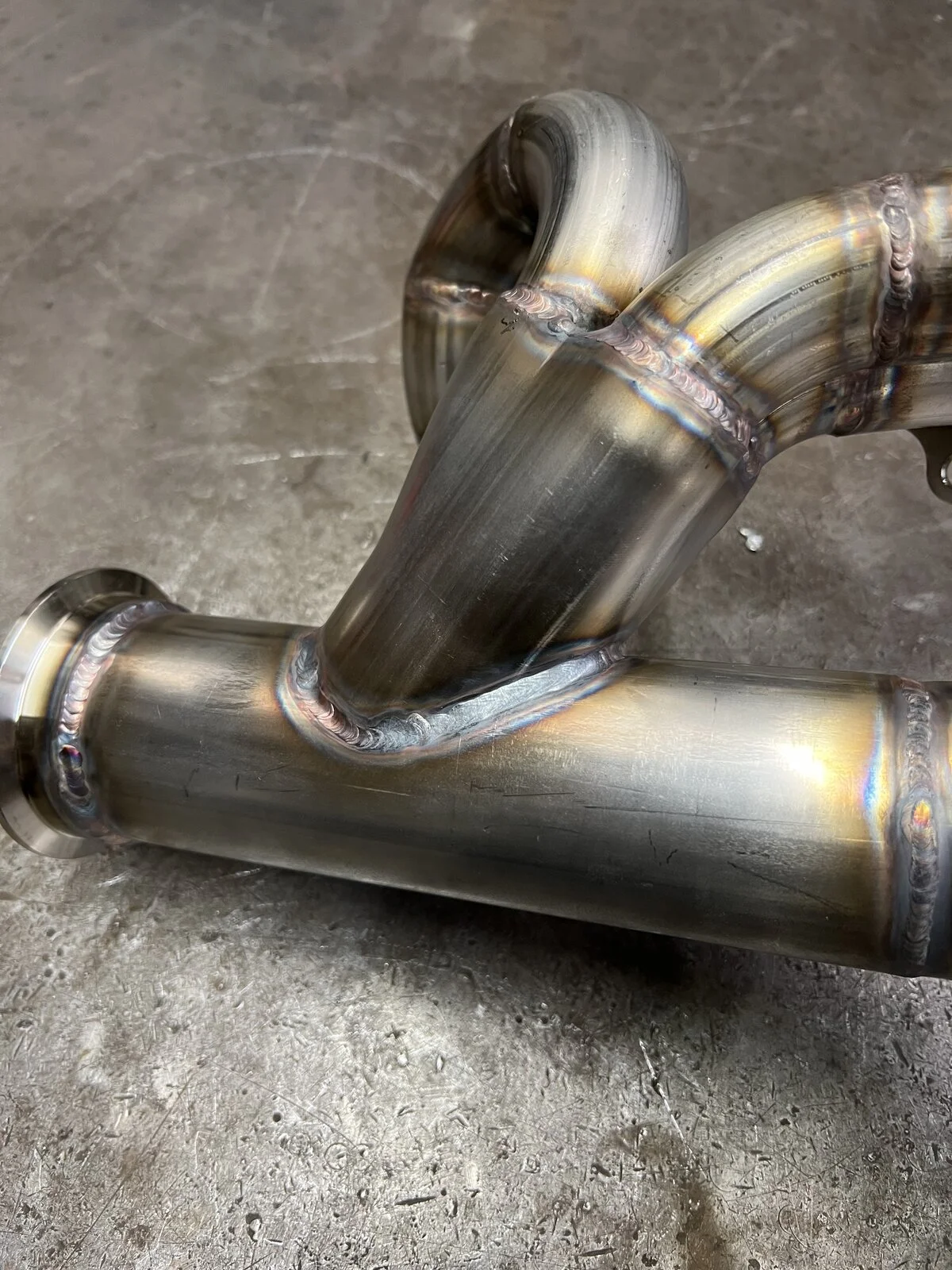

Finally finished the exhaust. All welded out the crossover didn’t fit exactly sooo I had to cut it in two places👎👎

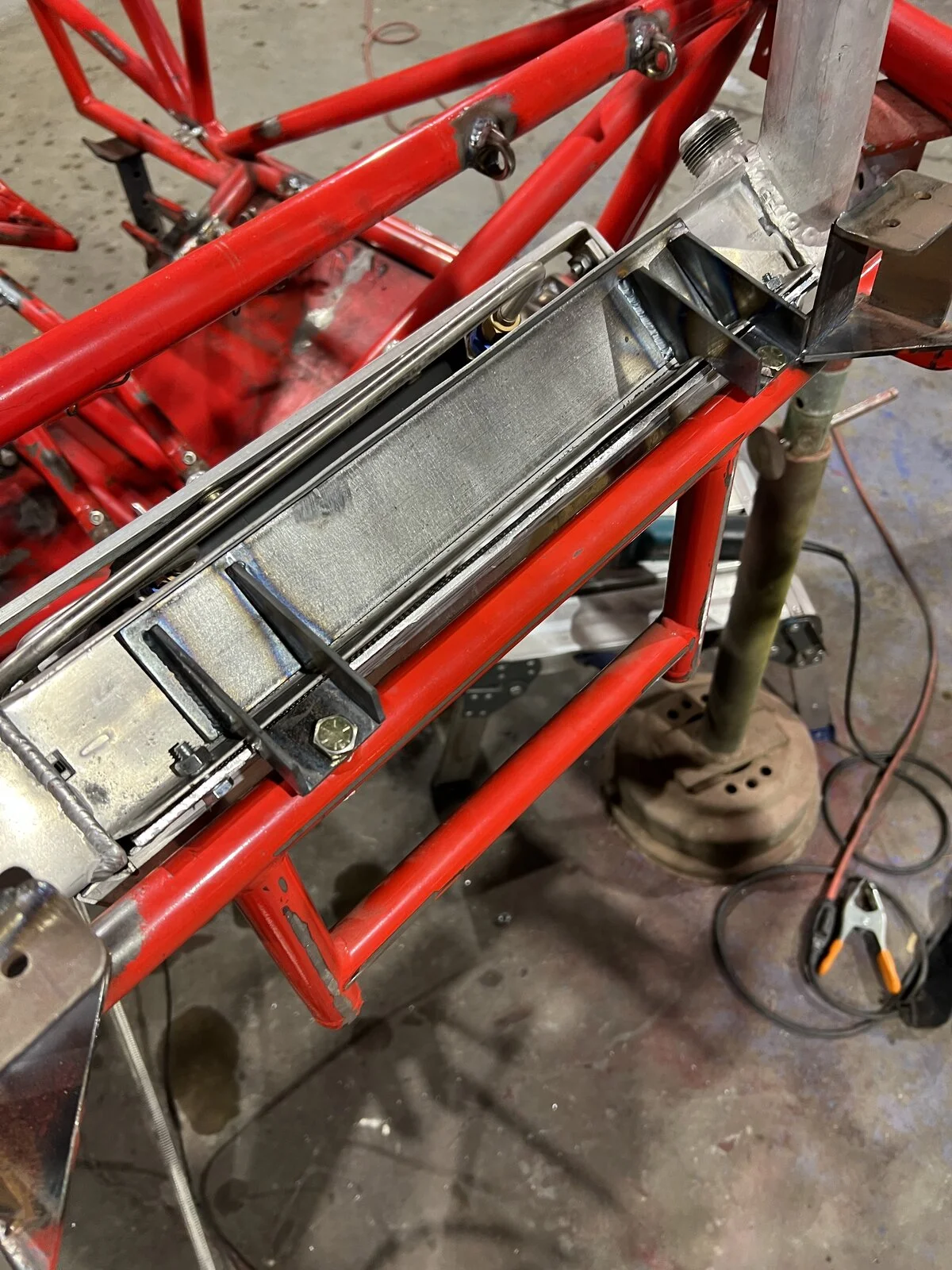

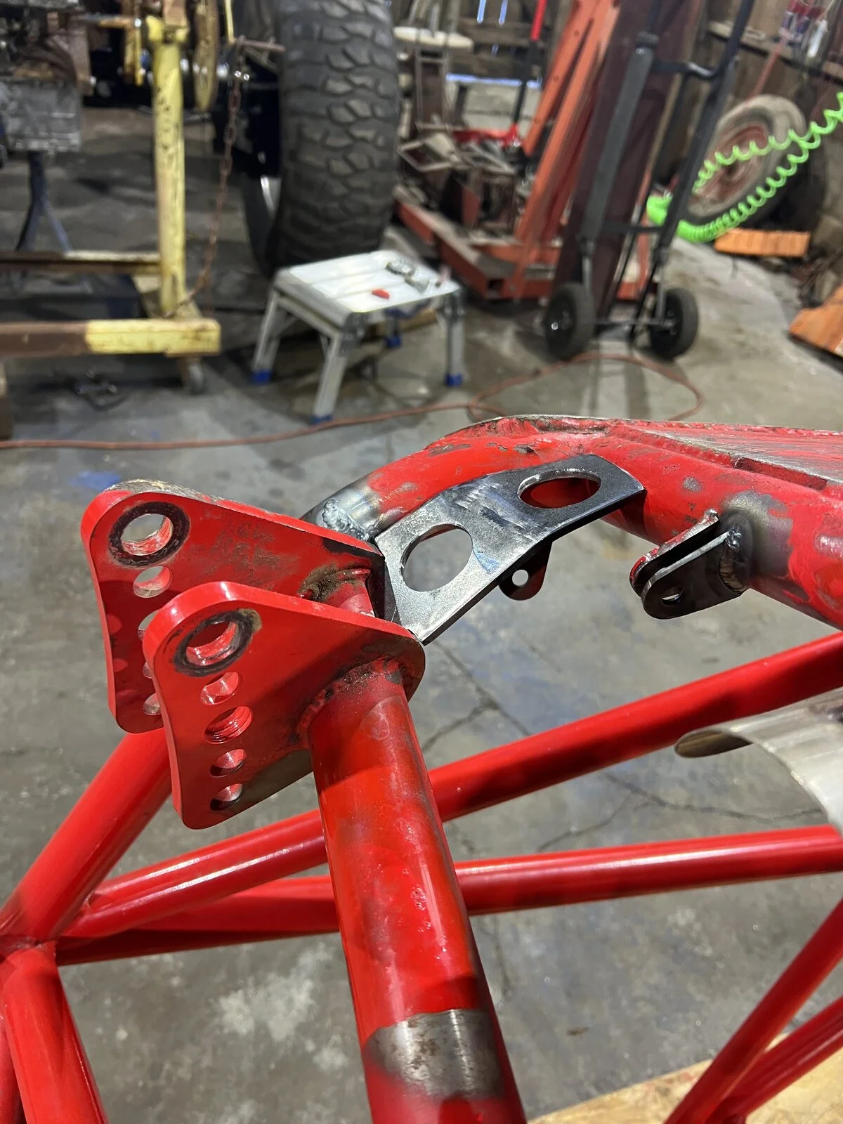

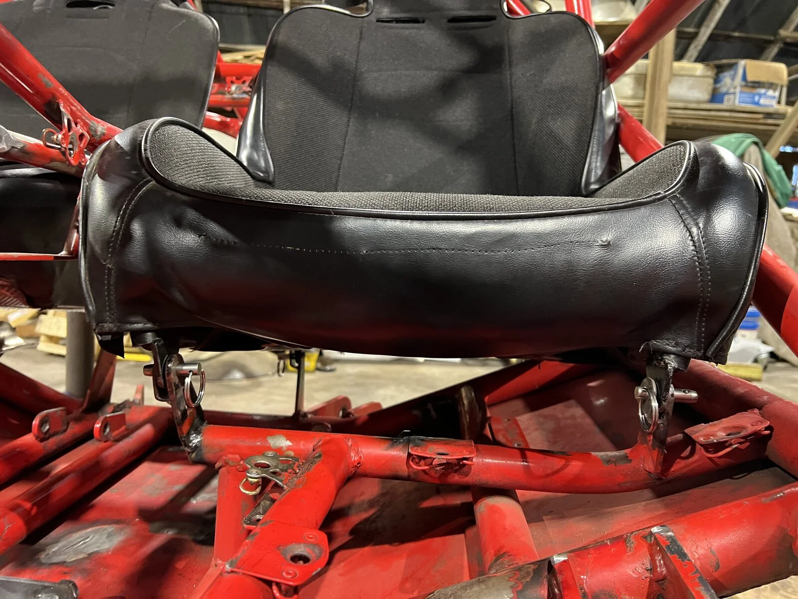

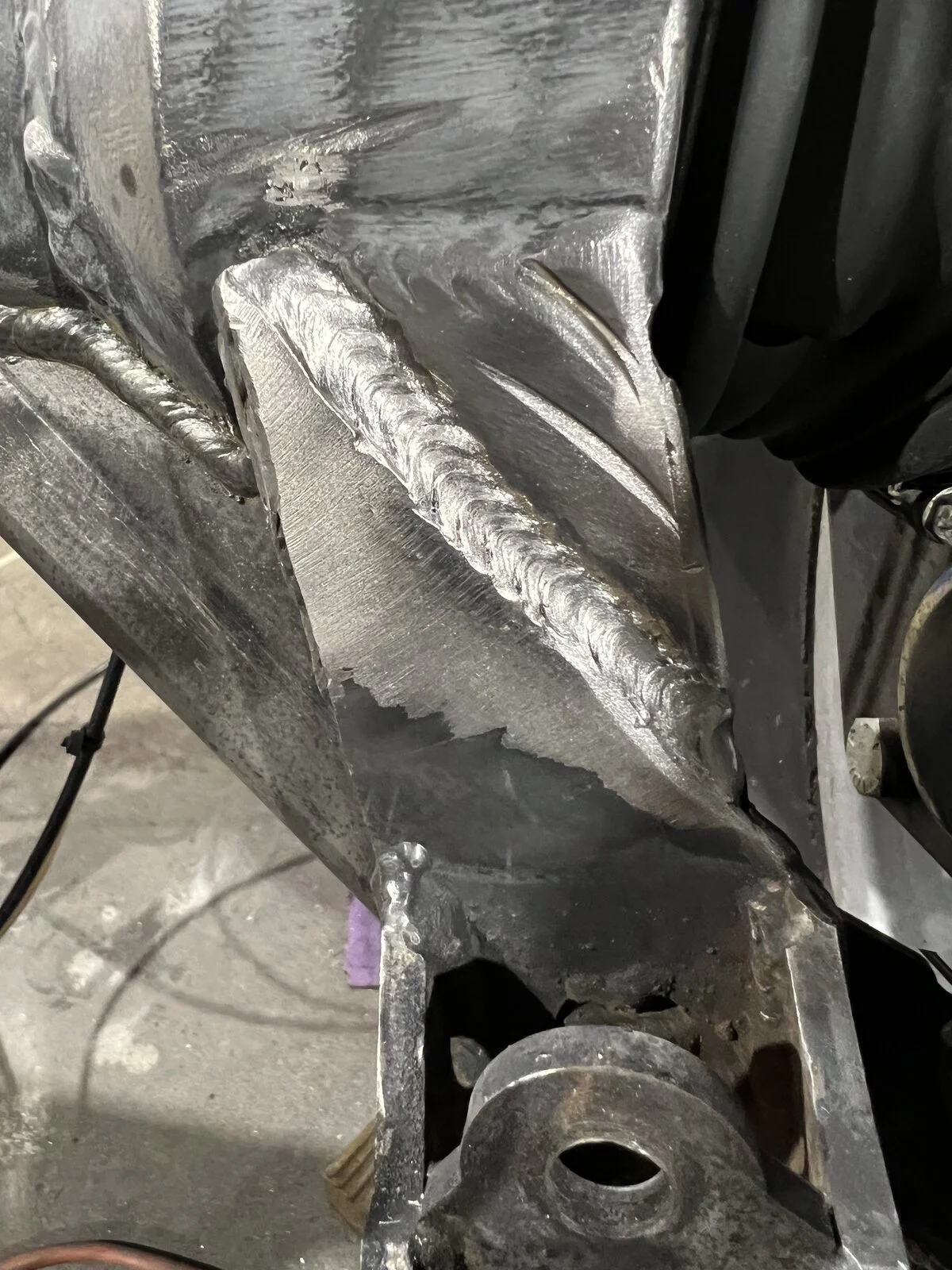

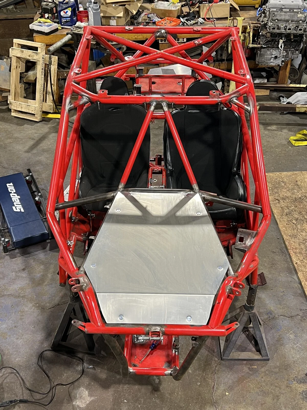

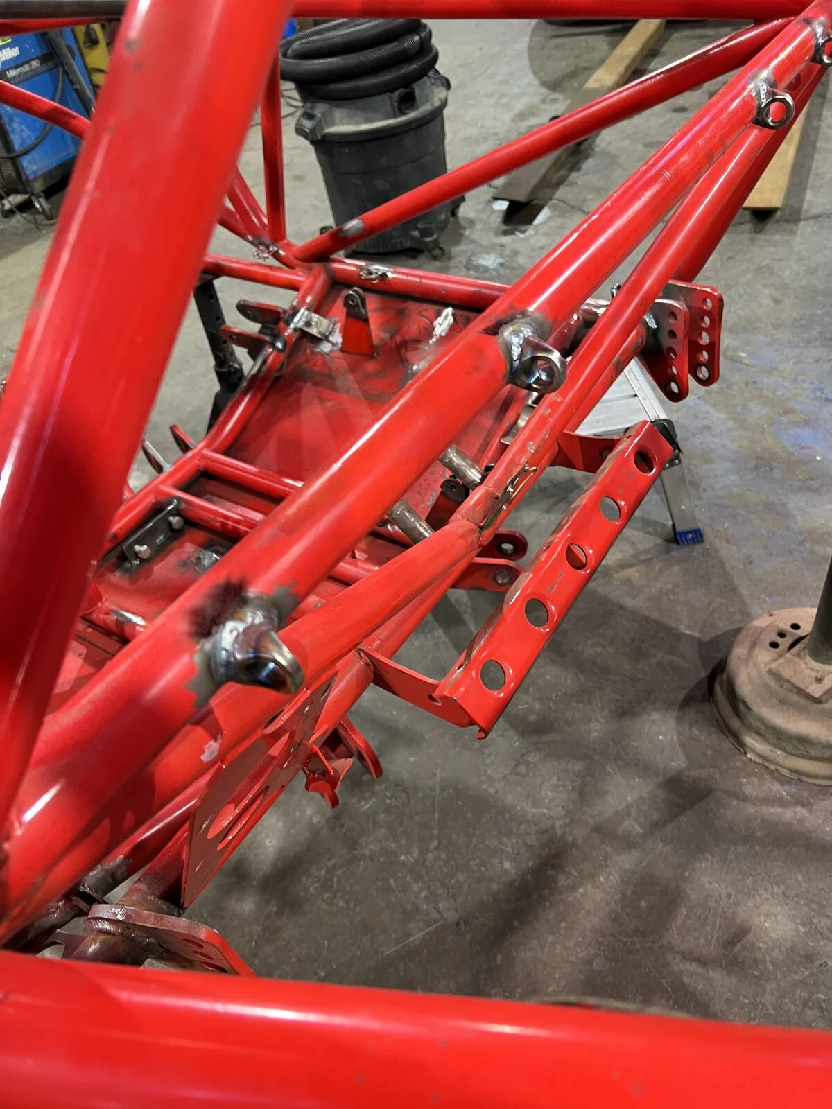

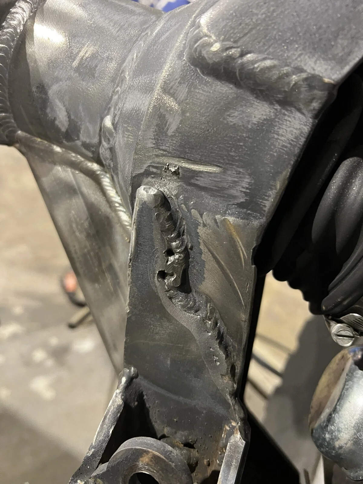

Seats mounted on quick pins. Seat belts anchors from Armada are super nice idea from Jeff Clibon. Built a nice little hood to finish off rig Had a small crack in the frame near rear upper link mount so I fabbed a a gusset to tie belly to link to outside chassis bar

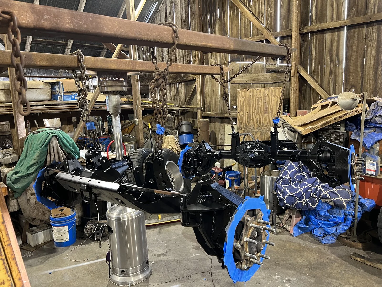

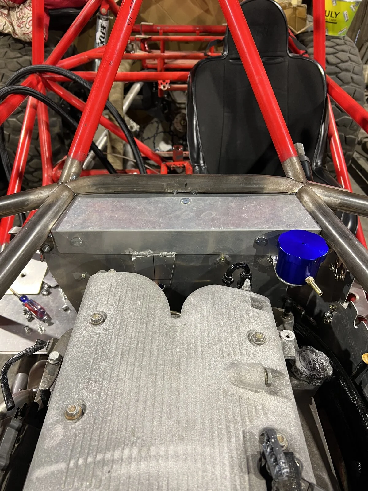

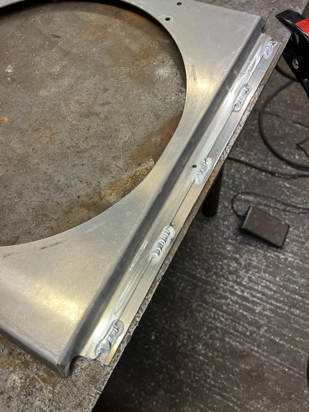

Radiator and fan were mounted poorly so I extended the fan shroud and built a nice upper radiator mount that will receive some holes for looks. Chassis is done and being powder coated at CAPS in Fresno,CA. They did an amazing job coating the headers inside and out with ceramic chrome inside and out for a heat barrier.

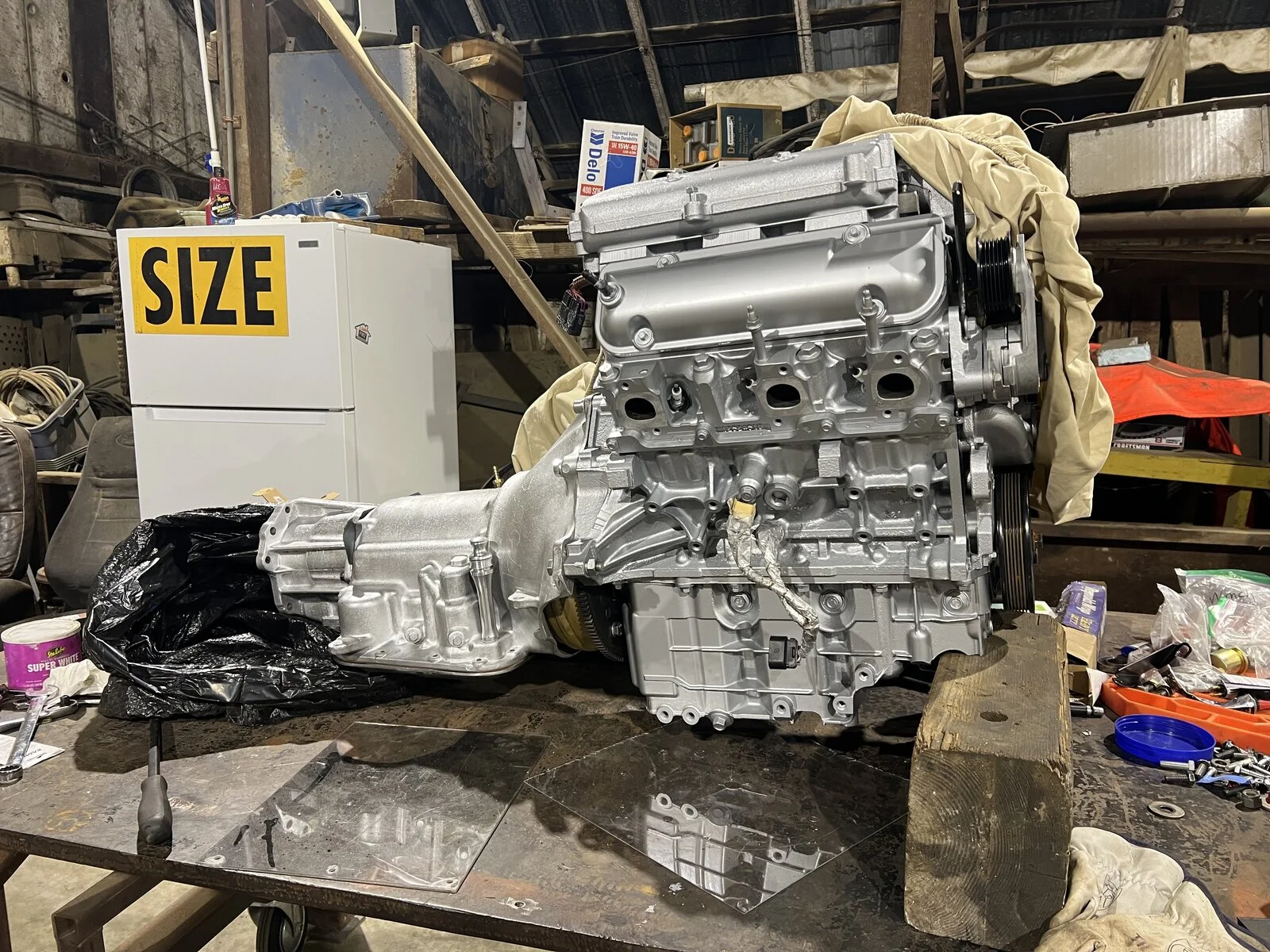

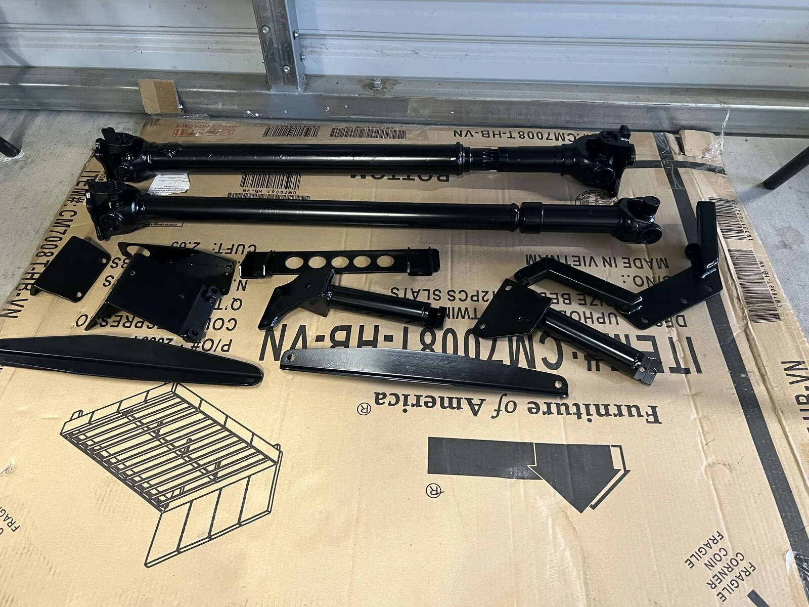

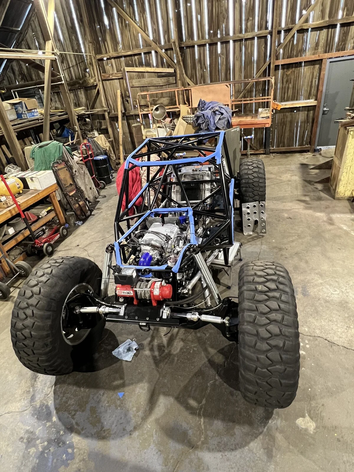

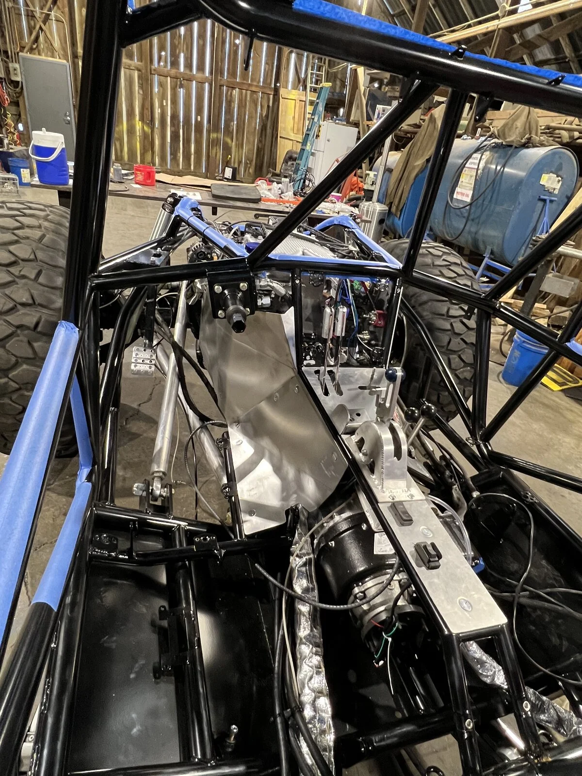

Transfer case is remounted in original location which keeps driveshafts and seat mounts!

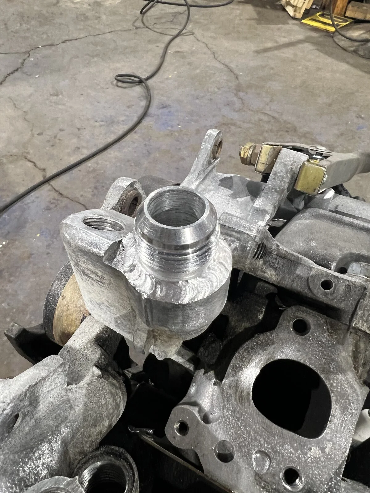

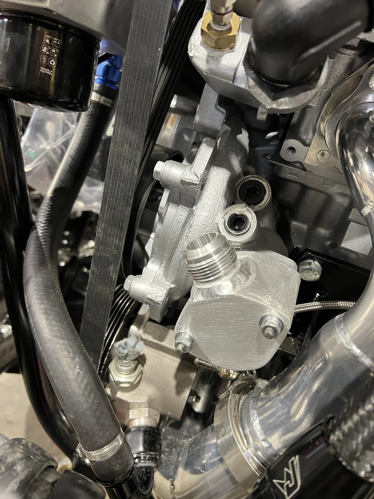

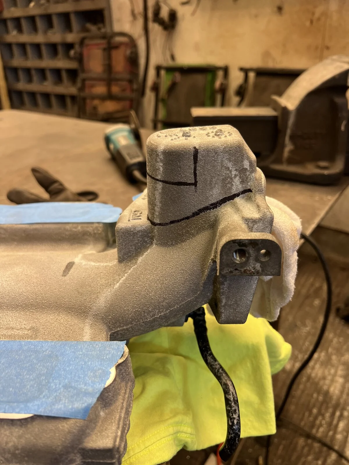

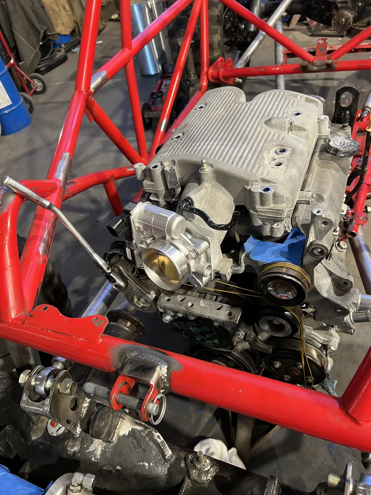

My first real tech was flipping the intake. I have seen the normal move all the front water jackets to the rear like Mnorby who did a great build! And has the JHF advantage of coolant traveling through the chassis tubes

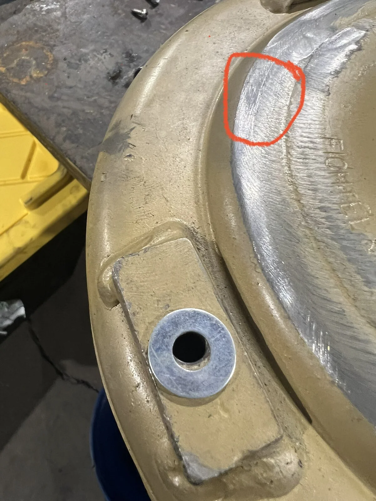

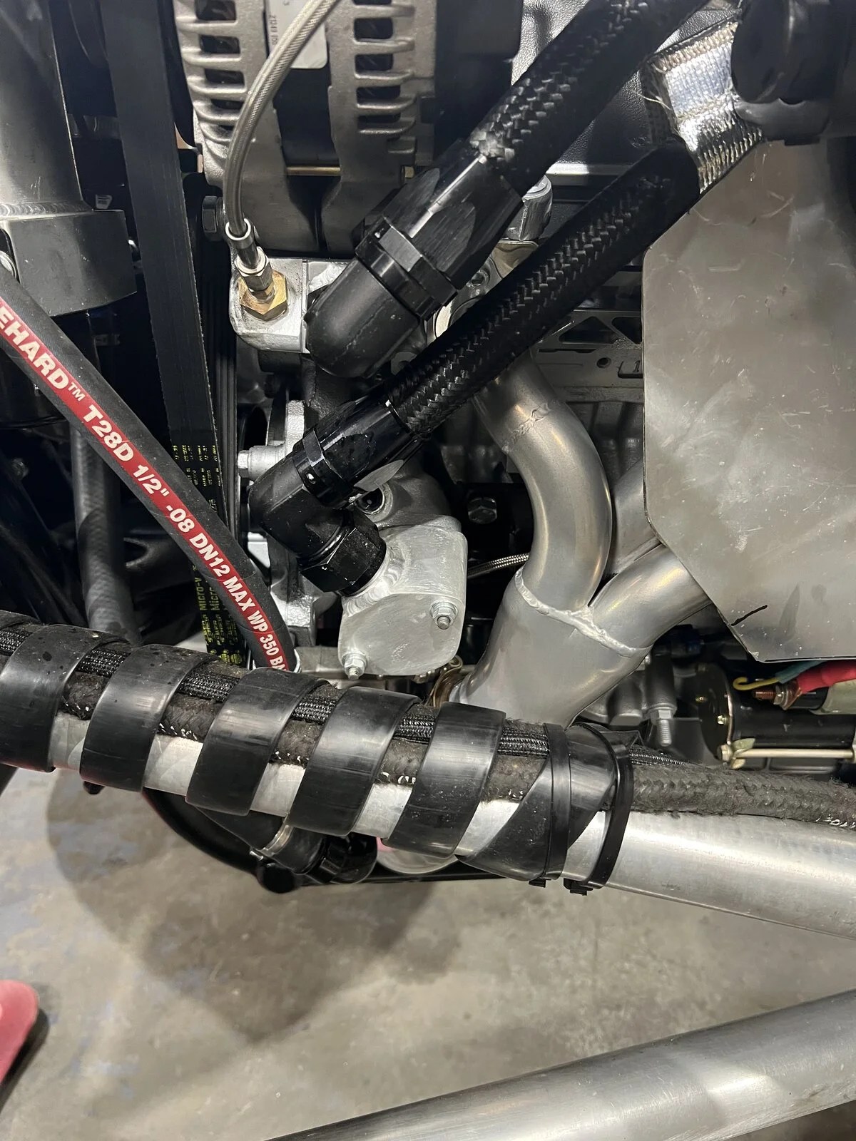

I decided to cut the ball sack off the intake and flip it after cutting off stock power steering mount which keeps the Eversen belt routing 👍 just need a friend with a higher powered Tig to seal the hole

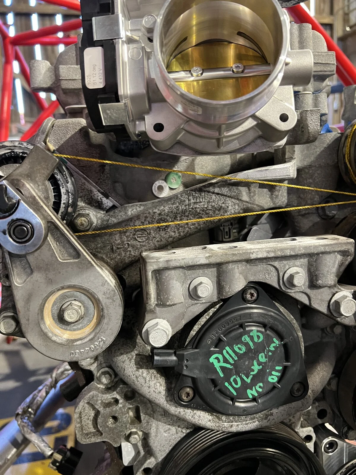

Have you actually put a belt on this yet? I bought the same Eversen bracket and with a 90 inch belt the tension is great but the belt hits right below the throttle body. Just wondering if it’s me or if I need to change something. Thanks in advance!
I figured out my problem. I just needed to clearance about another 1/4 inch off the upper intake. Right as rain now!

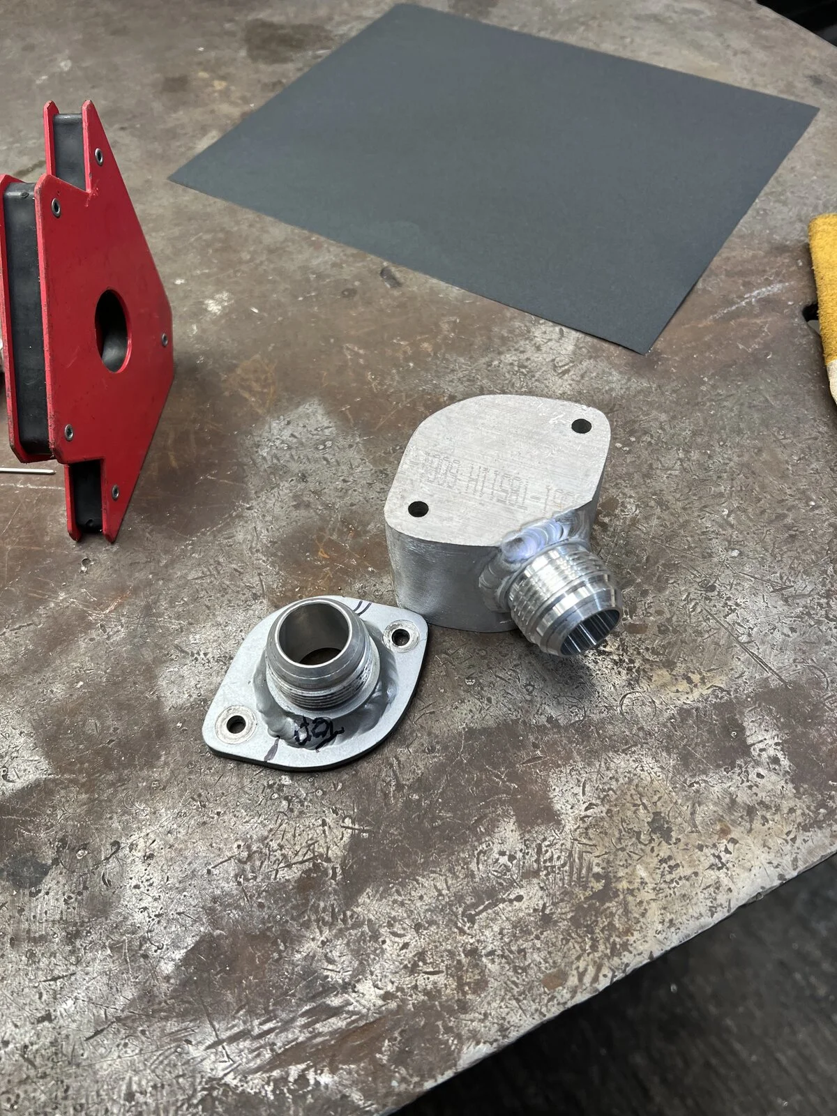

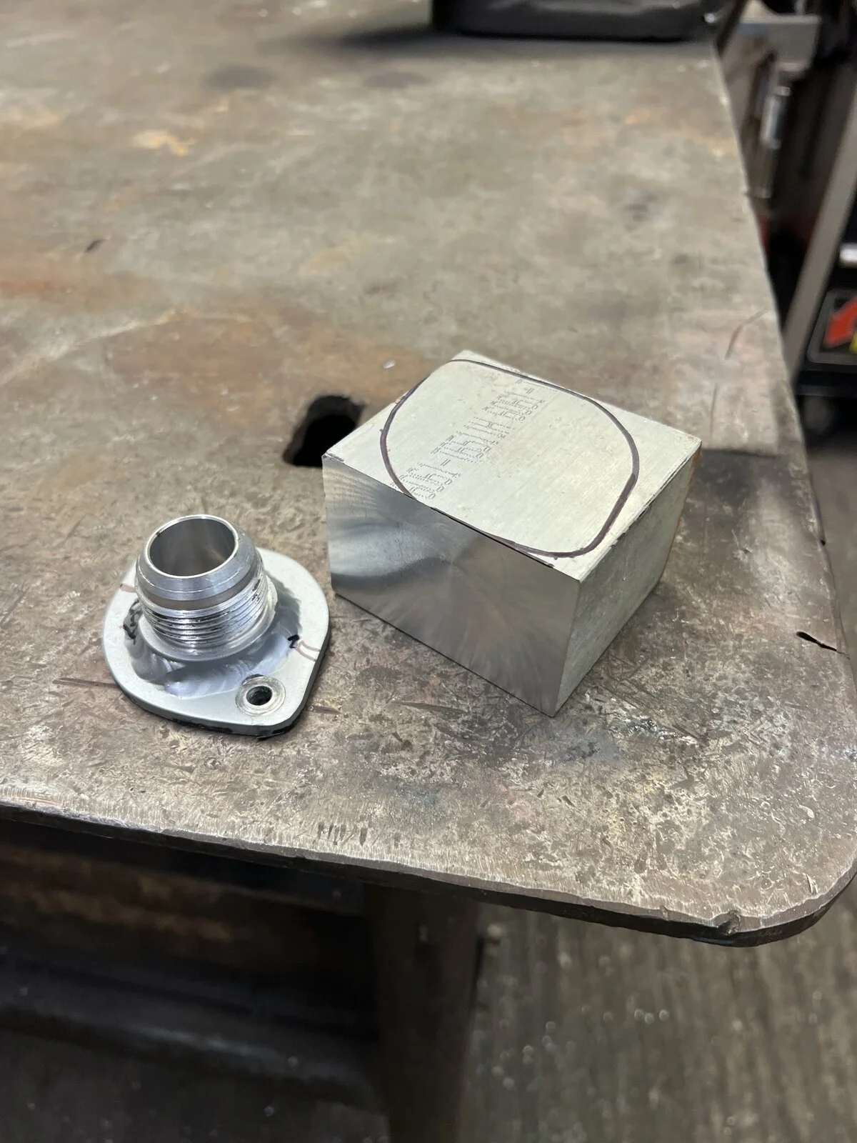

Water neck was too close to drivers side upper link so I made a 90* neck out of a chunk of aluminum 👍

Billet cardboard waterneck (no thermostat) installed

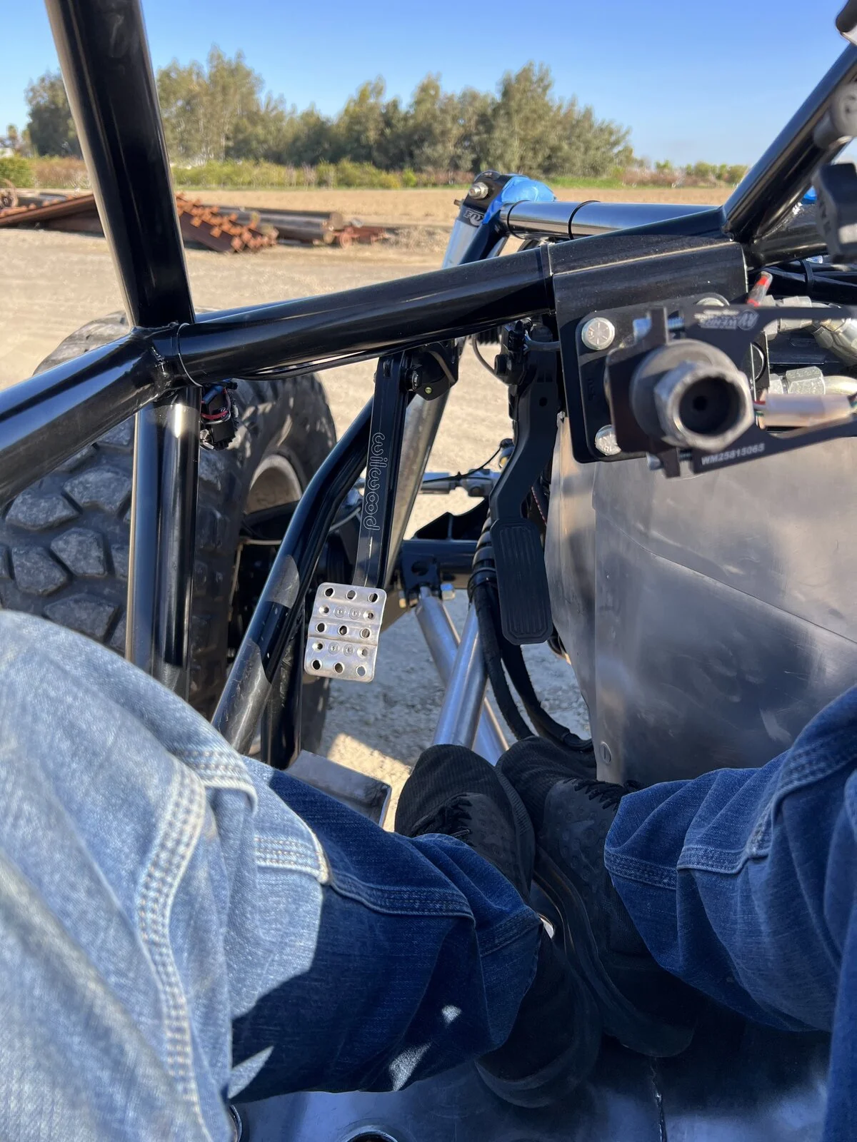

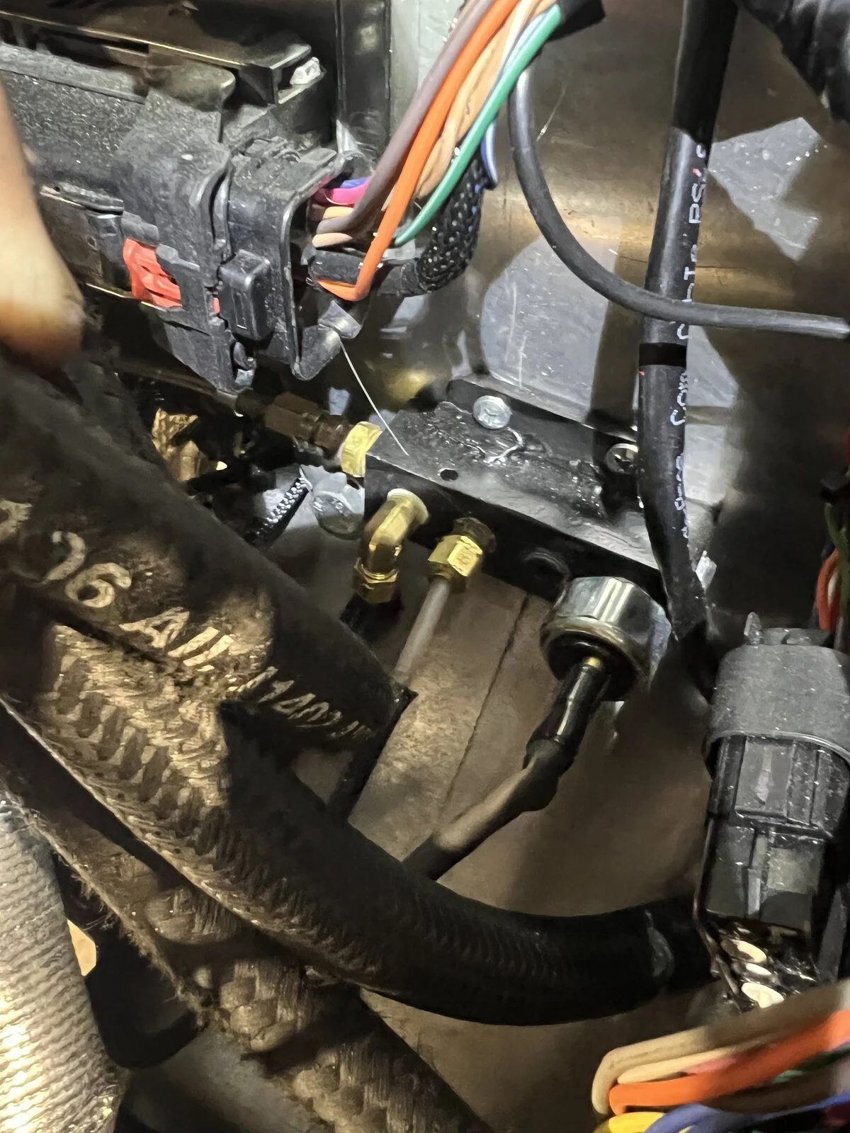

SHO 3/4” wilwood single master cylinder with a braided flex to a manifold (internet buy) mounted with a brake light switch all plastic lines from there to calipers. Brakes are good 👍

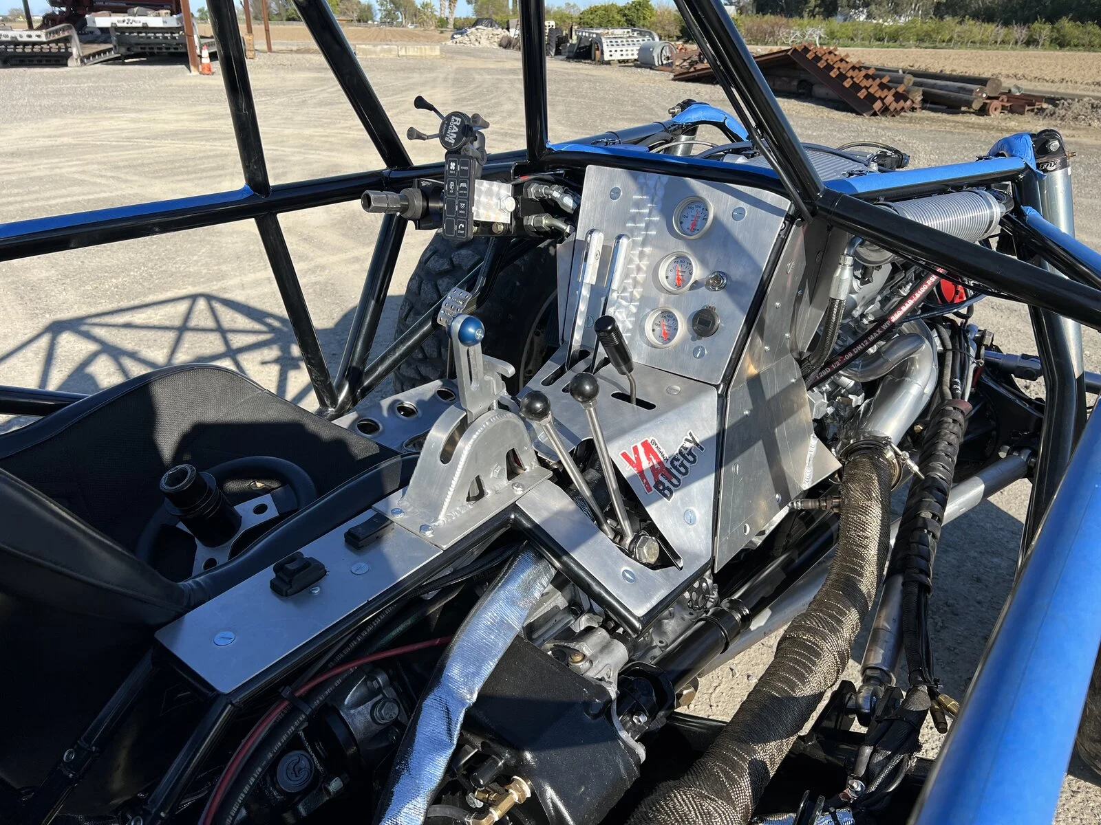

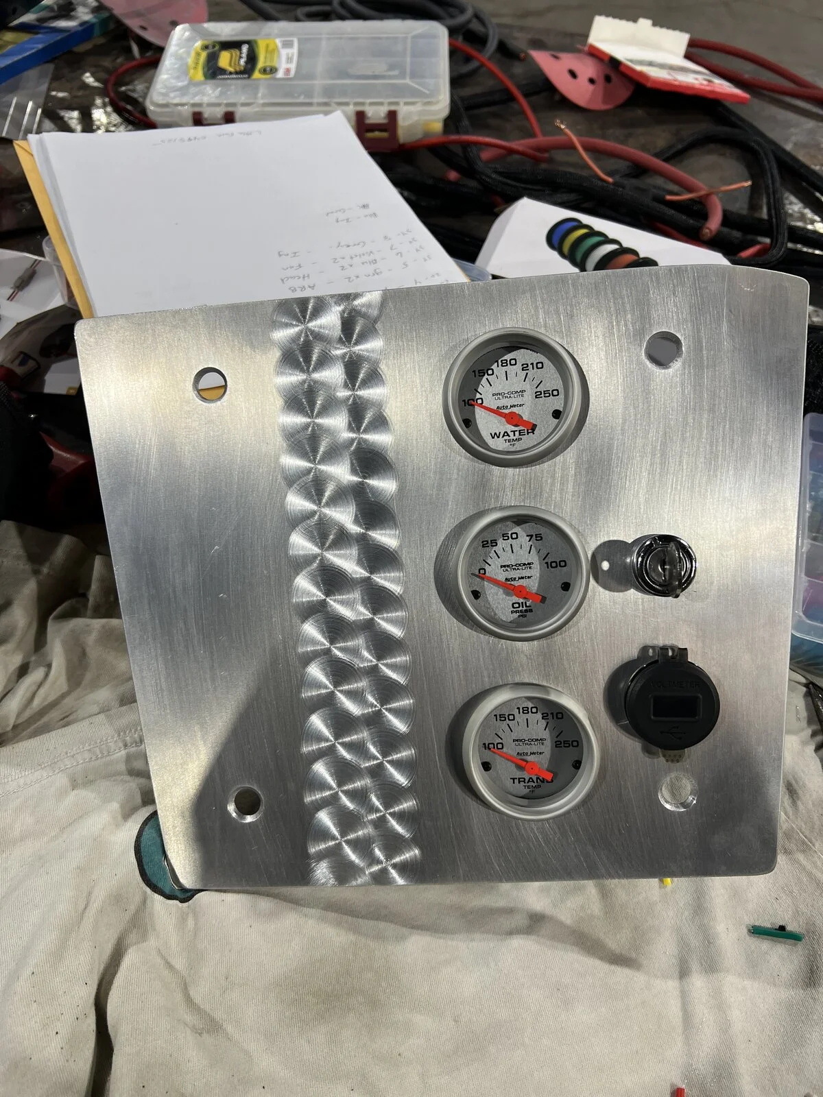

Got the air locker switches mounted (plastic air switches from a Peterbilt).

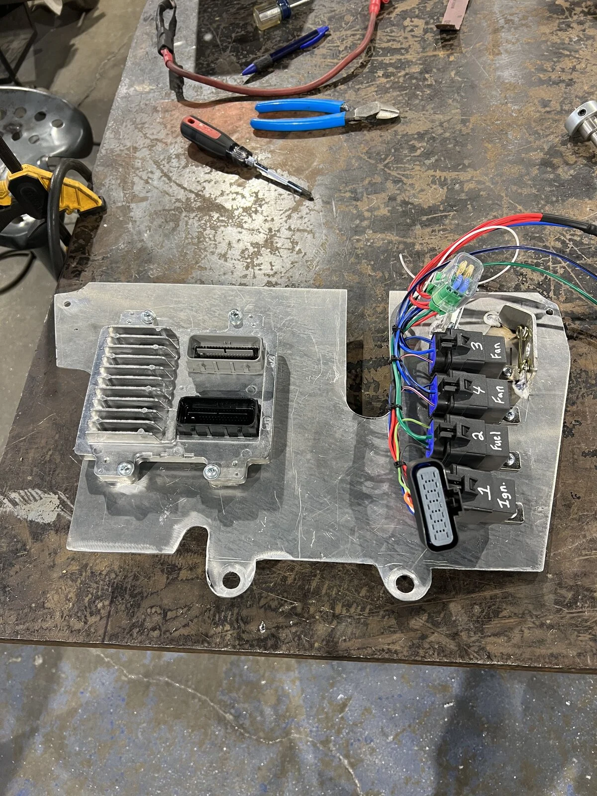

Fired right up. Idled at 1500rpm and then after a minute and a half it idled up to 2100rpm. I realized with HP tuners that I had a faulty new GM O2 sensor. New Napa O2 sensor and we are in business
Stock D300 gears seem perfect ratio with the portals. The Buick 3.9l is surprisingly peppy a couple small things left

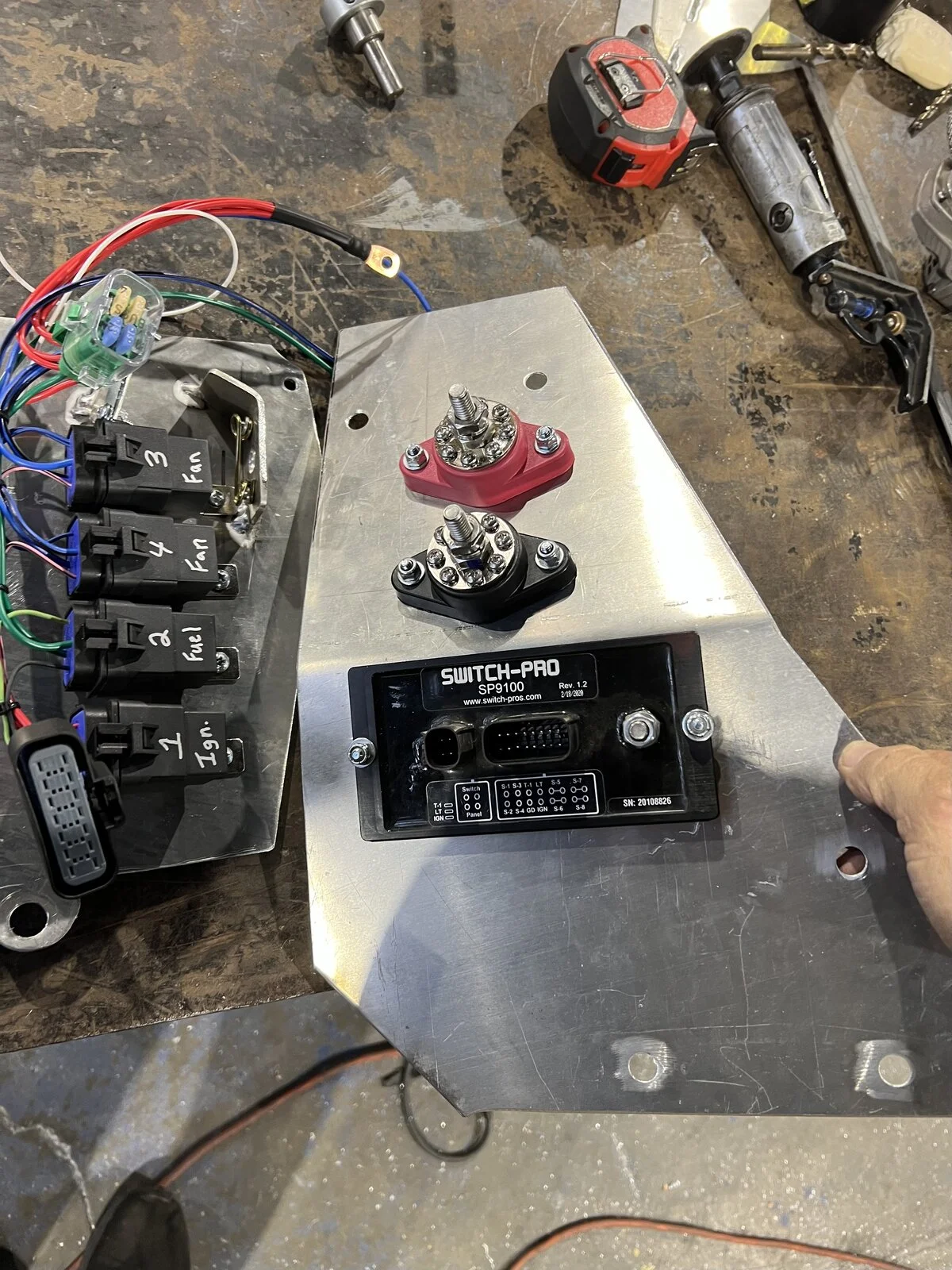

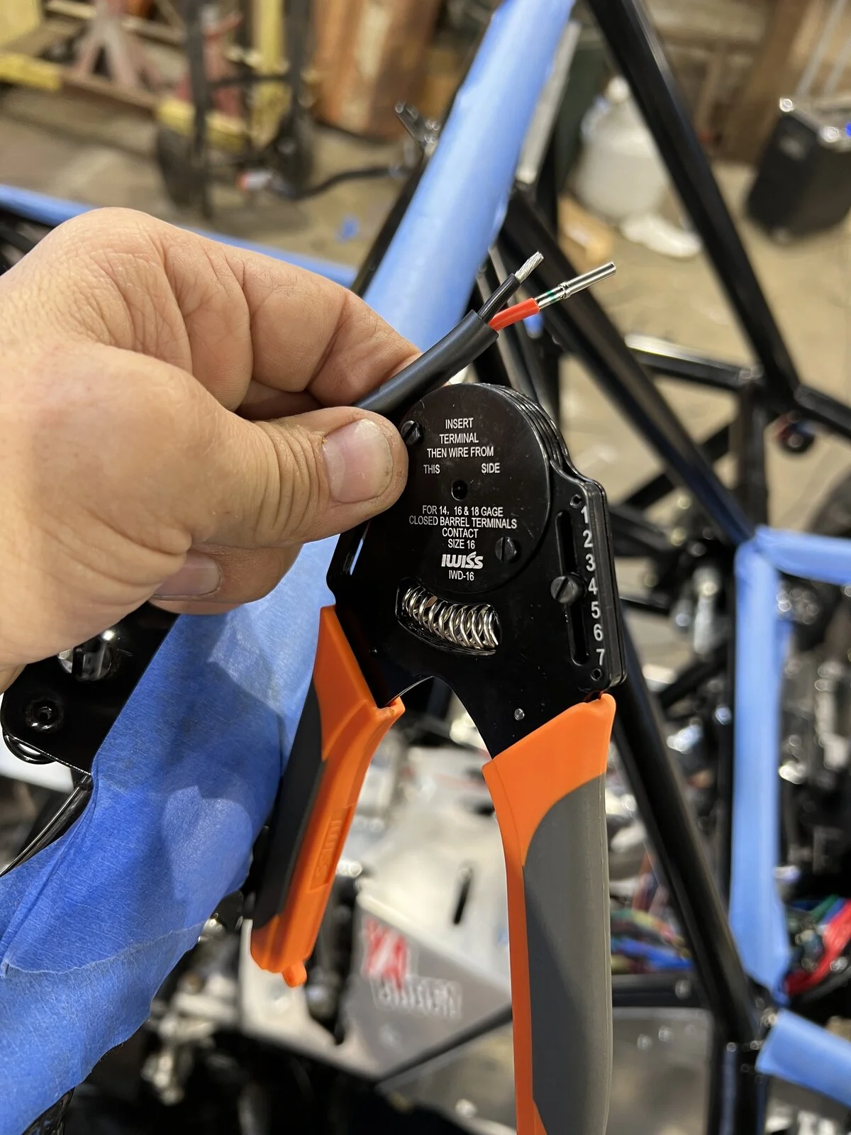

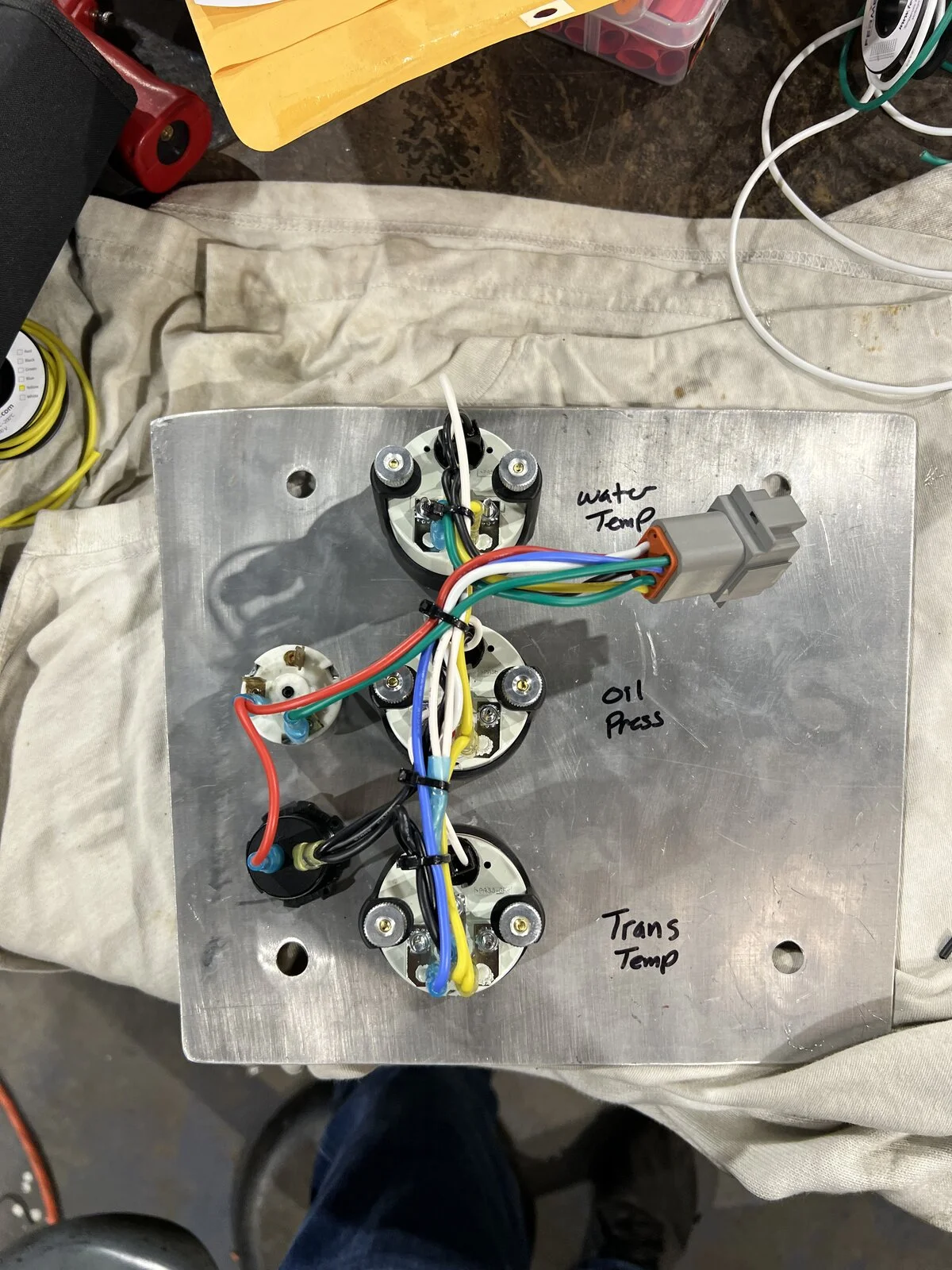

Very happy with the duetch (whatever) connector kit from Amazon. Also bought the crimpers and extra terminals that were not split down the middle which I like these only work for 14 gauge wire so I used a weather pack for the 12 gauge fan wires

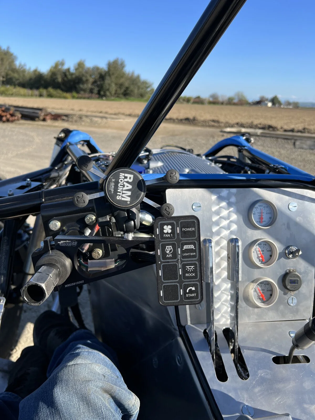

This buggy came with a switch pro’s 8 switch
It is magical. Internally digital circuit breakers. The Brain will Bluetooth to your phone
You can program 4 switches to 35amp (these have two 14 gauge outputs)
4 switches are 17 amp max.
Individually programmable momentary on/off
Can turn certain switches on automatically with key switch
One switch can trigger another. Light bar was set at 7 amps and after 3 seconds on they would flash and turn off. It can dim stuff by lowering voltage.
I have a key switch that turns the pro on.
ARB is automatically on
Ignition button then starter
