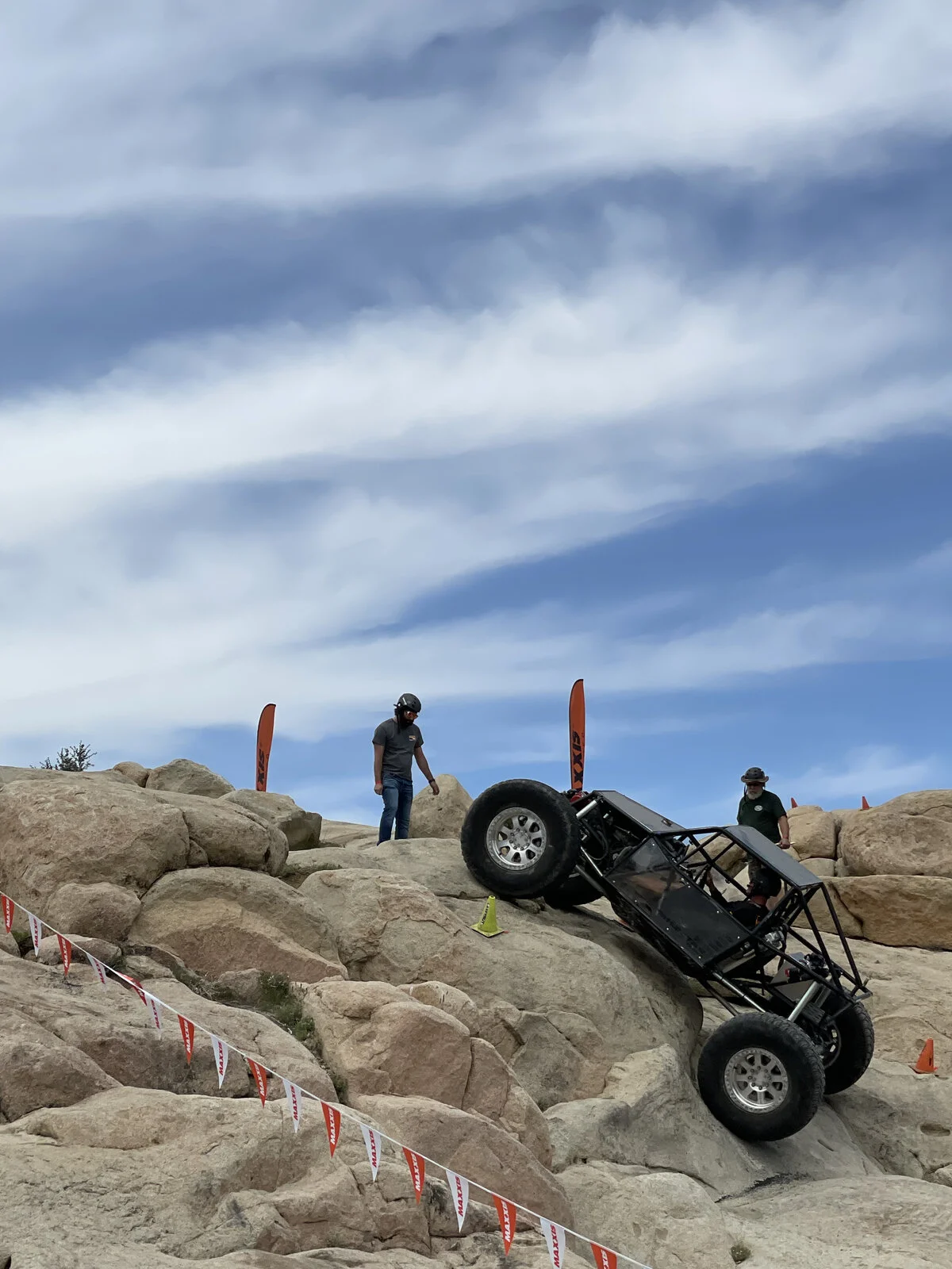

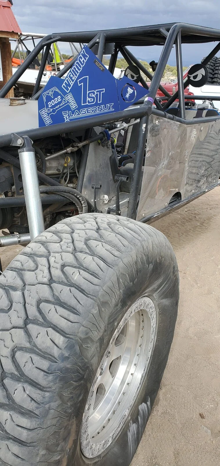

So, I did a thing last weekend April 30/May 1.... WE Rock - Cedar City Home
TL/DR: we won Sportsmans A.
So, Wednesday 4/27 I reply to Tyler Harper's post on WE Rock....that I have dusted off my lawn chair. I'm on my way to Moab for a 2023 Sequoia thing, and between replies to my post and a handful of direct messages, I decided to compete....that means finding a spotter. As I clear Green River, I called Logan Backus...he's building a JHF Trail too (chassis #1) and has WE Rock experience....,having someone that knows the rules AND needs to learn his pending car's capabilities turned into a win for both of us.
I turn and burn from Moab on Friday and got home about 1pm...unloaded my FZJ80 and loaded the Sprinter, did a once-over on my car, and loaded up. Fortunately, prep was easy....Sportsmans A requires a DOT helmet and 4-point harnesses, easy stuff. While I sat in the shop, I registered for the event...$175 I think. Well worth it for the experience.

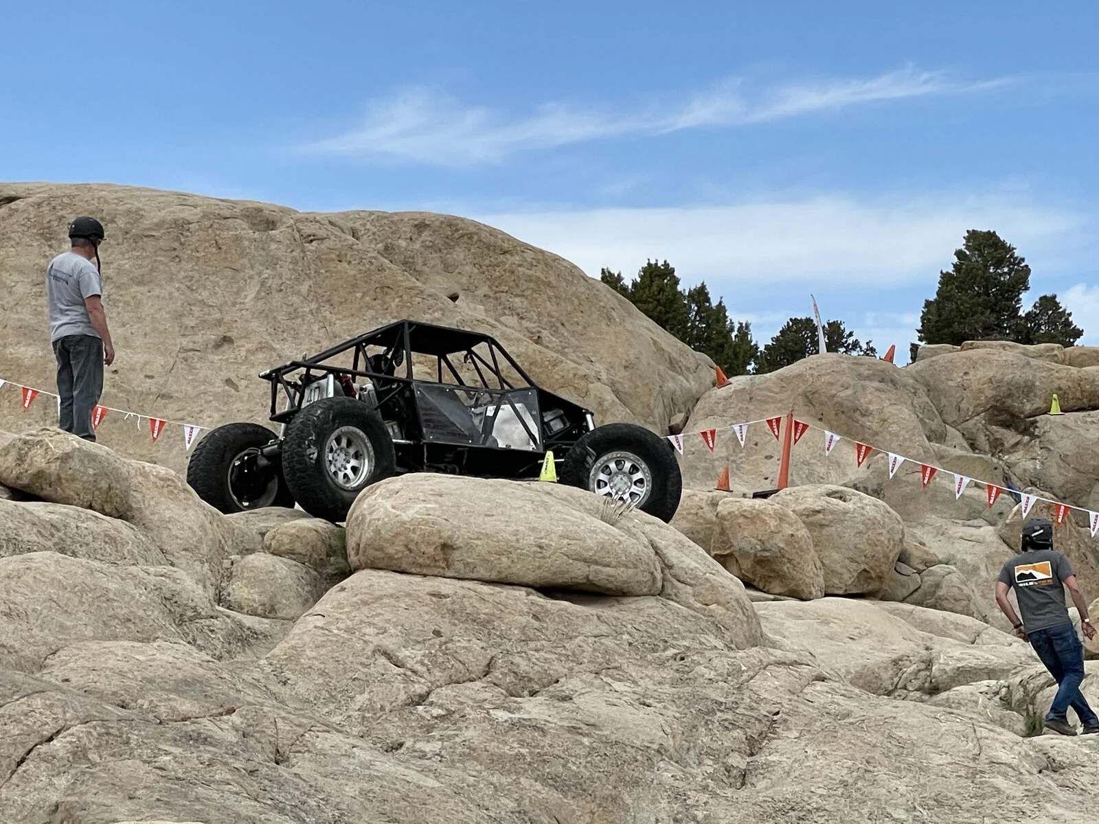

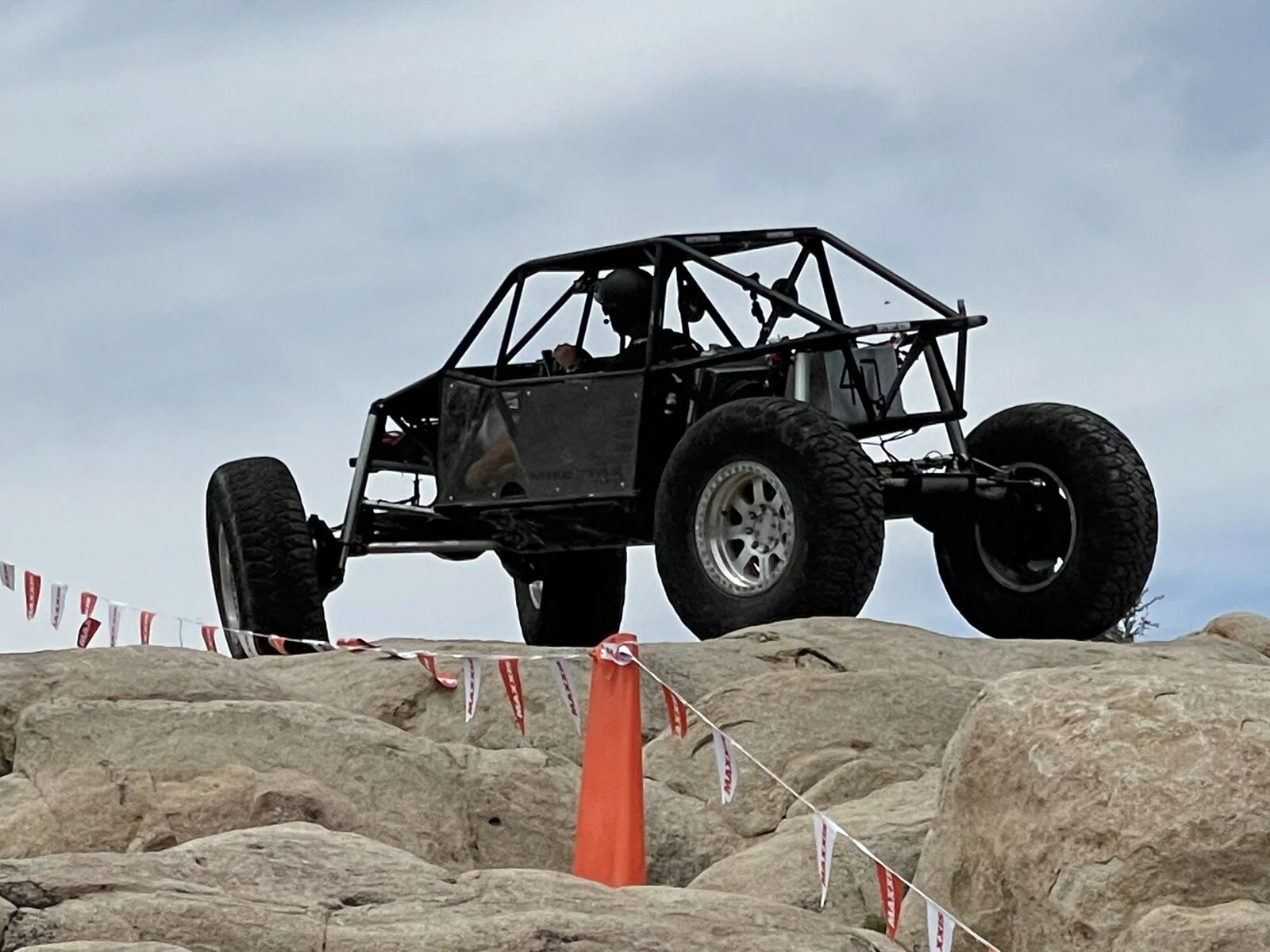

Sportsman's A-B-C all run the same cones/courses. Using rear-steer is a -10 penalty....so a perfect course score without rear steer is a -30...using rear steer puts the perfect score at -20 (assuming you run both bonuses).
Saturday started well...our first course was C2...we thought it could be done drag axle and score a -30, but the rear tires on the gate 2 crack/climb decided to actually stick, rather than slide (darn Milestar DOT's)....and we were forced to use rear steer. Ah well, no cones or backups, so a -20 score. C3, -20. C4, -20. C1 was our final course, and we believed it could be done drag axle too, but the final bonus would be tight....Logan positioned a rock in JUST the right spot and we cleared it for a -30. Day one final score: -90.
Sunday was simply the reverse of Saturday....climbs became drops, etc. C2 opened with a climb....again, we tried to drag it but aligning up the wall was not working, so we opted to use the rear....then the climb was not crawlable....two backups for -1 each to get aligned. Then the L67 supercharger shined and a little 2nd gear bump put the front tires on top and it crawled the balance (I believe we were the only car to make the gate 1 bonus climb on C2). Since we already had our -10 rear steer penalty, the balance of the course was easy. C2 score -18. C3 was another drag attempt but the gate 1 bonus ended up needing rear steer AND because we opted for it so late in the gate, cost us a cone. UUGH....C3 was a -10.
Sunday C4 was another drag attempt....gate 1 was a solid sidehill. Pointed the front uphill-ish and the rear tires again stuck too well, so I needed to either rear steer down to clear the upper cone OR skid the rear about 1-1/2" downhill...and not hit the lower cone. The Midnight D300 shined here....shift the front into N, lock the rear ARB, line lock the front brakes, and gently slide the rear downhill....then unlock the rear ARB, clear the line lock, hold the high cutting brake and engage the front while easing forward. Work perfectly. The transition from gate 2 to 3 required a front burn, and clearing gate 3 required a rear-burn/slide. The Midnight makes this stuff so easy. Score: -30.
C1 was our final Saturday course....Gate 1 was tore up, so we opted to take it simple and run the normal line....then a mistake on gate 3 cost us our 2nd cone of the weekend. Our score on C1 was the worst, a zero.
Logan killed it with spotting....great communication, good feedback, and good advice on car positioning between the gates (more critical than you'd think). We worked great together, especially considering there was zero practice.
For the weekend, final score -148. Two cones, two backups. Next closest was Jason/Jacob Reeves with -128 and then Tyler/Steve Nantz with -111. Considering the last time I comp'd at ANY level was in the late 90's, I'm not complaining. I did get a little flack for sandbagging, so we'll see what I decide for future comps...the JHF Trail IS a bit big for the Unlimited courses, but that simply adds to the challenge ;)
Well, that and I'm on DOT tires....
